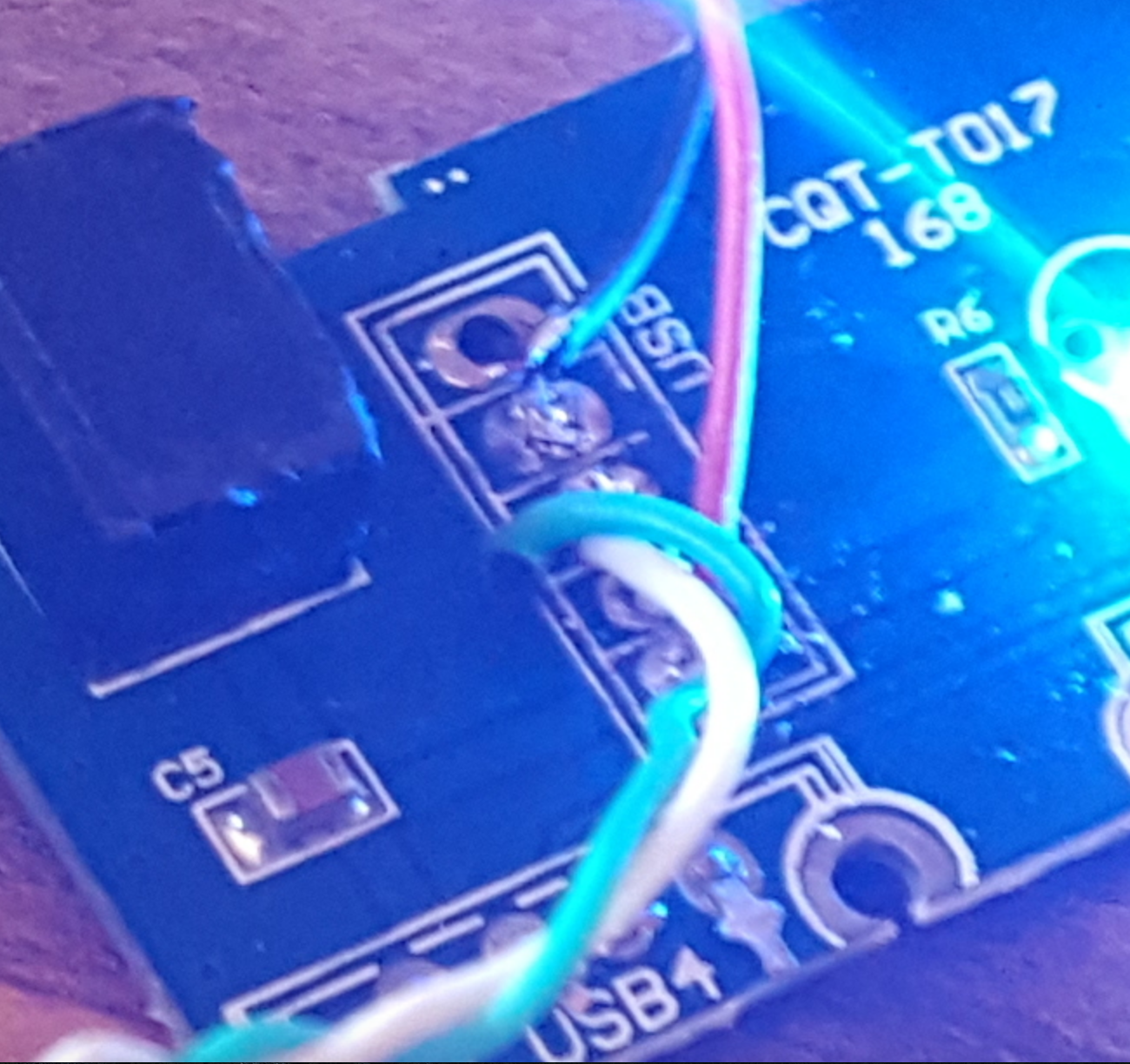

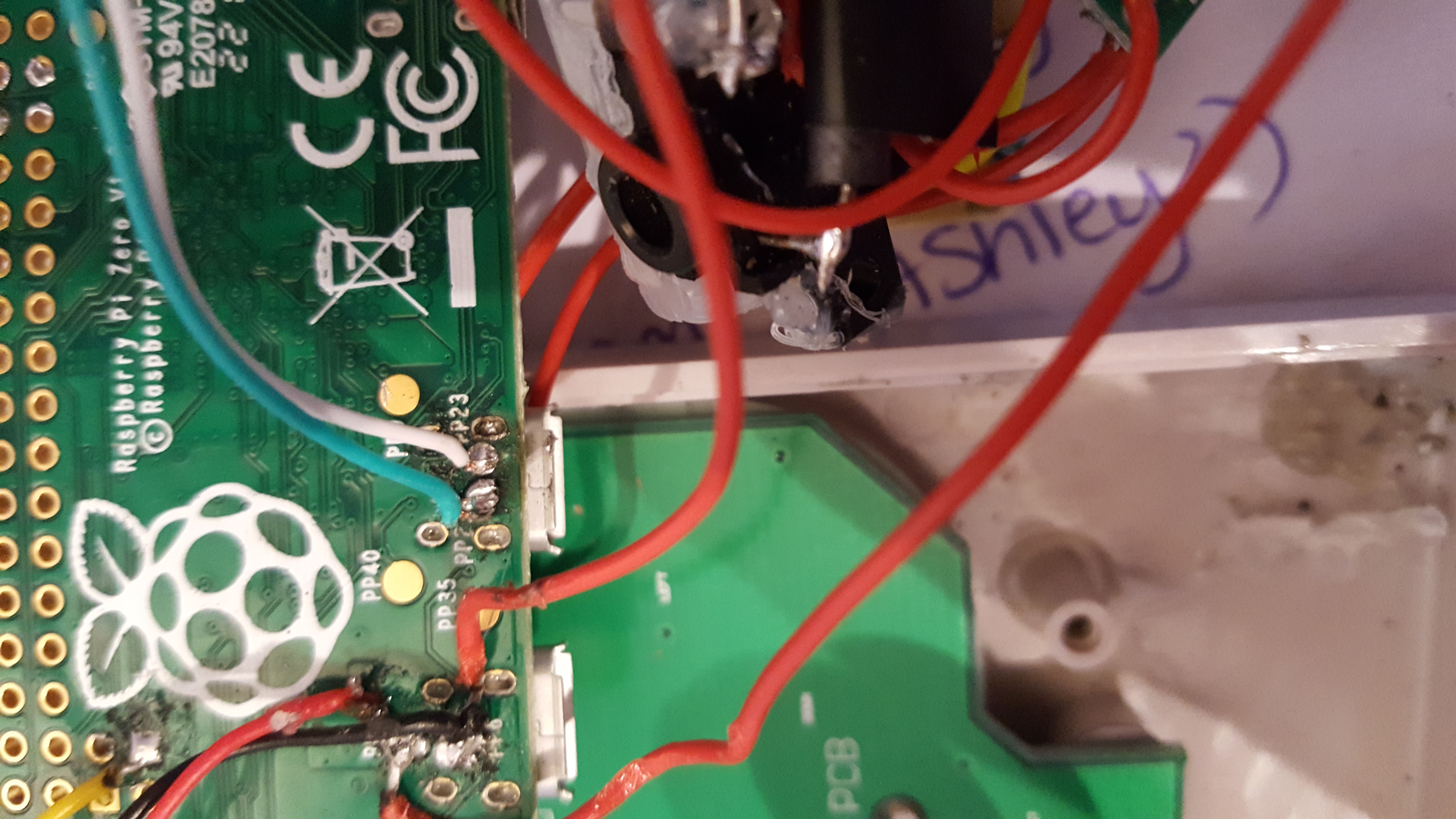

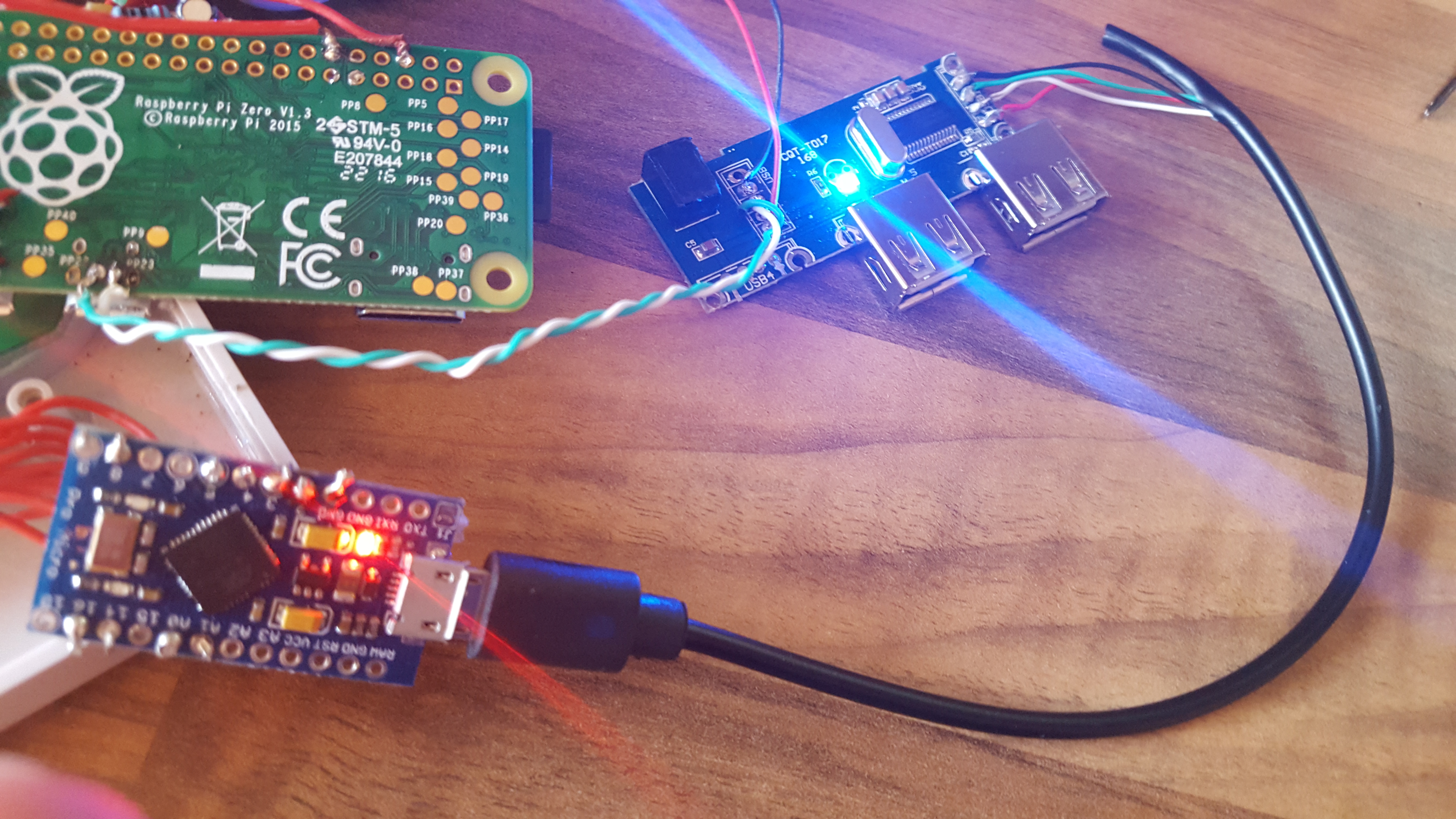

thanks for the replies, i have cleaned around the usb pads and taken photos to zoom in can not see anything touching?
also i did see that thread on usb issues. had read it but not tried, have now tried but still no joy.
a few pics attached below, i would love it to be a glaring mistake i have made but just can not see it? green/white goes to usb pads on pi, red black go to power on pi or power strip?
please someone tell me ive been stupid and missed something obvious........... ;)

Is this the order of your wires ?
