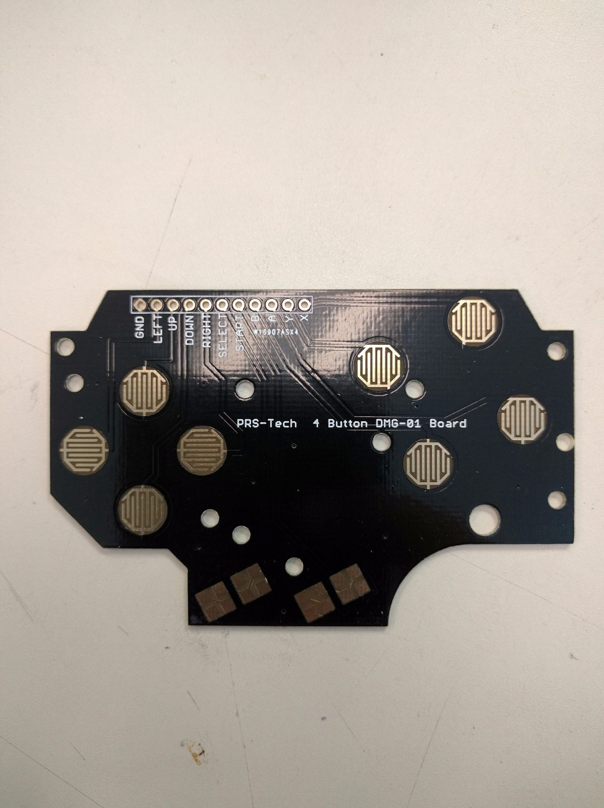

I'm anxious to get my GBZ started and looks like there's no plans to make anymore AIO PCB's, so I'm left with buying a V1 from ebay
My question is, do I just wire this directly to the Raspberry Pi Zero, or do I need to buy a Teensy-LC and wire that to the PCB and then to the Pi?

See Wermys original guide for GBZ
This can be wired directly to Pi Zero but it's recommended to use a Teensy

Thank you, do you have a link as he has several guides?Lphillimore wrote:See Wermys original guide for GBZ
Awesome, Picked up a Teensy-LC. Now I waitLphillimore wrote:This can be wired directly to Pi Zero but it's recommended to use a Teensy

The teensy is recommended or we must have one ?
Because in a lot of turorials i don't see teensy and they wiring on the pi all the buttons.
I have the same PCB and i want to be sure i can use it like that without buy an other thing ^^

@Valadone
If you don't want to use a teensy then follow this guide:
http://www.sudomod.com/forum/viewtopic.php?f=22&t=57
I used the same style PCB in my first build and did not use a teensy, I have had no issues with the controls wired directly to the pi's GPIO's.

Thanks a lot !
EDIT : And for recalbox ( out of the box when you add something on the code ) https://github.com/recalbox/recalbox-os ... llers-(EN) but not sure for Rasp Pi 0
