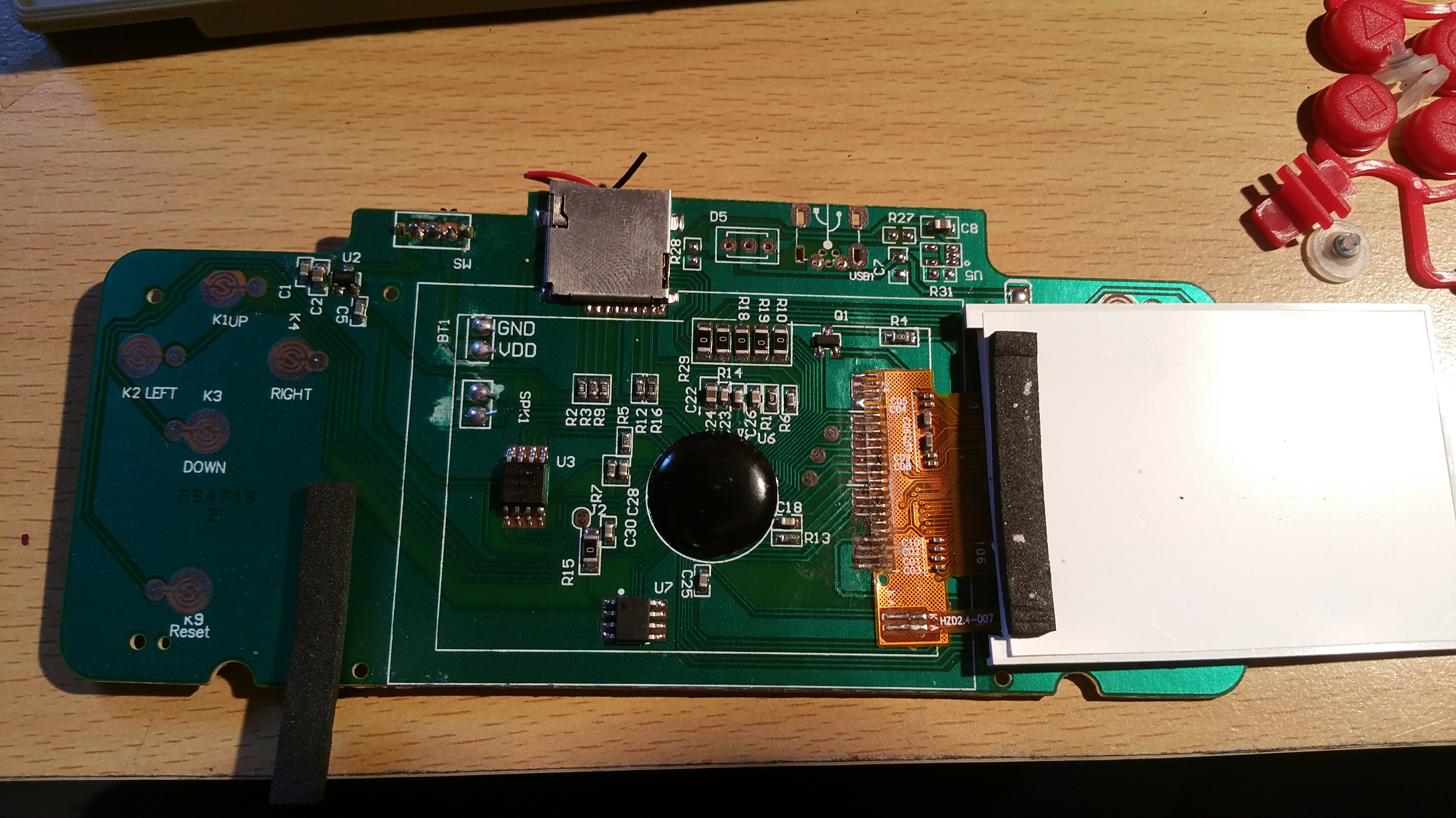

So thats where you guys come in! I can see where to get power and ground for it but i have no idea how i could get picture signal to the screen. Any help would be GREATLY appreciated.

That screen looks like it'll be difficult to salvage, maybe try finding what kind of chip is under that black resin blob. I could help you if I knew what the chip underneath is to find the pinout with a data sheet, if one exists.

Oh, and also if you can't get the screen, your $20 is not wasted, as you could reuse those button PCBS and pads.

Yeah that screen is going to be tricky. Will probably be using spi, but there are more pins than I would expect to see (24) on the screen. Looking at the photo, there seems to be quite a few pins tied together, and some not looking like they are connected.
First think I would try is see if you can find a similar screen on aliexpress and see if you can get a pinout for that. Even then, you will need some kind of carrier board so you can wire the screen to the pi

After a quick but of searching I found this
http://s.aliexpress.com/yYRf2eUJ
Hopefully the URL will work ok, I found it with my phone. You firstly need to see if the driver chip will work with the fbtft driver on the pi
