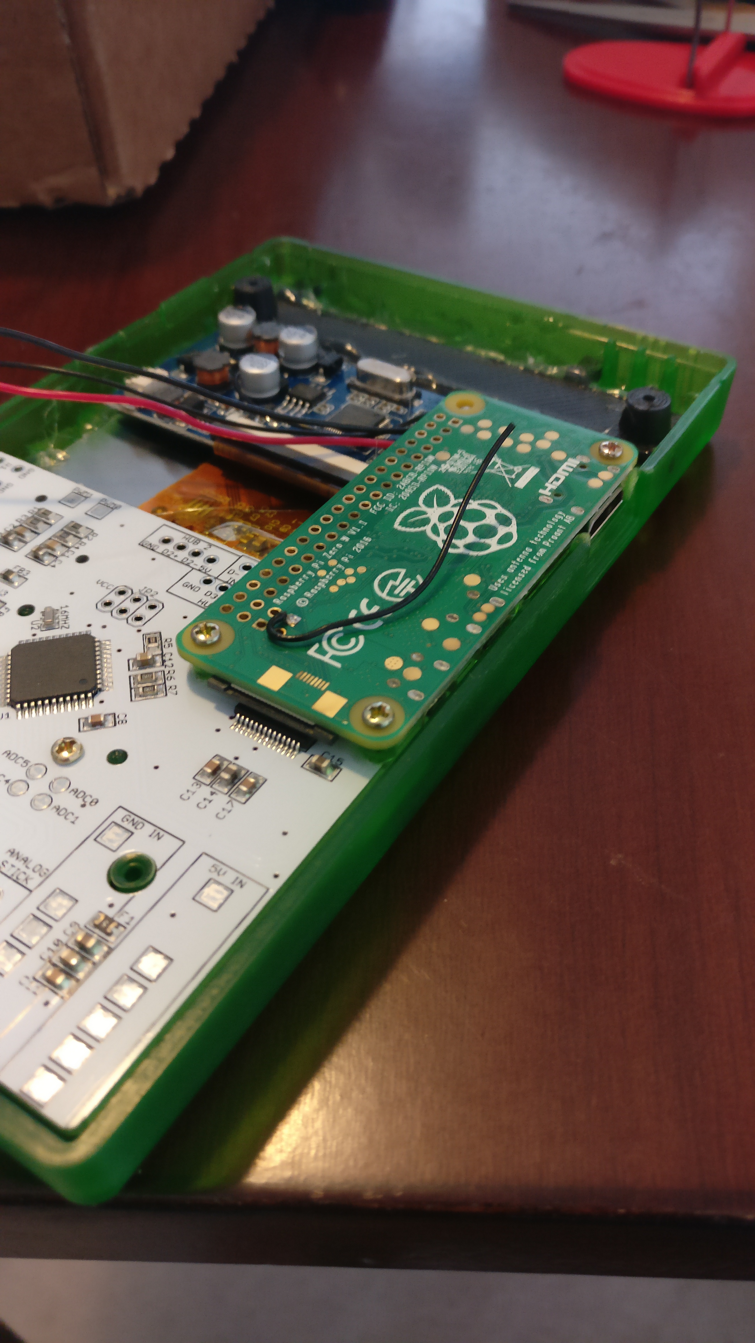

I ran into an issue on my first gbz build with the pi getting so hot that it would soften up the hot glue that i used to mount it, enough that i couldnt plug in a mini hdmi cord. If i have been running the gbz for some time (enough for the pi to get hot) i would try to plug in a mini hdmi and it would just push the whole pi inward. I came up with a more solid and permanent solution but still easily removable. Best of all, it fits perfectly on helders AIO board. Hope this will help someone here out

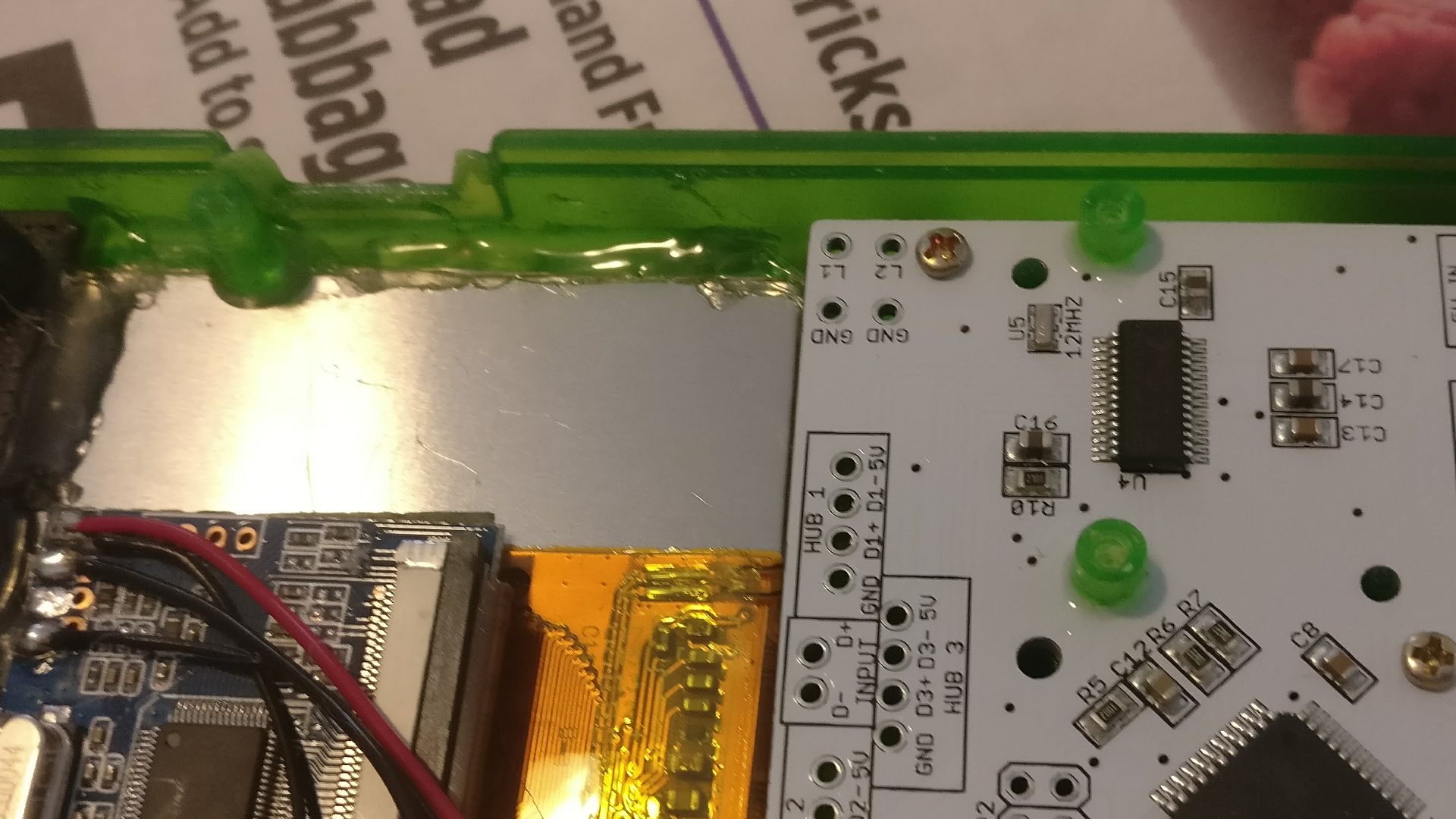

- Shorten the two bottom screws so that it doesnt bottom out and possibly damage the AIO.

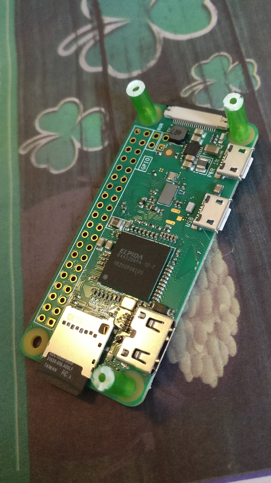

- Screw the screw posts onto the pi.

- Pi mounted neatly
