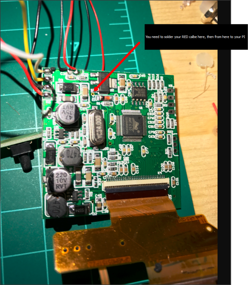

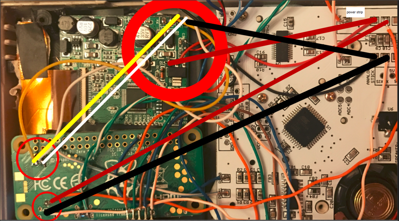

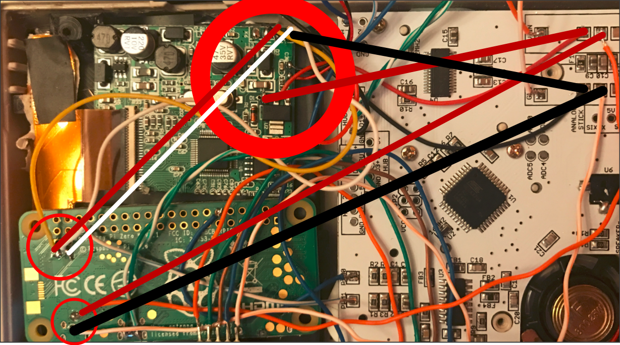

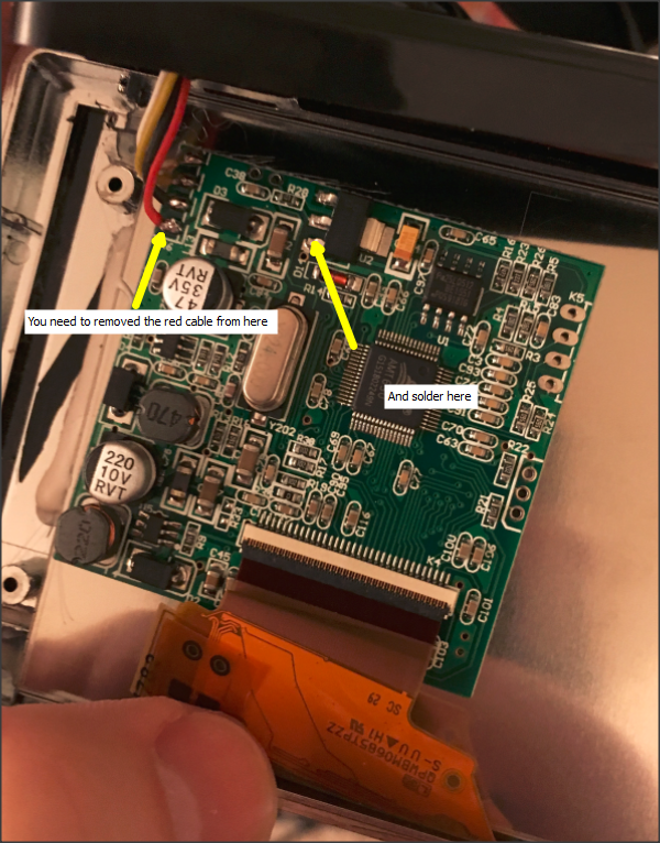

Maury wrote:
Tue Sep 19, 2017 9:31 am
I hope you got it working by now..
Me too, I just got this board for my build.
I understand from your photo the ground and power going to pi and screen from the power strip. My confusion is the wiring from screen to pi, but it just might be the color thing.
The thin red line is the original yellow cable and the white is the original white, correct?
From what I understand, only the red is disconnected from the original spot on the screen and moved to the leg of that chip.
Maury
Posts: 37
Joined: Fri Sep 01, 2017 8:36 am
Location: Chicago Ill.
Has thanked: 28 times
Re: Help with BW Variant 12V to 5V [Wermy GBZ]
Post by Maury » Tue Sep 19, 2017 11:30 am
You are correct..
I used the red color instead of yellow.

Maury
Posts: 37
Post by Maury » Tue Sep 19, 2017 11:31 am
Once you solder the jump cable your screen will run in 5V
