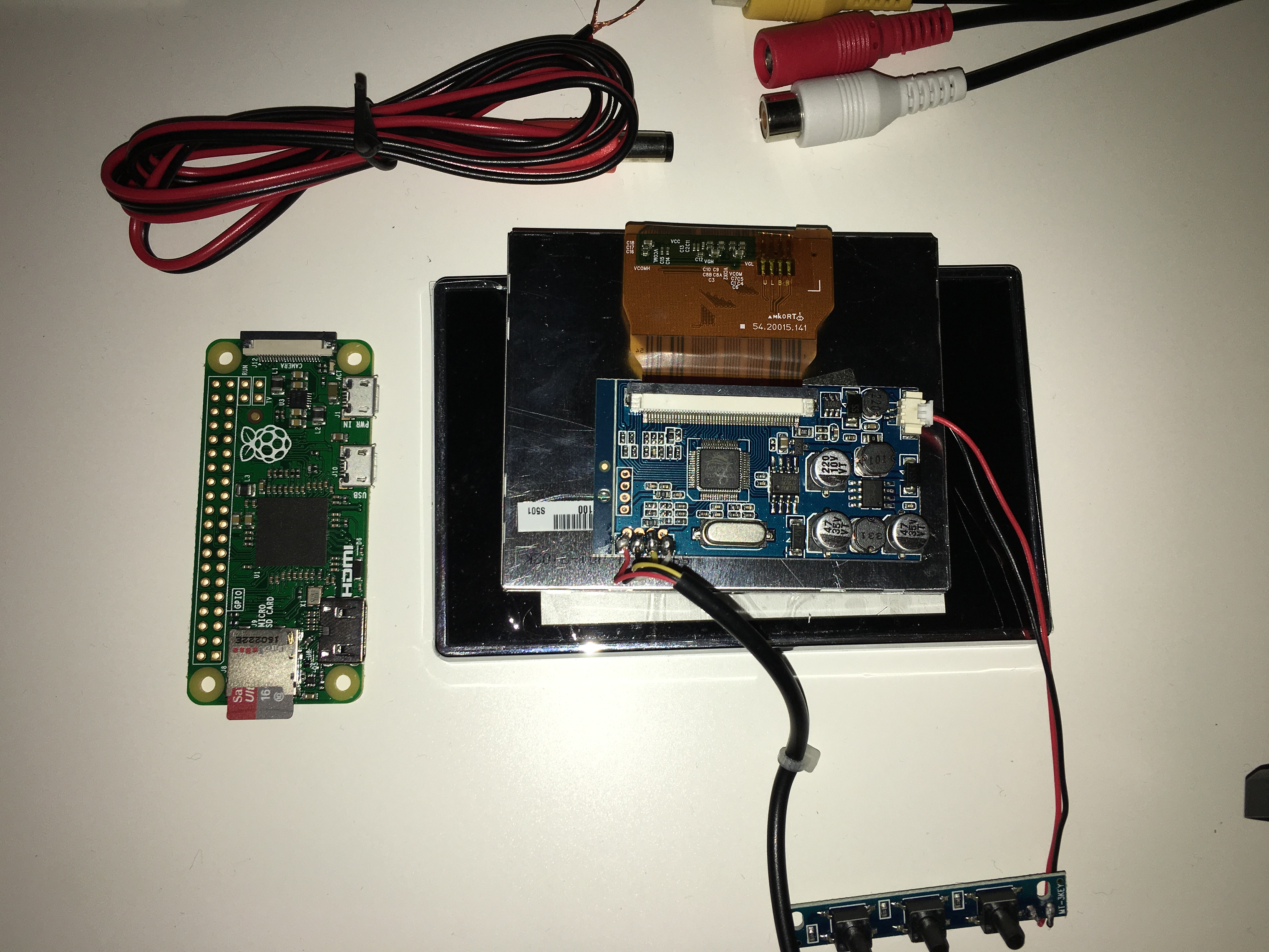

PND wrote:Hello I have this BW screen and I have made some modifications to it and it runs on 5v. I have made a drawing in paint of my wiring :)
Please correct me if my wiring is wrong or if there is a better alternative, I just tried this.
[spoiler="Pictures"]Image
Image[/spoiler]

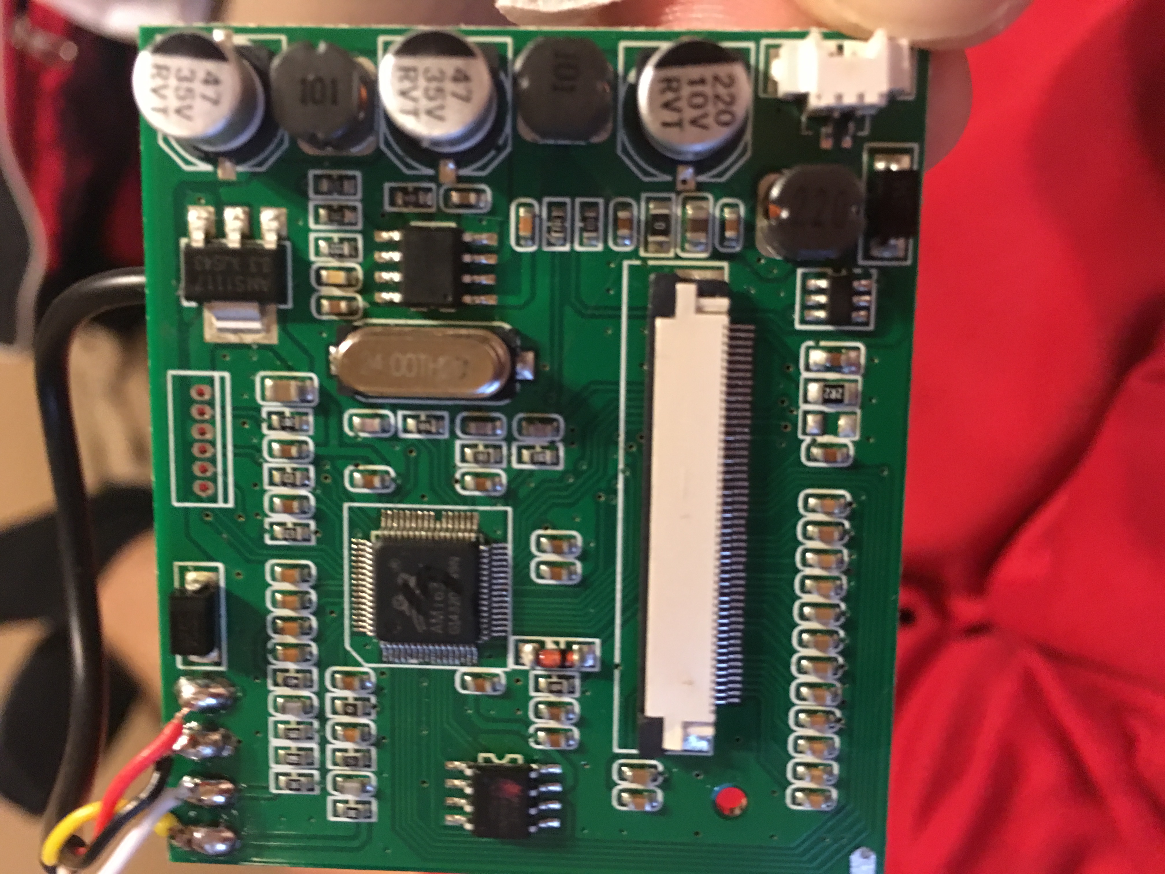

Hey there, will this board work the same as the image above, so that I can use your diagram with it?
Thanks
PND

Post by PND » Tue May 24, 2016 4:06 pm
Image[/spoiler]
[spoiler="Picture of travnar"]Image[/spoiler]
Thanks
I 'm not 100% sure but I think so. If you compare the pictures the boards are exactly the same, except for the color. If you want you can try it. If you do i recommend to try it first with hot glue before you intend to solder it. And please note that I am not responsible for any damages that you make. Good luck !

Why wiring 5V and 3V3 :o
jev
Joined: Tue May 24, 2016 9:31 am
Location: Dublin, Ireland
Post by jev » Tue May 24, 2016 6:30 pm
solder wrote:Why wiring 5V and 3V3 :o
That's clever. I think it's because pi zero has both 5v and 3v3 outputs. You can technically bypass all the voltage regulation circuitry on the display board. Maybe save few mAs? :roll:

PND wrote: I 'm not 100% sure but I think so. If you compare the pictures the boards are exactly the same, except for the color. If you want you can try it. If you do i recommend to try it first with hot glue before you intend to solder it. And please note that I am not responsible for any damages that you make. Good luck !
Yeah, that's what i figured. They look completely identical but the color. Now, what are the exact modifications you made the board? The diagram shows you pretty much keeping it intact; did you not remove any of the chips like the guide?

Post by PND » Wed May 25, 2016 1:09 am
I didn't make any modifications on the board. I only have changed the wiring like in the picture i made. The orange wire that i used in the picture is just a wire that I took from a UTP cable (It can be any color).
Haha to be honest I have no idea, I do not know much about this :P. I found this idea of wiring on the original Raspberry Pi forum. The OP of the post on that forum gives a short explanation why he did this. So thanks and credits to "MauroG" haha :)

Post by jev » Wed May 25, 2016 5:40 am
Interesting. So we don't have to connect the white wire at all because on Pi Zero it is the same as ground? According to wikipedia white and red wires mean left and right audio channels.

jev wrote:Hey guys!
Got a BW display on amazon.com from a seller called GoodWill Sky. Shipped from Hong Kong, $15.98 with free worldwide delivery. The motherboard is not like any other I've seen here. Also, it doesn't work with 5V so I had to modify it (red wire from 5V to a 3rd pin on AMS1117 chip).
The display is based on AMT630 Video Display Controller from ARKMICRO (http://www.datasheetspdf.com/PDF/AMT630/840049/9).
It has AMS1117 12v -> 3.3v (3 pin) voltage regulator to run all the logic (http://www.advanced-monolithic.com/pdf/ds1117.pdf).
Be careful not to remove a 8 pin chip there, it's a flash memory chip (marked Pm25LD512) presumably for built in graphics. It's the only 8 pin chip on that board so that's a distinguishing feature.
Also, the case didn't have any screws, instead holding together on plastic clips. The control board is on a separate PCB.
Hope that helps!
I'm just asking for clarification. Does this mean the actual control chip run on 3.3V? Why not completely bypass 5V and feed it 3.3V on the right point? Wouldn't this save some amps? I am not really knowledgeable in electronics, I'm just asking to learn.
