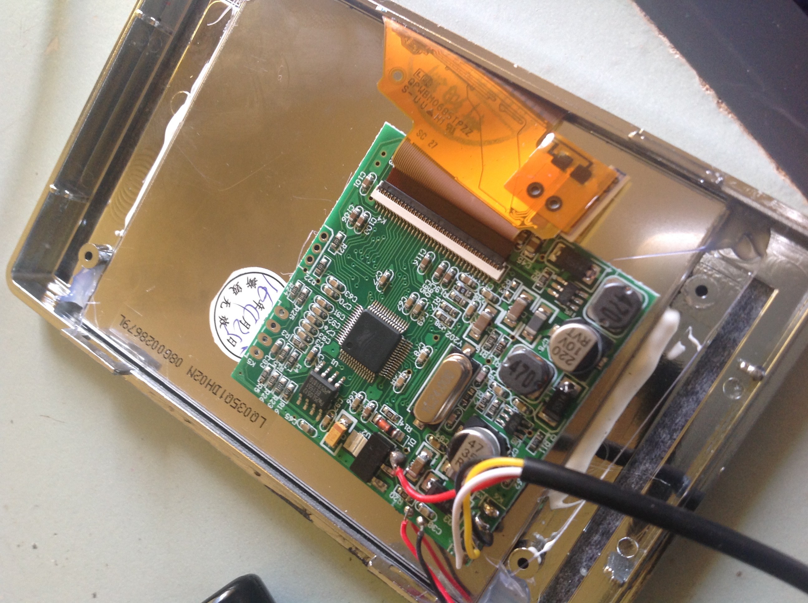

Do you have a picture of your lcd board? Does the board use the AMT630 chip? Mine gets hot. How about yours?
Mine isShow
