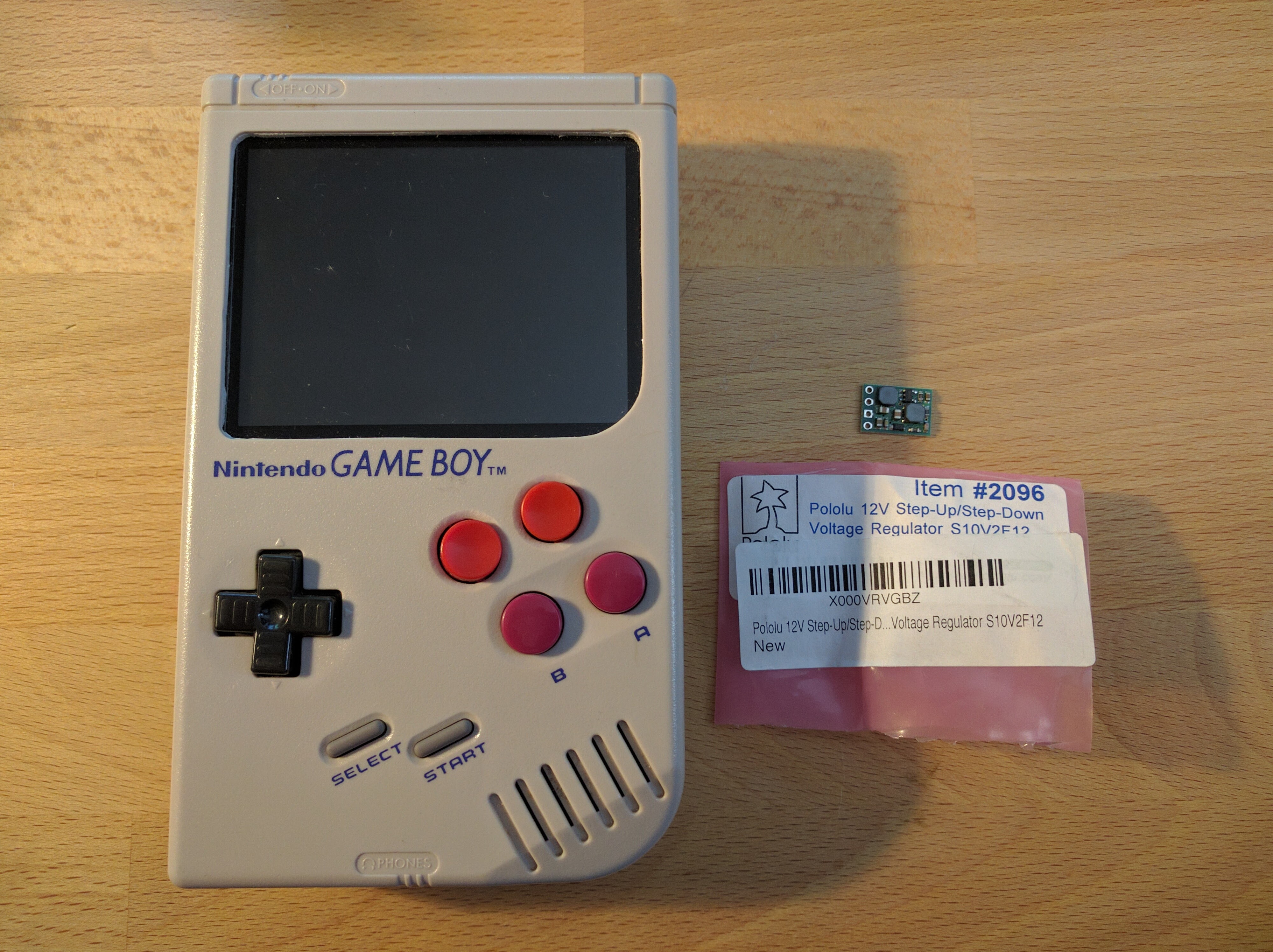

Post by dirtybeagles » Thu Jun 02, 2016 9:25 am
Well, I either did not set up my 12v jumper up properly, or I am hosed :oops:
Here is my 12v Jumper from Pololu:

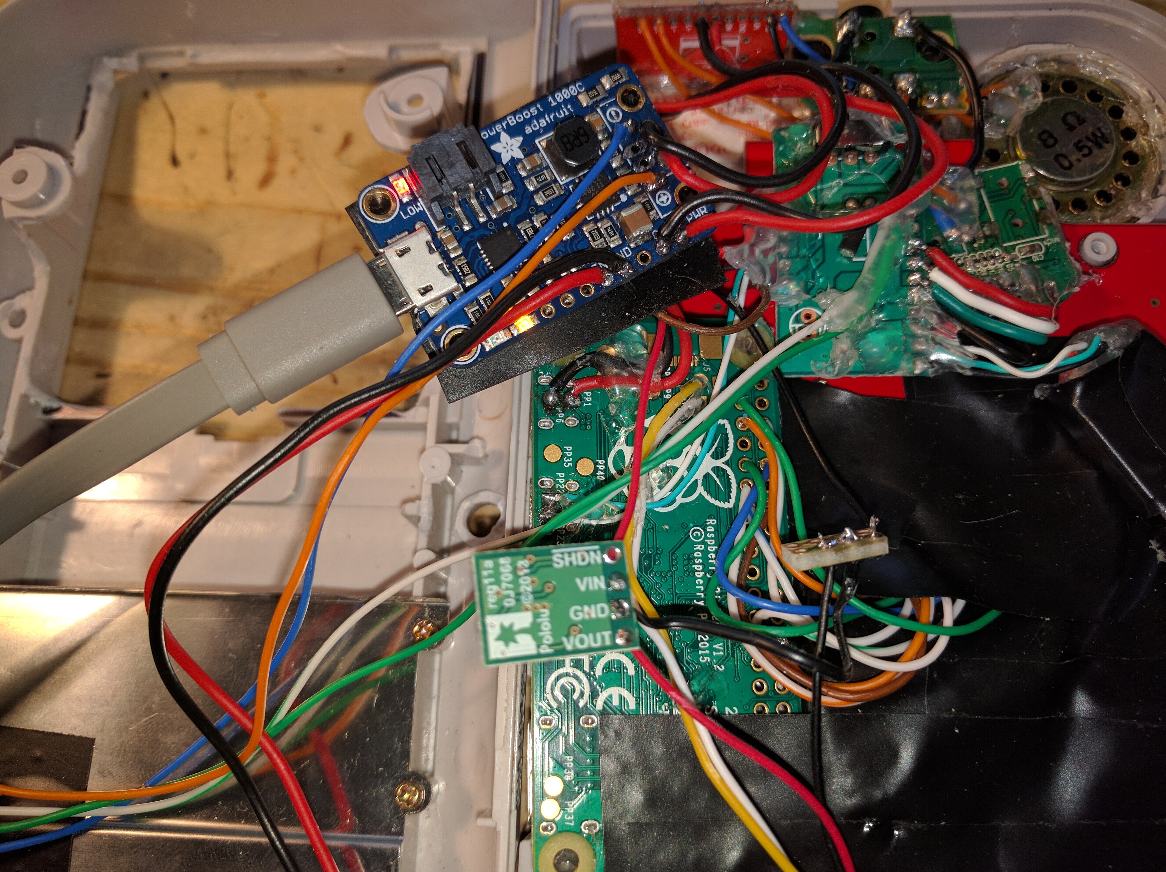

I cut both my red 5v wire and my ground going to my screen to my breakout board. I then solder the components like you see in the picture:
VOUT --> Red wire to screen
VIN --> Red wire to breakout board
Gound --> Black wire to GND solder point (the wires are solder together)
I get a LOW light on my PowerBoost and the screen never comes on.
There is a SHDN connection on the 12v jumper but I do not know what that means.
Any ideas [mention]popcorn[/mention] or [mention]Fleder[/mention]?

dirtybeagles wrote:Well, I either did not set up my 12v jumper up properly, or I am hosed :oops:
From the Pololu Website
The SHDN pin can be driven low (under 0.3 V) to turn off the output and put the board into a low-power state that typically draws 20 μA, and it can be driven high (above 2.3 V) to enable the board. If you do not need to use the shutdown feature, the SHDN pin can be directly connected to VIN to permanently enable the board. You should not leave this pin disconnected as this can result in unpredictable behavior.

Post by dirtybeagles » Thu Jun 02, 2016 9:37 am
_N0x wrote: From the Pololu Website
https://www.pololu.com/product/2106
Not really sure what that means. I can try to solder VIN and SHDN together with the same piece of solder. Correct?
_N0x
Posts: 29
Joined: Mon May 09, 2016 3:02 am
Location: Germany - Hessen - Siegbach
Post by _N0x » Thu Jun 02, 2016 9:43 am
dirtybeagles wrote:Not really sure what that means. I can try to solder VIN and SHDN together with the same piece of solder. Correct?
I guess. I think the SHDN pin is for shutting down the outgoing pin if no Vollage is applied. But you are using the PowerBoost for shuting down everything. Right? So connecting SHDN and VIN should bridge that.
