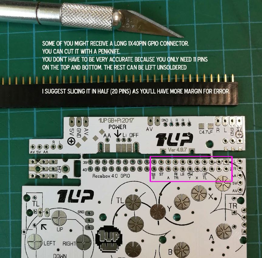

Hi everyone, I've meddled with this kit for abit and gotten alot of feedback regarding the guide. Basically there's alot of things the guide wasn't so clear, and even I am not that clear in the beginning. I didn't get right the first time and I'm back to right some wrongs with this new guide. As you know 1up is a chinese company and culturally, they aren't very western thinking. They have been bootstrapping constantly and some of you buying from them will realize they'll give you items that's different from their guide.
I have been bitten quite a bit with some of these issues, so I did a community edition guide for all of you guys who are having problems and also help with understanding what you're actually doing.
The guide will keep on improving as more tips and tricks come up.
https://www.dropbox.com/s/hldjtmignz73h ... 1.pdf?dl=0
next version will have wiring regarding the voltage drop when you use AA batteries to power the board.
Here's some insert previews for people who have the slightly older guide.

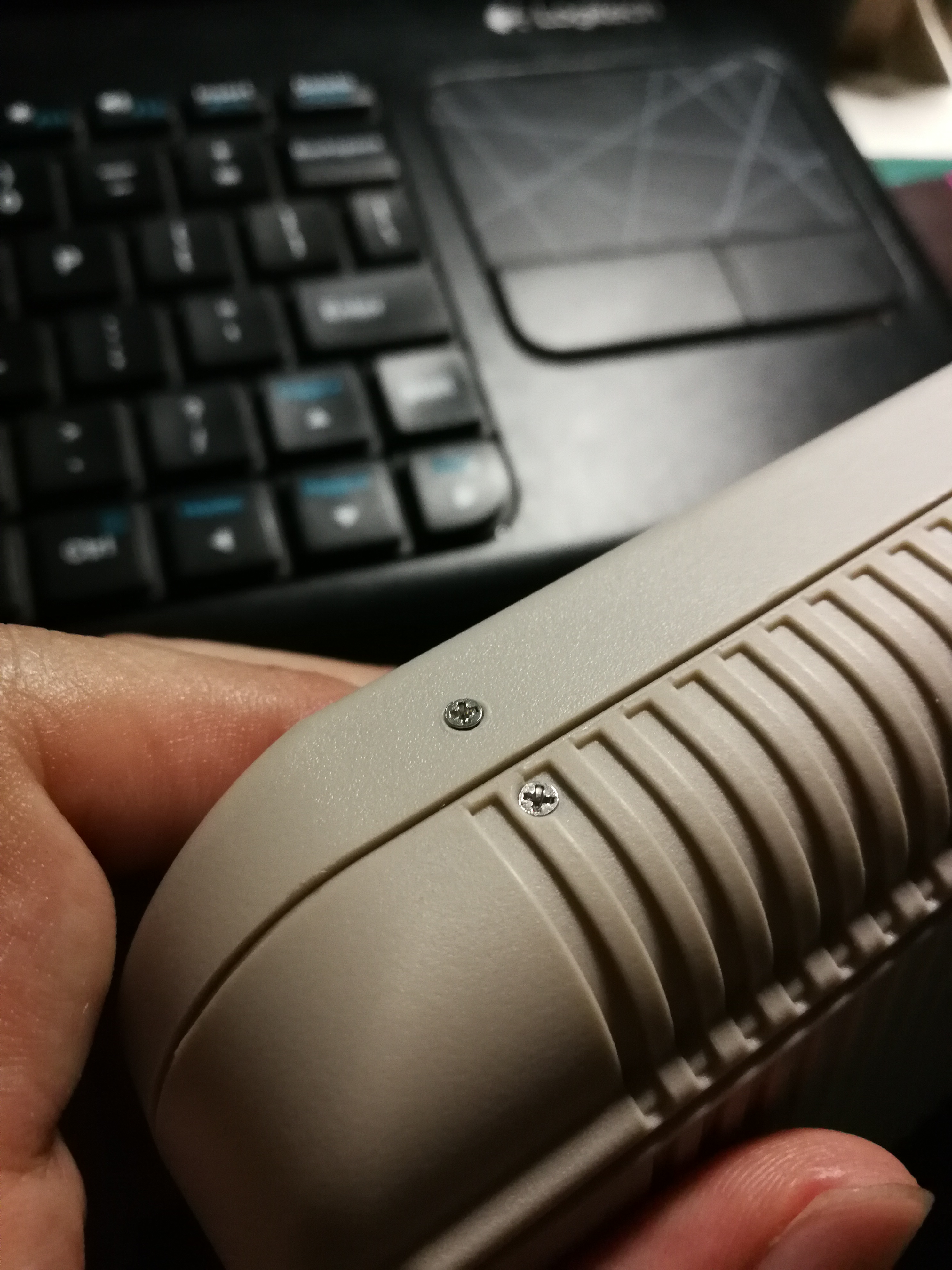

secondly... this i appricate is a must in the build (until someone comes up with another solution) is the screws that allow the case to be secured together....
one fix i thought of for these would be some sort of cap
i doubt it that your gonna find caps for screws that small, but that doesnt mean a cap cant be 3d printed...
if done correctly....
they could match the colour of the case/shell
or contrast with or against the button
its not ideal, but would/might make it look alot cleaner

As for the screws, I bought another GB and i'm opening up to check how he did the screws.
If i can do that, i think it would be much preferable.
