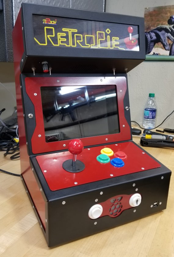

VeteranGamer: Thanks for the reply. I actually bought one of Camble's switches the other day. It hasn't arrived yet. I do agree about kids probably being more interested in the games than messing with the power switch but I guess another reason for wanting a "hold 5 seconds" is so it doesn't accidentally turn on or off if I have it in a bag or something. After finishing my last bartop build (see attached image), my 3 and 5 year olds loved playing the games, but during the load screens they would flick the toggle switches. Of course these switches are pretty inviting to be flicked in the position they are in, so I was just thinking of curing this problem on the front end since it would be harder to add this switch mod later to an aluminum case. I'll do some more digging to see what I can come up with. VeteranGamer, your builds are great. Your's along with other great builds on here have given me the inspiration to start this project.
