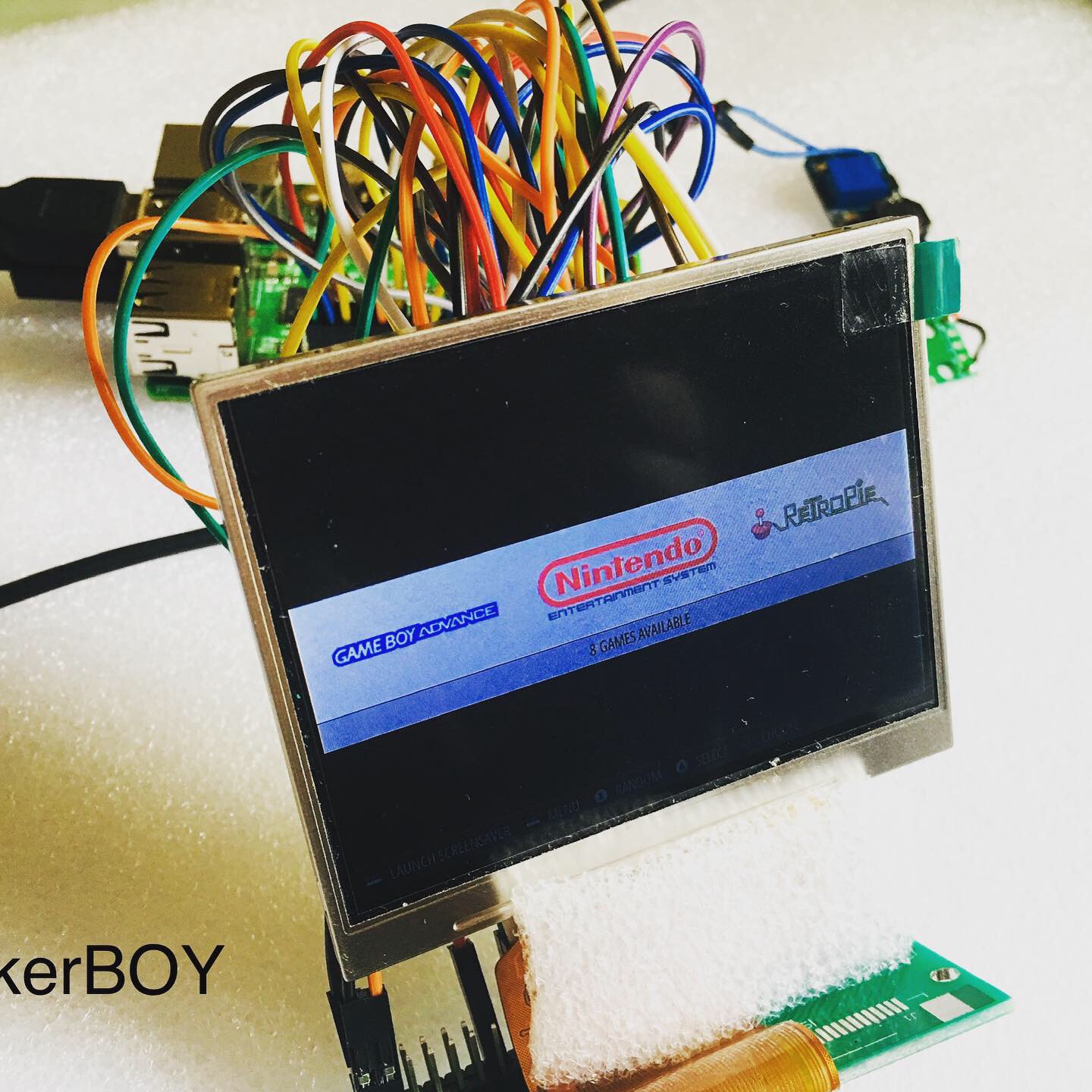

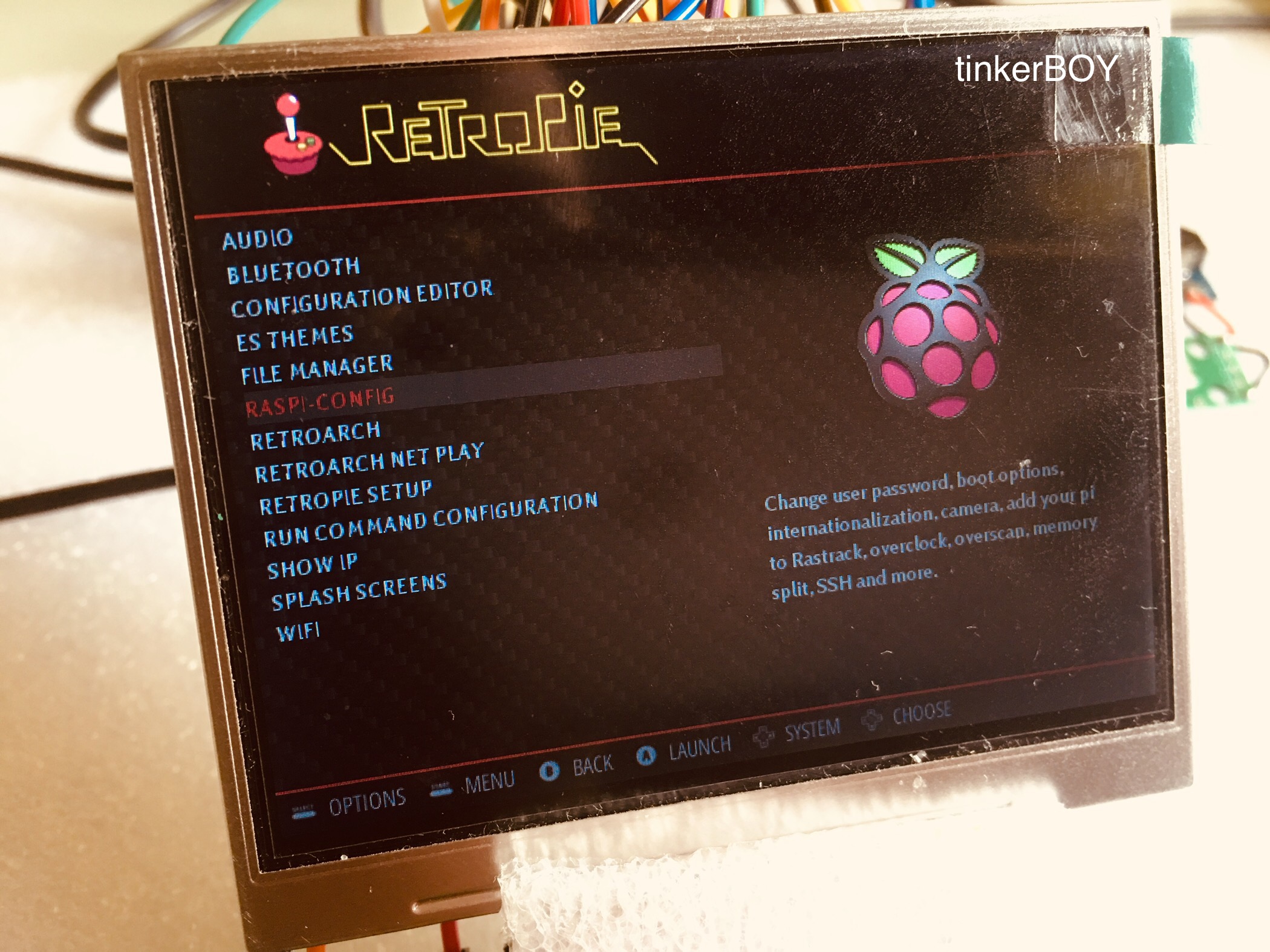

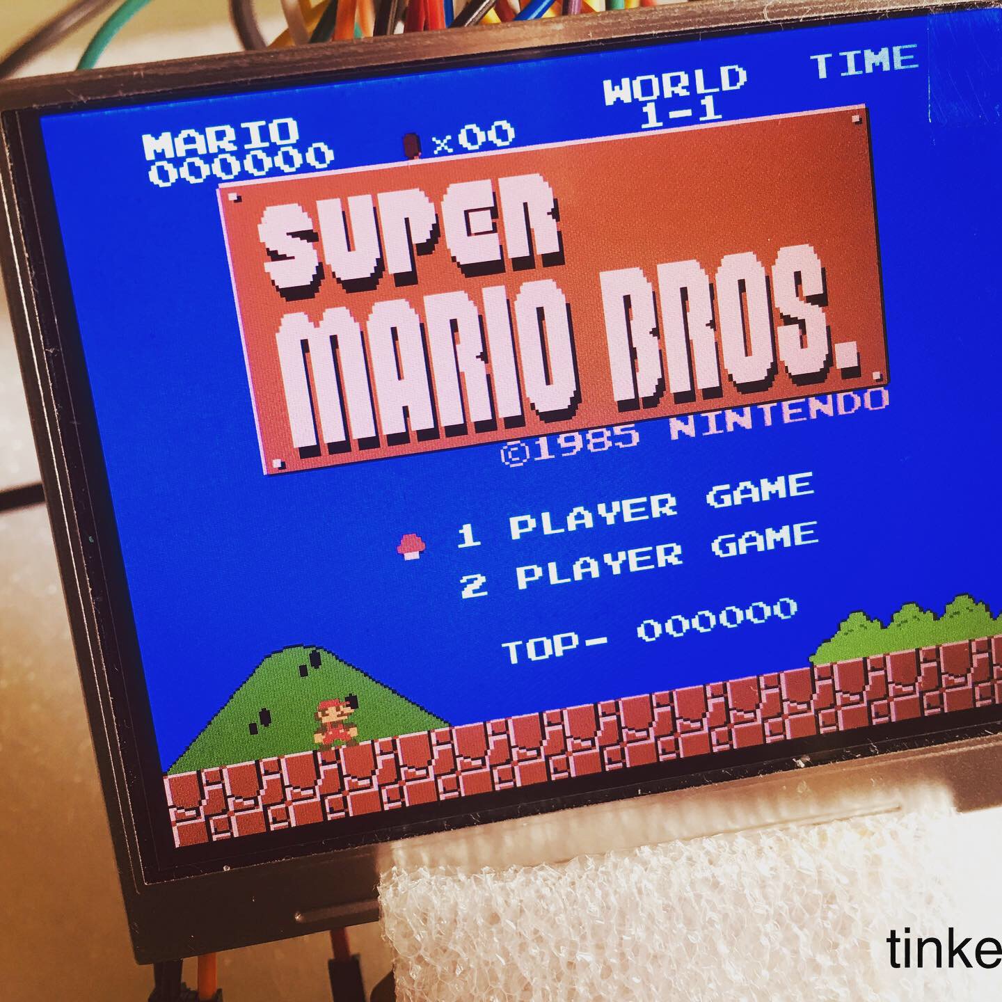

Testing a new 3.5” 640x480 IPS DPI LCD
Post by tinkerBOY » Thu Aug 29, 2019 3:27 am
Im super super excited to test this beauty! It’s a new 3.5” 640x480 IPS LCD. It’s super sharp and clear. These photos i took from my iPhone doesn’t really do justice.

Nice !
54 pins ? compatible with your DPI adapter ?
Yes 54 pins and works great with my dpi adapter.
