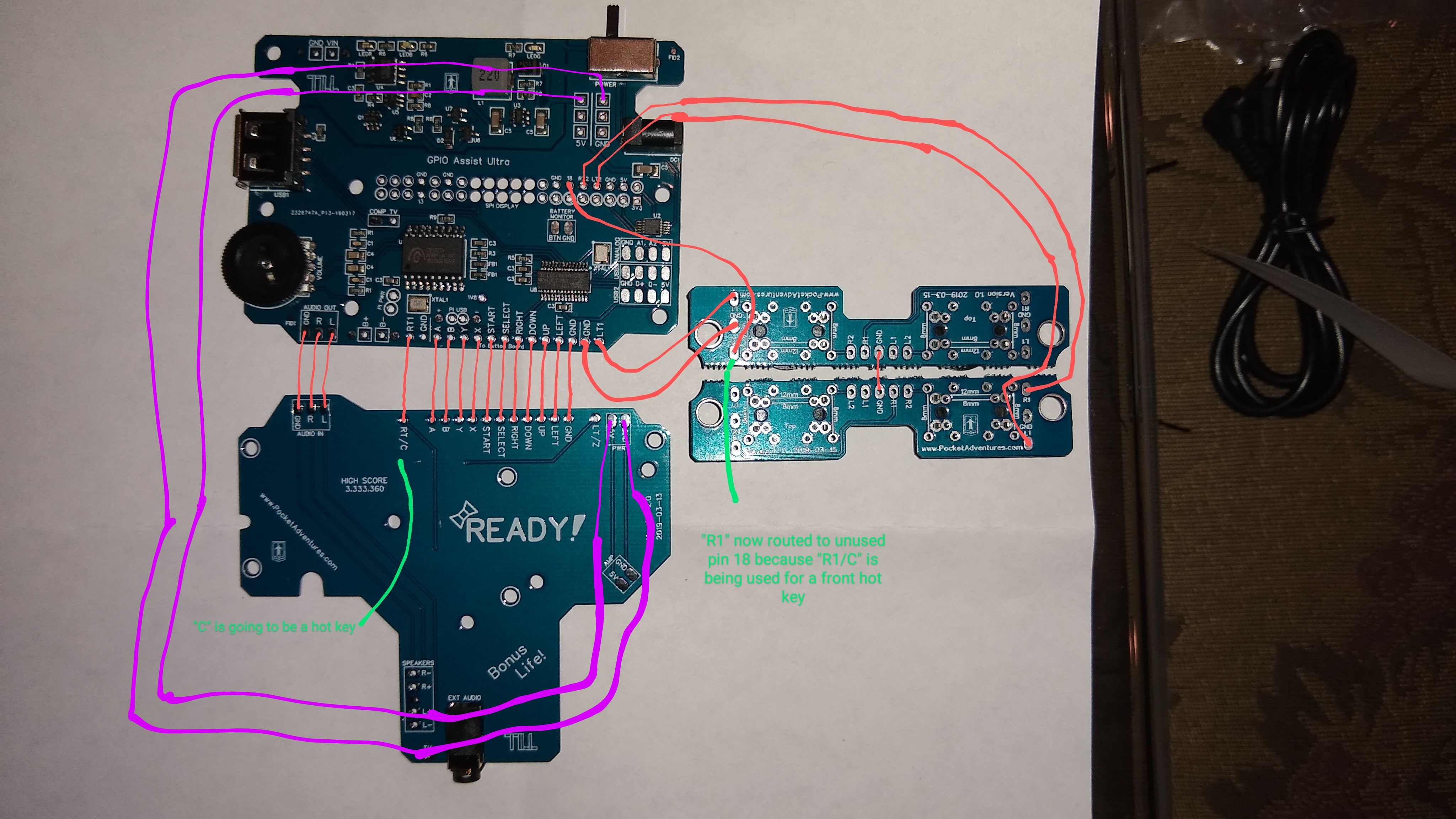

I am working on my first Gameboy Zero. I have done a couple Raspberry Pi emulation boxes (3b+ and 4) but this is my first project ever with soldering. I got my components from Pocket Adventures and I am trying to plan out everything. Unfortunately, while I really like the parts, the documentation isn't great and I'm kinda floundering on whether or not I'm thinking this through correctly.

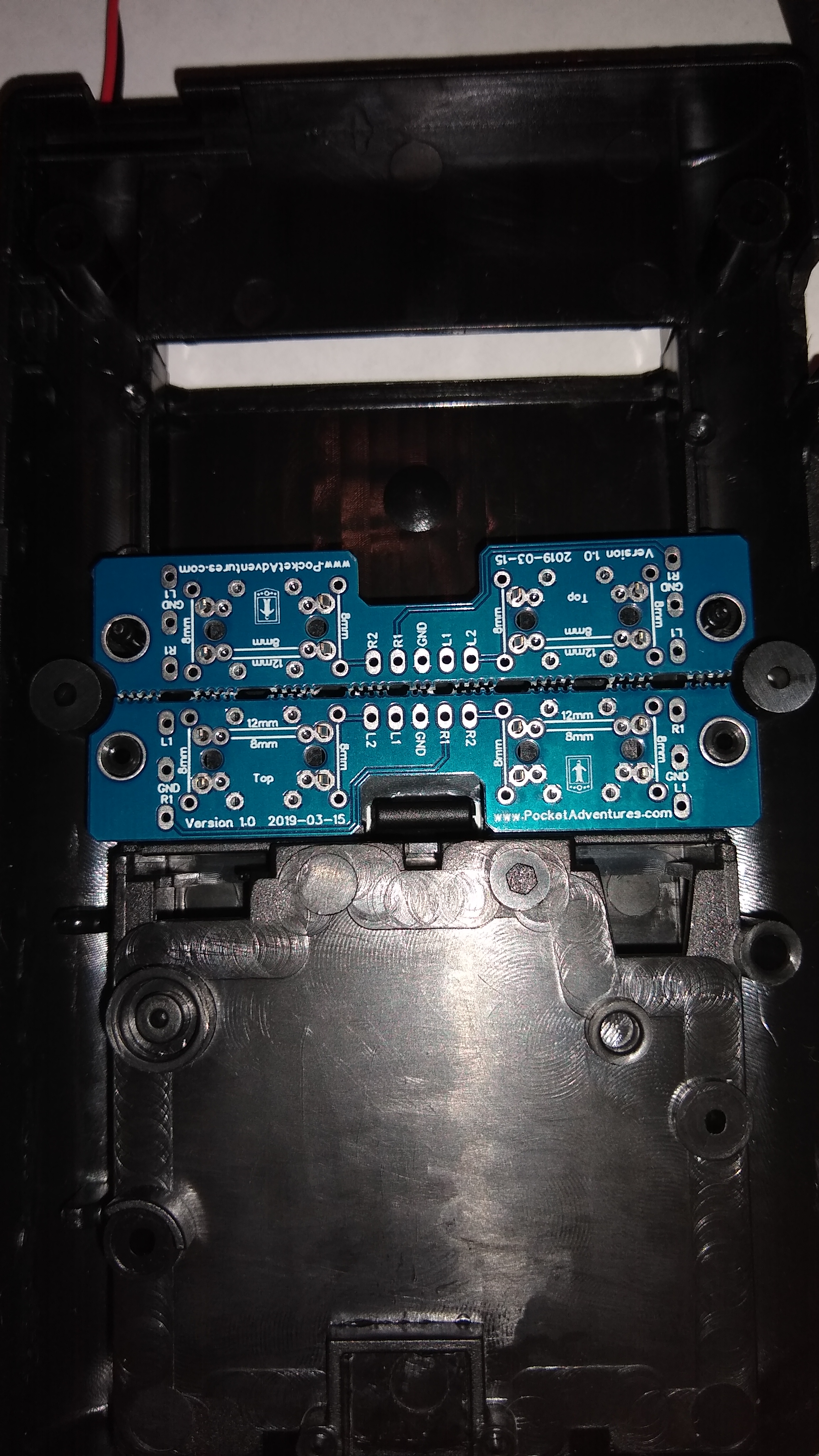

I want to put 4 buttons on the back (attached picture on placement). I am also using the R1/C connection for the C button on the front and will set it up as a hotkey, so I am routing R1 to an unused GPIO pin 18. I believe this will work, if not I believe I could use pin 7 or 13.
If someone could tell me if I'm on the right track, I'd appreciate it. Sorry about the goofy colors on the pictures, it stood out on my phone, but my not look as good posted here.

yep - looks like you are doing it right. you don't need the 5v power to the button board (theres nothing powered on there - that connection is in case you need an amp, but there is already one on the other board - just wire the buttons and the sound). you will also need to solve for the display (i would recommend a composite one if you want to avoid issues trying to get the spi display working).

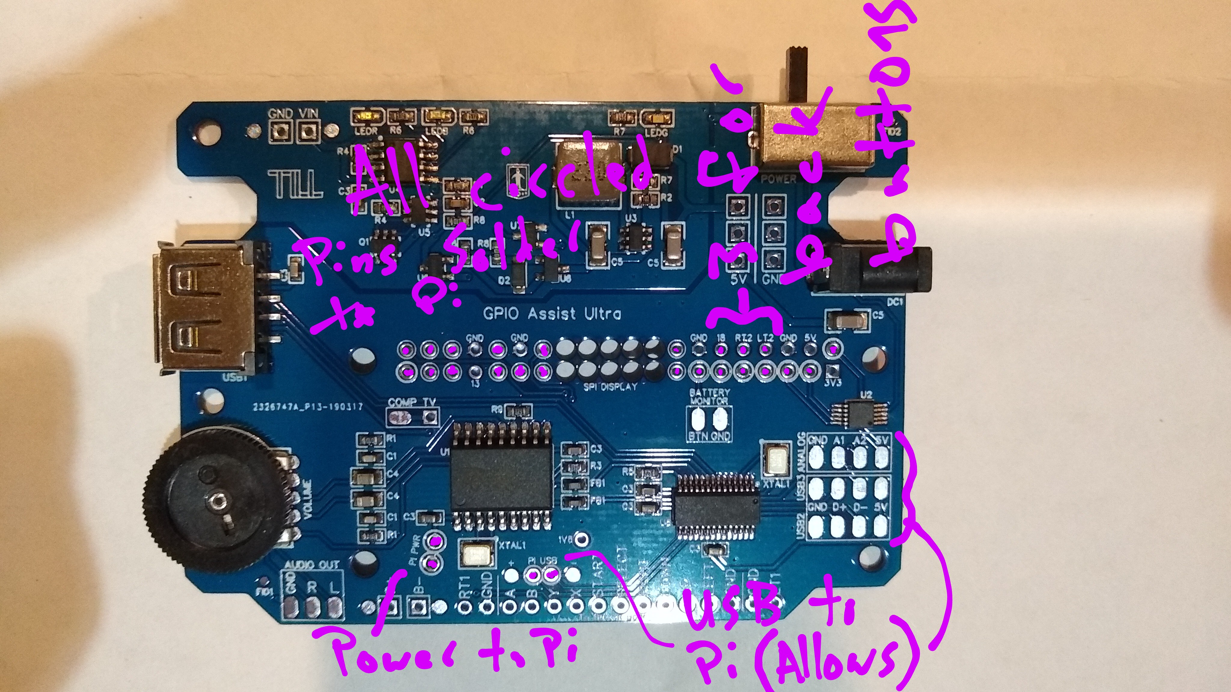

I got ahead of myself on soldering the GPIO assist board and the pi zero together and had to undo that last night. Pi still works after testing. Need to clean up the assist board and then clean all the extra flux off them then try again. If I'm soldering GPIO through-holes should I be using header pins or can I just use solder (watched a bit of Helder's soldering a minty pi video but he's soldering to pads instead of another through hole.

you don't need header pins for it. i usually used some screws and nuts to line up the boards, or you can screw them into the bracket, to line them up. do the usb ones first, and check that you haven't bridged it, since that's the easiest thing to mess up. then just do one side (the circled ones are the only required ones), and flip it over and check the other side, and add a little solder or just heat it up to flow it, and that should do it. you don't need a lot of solder, so its better to under do it, then over do it and have to try and get it apart again.

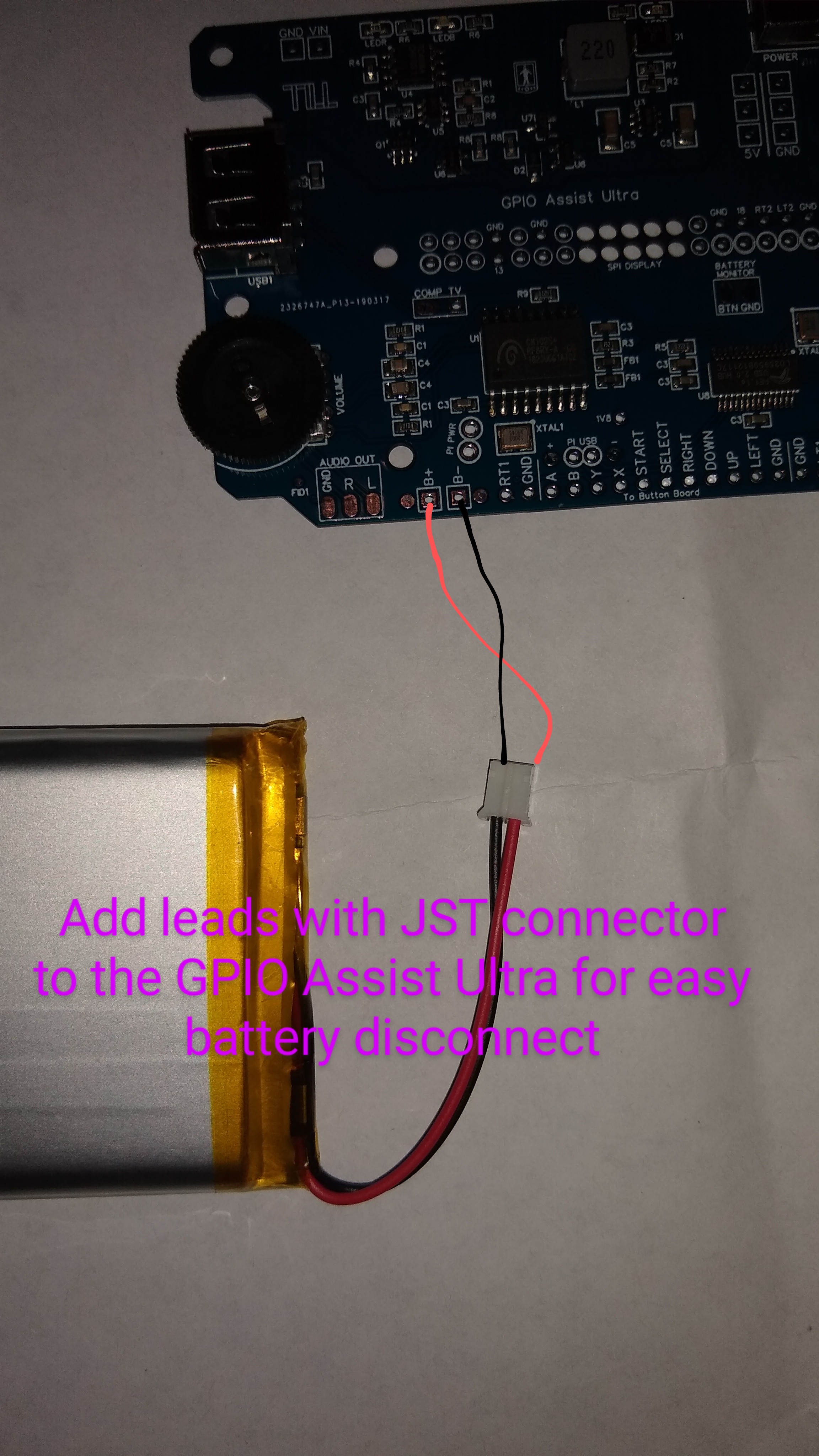

It's soldered together and the screen works, played a bit of SMB 3. I already screwed up the USB pads on the pi so I'm going to be plugging a micro USB into the port and soldering the leads to the USB hub on the assist board. The owner over at pocket adventures said this should work.
I am concerned about the pi not booting all the way when powered by the barrel jack. It reboots right after the retro pie splash screen goes up instead of running through the final boot list and starting emulation station. I'm hoping it's because I have not hooked the battery up to it yet. It boots without issue when I plug power into the pi directly.

yes, that's normal. it needs the battery to operate. it can't only run off the charging port, or it tends not to have enough current. the battery powers the pi and other components, and the barrel jack recharges the battery.
