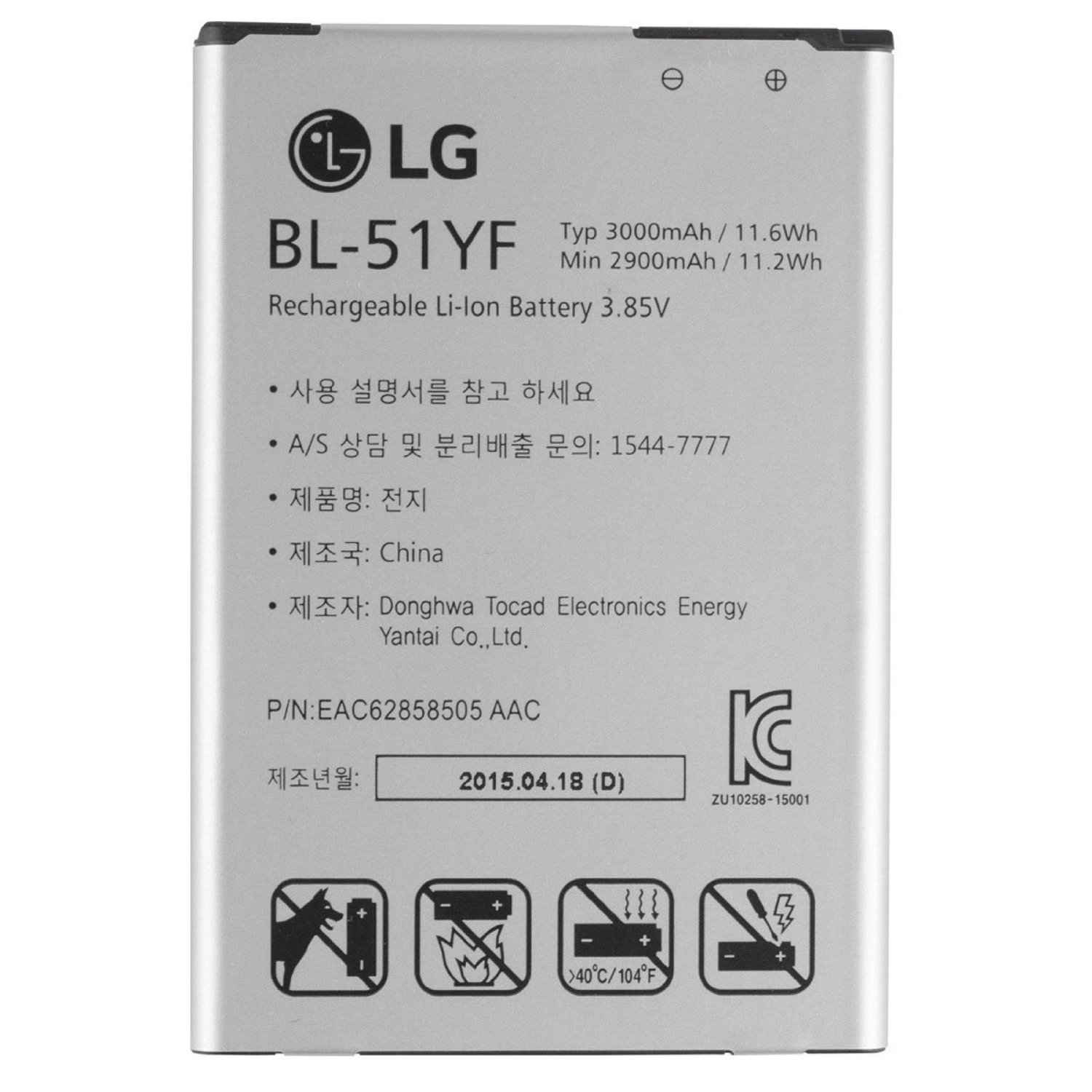

Hi @ All,
Is it possible to use glue instead of soldering to minimize the heat?? Maybe use tape band to fix the wire onto the pads?
I got a battery of a LG G4 Phone with 3000mah :shock: i would be happy if i ca use this Battery with the Powerboost 1000c.
Greetz
