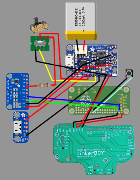

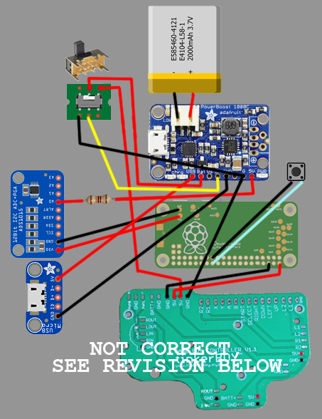

Post by Talc » Mon Dec 31, 2018 12:02 am
*EDIT: see the revisions below for a better diagram
Thank you to everyone above for the diagrams and discussions. I'm not sure if this should go in it's own post under support, but I am piecing together my first build and am wanting to include an ADS1015 with HoolyHoo's battery monitor script. I think I have figured out how to add this in with my other parts, but was wondering if someone could look at my diagram and let me if it looked like it would work. The post above by hueblo helped me out a lot, but as I'm not using an "all-in-one" board or camble's board, I still have some spots I'm unsure about.
Thanks in advance!
I think this configuration of parts may be common, so hopefully this will help other people as well.
Re: On-Screen Battery Monitor Options
Post by rodocop » Mon Dec 31, 2018 7:36 am
I notice a few things with you diagram. The ads needs battery voltage to a0 not 5v like seen. Also your dpdt switch, you only need en and ground you do not need to switch bat power to the pi. (Grounding EN turns the powerboost off).
I would wire en and ground as you have, and then wire bat + to the other side of the switch then to a0, that way the battery will be cut off from the ads when the switch is off.
Also, sda and scl on the ads need to go to the pi's gpio's.
I also reccomend a power strip. Run 5v and ground to the power strip, then power all components from that power strip.
Post by Talc » Mon Dec 31, 2018 1:35 pm
Thanks rodocop! I updated the diagram per your review above and based on doing more research on the adafruit website. Also, I decided to pull the vdd and ground for the ADS1015 from the USB connector pads of the Powerboost (Like how hueblo did it).
For the power strip, is there any difference between running 5v and ground to a power strip and running 5v and ground to the common ground board?
Thanks again for the support.
Post by rodocop » Mon Dec 31, 2018 1:38 pm
I guess tinkerboys board has a built in power stip kinda. Just run 5v and gnd to his board. And power components from the various 5v and gnd pads . Or add a standalone power strip. Up to you.

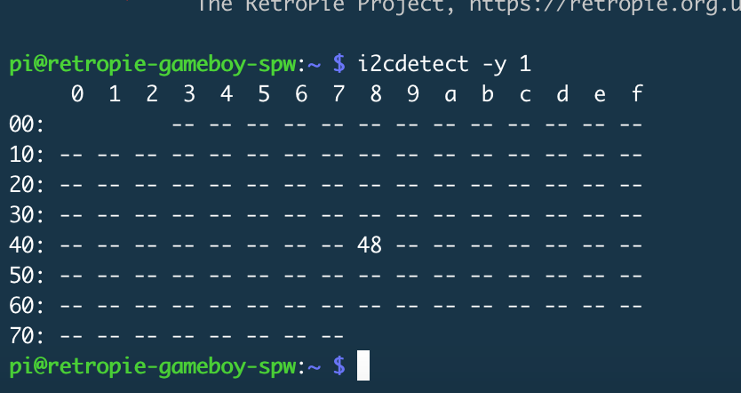

I have tested with both usb only and battery only. During the tests, the system did randomly shut down twice, which makes me think that something is happening behind the scenes.
if I connect to the usb and run i2cdetects -y 1 I get the following, not sure if this means anything:
Screen Shot 2019-05-14 at 3.10.02 PM.png (55.7 KiB) Viewed 8725 times
Post by rodocop » Tue May 14, 2019 5:41 pm
Hmm. I would try to bypass the a0 on the pcb. Try wiring a0 on the ads1015 direct to the b+ out on the tp4056 and see if that helps. Is there any other scripts running that might be causing interference?
Also, can you confirm, are you using an ads1015, or 1115, since the 1115 would need modification to the script too.
