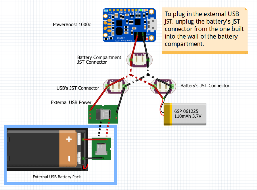

dirtybeagles wrote:I am taking my portable power brick that will connect to my GBPi and play off that external battery.
So does that mean the Powerboost can power the device via USB without having a battery attached?
Yes, you need a separate connection. See here: http://www.sudomod.com/forum/viewtopic. ... 5&start=30 or here: http://www.sudomod.com/forum/viewtopic. ... 3&start=30

I'm planning to use the original charger port with an adapter and connect this only to the Powerboost while adding a USB port to helder's AIO PCB for data, without the powerlines.
If I use the connectors like you did, I could take out the LiPo but still use external power as it goes directly to the Powerboost, correct?

dirtybeagles wrote:
Thanks! What I can't entirely tell is how you have both the battery's JST/USB and the external power JST/USB hooked up at the same time. Do you have to switch out which one is connected? I'm wondering if maybe I should do the extended JST connector to the battery compartment like you did, and then connect the USB/JST through that when I need it.
Here's a diagram of what I'm thinking
Power setup.png (41 KiB) Viewed 30773 times
My wiring diagrams and schematics for Helder's boards and graceful shutdowns.
