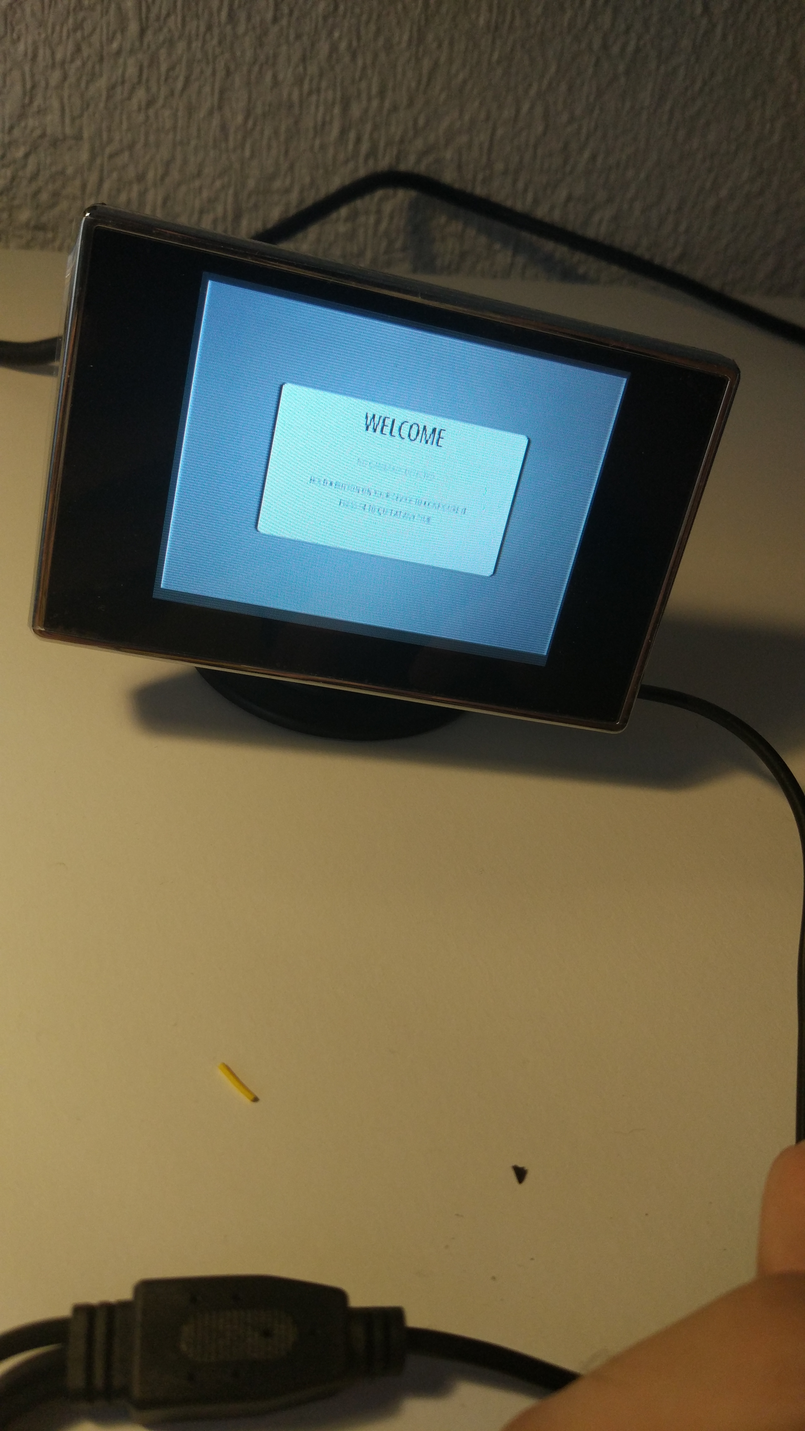

And the screen its alive :D. But the quality of the screen... i think its because 640x...i will should setup the resolution.

I have a problem The thing is that the screen does not look good and I think it is due to the resolution. . How can I set the resolution of the Simpler Way? The screen should show 320x240
Thank

@sckay
It looks like you need to use overscan in the config.txt file to get your screen to display everything correctly.

Can you said me, how can do this?
I have that in config. :
# For more options and information see
# http://www.raspberrypi.org/documentatio ... fig-txt.md
# Some settings may impact device functionality. See link above for details
# uncomment if you get no picture on HDMI for a default "safe" mode
#hdmi_safe=1
# uncomment this if your display has a black border of unused pixels visible
# and your display can output without overscan
disable_overscan=1
# uncomment the following to adjust overscan. Use positive numbers if console
# goes off screen, and negative if there is too much border
#overscan_left=16
#overscan_right=16
#overscan_top=16
#overscan_bottom=16
# uncomment to force a console size. By default it will be display's size minus
# overscan.
#framebuffer_width=320
#framebuffer_height=240
#hdmi_force_hotplug=1
# uncomment to force a specific HDMI mode (this will force VGA)
#hdmi_cvt=320 240 50 3
#hdmi_group=2
#hdmi_mode=87
#hdmi_drive=2
# uncomment to force a HDMI mode rather than DVI. This can make audio work in
# DMT (computer monitor) modes
#hdmi_drive=2
# uncomment to increase signal to HDMI, if you have interference, blanking, or
# no display
#config_hdmi_boost=6
# uncomment for composite PAL
#sdtv_mode=2
#sdtv_aspect=3
#uncomment to overclock the arm. 700 MHz is the default.
#arm_freq=800
# Uncomment some or all of these to enable the optional hardware interfaces
#dtparam=i2c_arm=on
#dtparam=i2s=on
#dtparam=spi=on
# Uncomment this to enable the lirc-rpi module
#dtoverlay=lirc-rpi
# Additional overlays and parameters are documented /boot/overlays/README
# Enable audio (loads snd_bcm2835)
dtparam=audio=on
gpu_mem_256=128
gpu_mem_512=256
gpu_mem_1024=256
#overscan_scale=1
