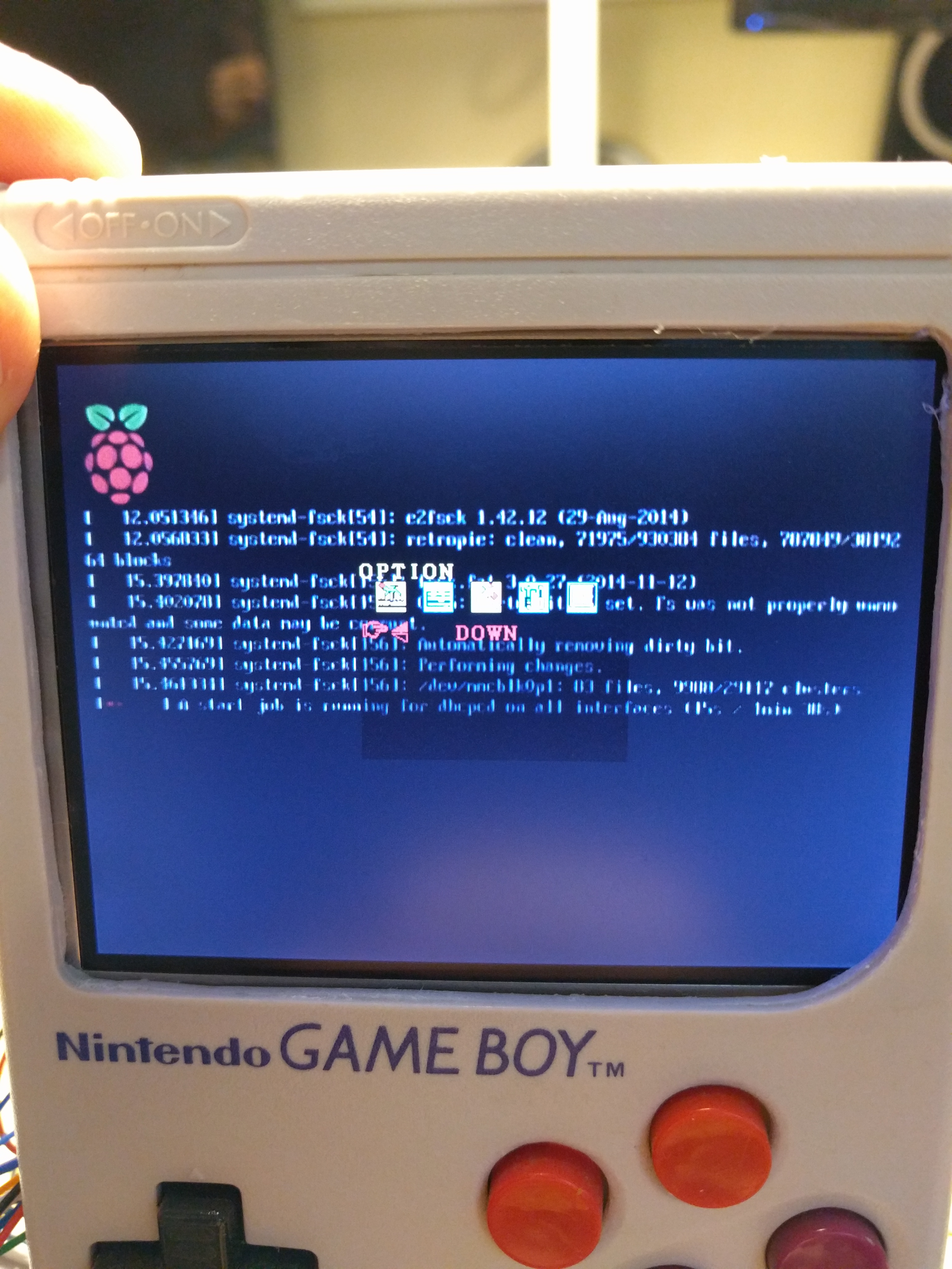

Just FYI... not sure why it makes a difference but I had to connect the pi0 to my breakout board instead of the power boost

dirtybeagles
Posts: 386
Has thanked: 34 times
Been thanked: 64 times
Re: Full VGA resolution (640x480) 3.5" display, composite in
Post by dirtybeagles » Fri Jun 10, 2016 5:54 am
Cannikin wrote:[mention]Mad_Duke[/mention] and [mention]dirtybeagles[/mention] you only need display_rotate=2 if you mount your screen "upside down" (ribbon cable at the top). If you can mount it with the ribbon cable at the bottom then no need to rotate at all. :)
I have this option on my display.. it seems to rotate the screen natively so I don't have to make any change to the config on the pie.

dirtybeagles
Posts: 386
Post by dirtybeagles » Fri Jun 10, 2016 6:29 am
Cannikin wrote:Nope, any 5V connection on the control board is the same 5V so you only need to hook up one.
I actually did end up coming OUT of the 5V GPIO on the Pi and it works great!
Question on this. Do I have to do anything special is I connect the 5v and GND from the VGA to the pi0? I am having some strange issues with the VGA connected to the powerboost with flickering on the screen. I am thinking it may have something to do with my amp (still waiting on the adafruit one, because I think my current amp is using to much amperage).
I assume you just take 5v and GND and solder those wires to the pi0? Thats it? I do not have to run another GND wire from the PI0 to the powerboost?
