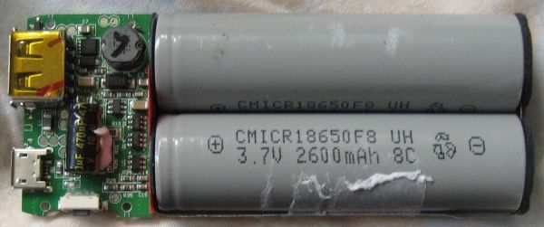

I have bought a couple to try. One is an Anker Astro E1 5200mah.
https://www.anker.com/products/A1211012
I've pulled it apart, which wasn't easy as it was very well built, and it looks like it will work nicely. Has 4 blue leds to show the power level too. Also has lots of protection circuits so should be a safe one.
This is what was inside:
Will use it in a future build.
Hah that's funny. That's the exact same battery that I already have. I'd buy the 10k or 20k mAh version for this though.

Post by Zero » Mon Sep 26, 2016 9:29 am
You might be able to fit 4 of these batteries in a gameboy case at a squeeze, but no more unless you're a wizard at space management, they're quite large.
