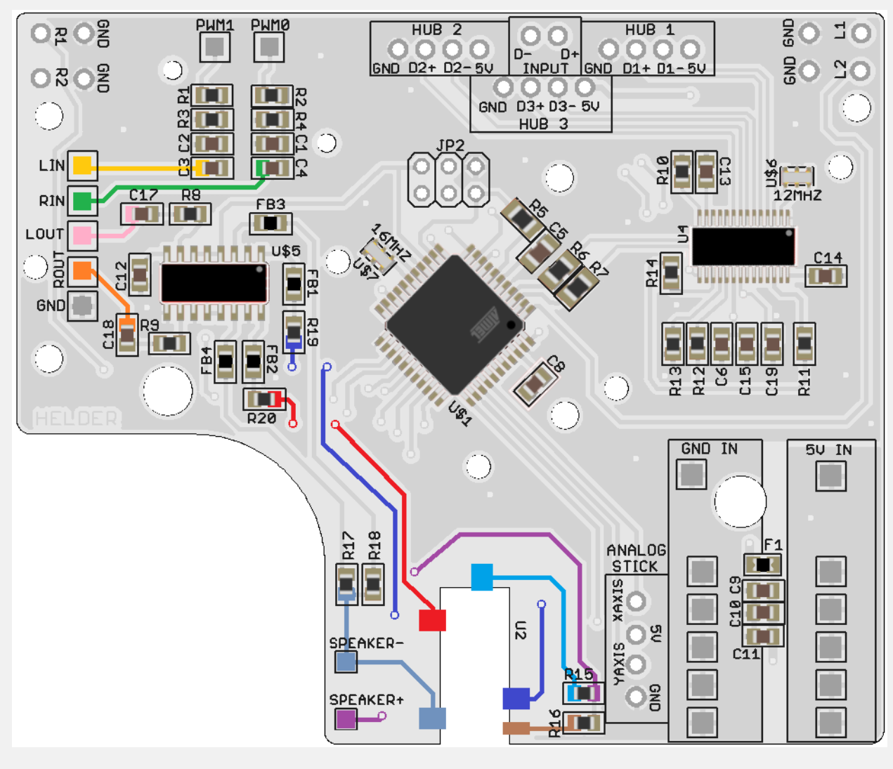

Should be able to fix this. I did the same on 2 of the volume potentiometer pads.
@helder sent me the below with the audio traces so I just followed them and soldered directly to the relevant components.
Same would apply to PWM pads see below:
