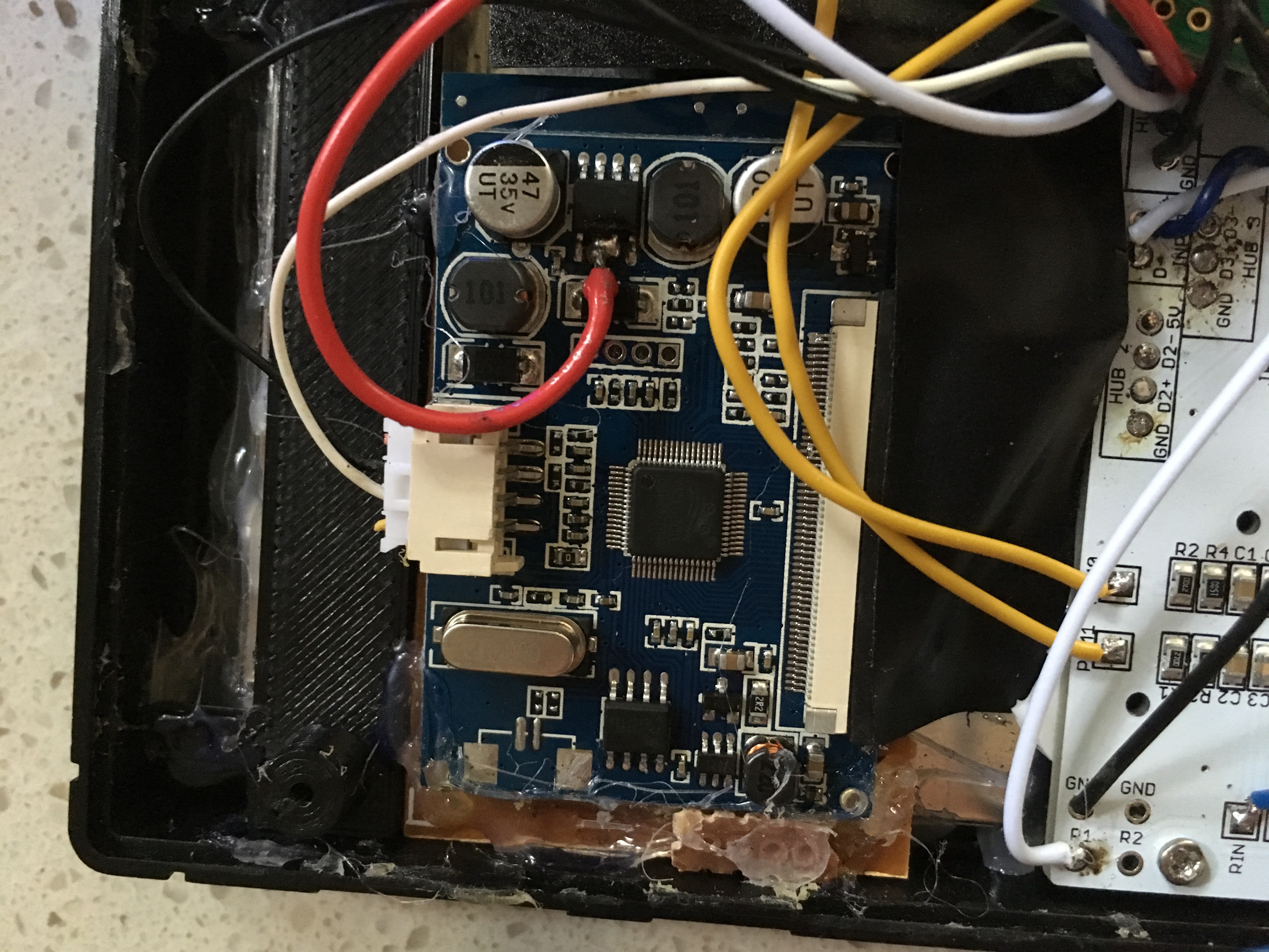

Your images don't seem to load, but if it's a recent gearbest purchase than it's likely the same board that I received. It actually works fine with 5V out of the box. Test yours out and see.
If you do want to modify it to skip the regulator (can make it a bit more stable + more efficient with power, not having to change 5V to 5V) then the board has an IC that has "XL1509" written on it, that's the DC converter which takes the input and converts it to 5 volts. Here is the datasheet for that chip => http://www.xlsemi.com/datasheet/XL1509%20datasheet.pdf
You essentially want to put your 5v into the output of that chip, which is the 2nd pin from the small divet in that chip. Essentially bypassing the chip alltogether. Hope that helps :)

That's the one, i've attached a photo of where you should put your 5v in. Although like I mentioned before the screen did work fine for me without the modification, so try that first; I only modded mine to debug an issue which turned out to be something else anyways.
The screen won't turn on without a valid composite signal, so be sure to wire it to the pi's tv pin first before trying this mod.
In my photo you can see that the 2nd and 3rd pins are bridged, that's not on purpose but doesn't matter anyways. You should aim to get 5v to the 2nd pin only if you can :D The 2nd pin is the 2nd one across from the little divet in the chip.
