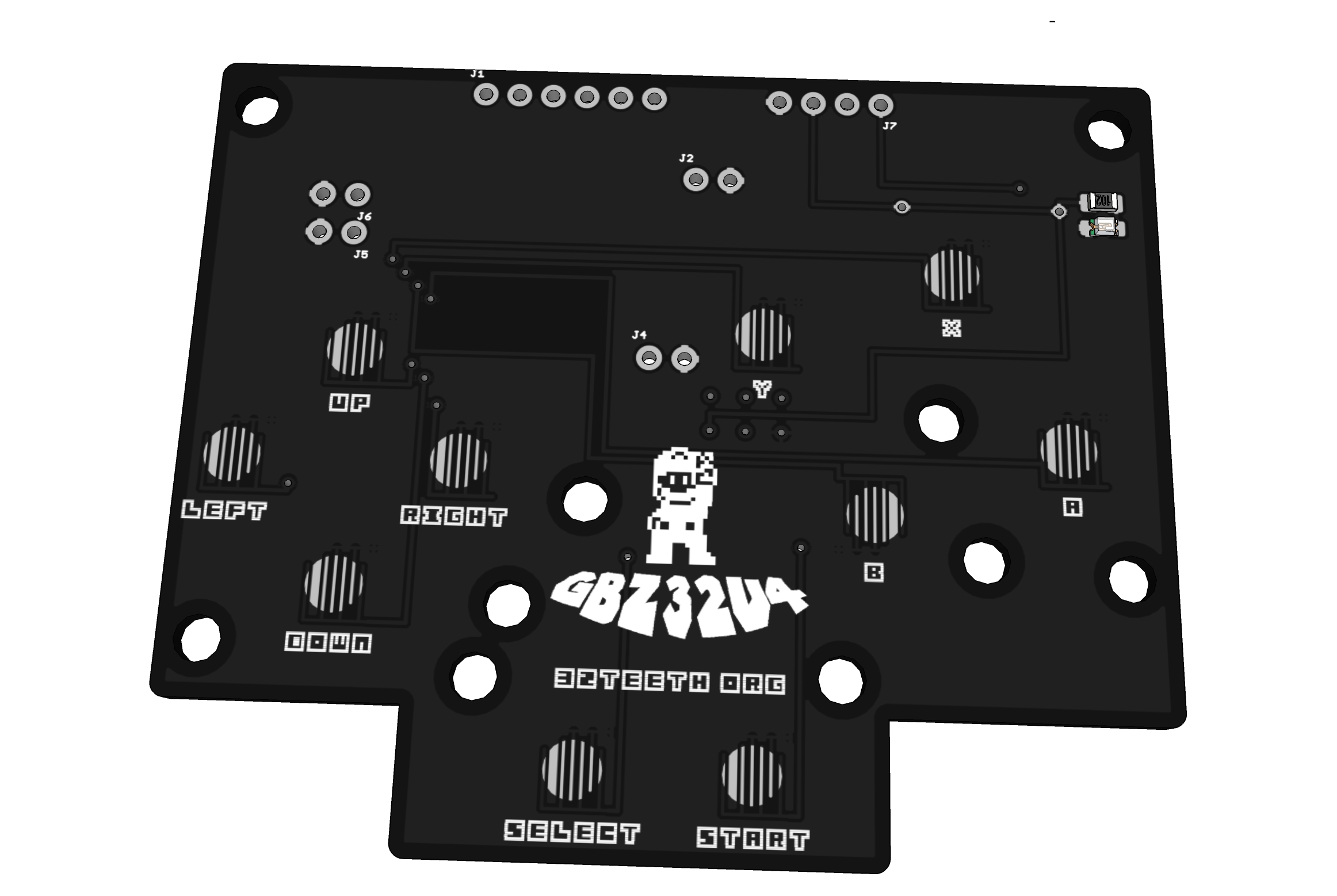

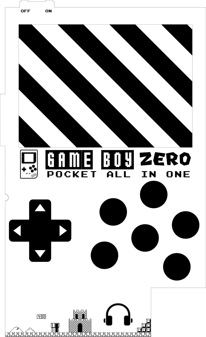

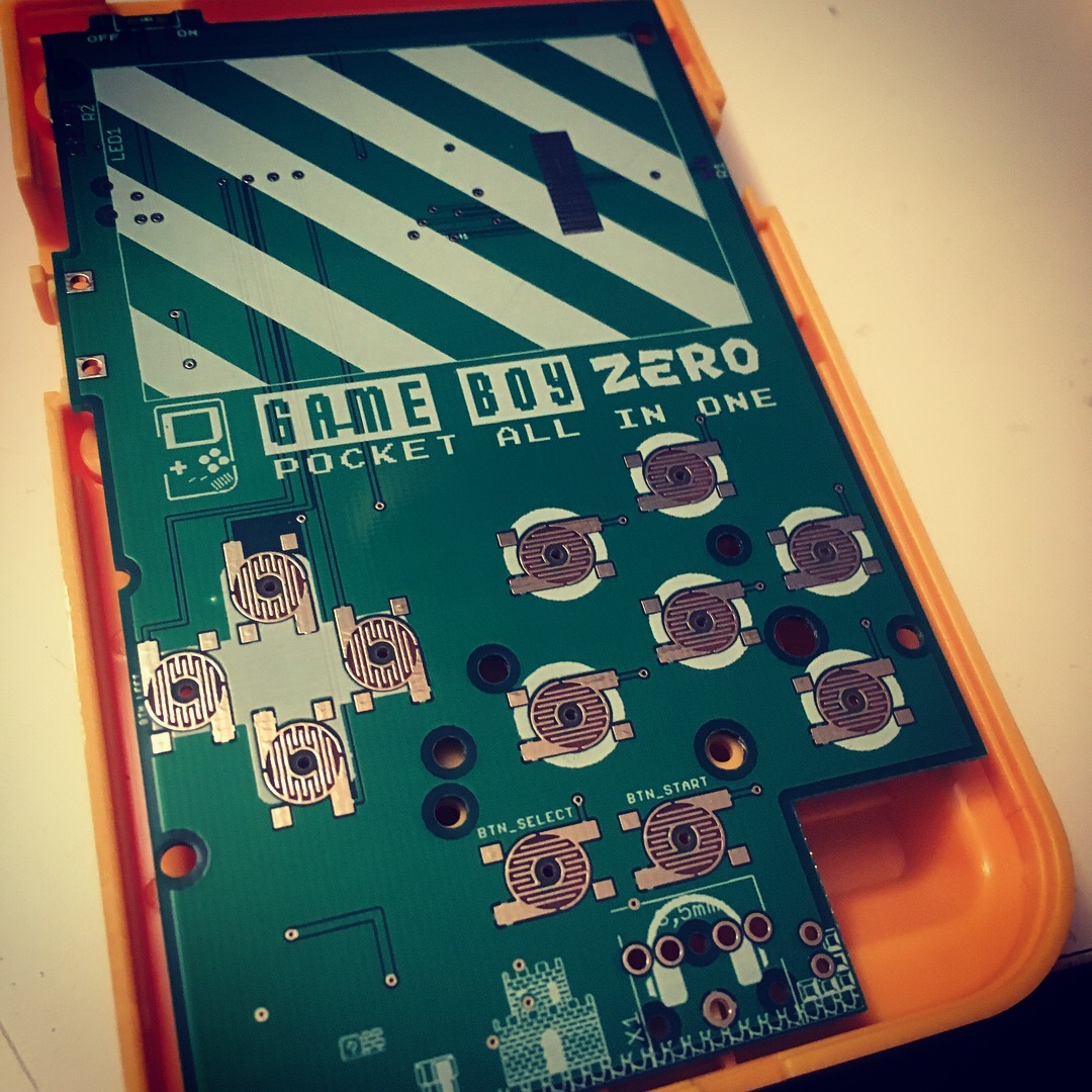

Post by 32teeth » Thu Mar 16, 2017 10:02 am

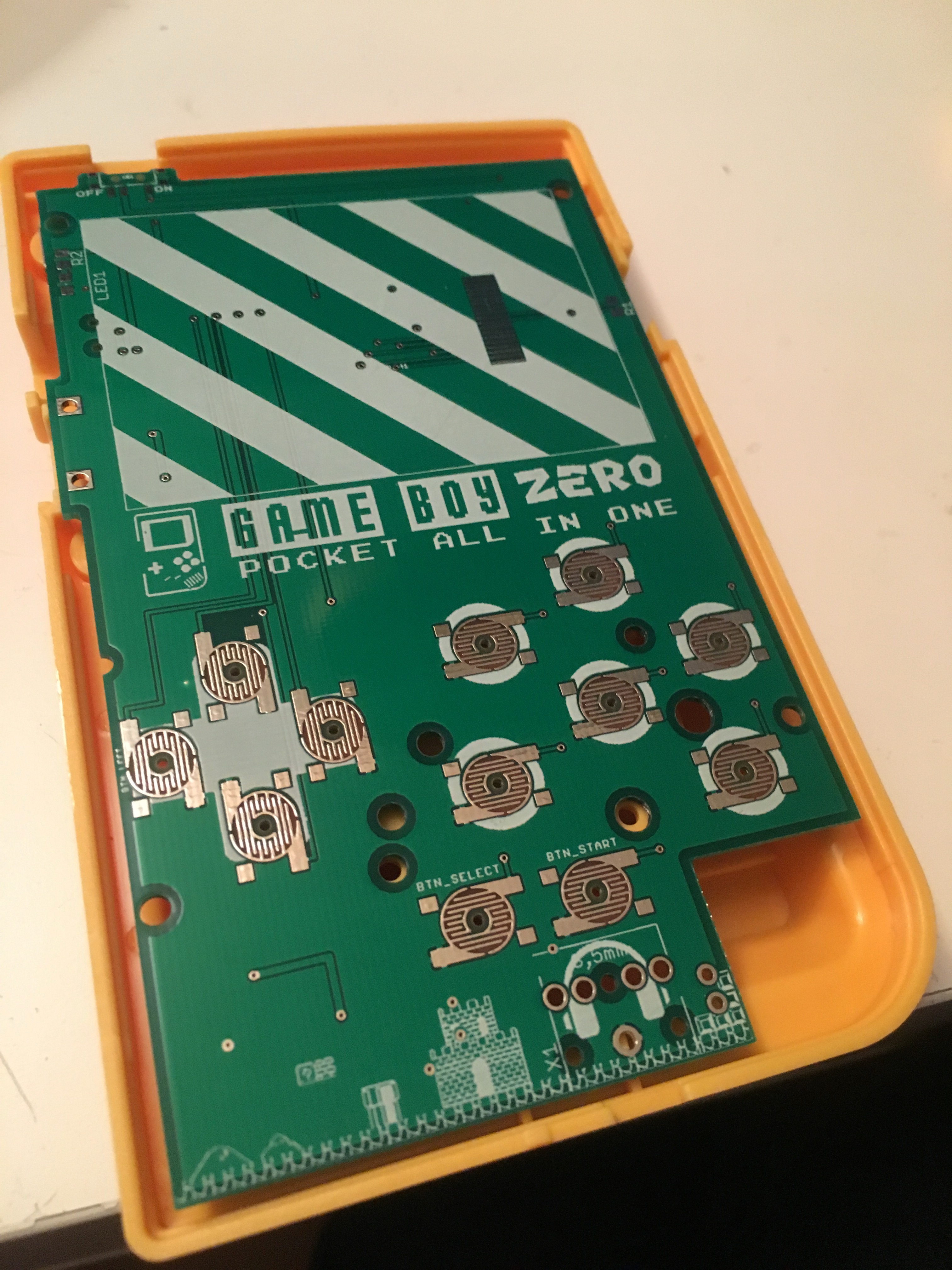

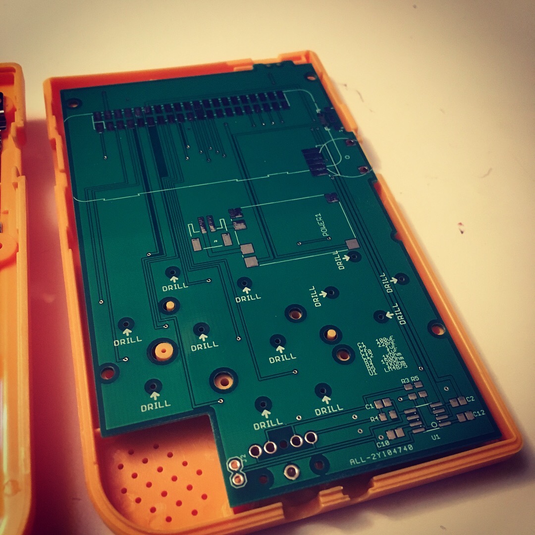

Introducing
Gameboy Zero - Pocket Edition
Gaboze Pocaio
Gaboze Pocaio is a concatenation Game Boy Zero Pocket All In One
  • Game
  • Boy
  • Zero
  • Pocket
  • All
  • In
  • One
Le SilkscreenShow
Introduction
Gameboy Zero - Pocket All In One
Raspberry Pi Zero based arcade in you pocket, and in your Gameboy Pocket
Features:
  • 2.4" TFT LCD
  • Gameboy button layout interface
  • Raspberry Pi Zero
  • Battery Charger (TP4056 Module)
  • 60 frames per second display
  • Headphone Jack (LM4857)
  • Speaker capability (LM4857)
Platforms:
The boards have been tested with the following platforms:
Other platforms are yet to be tested.
Eagle CAD Library
With our project we have included a few custom Eagle CAD Libraries
Details
Top ViewShow
Bottom ViewShow
3D Model
GalleryShow
Gallery
Jump to the video where i introduce it.
Fast forward to the part where i DROP IT

Post by wermy » Thu Mar 16, 2017 10:31 am
32teeth wrote:Introducing
First off, hello everyone!
Long time follower, first time poster.
I'd like to introduce a resurrected project of mine, the Gameboy Pocket PCB based on AVR chip sets, my old PCB design has been referred to many times and felt it was worth an update
Here is my current GitHub repo: https://github.com/32teeth/GameboyZeroPocket
When you have a chance, check out the source, it's under OSH License, so use as you see fit
Thanks
Awesome, thanks for sharing! Are you planning on getting a batch of these made? I know lots of folks have wanted to make a GBP version of the GBZ. :)
Also, welcome!

What screen size are you going for?
I have wanted to do one of these but either the screens are too big or two small, not yet seen anything that fits almost perfect.

32teeth
Re: Game Boy Zero - Pocket Edition
Post by 32teeth » Thu Mar 16, 2017 3:37 pm
Thanks for the welcome
Gameboy Zero - Pocket Edition (whats next)
So, in addition to other AVR projects (http://moledcule.club), i am planning on creating a Chrome App that you can reprogram (compile and flash) the 32u4 on the GBZP
Next i will be releasing the code for it
If you guys have time, check out the GitHub and let me know your thoughts. I will most likely do a short run of assembled boards. And if there is interest i'll make more
Thanks again for the welcome!

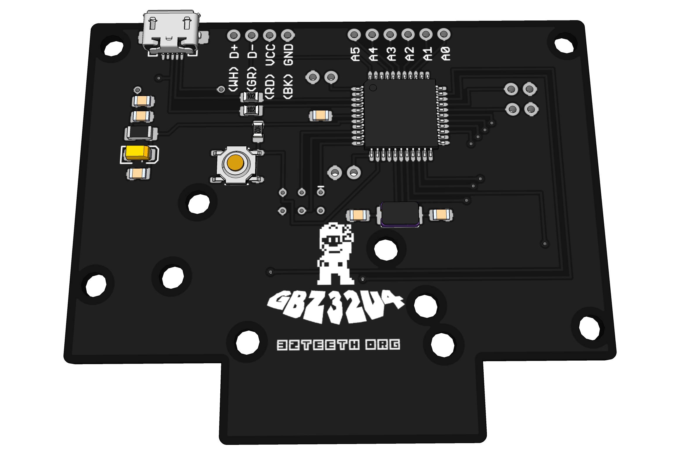

Post by 32teeth » Mon Apr 03, 2017 8:11 am
Updates
Hey All
Wanted to let you know, from some of the PM feedback (thank you)
I have updated the pin mapping to match that of @oxadao github repo https://github.com/oxodao/GBZGamePad
This was done for consistency
Additionally, there are now 4 additional button breakouts (L1,L2,R1,R2) they are labelled on the PCB
  • L1 = J2 Breakout
    L2 = J4 Breakout
    R1 = J5 Breakout
    R2 = J6 Breakout
GitHub repo: https://github.com/32teeth/GameboyZeroPocket has been updated!
