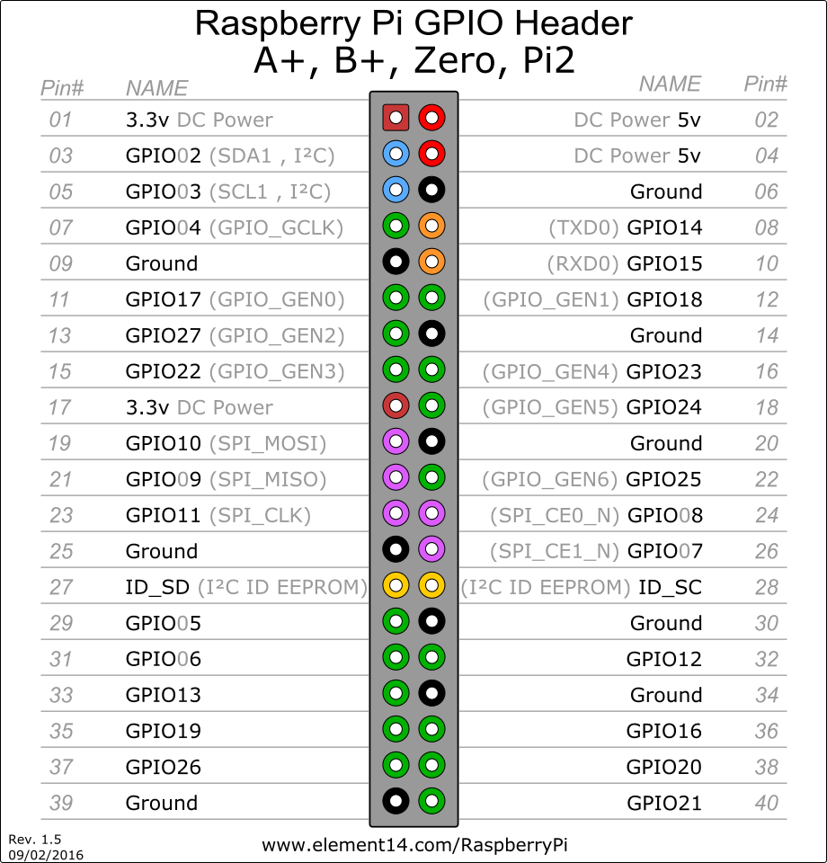

So i am going to wire up a kk_gb_zero_a but the pads on a "pi zero" and a "pi zero w" are not the same:
Zero Image
Zero W Image
What i am missing is "PP 8". Any ideas what can replace that?

PP8 is 3V3 so you could use pin 17, or pin 1, any which is 3v3. I used pin 17 with my PI0Ws.

As above they have moved the pads around a bit but everything you need is still there. I have swapped out a couple of Zeros now for Zero W's and had to look this up, too as im using cart readers on a couple of builds.
