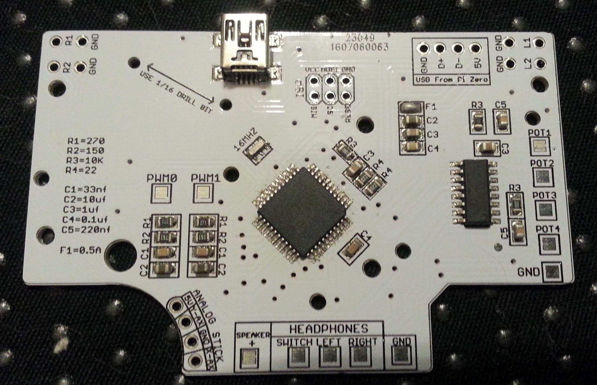

Here is the photo. It is similar to the board used in Wermy's custom part tutorial. It justn doesn't have a usb hub. Also, What does ssh mean.

Ok, not a bad board...
You can get away without needing a USB hub, you only really might need one extra USB port (and that might only be once in a blue moon)
But as you are you will need to ssh into the build when you hook up your board/pcb as you'll not have the ability to hook up a keyboard
https://github.com/RetroPie/RetroPie-Setup/wiki/SSH
I would suggest that you setup your pi zero w and retropie before you hook up the board/pcb...
Meaning sort your config out, move over your roms, setup your wifi and enable ssh via raspi-config... That way when you hook up the board/pcb only a minimal amount may be needed via ssh

Taking a step back, USB is used for:
Arduino button control
Audio
WiFi
Bluetooth
External access
The ZeroW already has bluetooth and wifi, so you don't need USB for those. The AIO board has audio and your controls, so you don't need USB for those, either. So the only use for a USB hub would be if you want to connect other input devices (controllers, keyboards, etc.)
It's a custom device, so what you need depends on what you want to do with your build.
As for SSH... it's a way of remotely accessing your Pi's operating system, so you can tweak the Pi's settings from your PC. The benefit being, you don't have to remove the SD card from your GBZ, or hook up a keyboard/mouse/monitor to your Pi.
https://raspberrypi4dummies.wordpress.c ... ssh-putty/
You will need to adjust settings and the Config file on your SD card. If the SD card is buried inside your GBZ, it's a lot more convenient. If the SD card is easy to access (mounted in the cartridge, for instance), it's less important - you can pop it out and mount it in another (loose) Pi Zero (it's good to have a backup for troubleshooting), or plug it into your PC to edit.
Again, it just depends what you want from your custom build.
