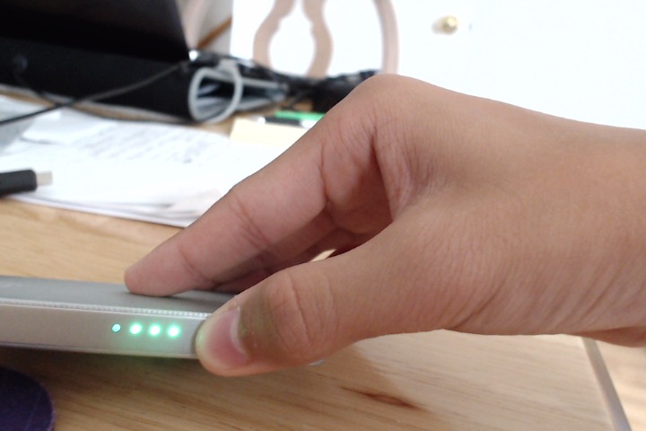

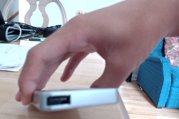

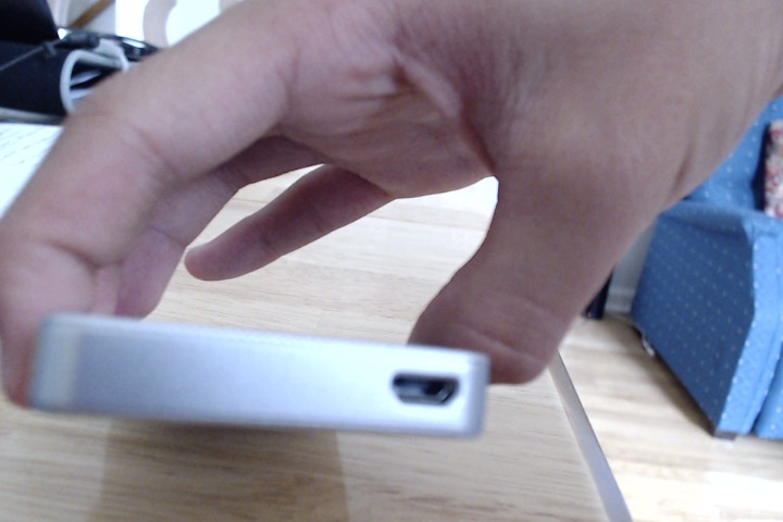

I didn't make this personally, but why haven't I seen a GBZ with a battery bank within it yet?
Specifically a battery bank (one usually used to charge phones) that has:
-A built in charger
-An internal battery
-A USB output to power the pi
-A LED indication light
All in one slim and compact thing!
*NOTE: just to be clear, I'm NOT selling these things or anything like that. Here's the link to buy it yourself: https://www.radioshack.com/collections/ ... bank-black
....the problem is that it's radioshack. Yeah.... :cry:
you will be missed
If you find an alternative, please post it below to help people out. I haven't tested if it fits inside a gameboy shell, but it seems like it can, more research pending.
What do you think?

Usb Output
Photo on 7-28-17 at 12.53 PM #4.jpg (70.81 KiB) Viewed 9195 times

Micro USB charge port
Photo on 7-28-17 at 12.53 PM #3.jpg (64.96 KiB) Viewed 9195 times

4 LED battery indicator
Photo on 7-28-17 at 12.53 PM #2.jpg (60.52 KiB) Viewed 9195 times

They usually (not always) won't supply while they themselves are being charged. Also their casing takes up valuable space for something that's only going to be internal anyway.

The case isn't a huge concern, as it can be removed for a smaller form factor, but there are a number of reasons why it's less common. Most won't do pass-through charging, so you still may need a Powerboost. And they're often more expensive than an equivalent bare LiPo from China. And their capacity claims are just as sketchy as any battery bought on eBay.
Most importantly though, it's not what Wermy used, and since most people are using Sudomod as a guide, they stick with similar components.

As for the whole power bank thing... The single biggest hurdle is finding a power bank with passthrough charging (it will charge/discharge simultaneously). Most don't, so they'll cut power to the device if you try to charge the battery. That's mostly going to be a matter of either tons of research to find suitable banks, or just trial and error, testing actual power banks.
Apart from that, make sure it uses LiPo pouch cells and not 18650s, and then find one that's small enough for your needs.
So, it will work, and it's a viable solution, but finding exactly the right bank is hard.
