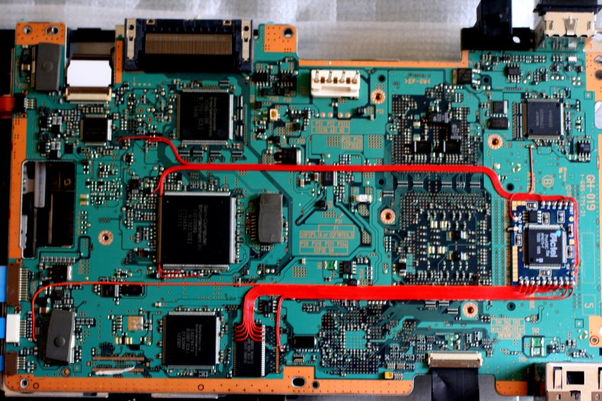

Re: What Gauge of Wires?
- 28AWG connections, terminals...
20AWG for power / ground
Kynar Wire if it touches / connects SMD components or capacitive pads
PS, Kynar Wire and Crazy Glue you can do some sexy wire manageme…Show
