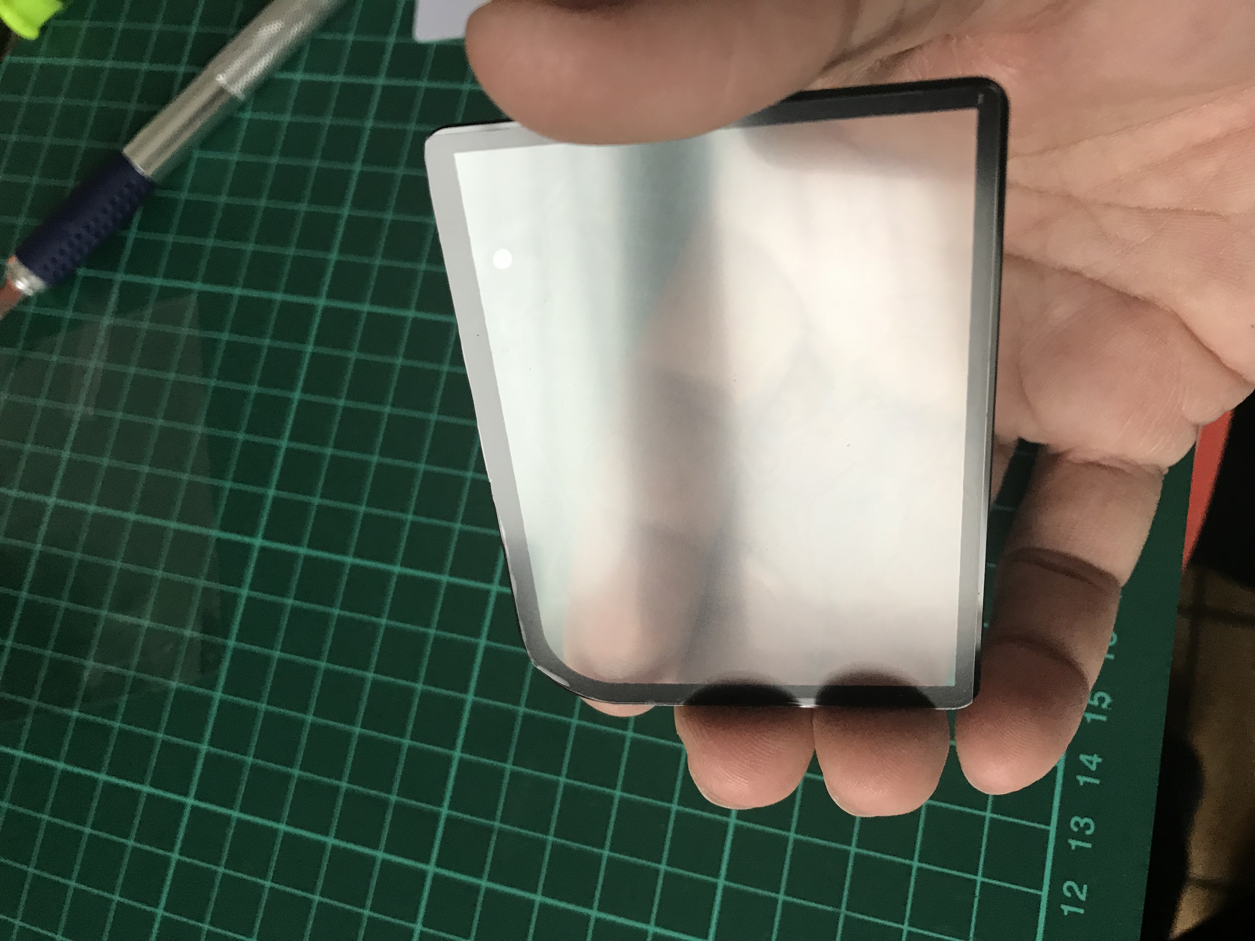

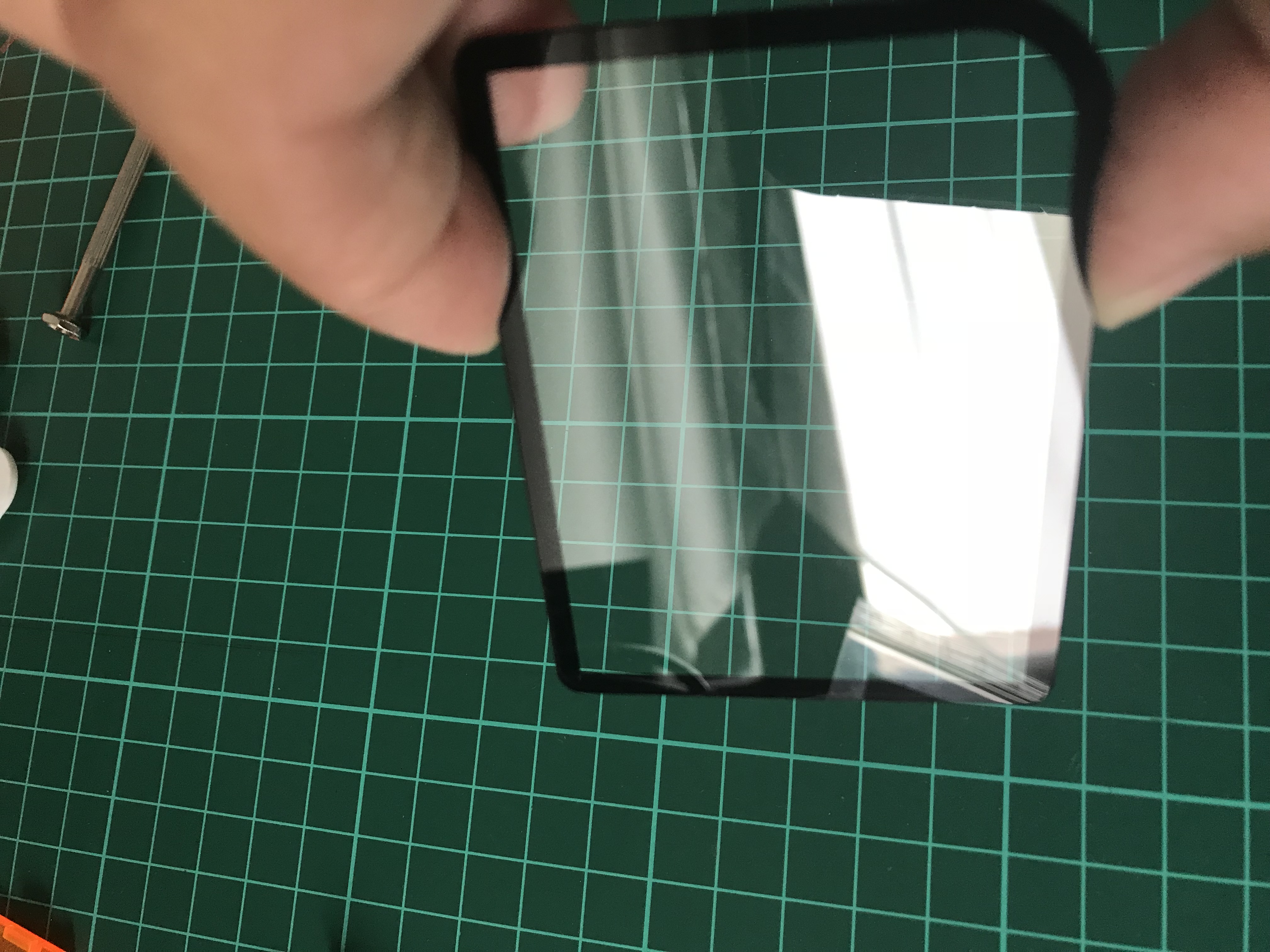

Post by VeteranGamer » Thu Nov 23, 2017 8:53 am
just an update no this....
not sure if people are really interested in doing this......
i have no choice as my next build has a 3.2" SPI screen, and the current screen surrounds just aren't the right size
first attempt and the results are not that bad....
for me the issue wasn't the cutting, but actually getting any air bubbles out (still a couple left, but its a first attempt)
any over bleed of the ink is actually a good thing, it gives you a kind of cutting guide
cut and on a clear screen surround
i should after cutting and applying a few more hopefully have better results......

Re: Screen Surround - printing techniques ?
Post by VeteranGamer » Thu Nov 23, 2017 10:01 am
YaYa wrote:
Thu Nov 23, 2017 9:23 am
To avoid bubbling, take a glass cleaner spray and make a pschitt form far above the glass so you spread a little cloud of drops on the glass. Then you apply your vinyl and the water film will prevent the vinyl from sticking.
thanks....
i did actually try that, but with disastrous effects.....
also the credit card technique didn't work out it started to rub the ink off as well
i personally found applying heat gave a better result.....
results are gonna be different for anyone that tries this ....
based on the vinyl you use and the type of ink/printer used
