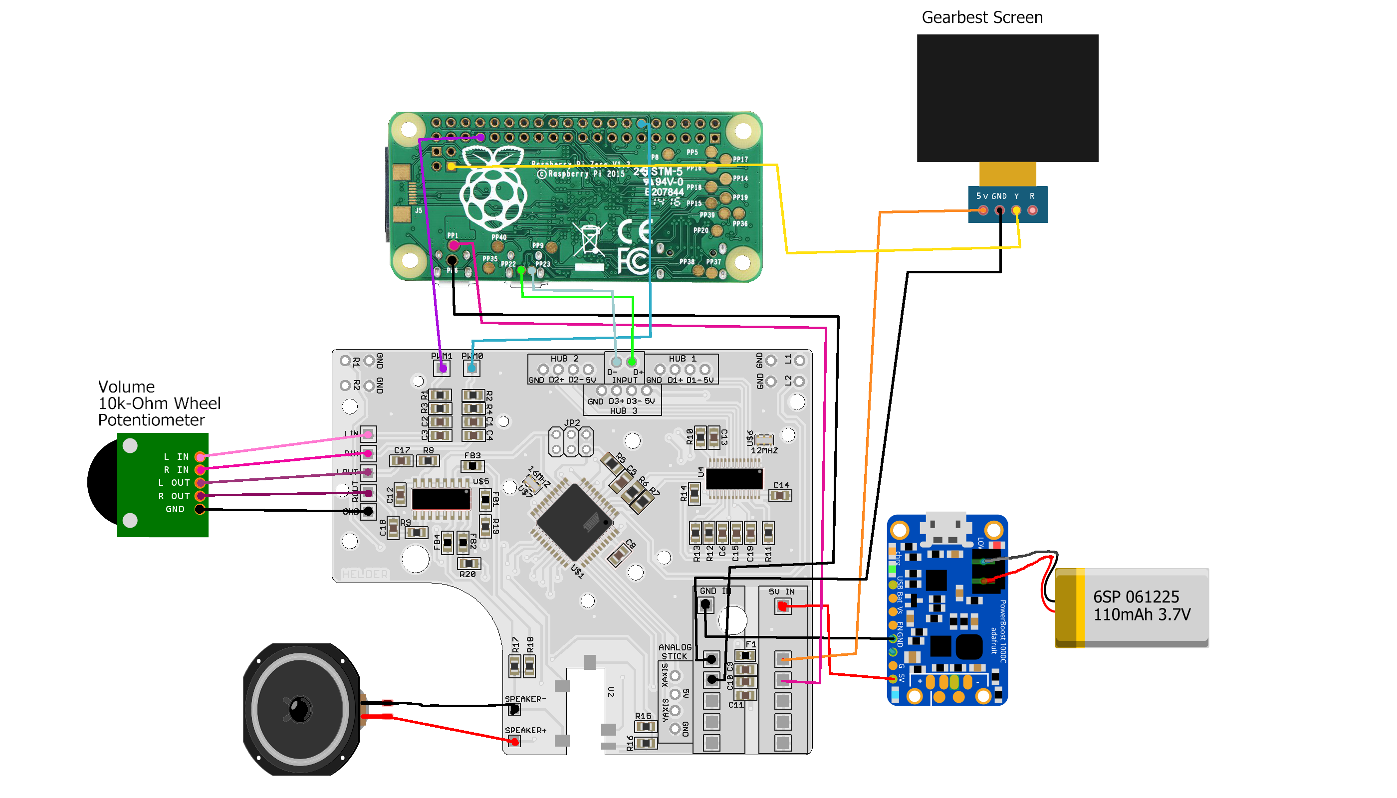

Hello guys, i know this should probably be the easiest thing to do on the GBZ based on Helders AIO board.
But i'm a little bit confused about the wiring from the volume wheel to the AIO board.
i know i probably have to wire the first pin on the volume wheel to the first pad on the board and so on.
But helder posted an image which has a little different labeling to it.
on my board its: RIN, LIN, LOUT, ROUT, GND
on that image from helder its: LIN, RIN, LOUT, ROUT, GND
so i think basically i just need to wire them up in order from up to down. but since the labeling on my board is a little bit different i'm not exactly sure about that.
i hope someone can help me with that because that should be the very last step before finishing my gbz build :)
Re: Helders AIO Board speaker wiring
Post by Helder » Sun Jul 28, 2019 11:48 pm
You line them up pin to pin as in the picture except the volume wheel pins face down not up. That will orient it properly as long ad they face down.
