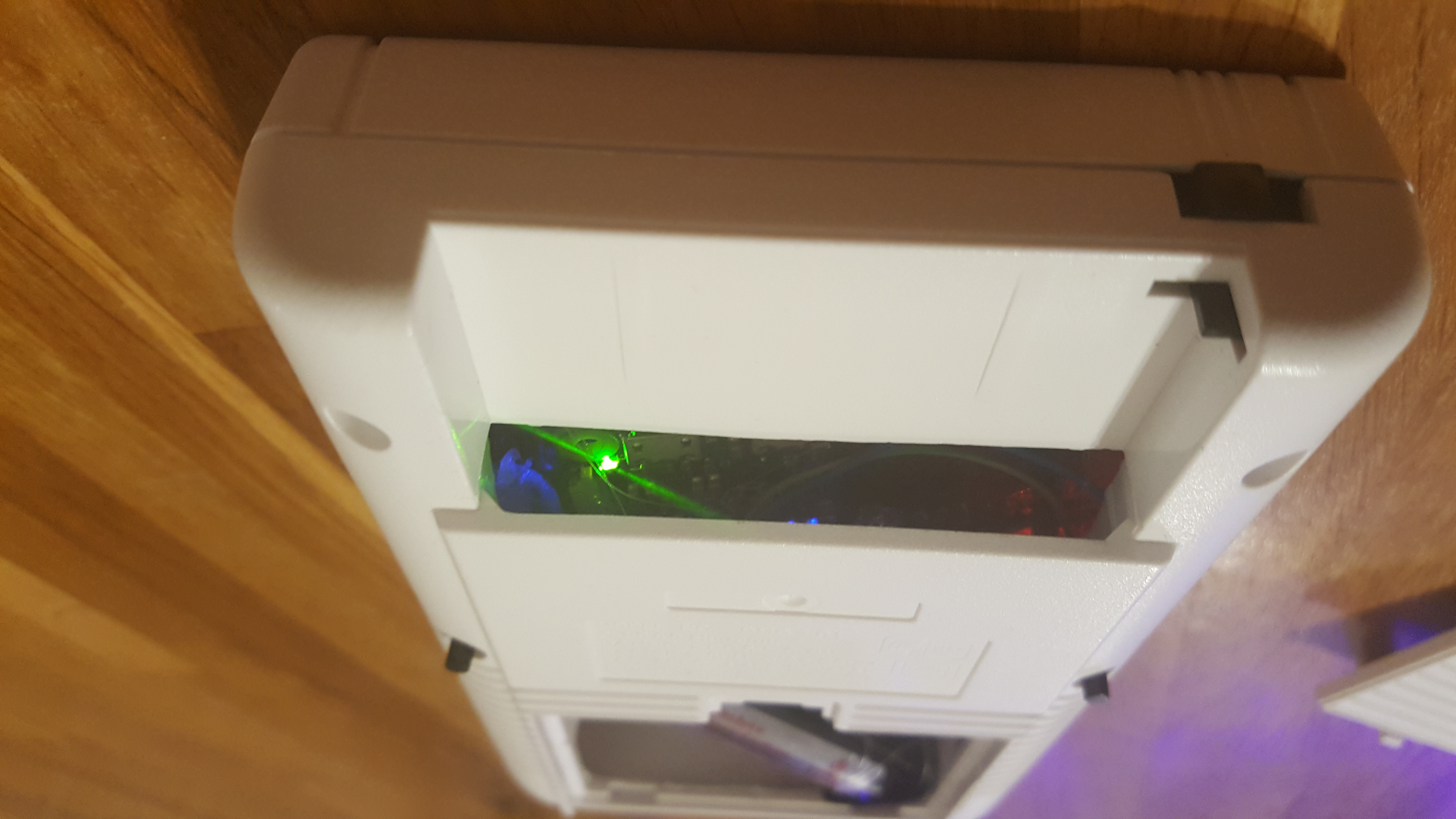

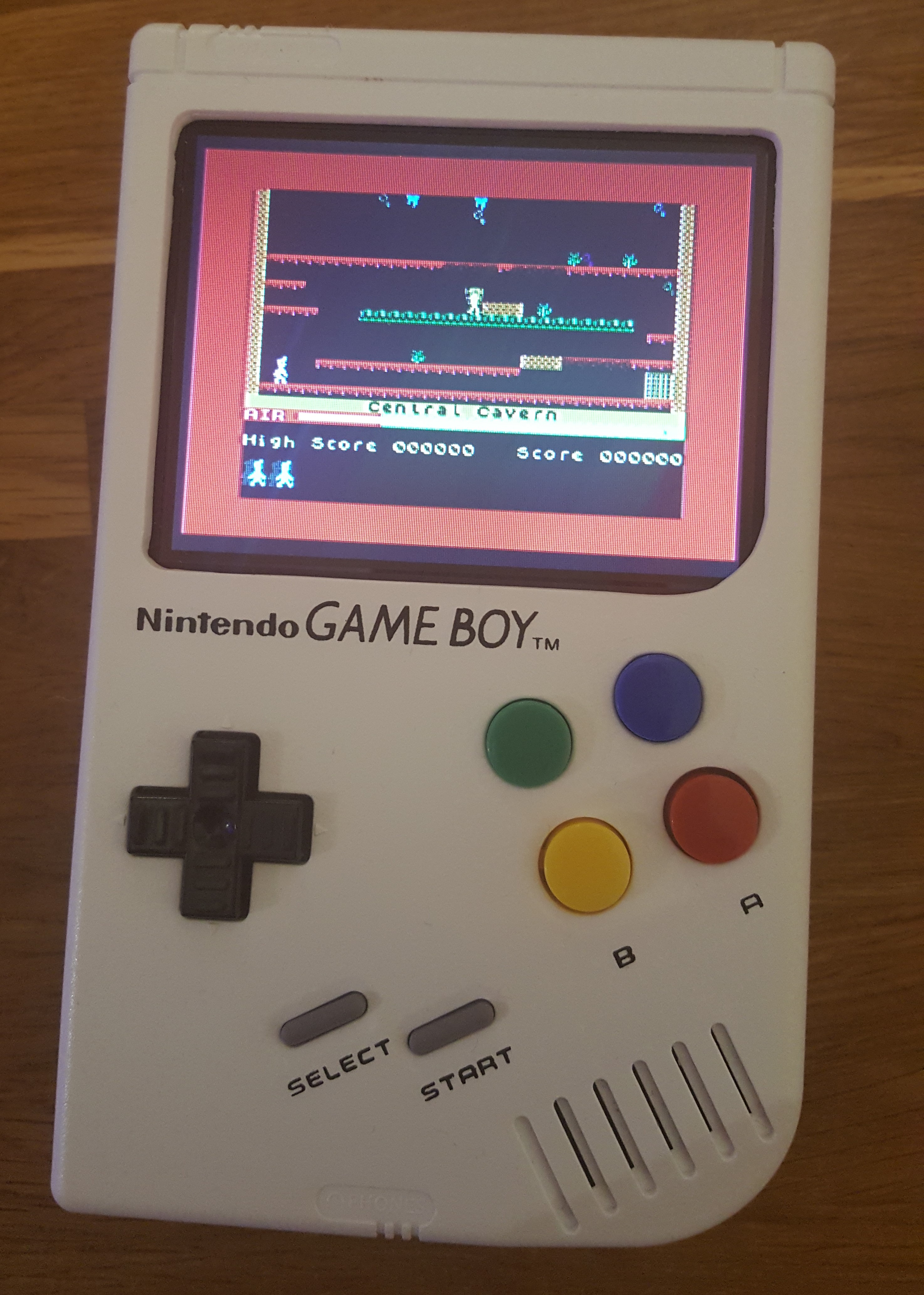

Hi everyone,

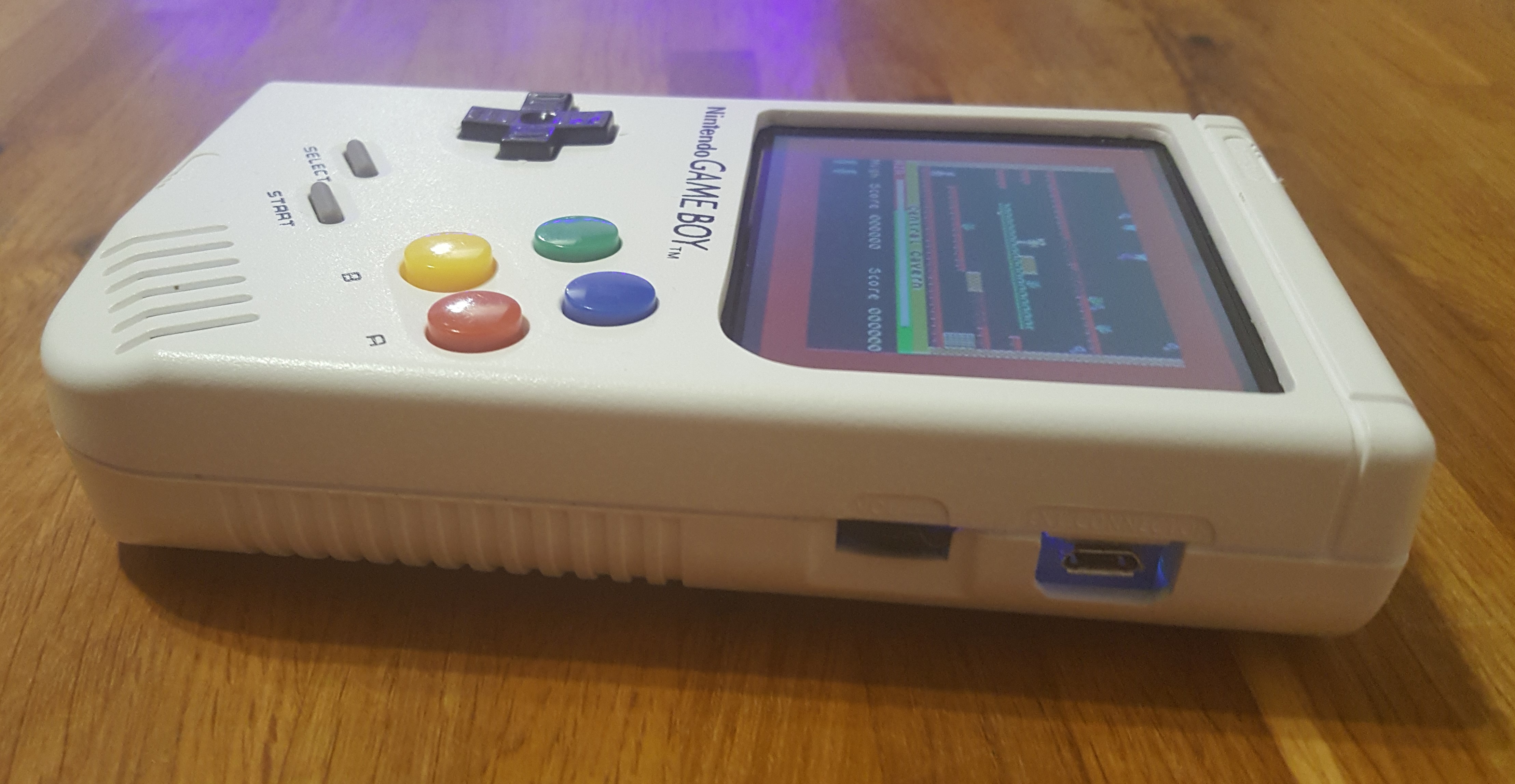

after several months my first Pi Zero Gameboy.

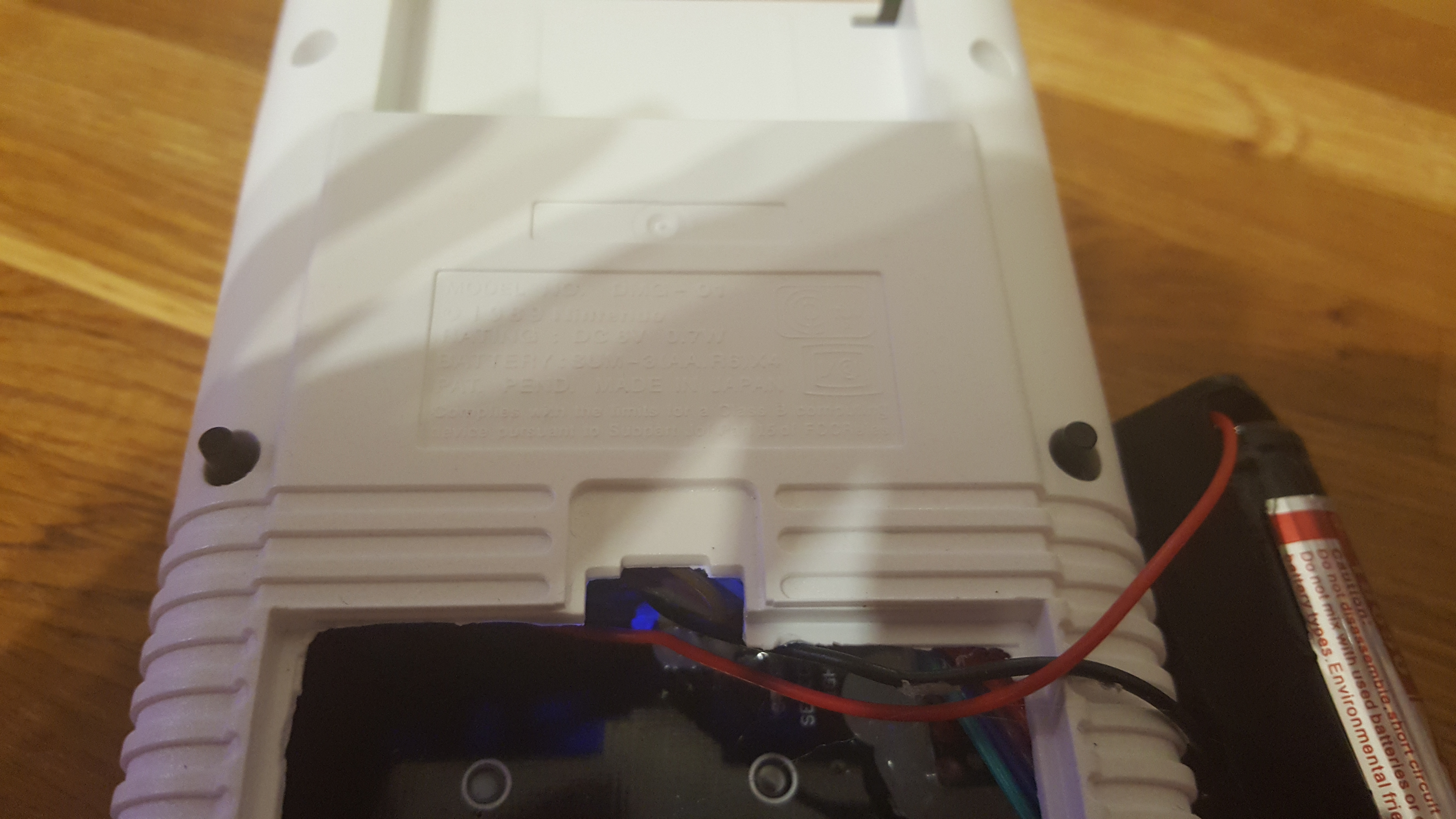

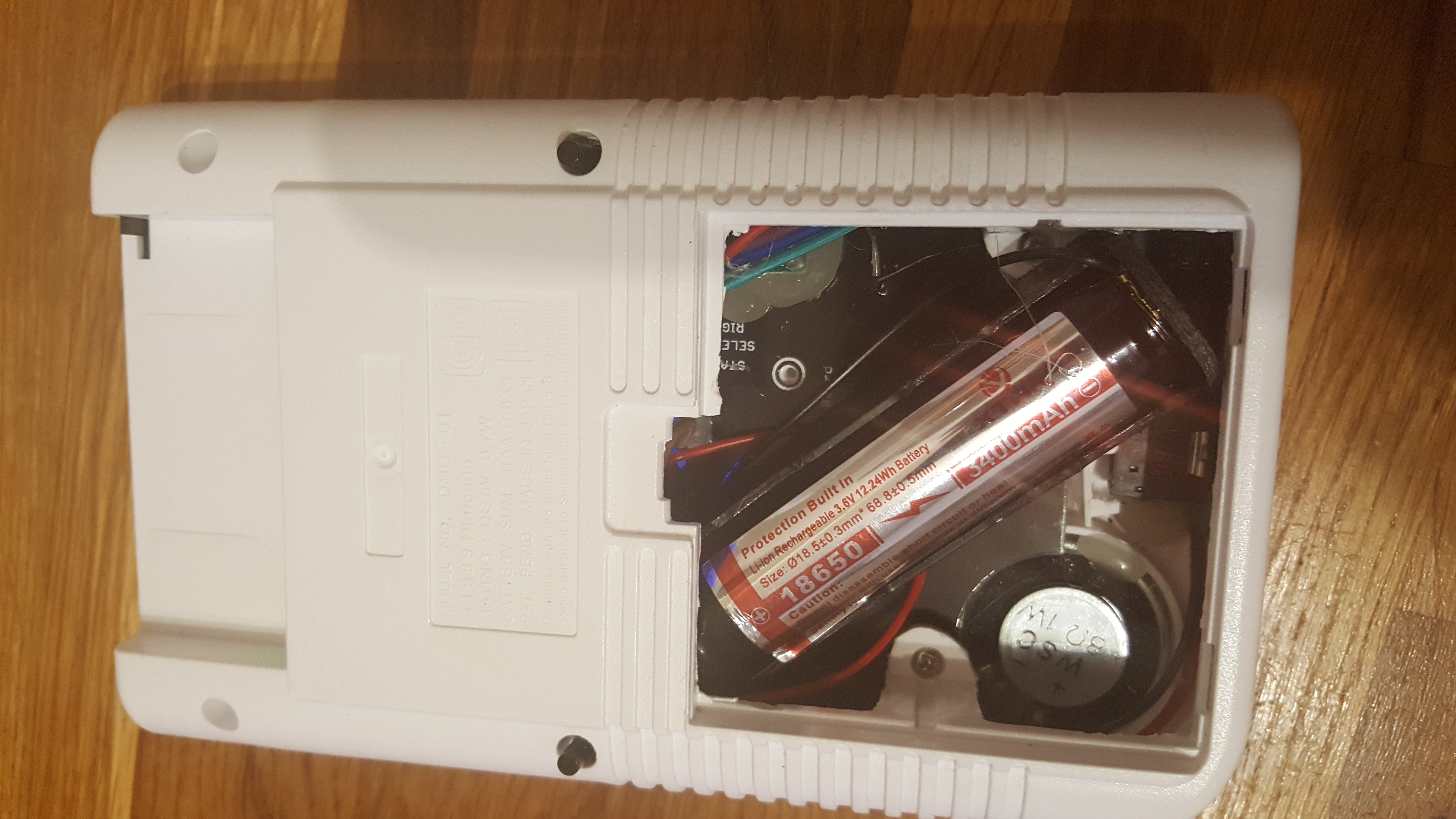

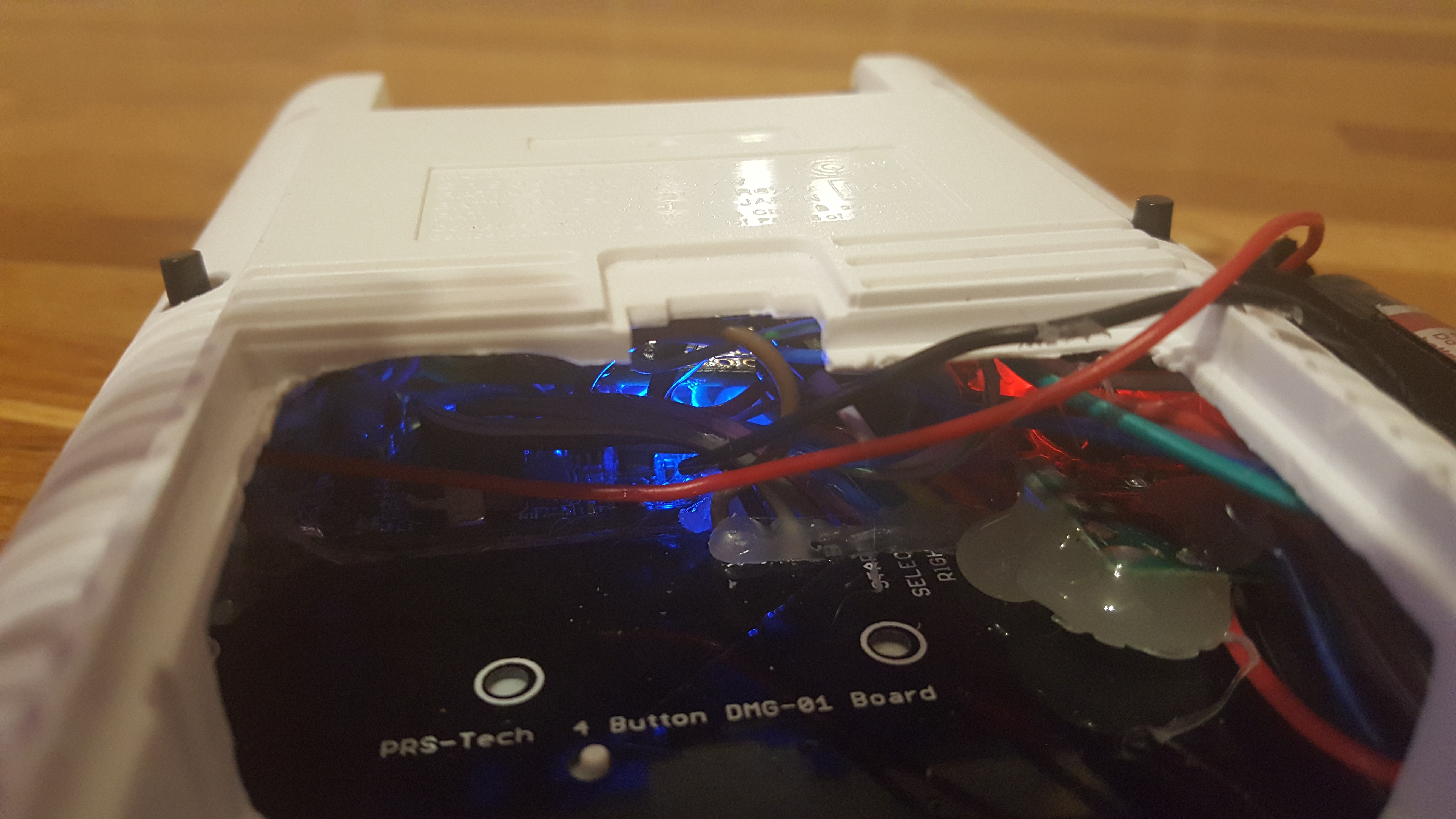

Parts used
BW V7 screen
Kepad PCB off ebay (connected using GPIO pins works great)
Standard DMG-01 (not an original one)
Power/charger board of Banggood (has additional cell protection too)

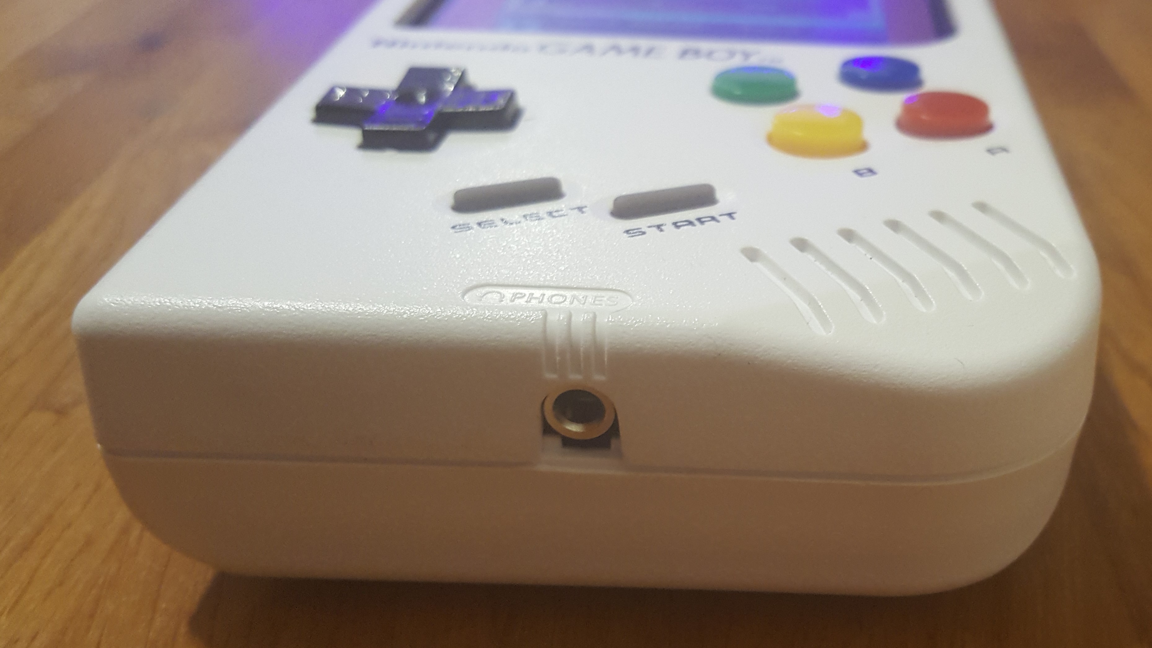

18650 3400mAh Cell (protected)
cheap USB sound card connected to OTG connector I couldn't get it to work off the pads very odd.

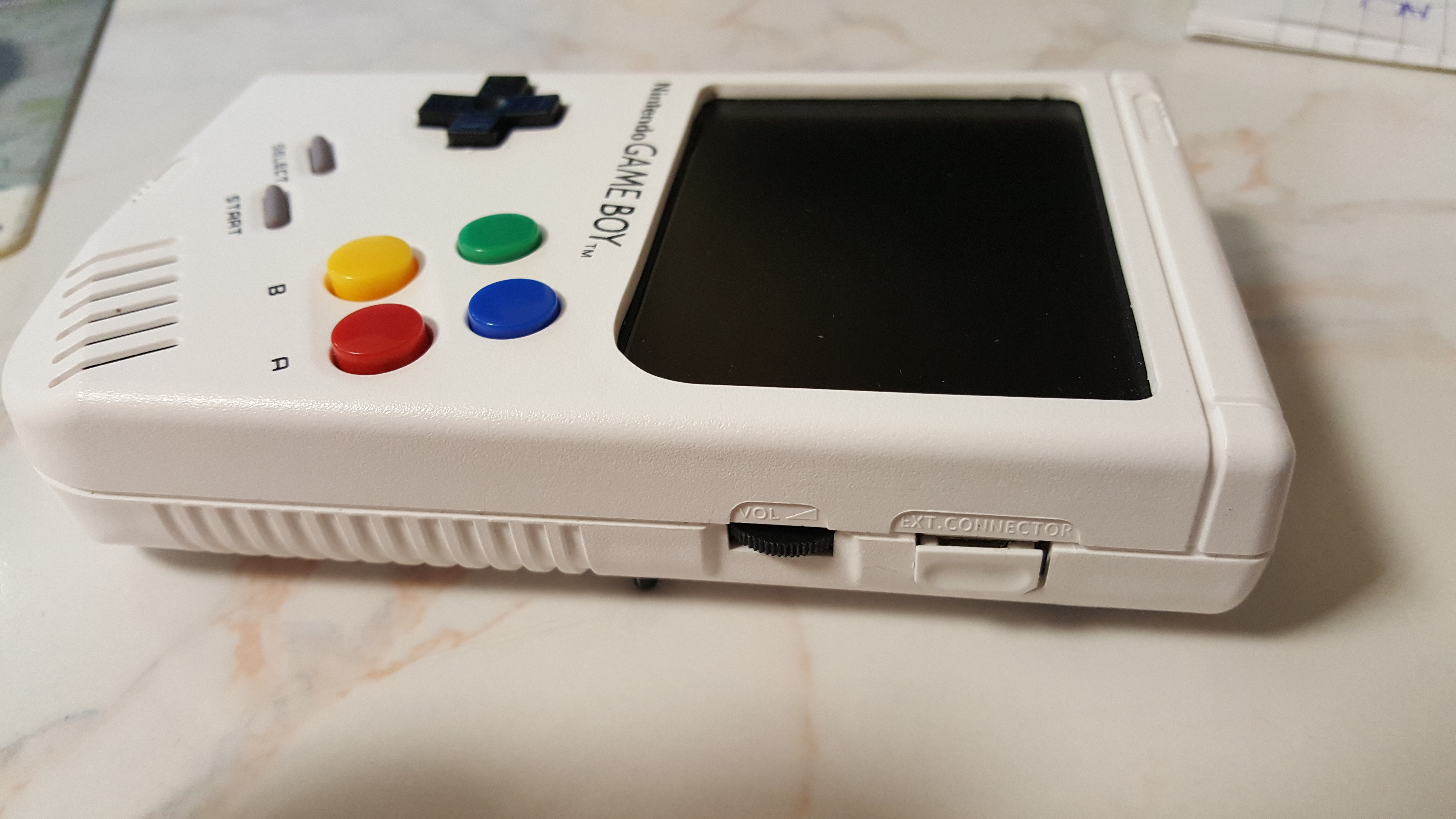

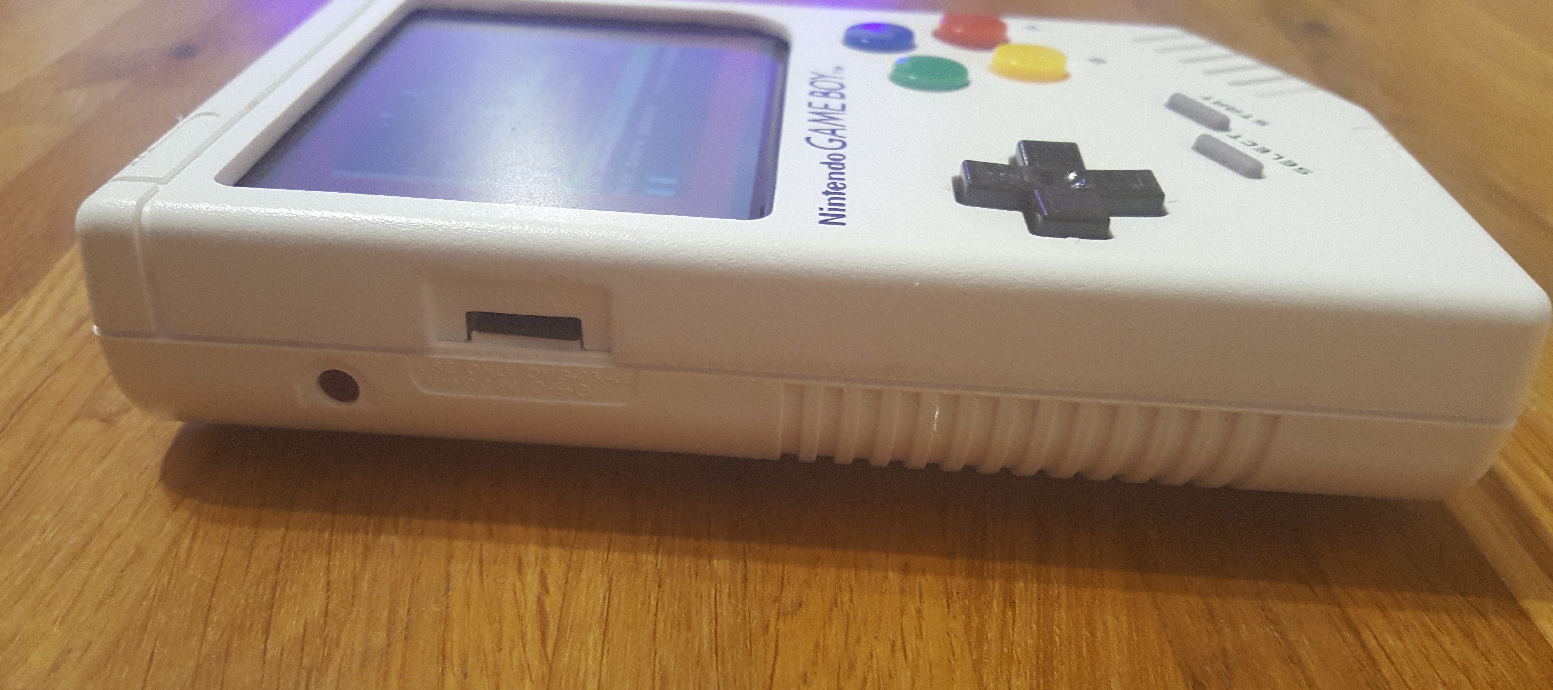

Has a working volume wheel and earphone socket (stereo) and a 3w pam8403 (mono) (small amount of interference adds to the charm)
Worked out quite well I just need to tinker with the sound to get it to work on mame. My favourite game Manic Miner plays so well :)
Sadly it has no wifi but its quite easy to transfer files using windows and a card reader.

I measured the current draw this morning its about 1A to 1.2 A from the battery so I reckon the battery life should be 2-2.5 hours.
I'm going to add an additional switch in the back to turn the amp off as I think this may be using over 0.5A on its own that will hopefully push the battery life to 5 hours.

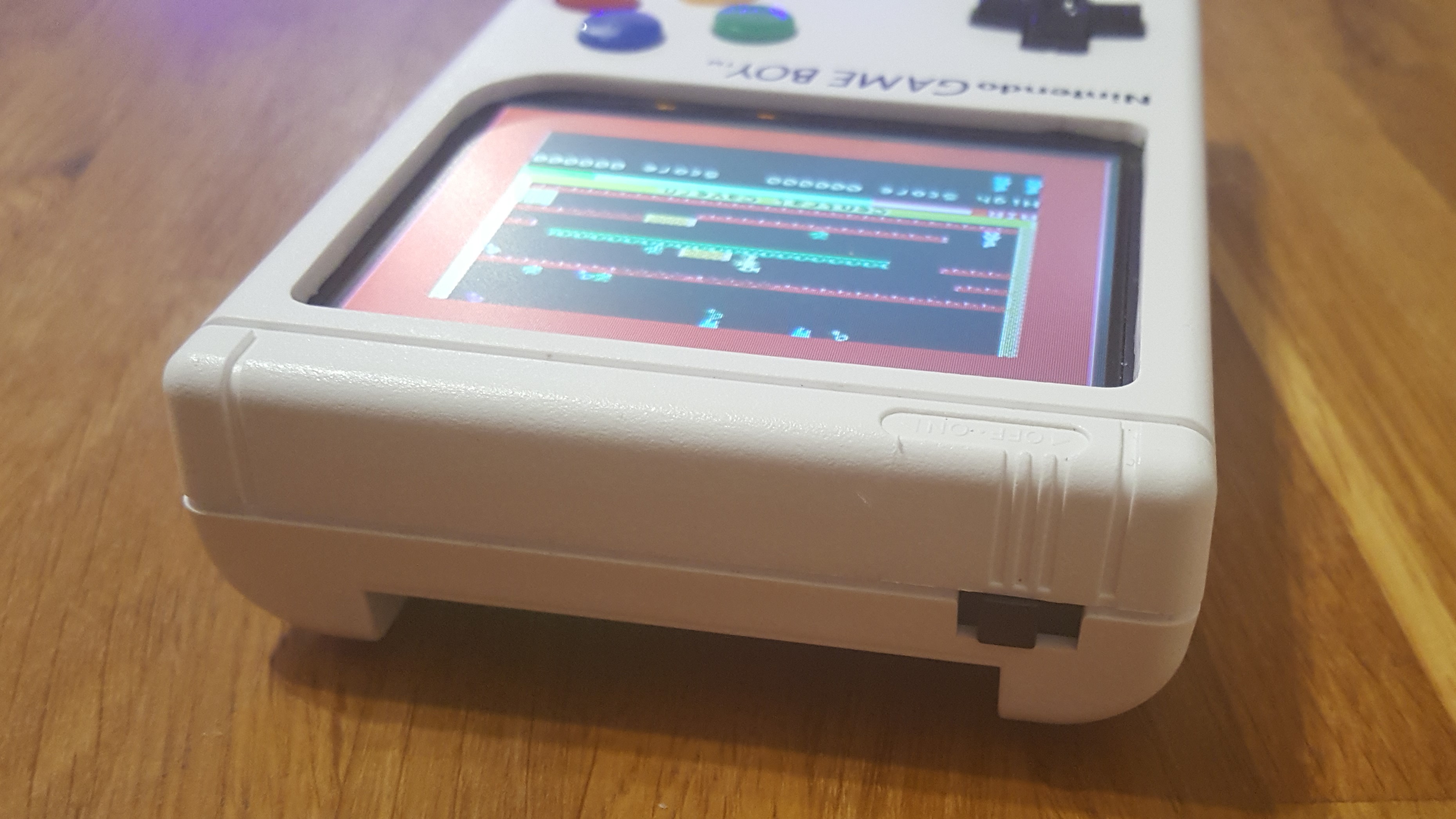

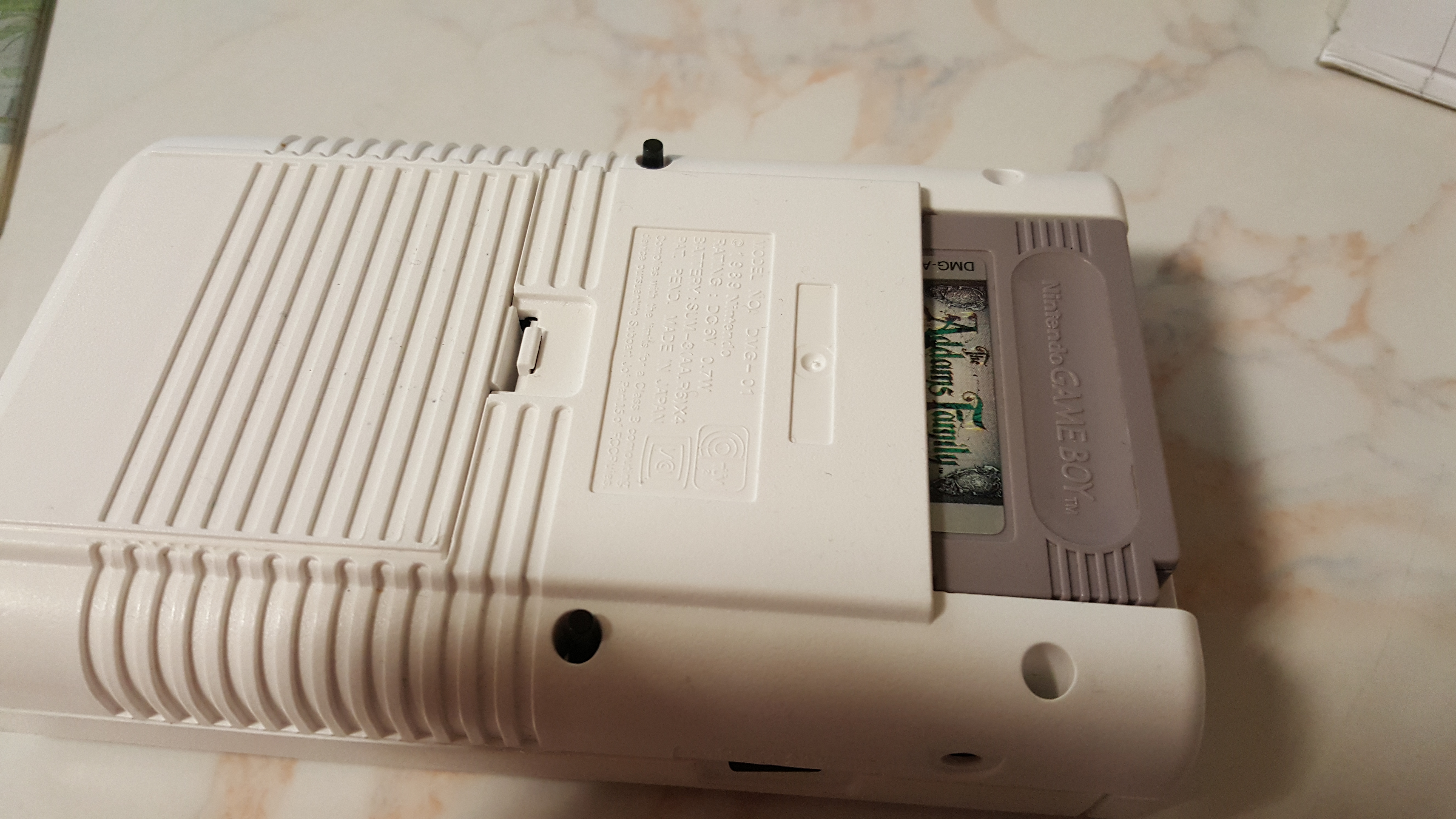

I have just tweaked it again to add a cartridge and sorted the charger cover.
