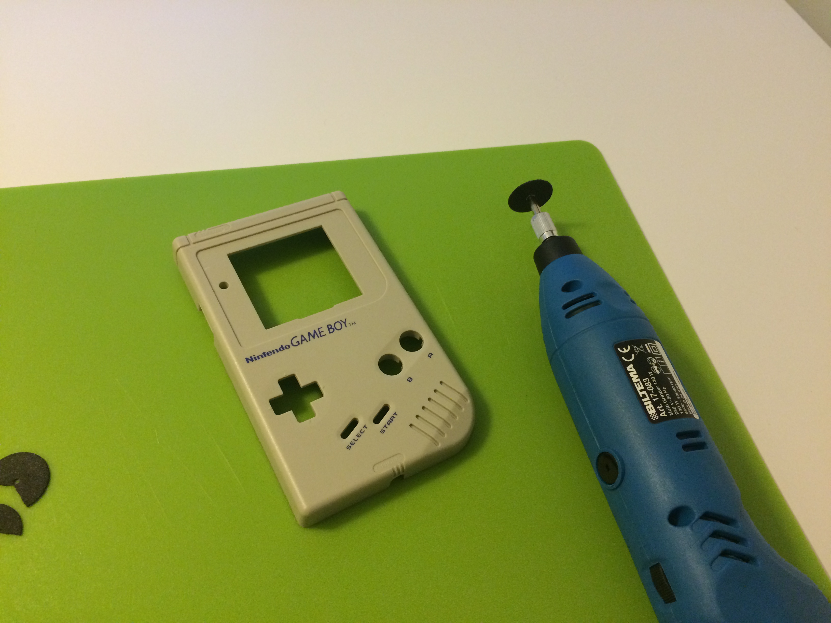

I bought a cheap rotary tool. And it works great.
2016-09-28 18.52.47.jpg (1.23 MiB) Viewed 11506 times

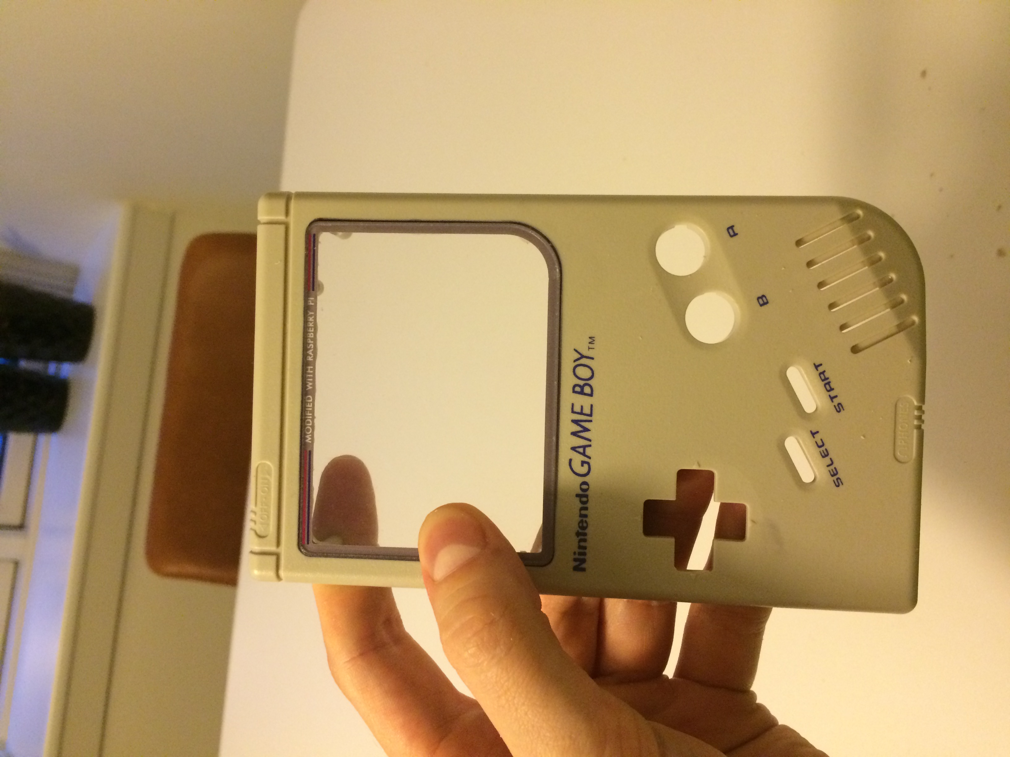

Test fitting Dominators screen surround

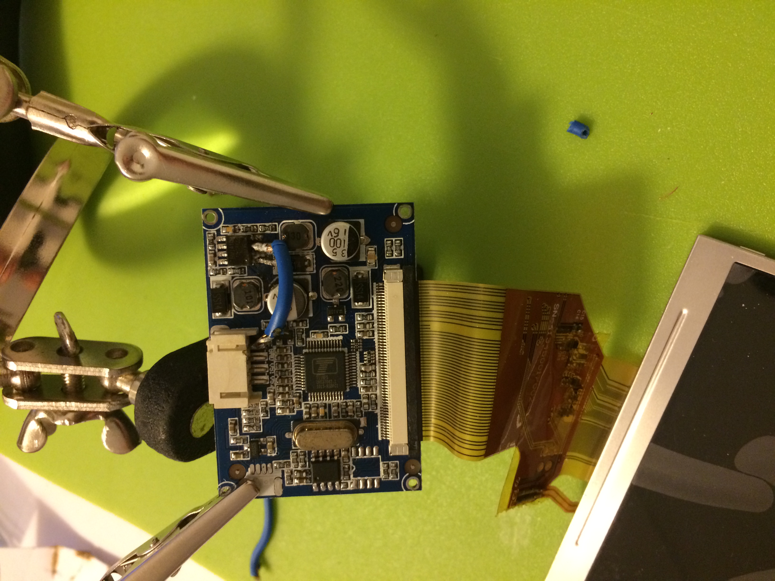

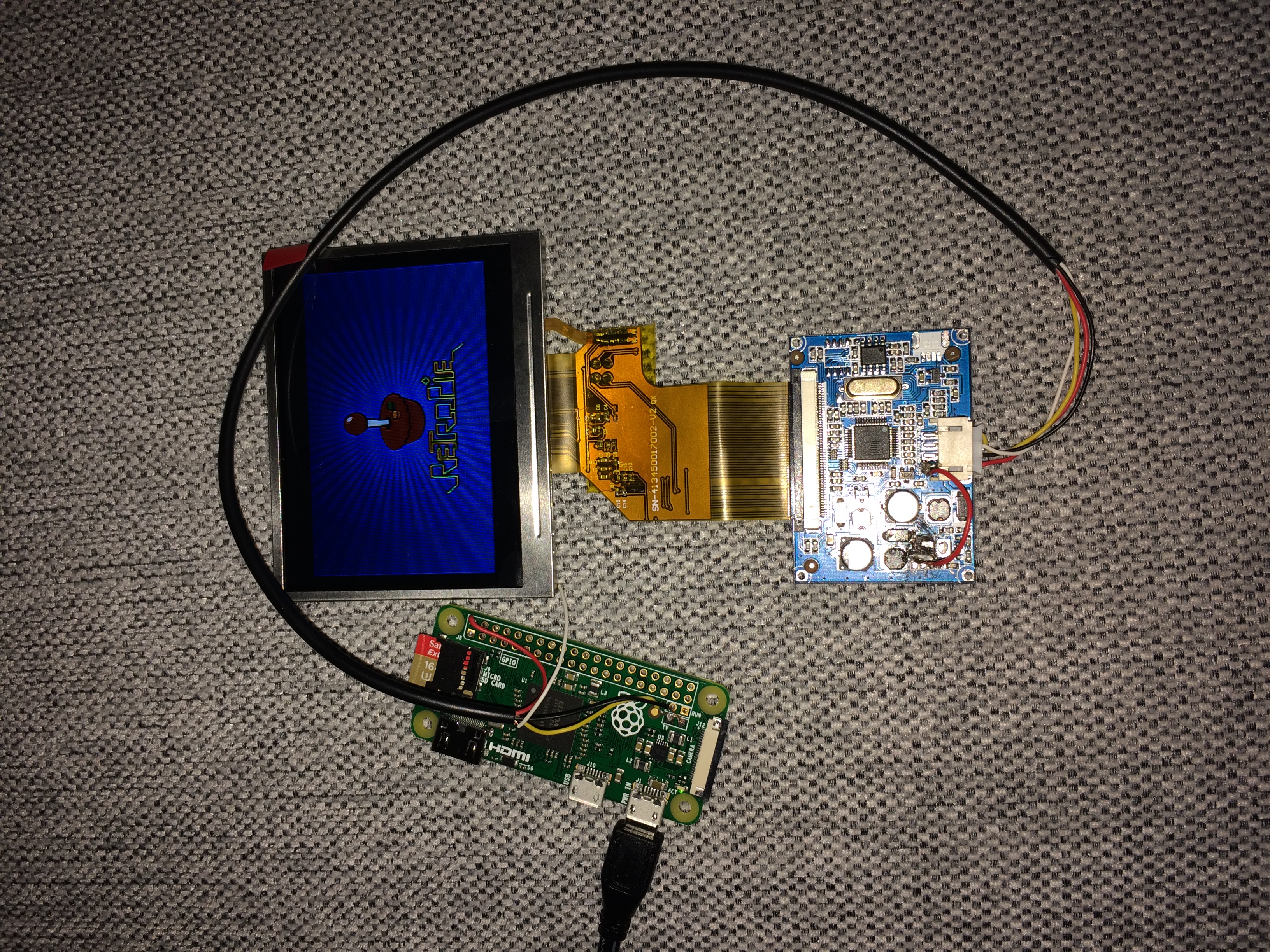

Soldering the jumper wire. Ended up removing the chip completely because of poor soldering.
2016-10-08 18.34.46.jpg (1.13 MiB) Viewed 11506 times

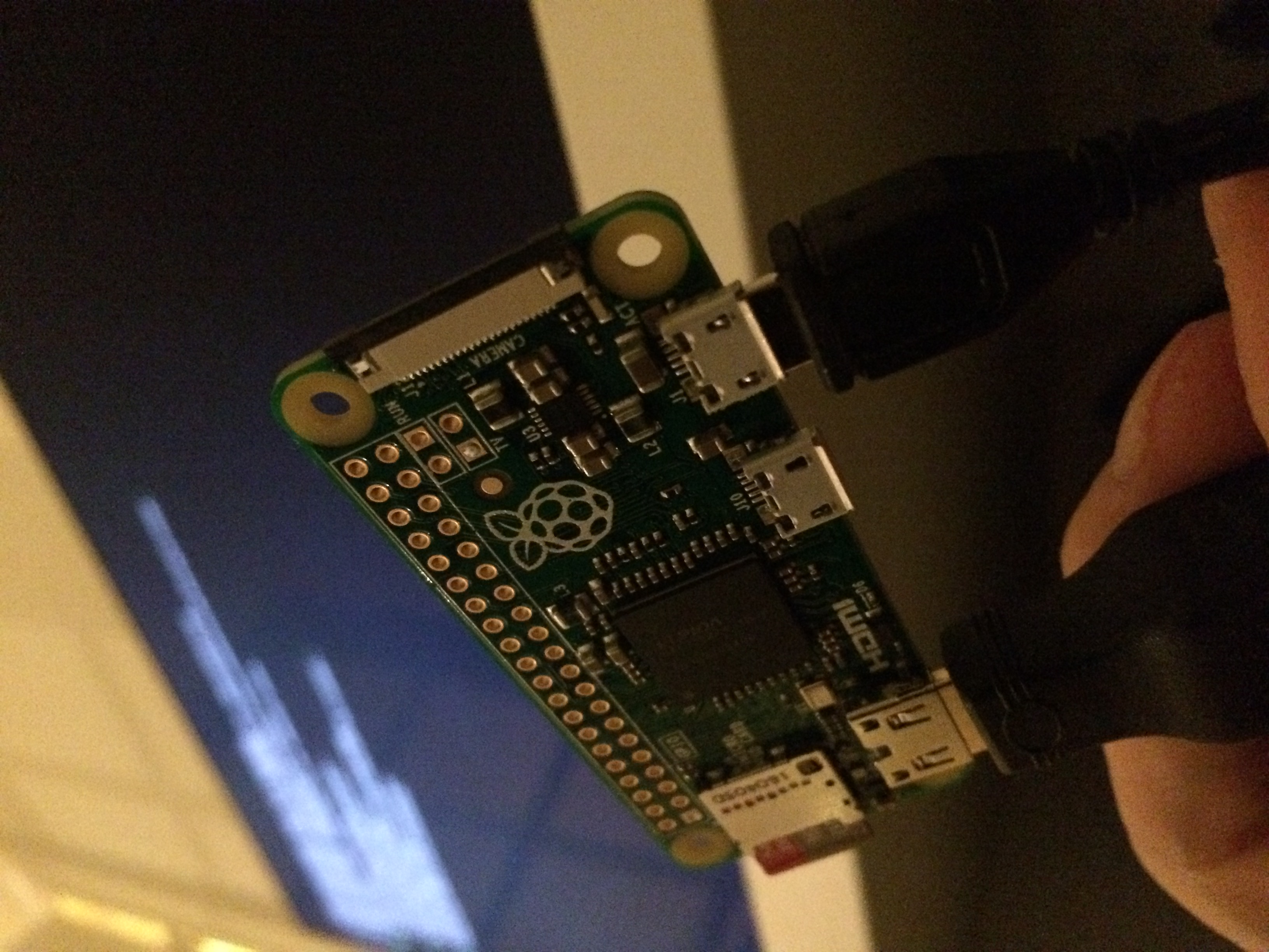

Testing the zero
2016-10-08 23.12.51.jpg (1.21 MiB) Viewed 11506 times

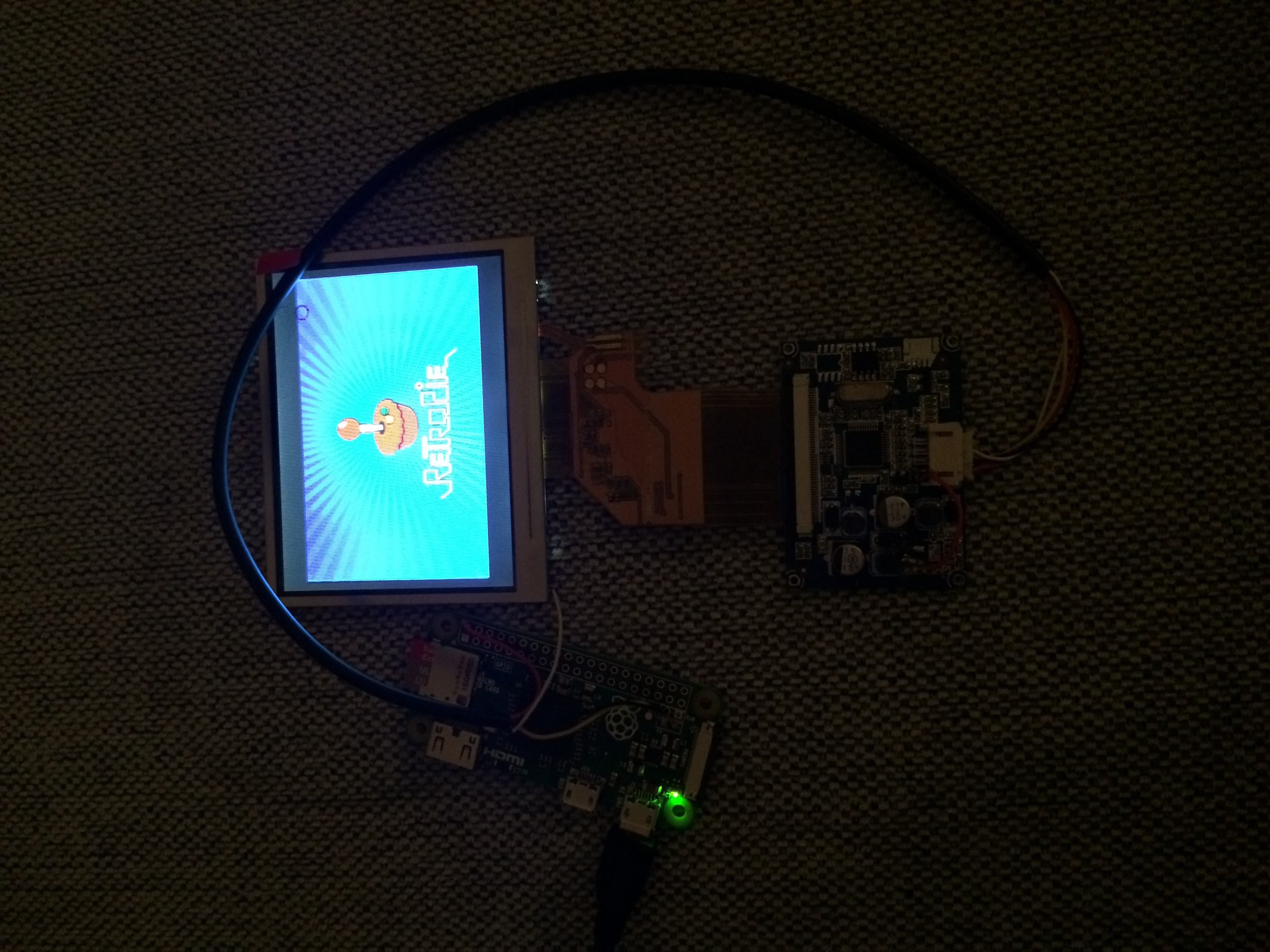

Testing the screen after modification
2016-10-09 00.57.04.jpg (1.03 MiB) Viewed 11506 times

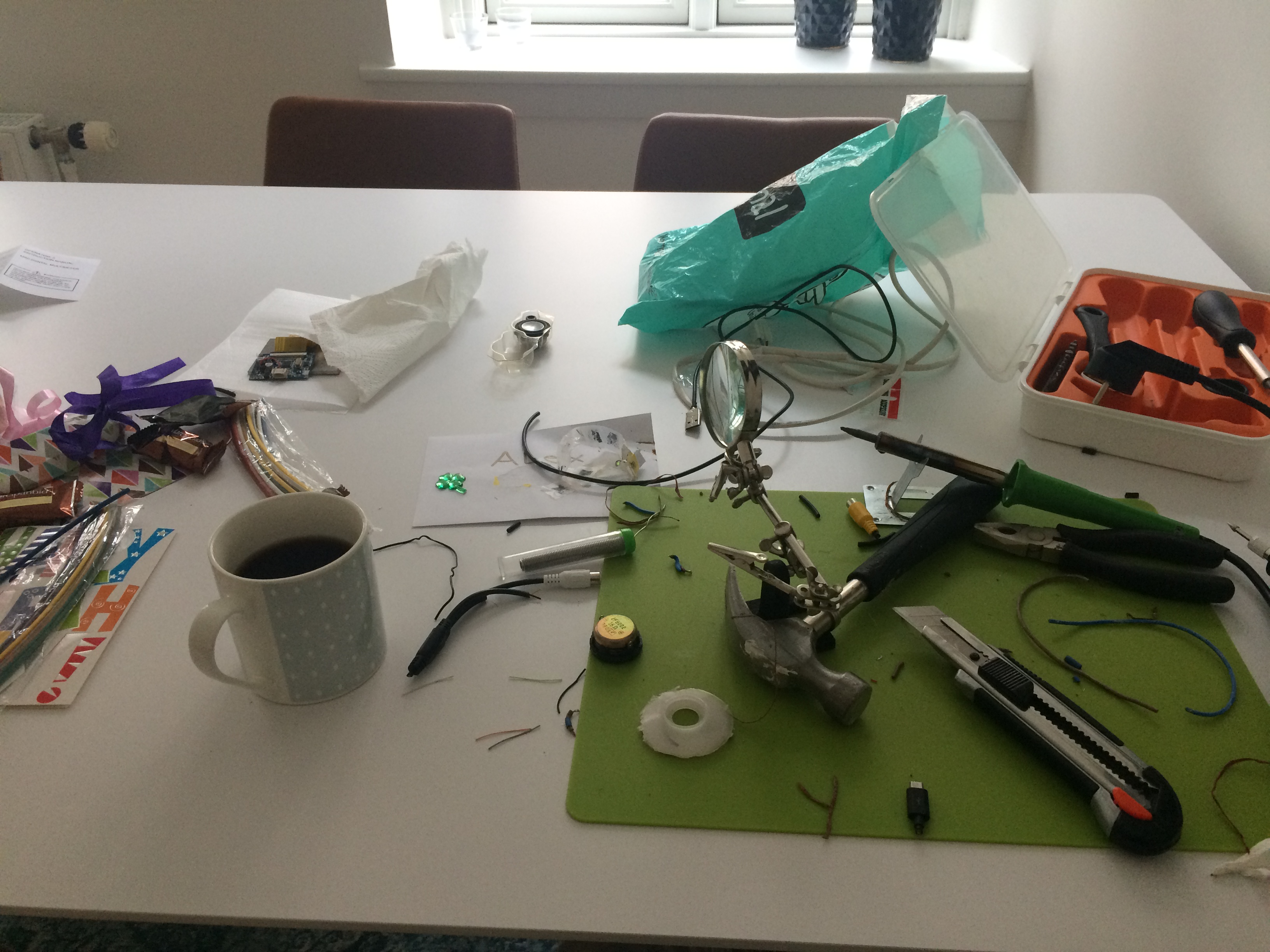

Nice and clean work space.

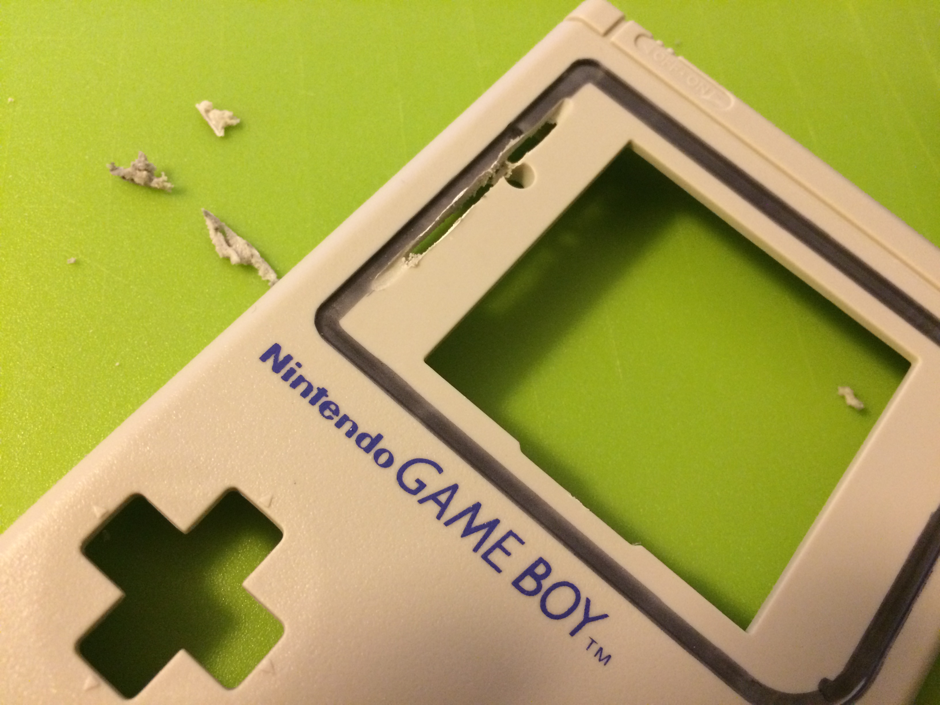

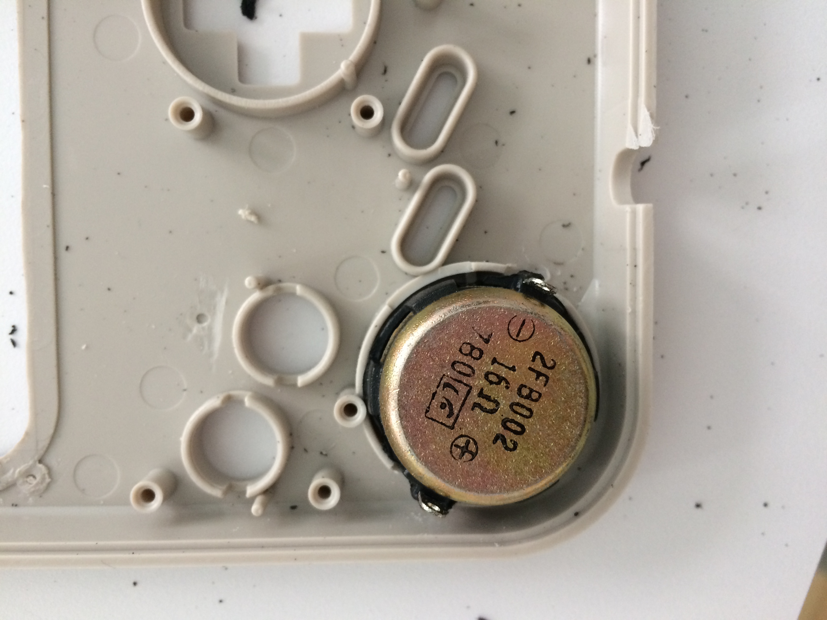

I had to trim of the edges of the speaker and the compartment around the speaker in the case, in order to have it fit. Can't wait to test it out!

Here's a picture of the modified speaker next to an unmodified version:

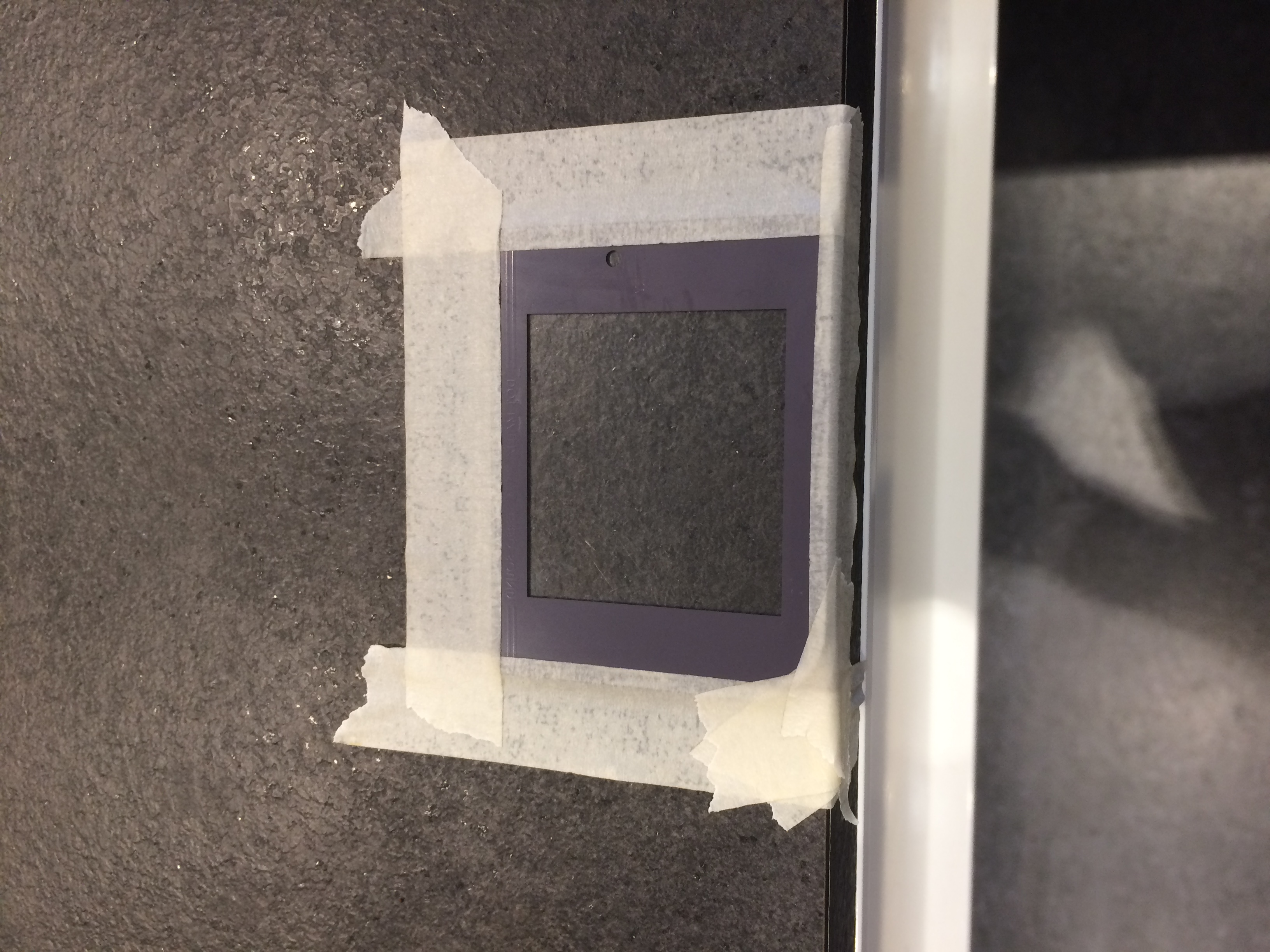

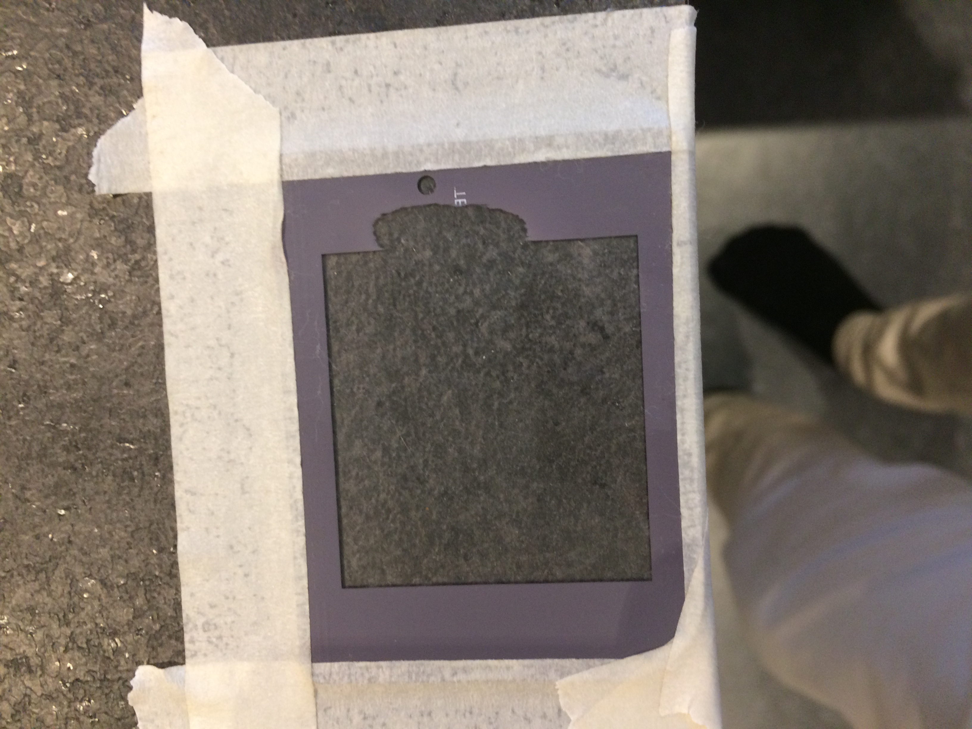

I've decided to clean the original screen protector with acetone. I won't be using it for this build. But i have enough materials for another build (once i've ordered Kite's Super AIO).
2016-10-09 17.22.36.jpg (1.61 MiB) Viewed 11504 times
2016-10-09 17.24.42.jpg (1.35 MiB) Viewed 11504 times
It's a lot of work. I should have used a mask and gloves.

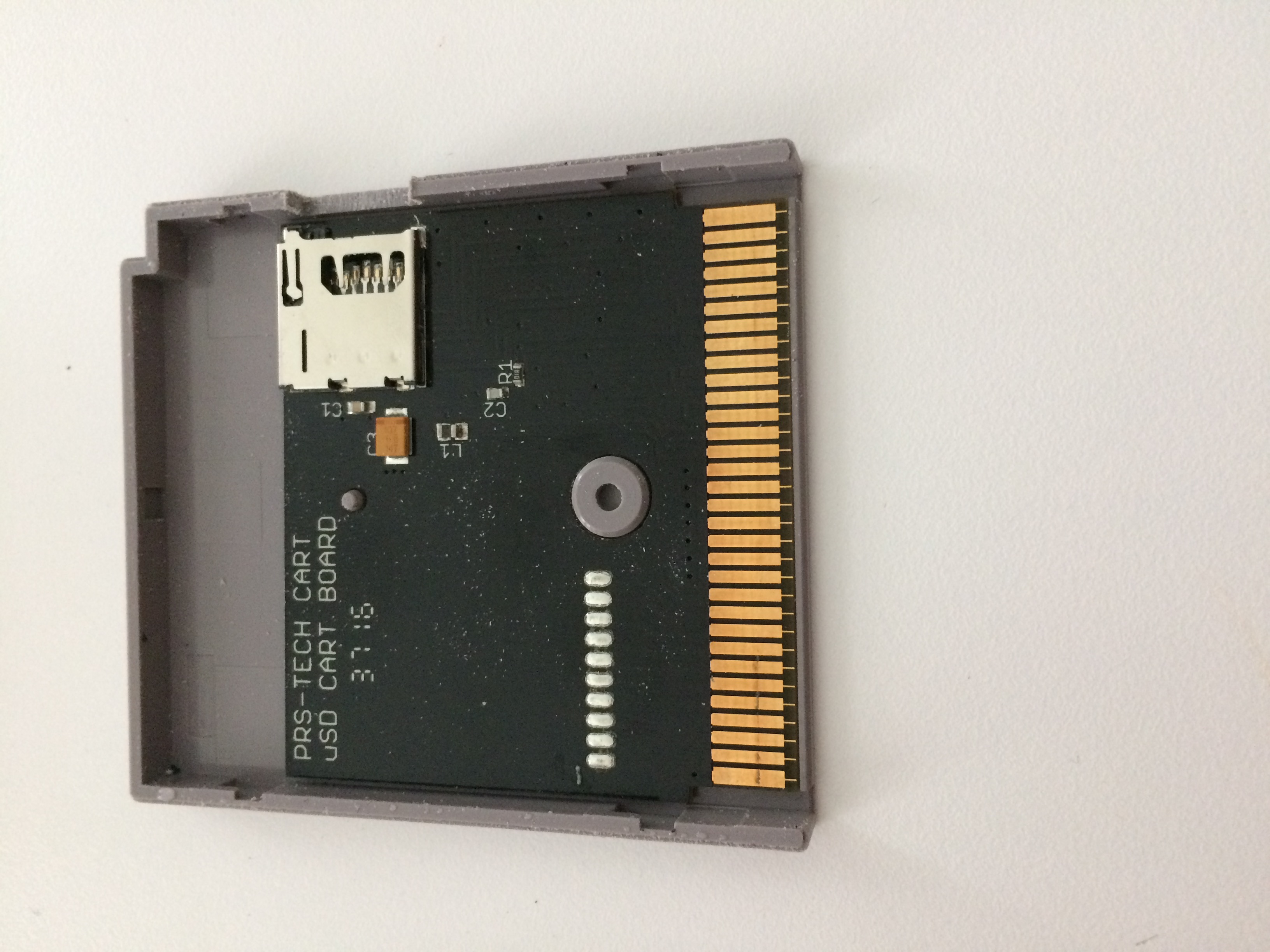

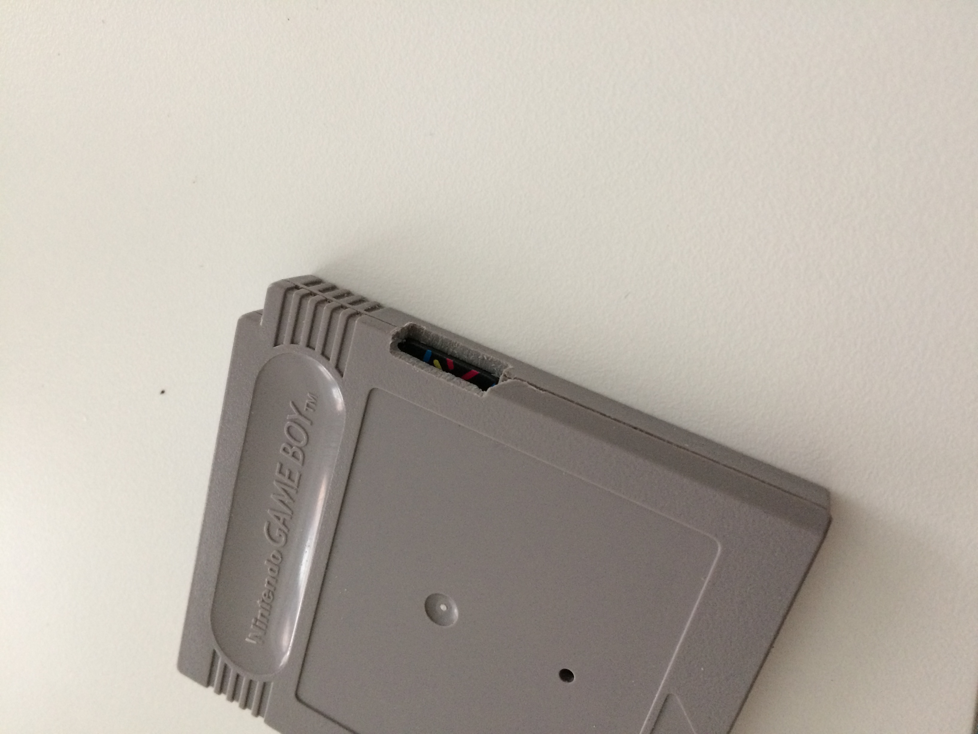

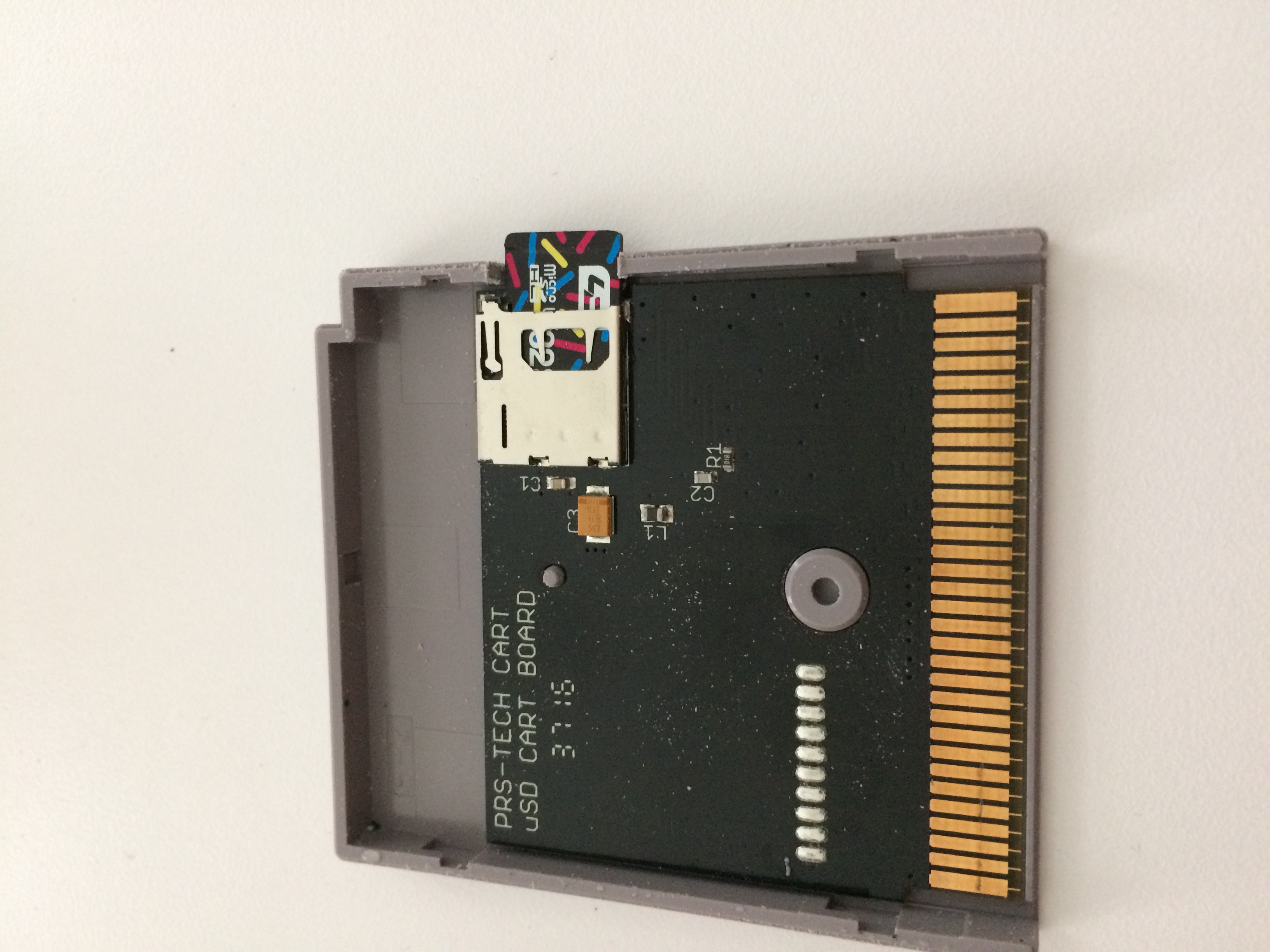

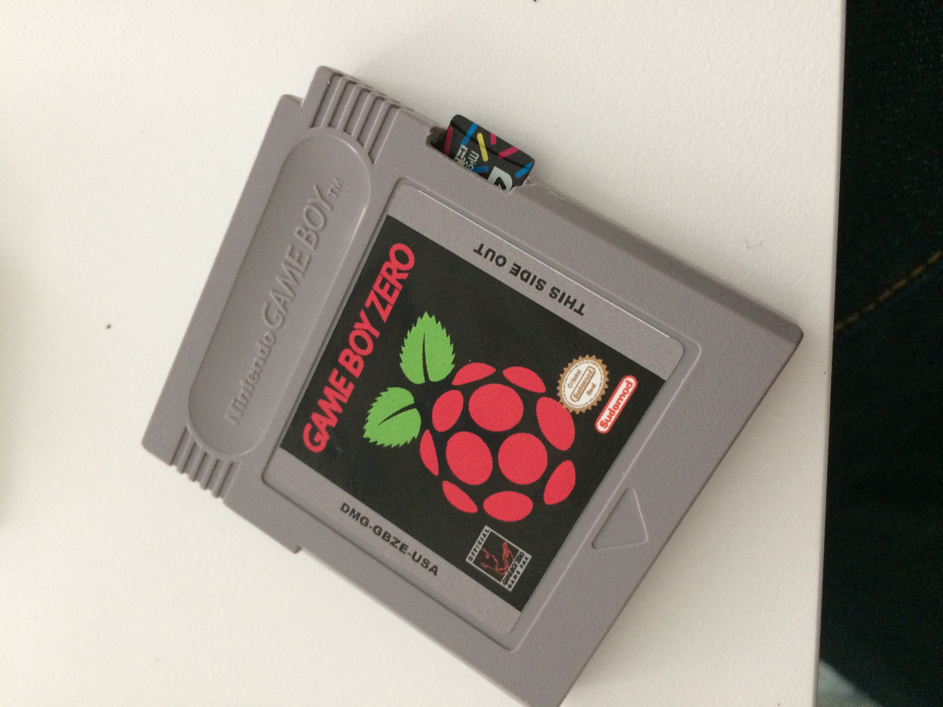

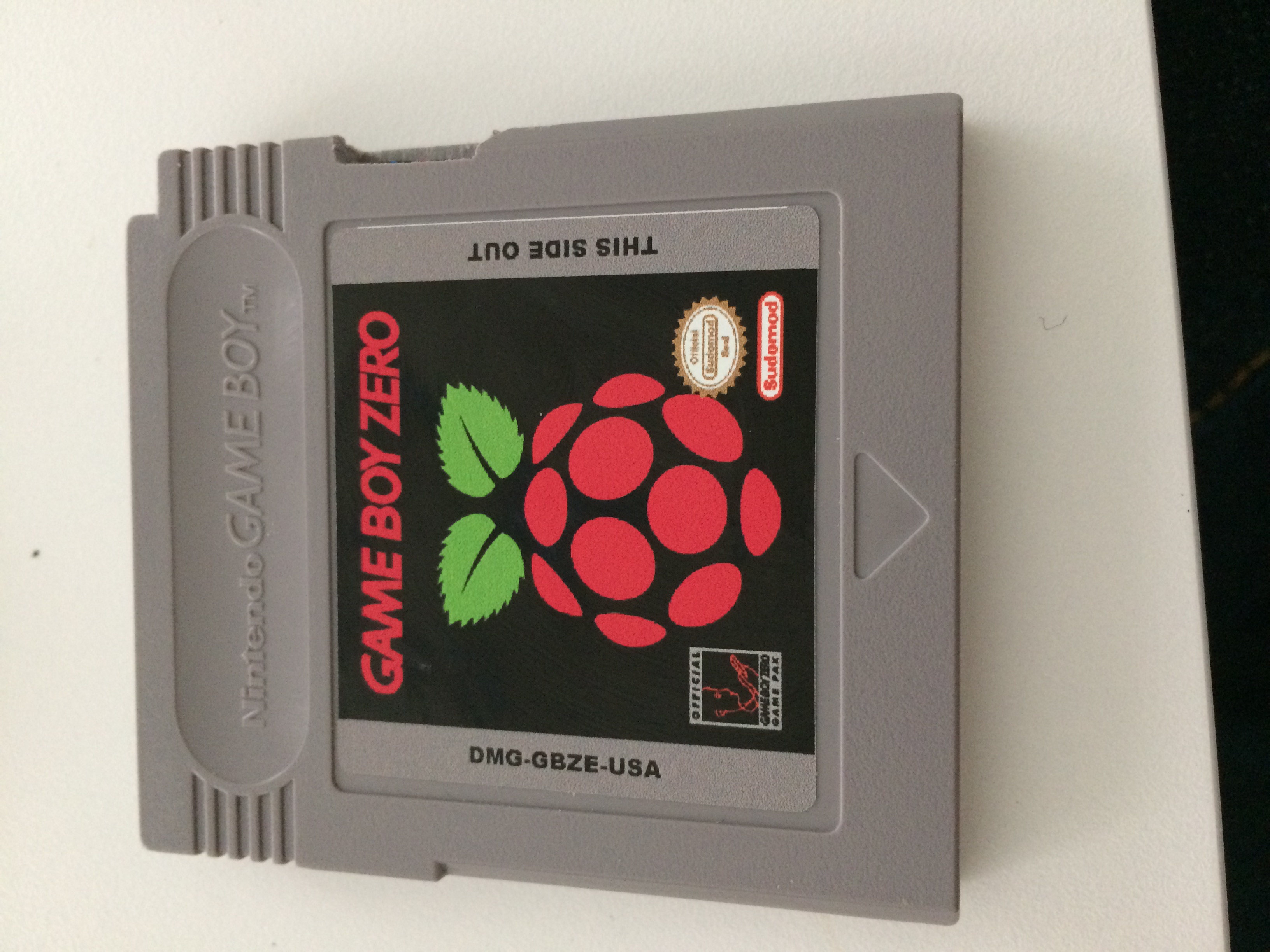

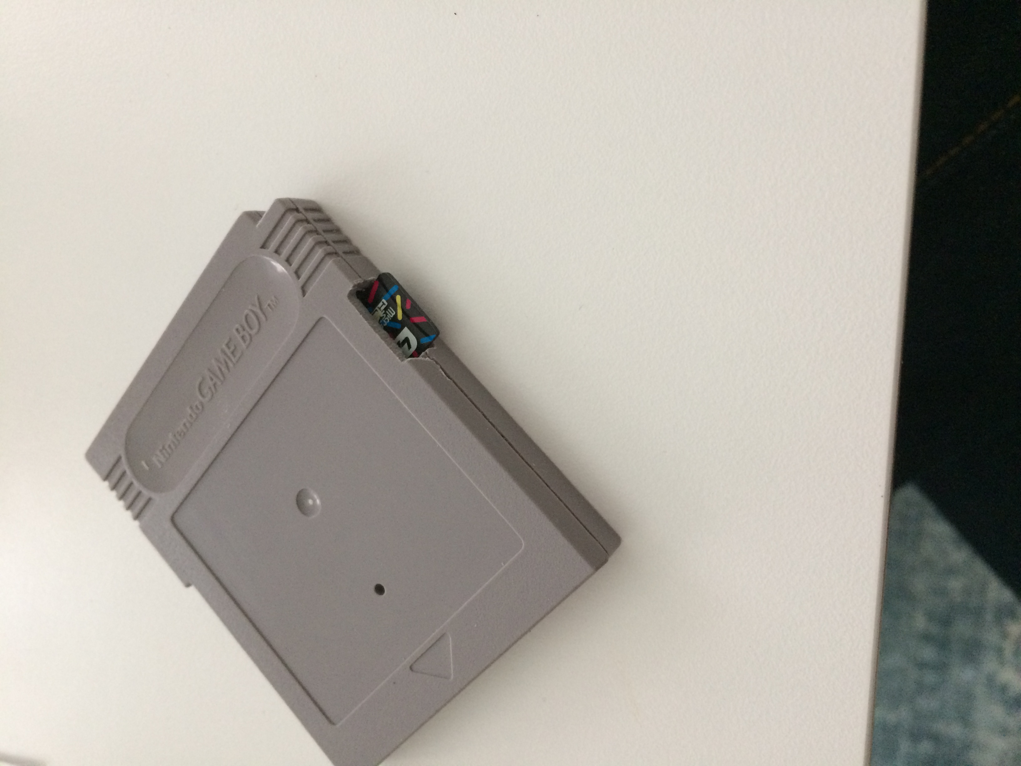

I got the SD cartridge slot from Prerunnerseth. Unfortunately the envelope wasn't protected so the SD card holder got quite banged up. Fortunately i was able to save it using a couple of tweezers.
[spoiler="The game cartridge"]
2016-10-13 14.44.17.jpg (952.53 KiB) Viewed 11504 times
2016-10-13 14.44.28.jpg (956.02 KiB) Viewed 11504 times
2016-10-13 14.44.38.jpg (1.1 MiB) Viewed 11504 times
2016-10-13 14.44.45.jpg (1.13 MiB) Viewed 11504 times
2016-10-13 14.46.44.jpg (1.04 MiB) Viewed 11504 times
2016-10-13 14.46.52.jpg (947.2 KiB) Viewed 11504 times
[/spoiler]
I think it looks pretty good.

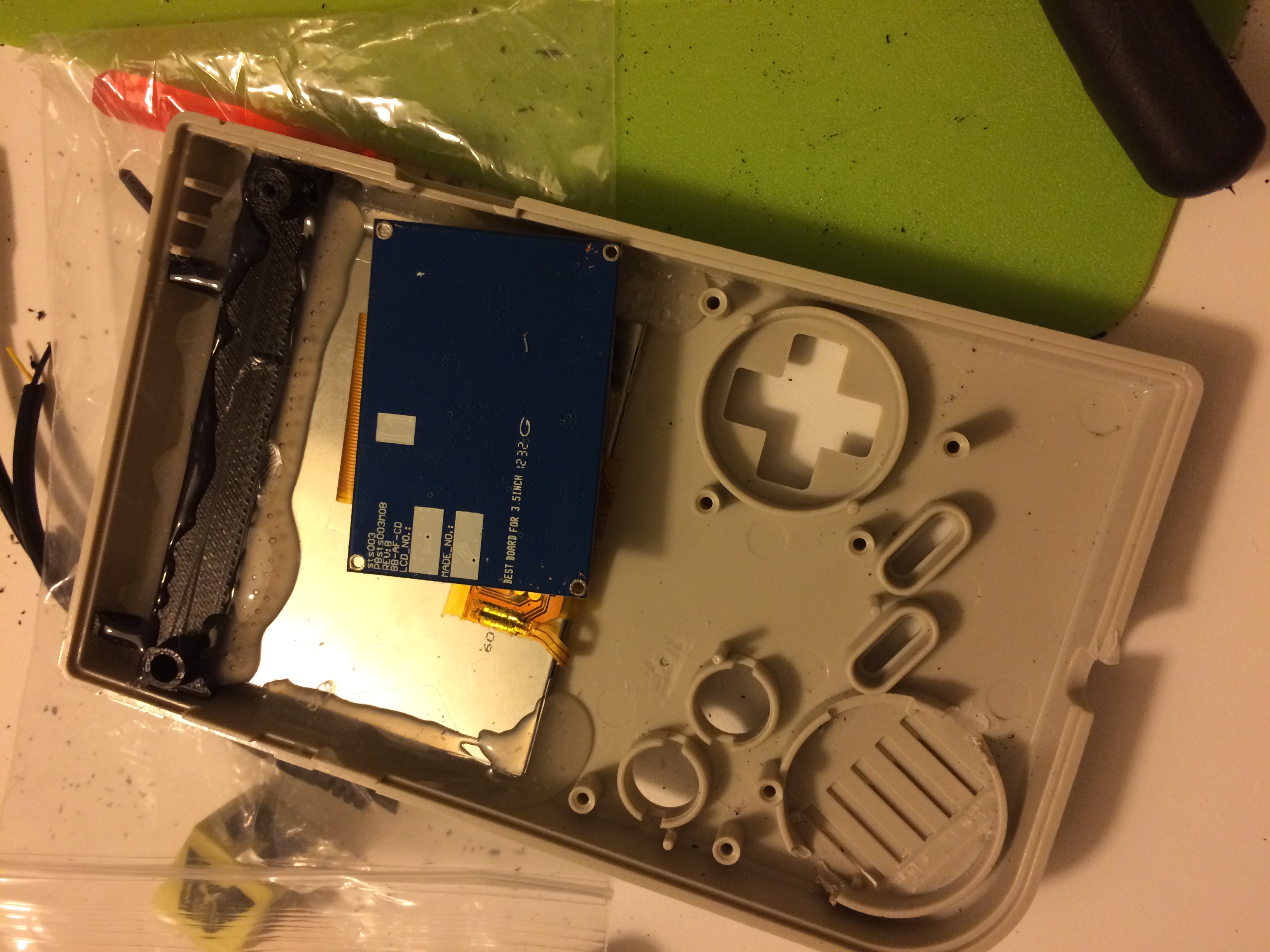

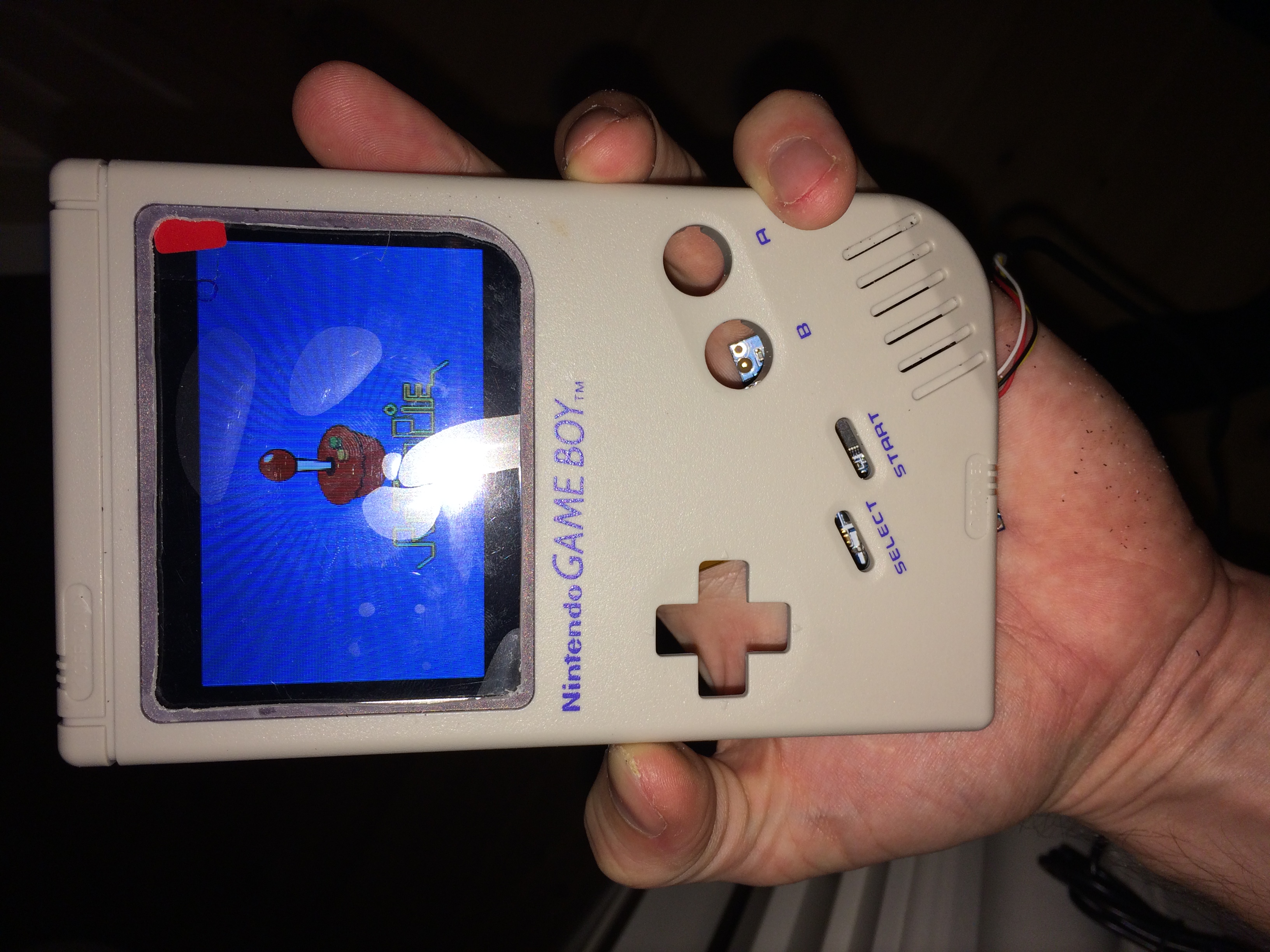

I glued the screen (and screen bracket) in place. Might have to move the driver board at some future time.
2016-10-18 23.21.09.jpg (1.06 MiB) Viewed 11503 times
How it looks so far.
2016-10-18 23.03.39.jpg (1.95 MiB) Viewed 11503 times
I can't get any further until Helders AIO arrives. Hopefully that will be any day now.

Do you intend to use just the two buttons A & B?
If not be careful when drilling the X & Y buttons otherwise you might damage the screen. As I see it you will get your screen cover in bits of plastic when you start drilling for the X &Y or anything you need to do (modding) of the top case.

vnman wrote:Do you intend to use just the two buttons A & B?
No, the intention is to drill X and Y once i get Helders board. I think i have to remove the glue and screen before i drill. It shouldn't be that troublesome though.
As I was drilling the holes in my build, my screen was already glued in and the tension on the case cracked the screen ;)
I would first drill the holes, put in the button pcb to see if everything lines up with the spacing and then test fit the screen to check if any of the button holes become inacessible (because that's what almost happened to me). Then I would glue in the screen and [mention]wermy[/mention]'s 3d printed bracket, so that everything fits without wrong spacing.

Does it come out clean when you use acetone? Or was it hard? I have a spare screen protector, I want to clean it and use it too.

I wasn't hard, but it takes 10-20 minutes of scrubbing with a cloth. But afterwards it's perfectly clear. I'm waiting on some paper from China that allows me to print stickers. When it arrives i'll print a screen surround and hopefully it'll look as good as dominators :)
