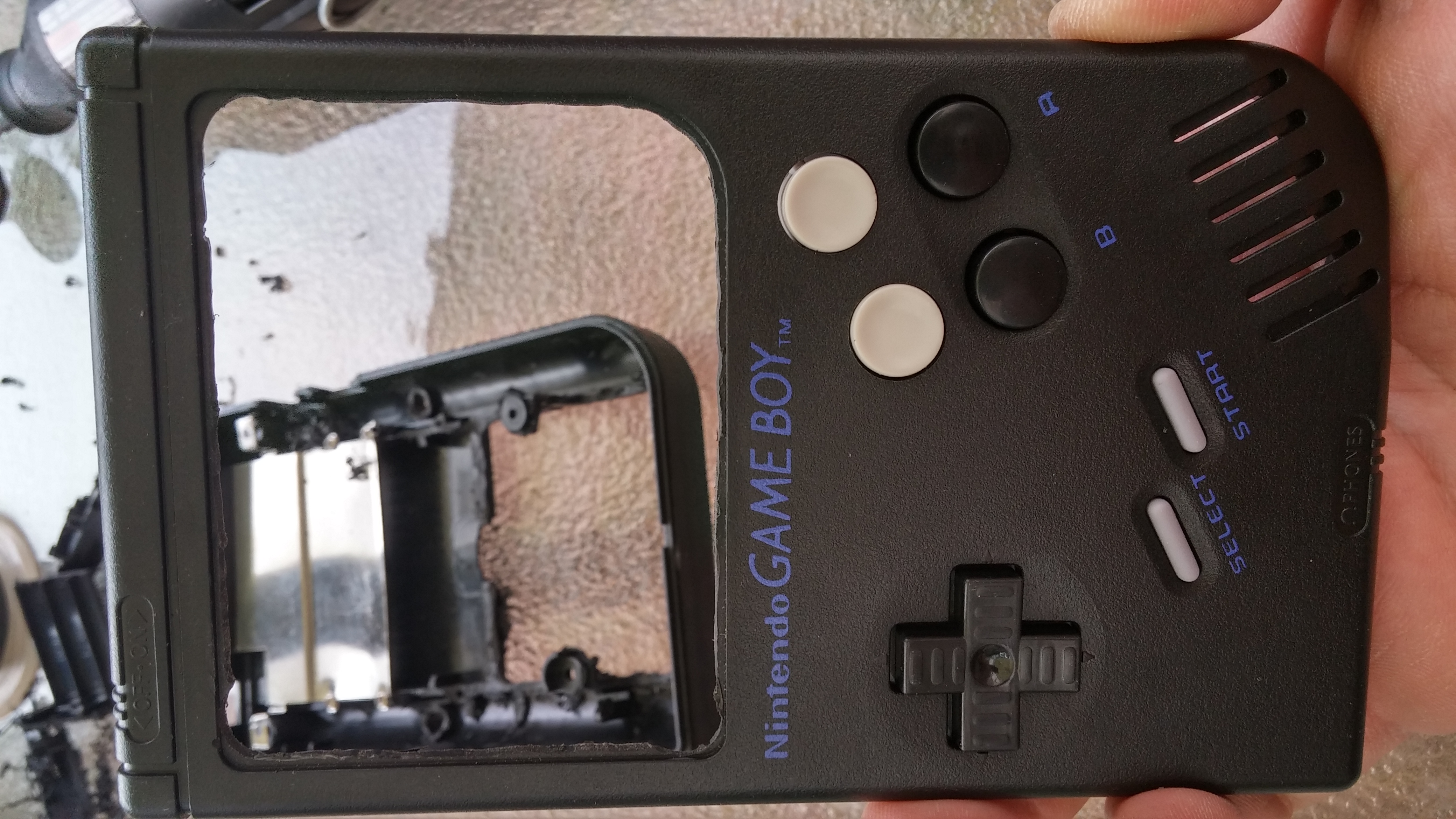

Took me about a week to complete I'm pretty happy with the end product. I had a lot of fun tinkering with the RP0 position making sure that the HDMI port was evenly placed same goes for the volume wheel and the usb charging port.
Parts I used:
- Acrylic screen protector(protective film is still on)
- Galaxy S4 Standard Battery (2600mAh) installed on the cartridge compartment
- Helders GBZ all-in-one 2.0 board
- Adafruit 1000c powerboost board
- Wermys 3D printed parts
- Etc.

That looks really good! Is that hdmi port the RPi0's, or did you mount the RPi somewhere else and use an extension? I'm trying to figure out where to mount mine, but I want access to both the HDMI port and SD slot.

CarbonKich wrote:That looks really good! Is that hdmi port the RPi0's, or did you mount the RPi somewhere else and use an extension? I'm trying to figure out where to mount mine, but I want access to both the HDMI port and SD slot.
That is the actuall Rpi0 HDMI port I decided to use a 32GB sd card so I don't have to worry about swapping sdcards out
