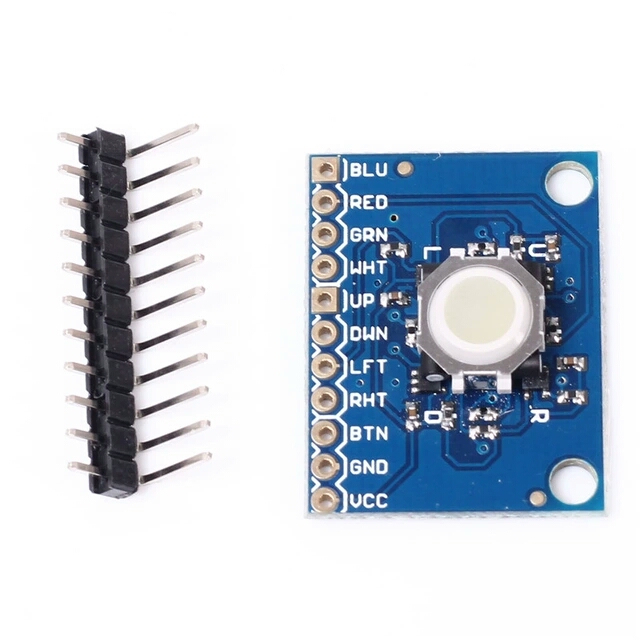

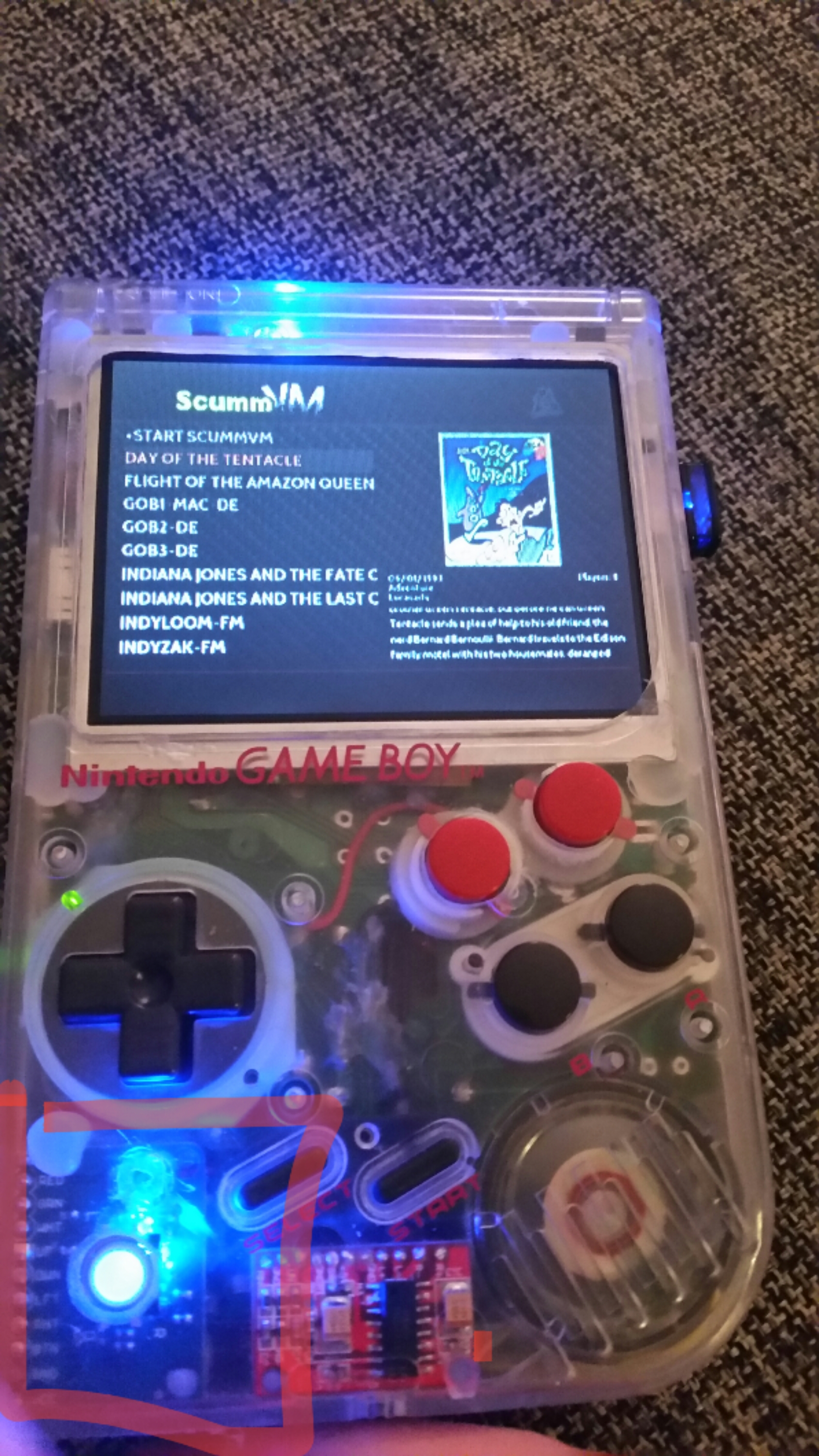

using the D-pad in ScummVM is just pain, that was the reason for implementing a blackberry trackball (~5€@ebay as breakout).
The device itselfe works fine just a bit "unsmooth", but much better than D-pad controlls.
Teensy Code with "up, down esc, enter" for easier retropie menu navigation and mouse control.
Moving the trackball turns on the LED light (RGB+white).
The code is still beta, but works perfectly fine for me. A mixure of wermys code and tennsy example.

This is a very cool idea. Do you have any other information? Which trackball did you use? There are dozens of different parts on eBay and it seems some of them are just the ball and not the encoder. How did you wire it?
dezent
Posts: 15
Joined: Tue Aug 30, 2016 6:10 pm
Been thanked: 12 times
Re: GBZ w/ BlackberryTrackball --> ScummVM
Post by dezent » Mon Oct 31, 2016 12:46 am
I have used this one.
ICSH044A icstation Blackberry Trackball Breakout Board
http://s.aliexpress.com/yuyIriuy
Power comes from teensyLC Pin 17 (the one on the oposite side of USB Port) ground is also connected to teensy.
Mouse directions are connected to Pin 15,16,18,19.
Left
Mouse Click is Pin 13
Pins 20,21,22,23 are used for the Trackball LEDs
They glow for around 1 second after Last Input.

likewise I'd be thankful about a short review concerning the responsiveness and accuracy of this device. is it possible to navigate diagonal? and does your code provide an option of switching off the LEDs entirely?
I'm really curious about this idea. planing to implement a similar workaround myself. thought it'd be nice to have the trackball just on the backside of the GBZ to keep the front "clean".
