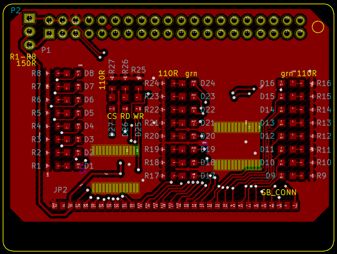

So I've mentioned in on my build thread and in a couple of other places.... I have a prototype breadboard setup to read gameboy/GBC cartridges directly to the Pi. I've finally got my stuff together and routed out the first prototype PCB to have a standalone Pi cart reader HAT (well not a real HAT as it won't have the eeprom but whatevs.)
It's not done yet, I have to take a few measurements to make sure everything is spot on before sending to OSH (or wherever...) but apart from that, all the hard stuff is done.

Looking at this with my not half asleep head on I can reduce the size of this board by about half, with better component positioning, so I think I'm going to be re-working it totally tonight rather than shipping it off as is... it'll save me a load as OSH park charges by the square inch ;)

I'm nearly done re-routing this and with just rotating one of the chips 90 degrees, and moving the LED's around I've got the board down to the size of a PiZero with much neater routing so yay! need to re-do silkscreen labelling and then it's done!
