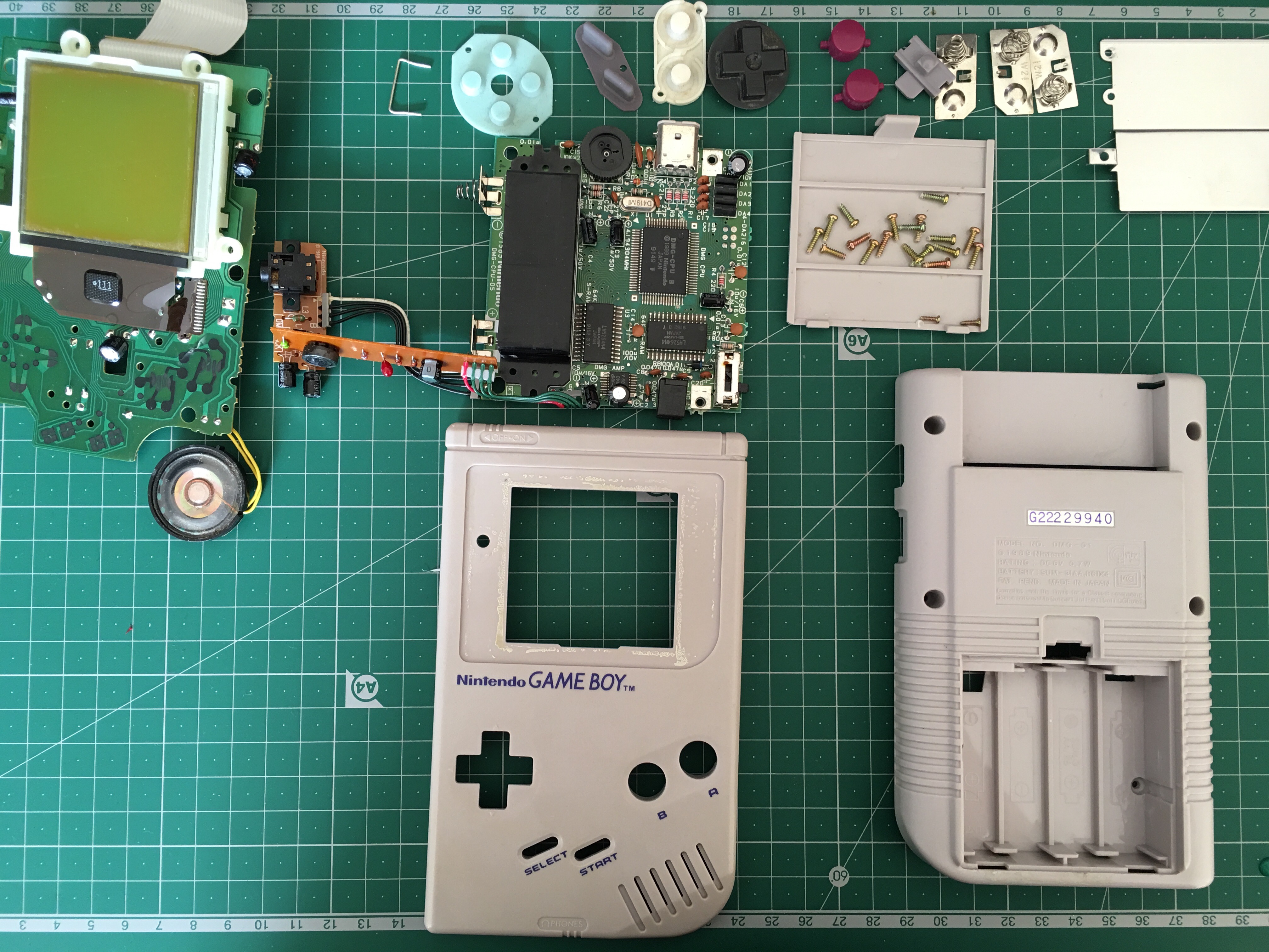

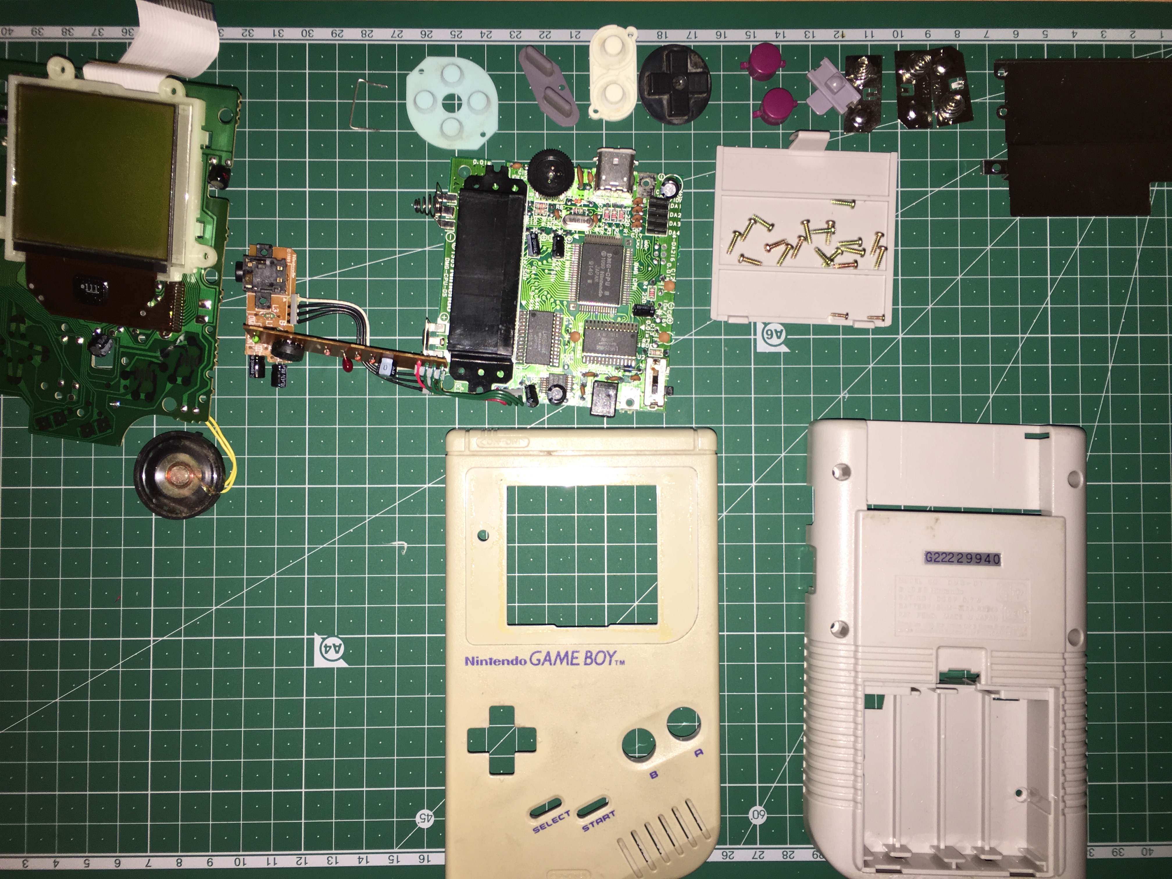

So far I've taken apart the gameboy and used peroxide to reverse some of the yellowing on the case.
Before:
After:
So far I'm reasonably happy with the results. That was just from a few hours in the garden this afternoon. You can tell from the photos that the front of the case is a lot better (that back was pretty good to begin with) but close up there is still a difference between the two.

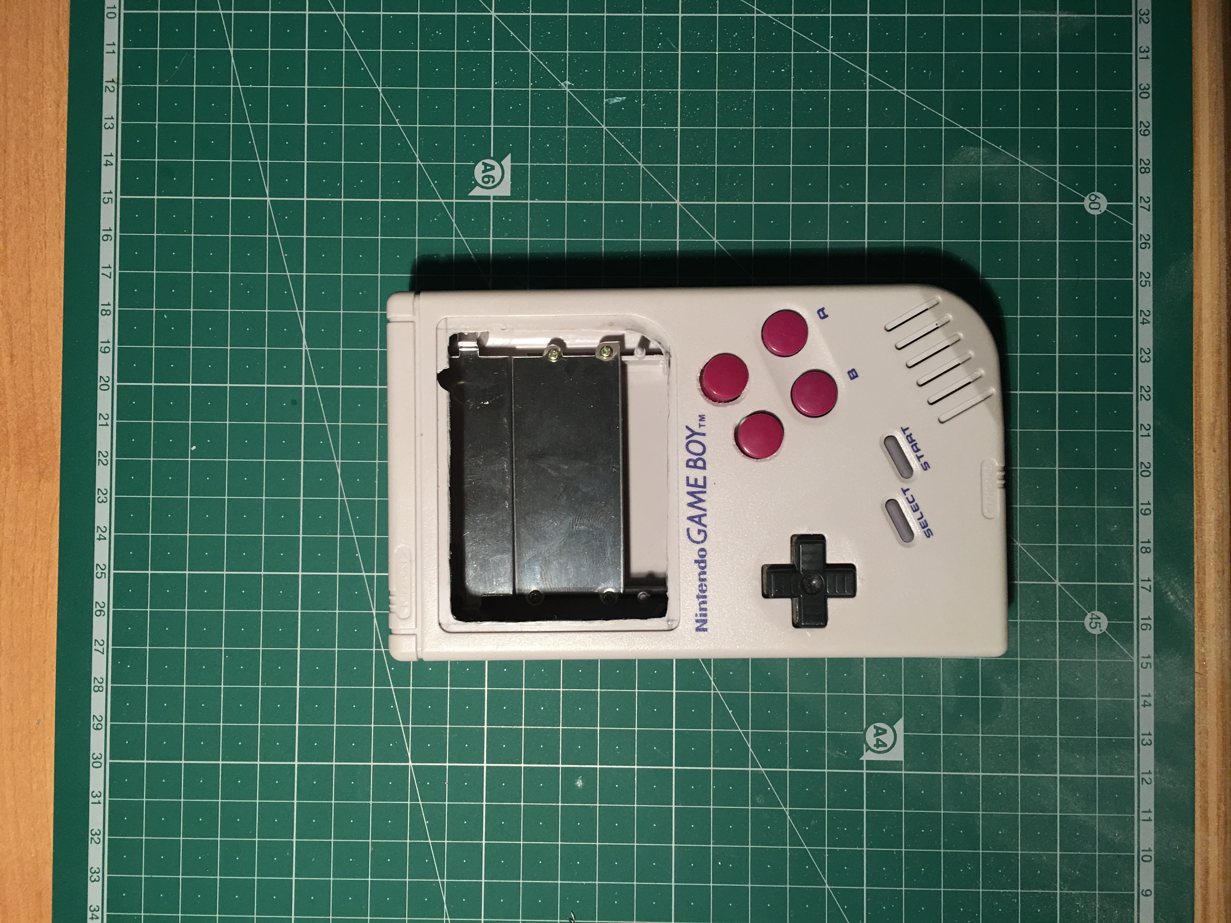

I put the front of the case back in the sun for another hour or two with peroxide, and it seems to match the rear of the case now.
I've now made most of the case modifications - dremelled down the screw posts for l/r buttons, widened holes on the side of the case for USB and micro USB ports, widened space for screen and drilled holes for x/y buttons.
I left a small ledge around the edge of the display area to attach a screen protector - once that arrives I'll file down the edges further to neaten it up.
You can see I made a small mistake with the dremel at the top of the display - I'm hoping I can cover that up, perhaps by painting a black border on the inside of the screen protector.
Finally, I removed some components from the pcb and cut it down to size for the buttons. I've temporarily screwed it into the case to see how everything looks.
One thing I've noticed is I definitely need button wells for the x/y buttons. I bought a spare set of DMG buttons to use off eBay as I wanted the colour to match but now I have to find button wells from somewhere.
