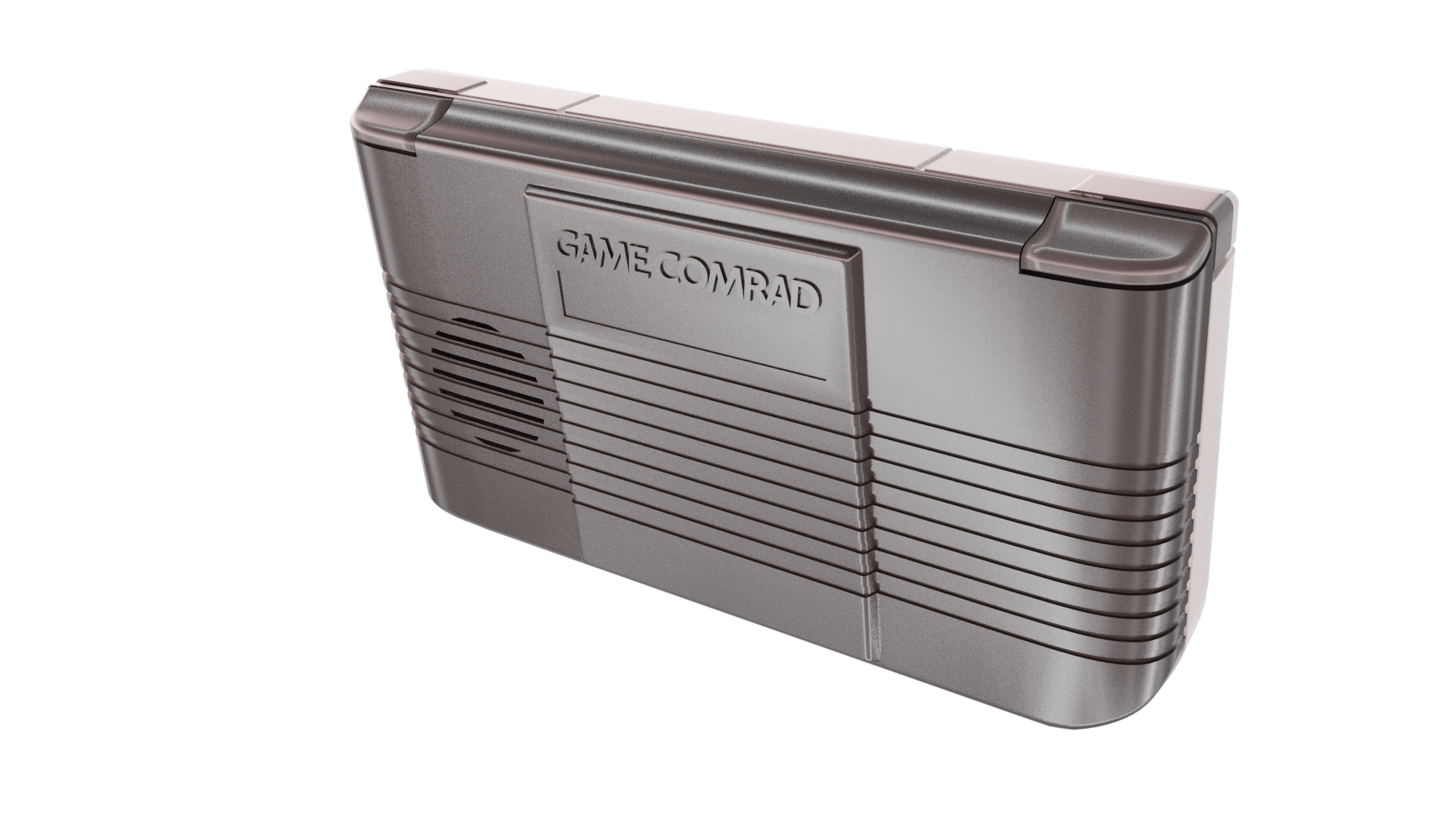

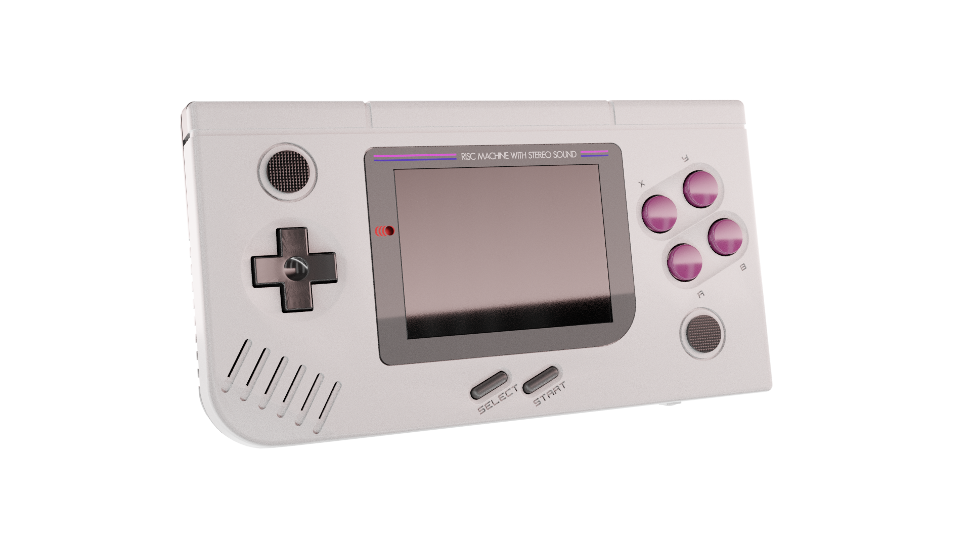

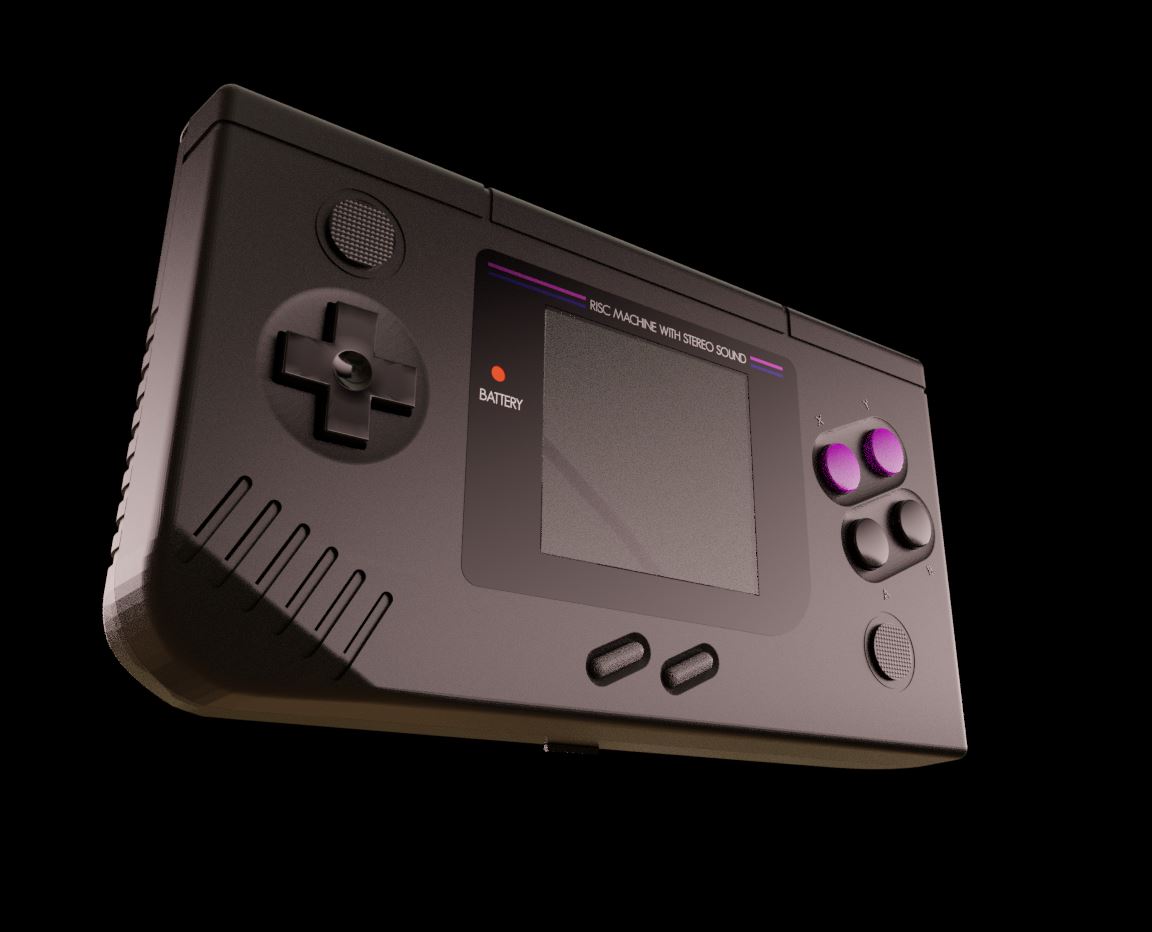

Hi everybody! Today I present you a little project i have been working on for a while now: A custom gameboy case in landscape format for 3D printing on my DLP printer.
I'm about 70% done with modelling the case
Planned features:
- Compatible with original DMG buttons, display lens and battery LED
- Raspberry Pi 3A+
- AB/XY, L1/R1, Start/Select, D-Pad and 2xPSP-Analog stick
- Retro PSU
- (Cambles Safe Shutdown)
- Atmega32u4 micro for buttons
- 7500mAh LiPo (Mybuynow LG G3 battery)
- No Button PCB (Sockets for rubber dome tactilebuttons)
- lq035NC111 3.5 inch display using tinkerboys dpi board.
- HDMI directly accessibly
- PAM8403 Amp
- 2x GBA SP Speakers
As you can see I am trying to stick as close to the original DMG design as possible. Let me know what you think :)

Post by VeteranGamer » Thu Jun 28, 2018 2:50 pm
looks great....
cant wait to see this finish......
just one thing, whys the joystick just below the buttons
(would it not be more in keeping with the DMG for the speaker and joystick to swap places)

Post by fdeluxe » Thu Jun 28, 2018 3:05 pm
You mean I should place the analog stick below the D-Pad? I own an original PSP where the analog stick is placed right below the D-Pad and I never liked that you are forced to choose between D-Pad and analog stick to steer your character.
Placing the below stick under the action buttons enables the player to simultaneously use the D-Pad and the analog stick while still be able to access the shoulder buttons. This comes in handy when playing FPS games like Quake 3.
I know that it somewhat breaks the DMG design, where the rounded corner is on the right side. Just see my shell as an original DMG shell rotated 90° clockwise :P

Just out of curiosity, if you are designing a custom case, why are you sticking with the DMG? You could design literally anything... do the ergonomics still work for holding / playing a gameboy in landscape orientation?

I guess its nostalgia :D Plus I really like the Style of old handhelds and edpecially the DMG. Its extremely recognizeable even when stretched to another format. Another thing is by offering compatibillity to DMG buttons and screen lens I get good haptics and a very consumer-product-like look.

Post by Helder » Fri Jun 29, 2018 3:50 am
Nice job but I have to agree with VeteranGamer about the analog stick placement. Dreamcast and N64 which the Pi 3 can emulate well will be awekward with the analog stick placement where it is.
Might I suggest a second stick below the Dpad so you have options for both preferences and other setups people like.
Some of those pictures in color remind me of the Sega Game Gear.

Post by fdeluxe » Fri Jun 29, 2018 4:50 am
I thought about adding a second analog but it wont really fit without make the shell a little bit taller or changing the design of the speaker. Maybe if I switch the dmg dpad with a pocket one...

Post by fdeluxe » Fri Jun 29, 2018 7:30 am
Okay you convinced me. This is how I am going to implement it: Kinda reminds me of an old school nintendo switch now :D
