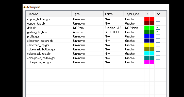

Post by WoodMill » Fri Jul 05, 2019 3:37 pm
VeteranGamer wrote:
Sun May 26, 2019 8:03 am
WoodMill wrote:
Sun May 26, 2019 7:42 am
So I've looked over the Github project. Spec'd out all the parts. Looked at Oshpark for the PCB. Looks like its going to be just shy of $60 for 3 boards. Is there a better place to get the PCB made?
https://www.pcbway.com/
$5 (10 boards) + shipping (just go for the basic around $6-7, it doesnt take that long...around the same as oshpark)
create an account....
upload the file....
pick the colour of the board you want....
pay...
and wait....
you should have them in around two week (thats the average I get)
So I've tried PCBway, and the file Errors out. This is the message they give me: "Could not open the file.We need gerber file in fomat of RS-274x" And they attached this photo.
