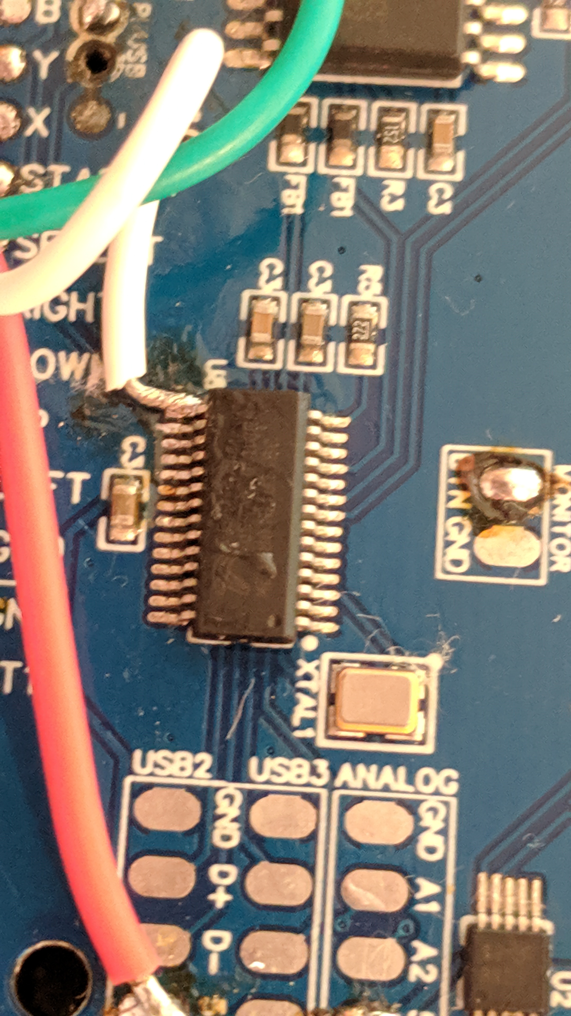

In trying to reflow the USB pads, I managed to bridge them. I was unable to fix that problem with any of the resoldering tools I had, so then came the sphincter-clenching process of removing the Pi from the board. After the carnage was over, the USB - through-hole & test pad didn't survive. Everything else seems to be functioning.
The microUSB plugs still work okay in the Pi Zero, so I'm going to use those to reconnect instead of the pads. With the original connection gone, is there somewhere I could solder the USB - wire onto the board to get back up and running? I'm guessing the lower-left pin on U8, opposite from pin 1?

Correct. The lower left pin is for D-. The pin next to it is D+. Those go to the Pi.
On the opposite side, the fourth pin from the left is D+ going to the sound chip, and the one next to it is D-. You can see both of those going through the FB1s into the CM102S+. (the next two go to the external USB jack, and the next 4 go to the pads on the right) From the picture it looks like all of the solder joints on the USB chip are good.
The CM102S+ gets its power from GPIO 2 (upper-right corner) passing through the Pi to the top "PI PWR" pad. So you'll want to make sure that one reads 5V. If it doesn't, then the sound chip isn't getting power, which would explain why it didn't show up with the lsusb command. It looks like all of the solder joints on that are still good too.

Welp, now I can't even get lsusb to even show the Terminus hub. The D+ & D- pins have continuity with the pads on the Pi, so I'm not sure what's up. Got some FE1.1S's on the way. Might as well try the nuclear option and swap out the chip altogether... (EDIT: The Terminus USB hub showed up again after I replaced the chip that I probably fried)

The left side of the capacitor right below the hub should be reading 5V, as should the red wire.

Ultimately, it seems that my no-sound/no-USB issue was probably related to a bad soldering job to the 5V pad on the back of the Pi (my fault). As a result, power was not making it to the USB-A plug or the sound chip. I probably should've suspected this, because when it was working previously, the unit would cut power if I squeezed it just right. This was probably flexing the PCBs enough to intermittently lose contact with my shoddy solder joint.
Because I fried that 5V pad & the connected trace on the GPIO Assist board while separating it from the Pi Zero, I ended up needing to run a jumper from one of the 5V pads to the bottom pad on the capacitor next to the USB-A plug. After that, the USB was back up and running.
I also found that separating the boards broke traces to the A button GPIO and the safe shutdown keep-alive GPIO (not surprising -- that was a brutal process with the tools I had available). A jumper from GPIO 16 <--> the A button pad on the Button Board fixed the A button. A jumper from GPIO17 <--> lower-right pin of U7 on the GPIO Assist fixed the safe shutdown.
