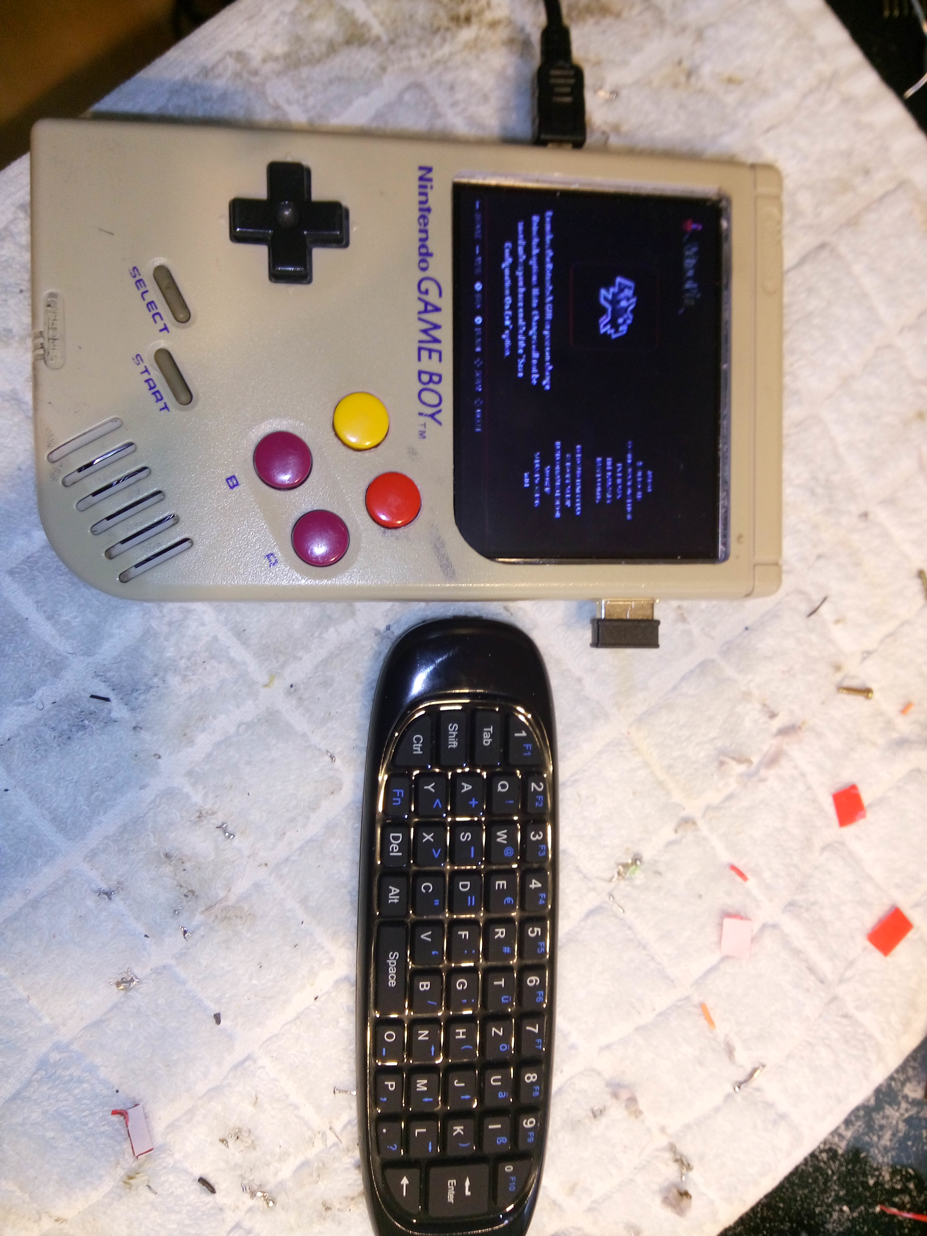

Post by smoki86 » Tue Aug 09, 2016 2:28 am
Ok...back to the drawing board :)
The Hub arrived and is working well.
It took me some time to get the retrogame app build and settings modified.
I tried mounting the USB in the built in file manager, copying the files, creating folders and modified rc.local.
That all would have been trivial if I did't use the Gameboy screen and a wireless presenter keyboard with german layout and no special Characters...
At the end I gave up at the last step, how important can a "&" at the end of the rc.local entry be? Well it starts the retrogame program and doesn't continue to boot.
After that I installed ubuntu to usb and edited the sd card in ubuntu...which took a few minutes and worked perfectly well. I could get the roms in that way too.
The good news
The PCB board works perfectly, roms are starting and everything is well!
The bad news
My layout doesn't work. The PI processor is directly over the display connector. The longer it runs, the worse the display gets with a very visible corona of dead pixels and distortions (after cooling down, it looks perfect again luckily).
If anyone has an idea what to do now...I can place it differently but then I will have to resolder most cables. I have some room between connector and processor, so maybe a heatsink and a fan?

@smoki86 Where can I find one of that mini keyboard that you have!?!?

Post by smoki86 » Tue Aug 09, 2016 6:57 am
@DeltaShadow
Good question :) I will post the model later today (currently at work).
But I really dont like it. A lot of special characters are not available.
Good point is you can use it like a laser pointer for the mouse. I played quake 3 with it yesterday (move with keypad on gameboy and aim with the usb keyboard).

Post by smoki86 » Wed Aug 10, 2016 2:21 am
Sorry, I forgot yesterday :)
It's Trust 19925
