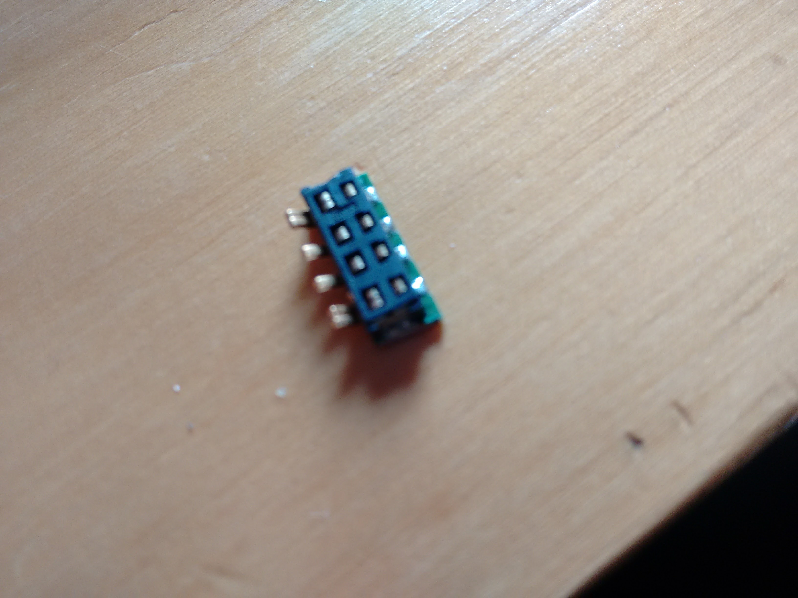

I've managed to salvage this battery connector from a phone I dropped in the toilet a few years ago. These are not pogo, but bendable pins and i can probably solder the wires to the back. Will it be good enough? (I'm sorry for the shitty picture quality but the camera of my phone is a little scratched)

Yes, you could make that work. Just make sure pins are the same pitch as your battery.
