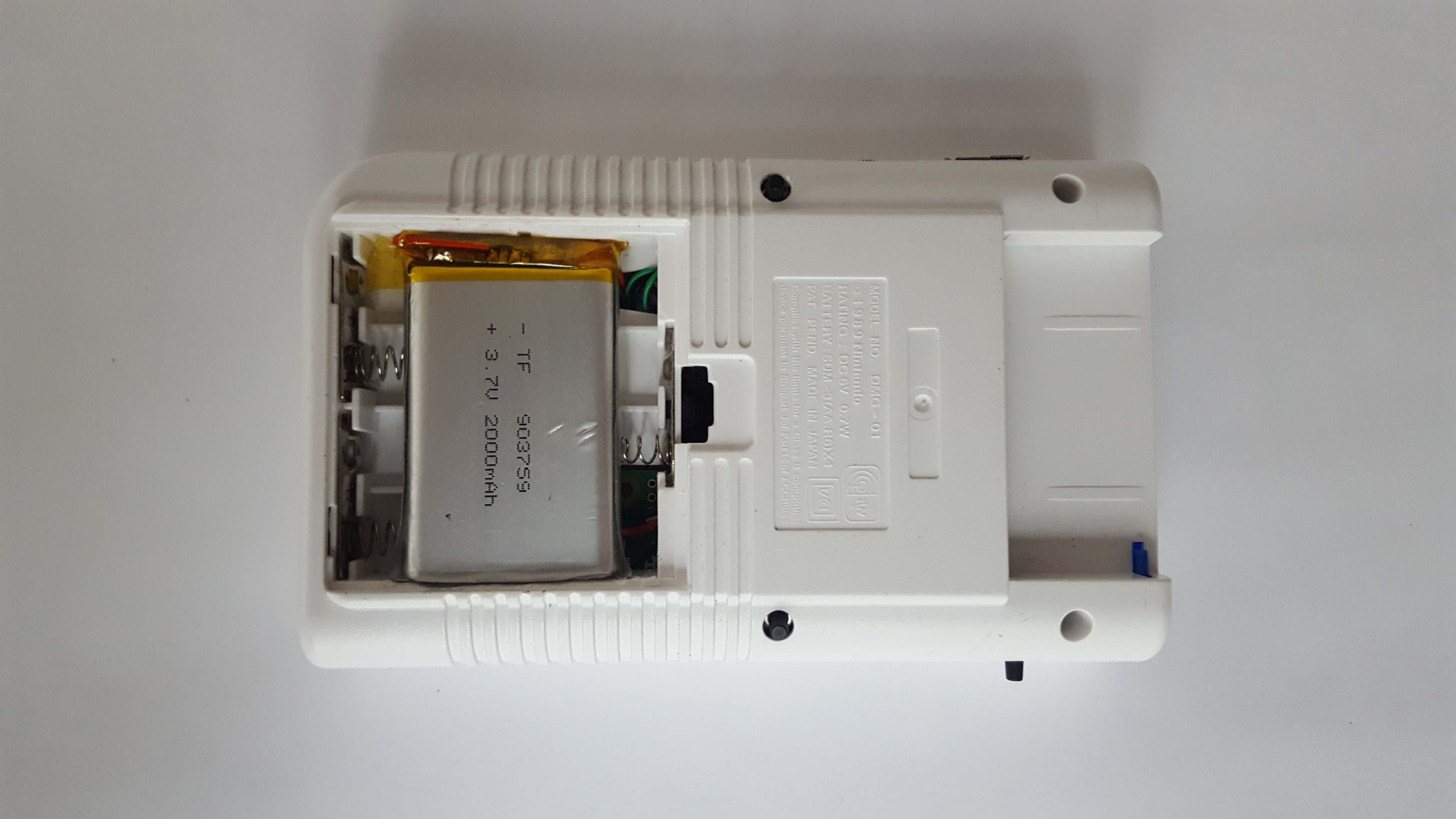

great build! I would like to know, which battery did you use? Any pictures?

I used a 2000Mah 903759 - basically identical to this - https://www.ebay.co.uk/itm/3-7v-2000mAh ... Sw-0xYZG5G
Except when I got them I managed to find 5 for like £20 which seems a really good price looking now... :roll:
Unfortunately I don't have any more snaps of that one as I gave it away, but the second one I did used exactly the same and it looks like this. As you can probably see I had to very slightly trim the side walls of the battery housing - but other than that it is pretty much untouched. The springs actually hold the cells in place really well and the door closes perfectly.

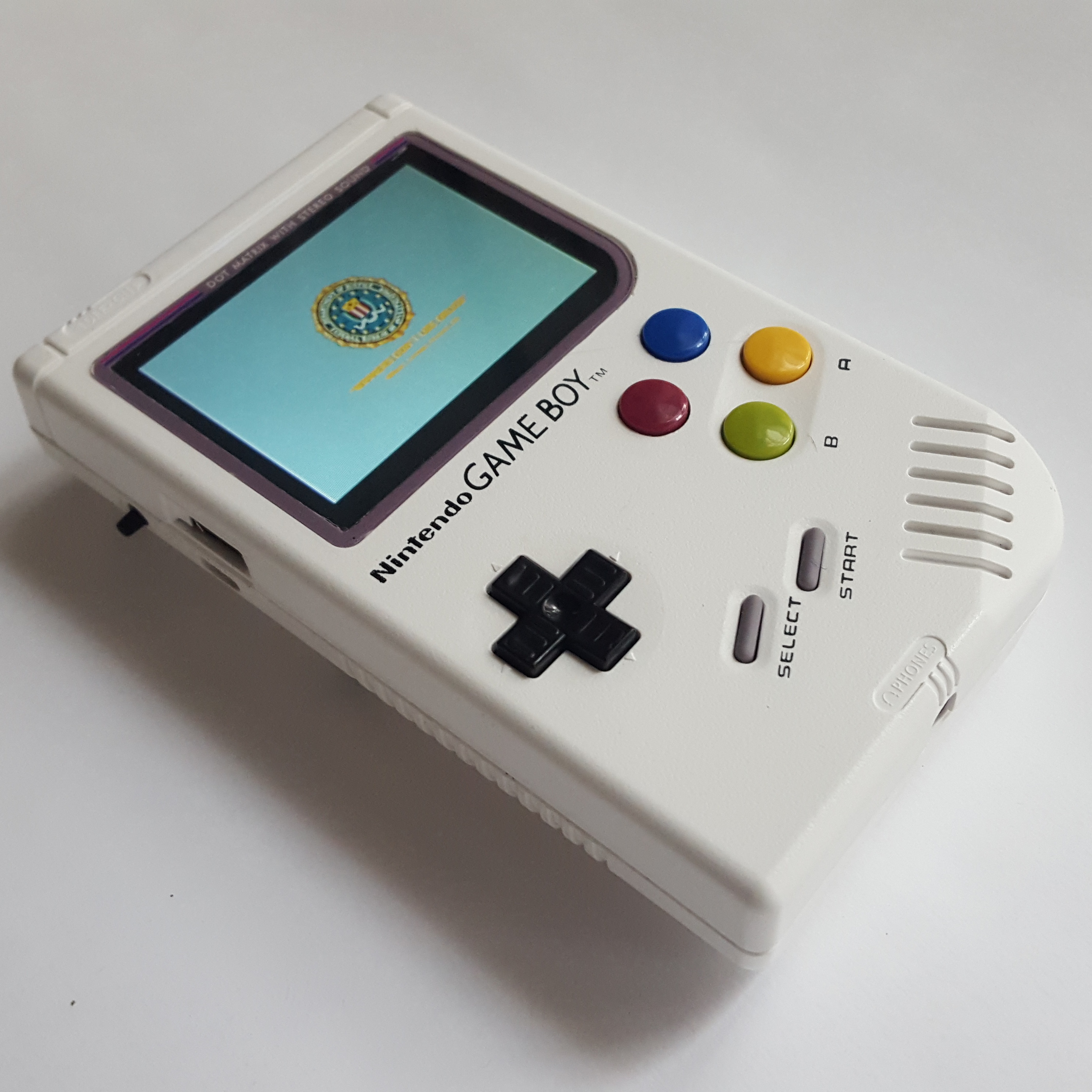

Which reminds me I should make a build thread of it too...this is what she looks like :D
fc-gbz-02
