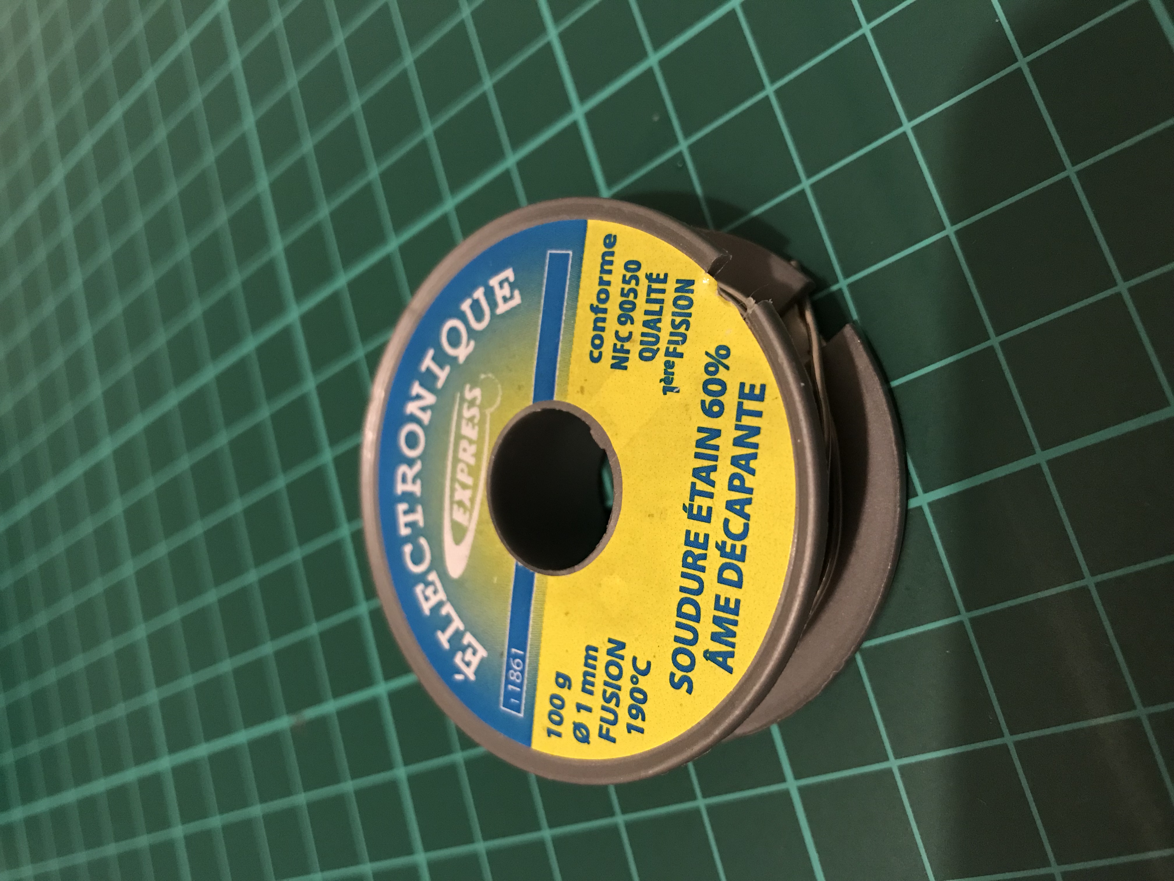

Also what solder did you use? The solder I bought isn't so.... Shiny.. but also feels like it clumps up.

The solder ? I’m using this... 60% tin, flux inside, the rest is lead (how much ? I don’t know)
But the real secret is a good iron, so i bought this pack from amazon
Soldering Iron,Kuman électronique 60W 220V https://www.amazon.fr/dp/B01KWZZSIQ/ref ... AmnjXDDtLC
and i can set the right temperature for the right soldering work (like ground pads requiring more heat) i’m soldering around 270 degrees and for ground pads, around 350... also, your tip must be very clean, i’m using brass sponge in a tin with rosin flux inside to perfectly clean the iron (look at the link above, all is in the pack)

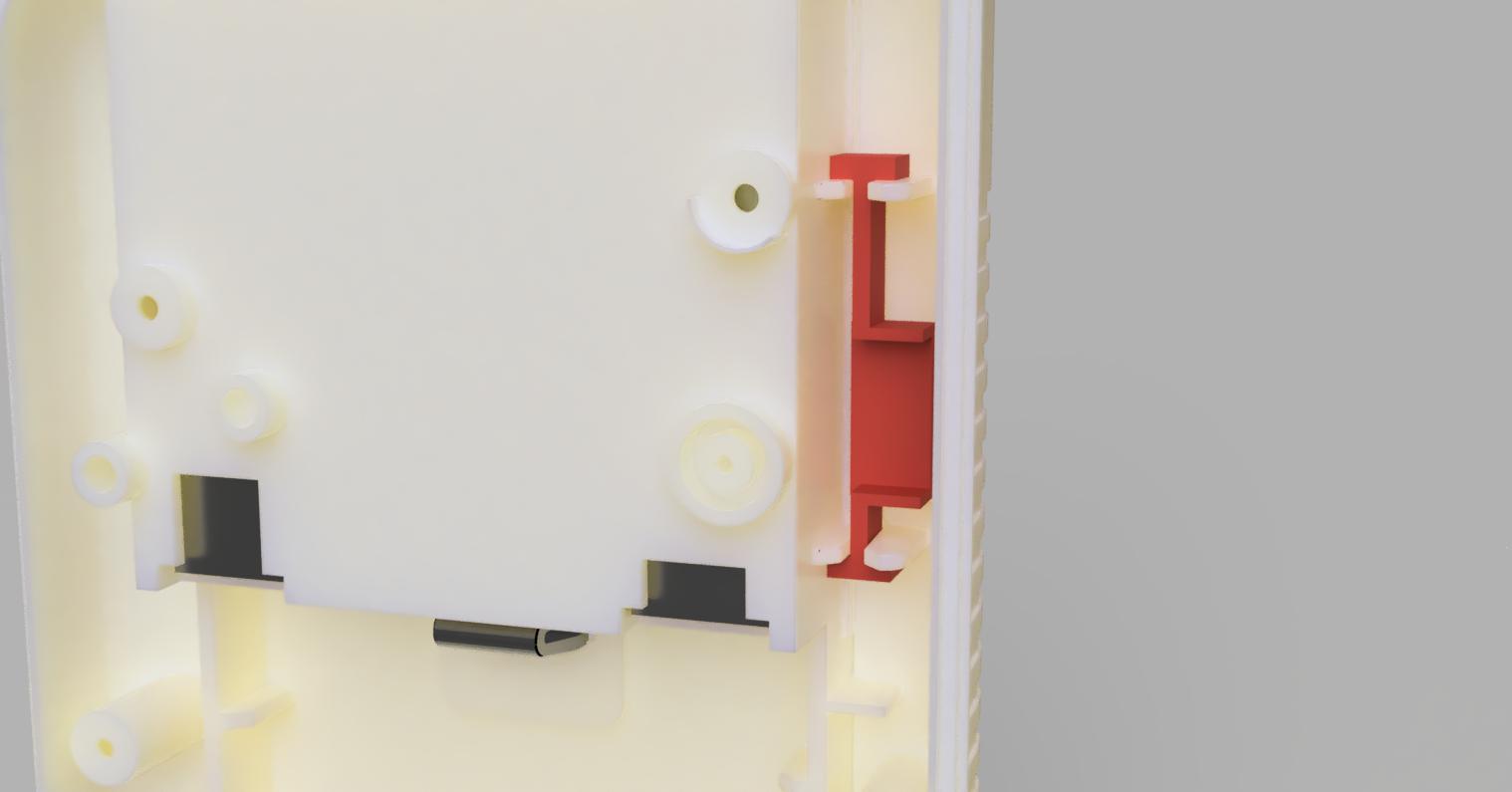

The pogo pins support...
It is just simply clipped on the 2 plastic stuff that you have inside the shell (maybe a cable management system ?)
Then the pogo pins (original from Samsung Galaxy 2) will be VHB taped above.
Normally, no need to stick the 3D part, it will stay steady by it's own :mrgreen:

The shell model is the amazing work of Neolith !!!
Thank you Neolith, your cad is almost perfect so i could save some prototype printing with it !
More info here
http://www.sudomod.com/forum/viewtopic.php?f=43&t=3729

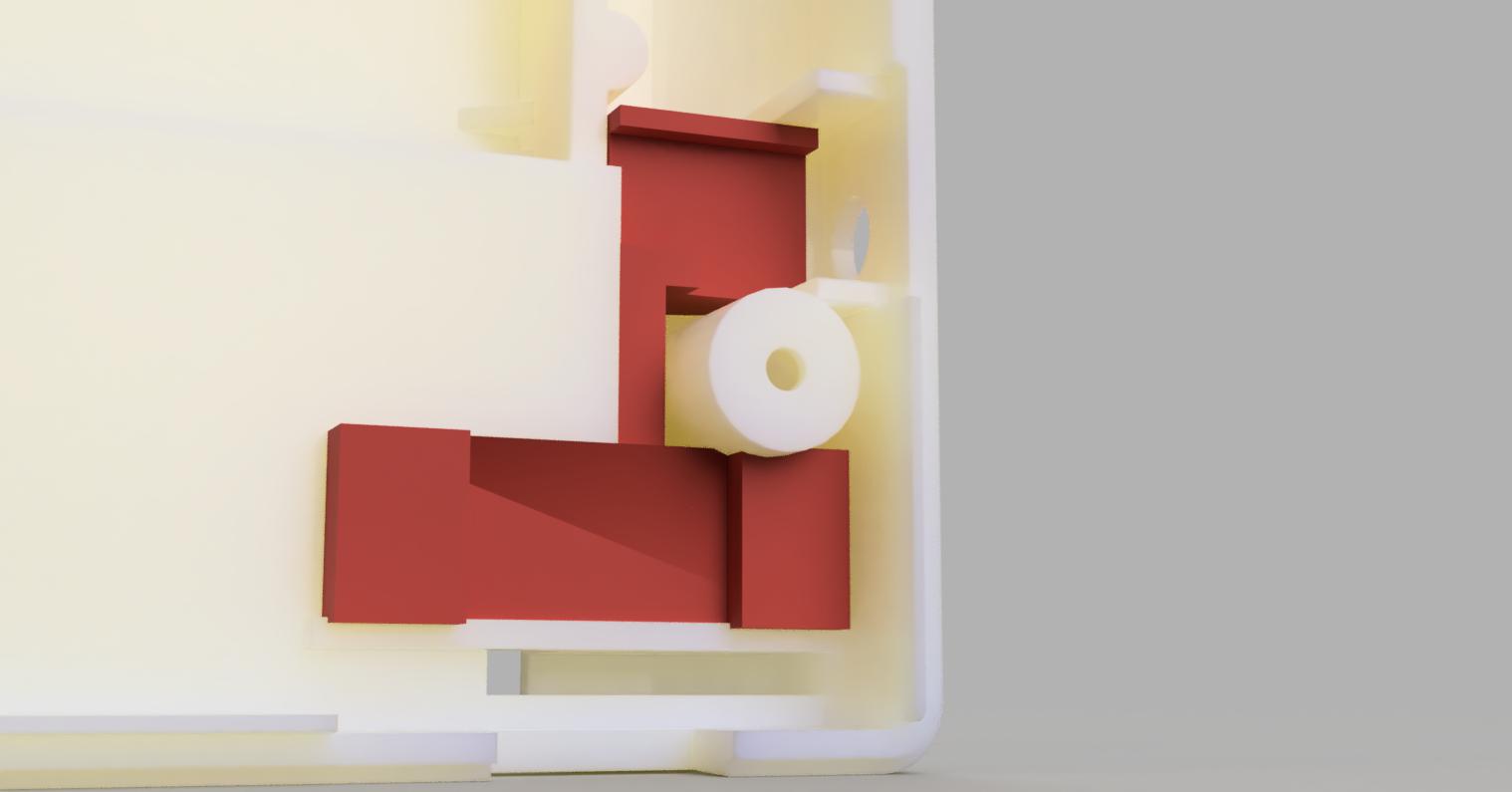

The power switch and the DC barrel jack support...
It is just simply pressed around the screw post and voila !! even removing it then is hard (need to use a flat screwdriver as a lever and carefully raise it to be able to take it off)
Then the components will be VHB taped above.
More info here

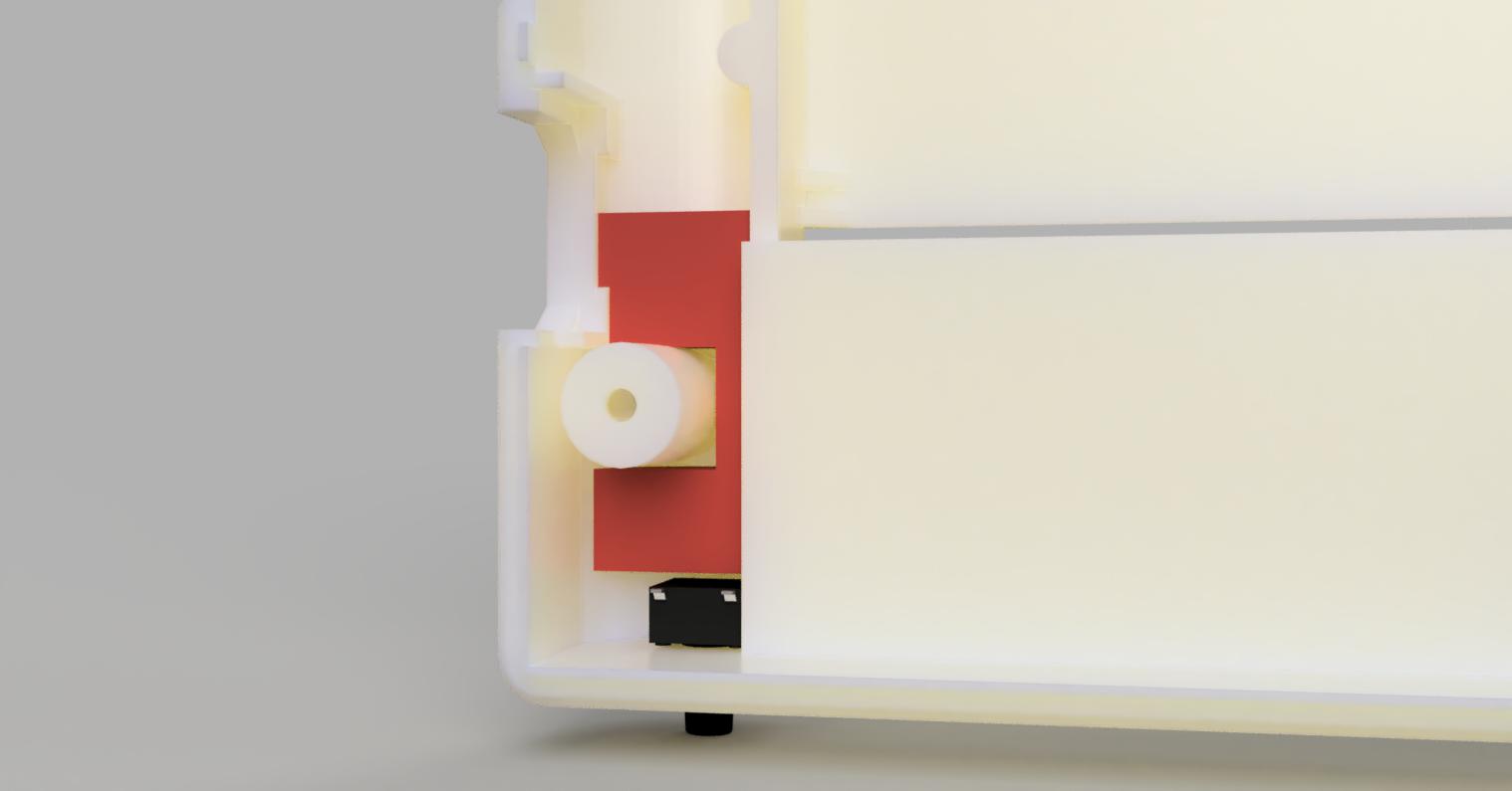

The mode button support...
The small gap you can see between the 3D part and the tactile switch is the room for the cable and the soldering :mrgreen:
You can also see that the piece is flush with the EXT.CONNECTOR hole where the SAIO's USB port lays... This also allows the USB port to be supported underneath so it will stay steady :lol:
You put the switch first in place, then you push the support and that's all...
More info here
