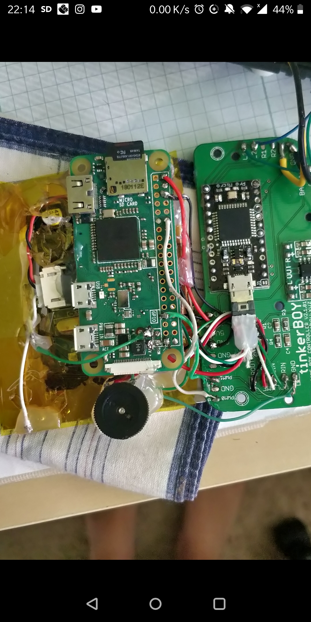

I connect my Av cable on the front of pi and it works, let me see if I have a proper picture of it.
Also the ground cable seems to be a not soldered correctly.
that's from my first gbz in January. Built 2 others. You will learn more about the it as you go.
