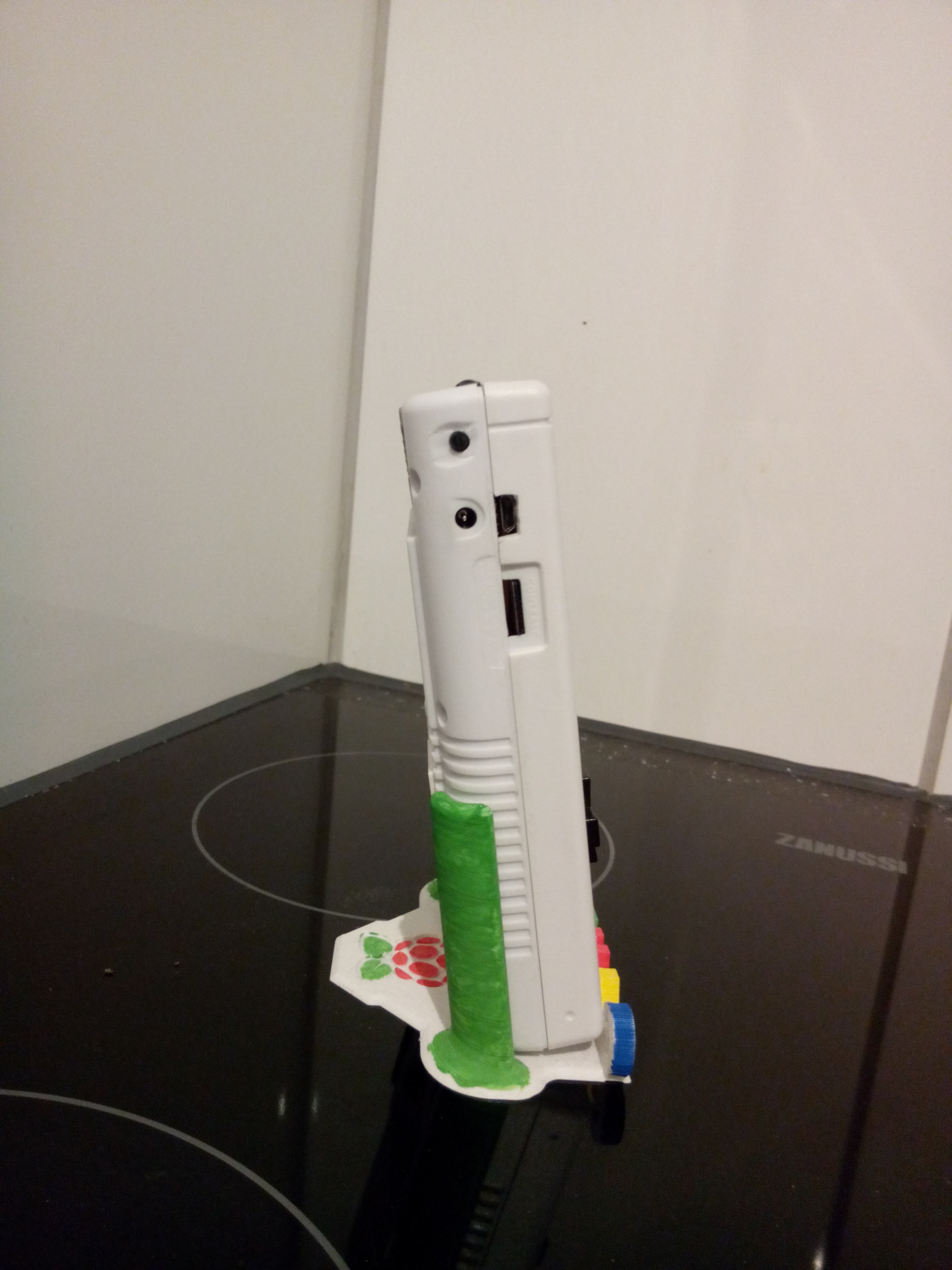

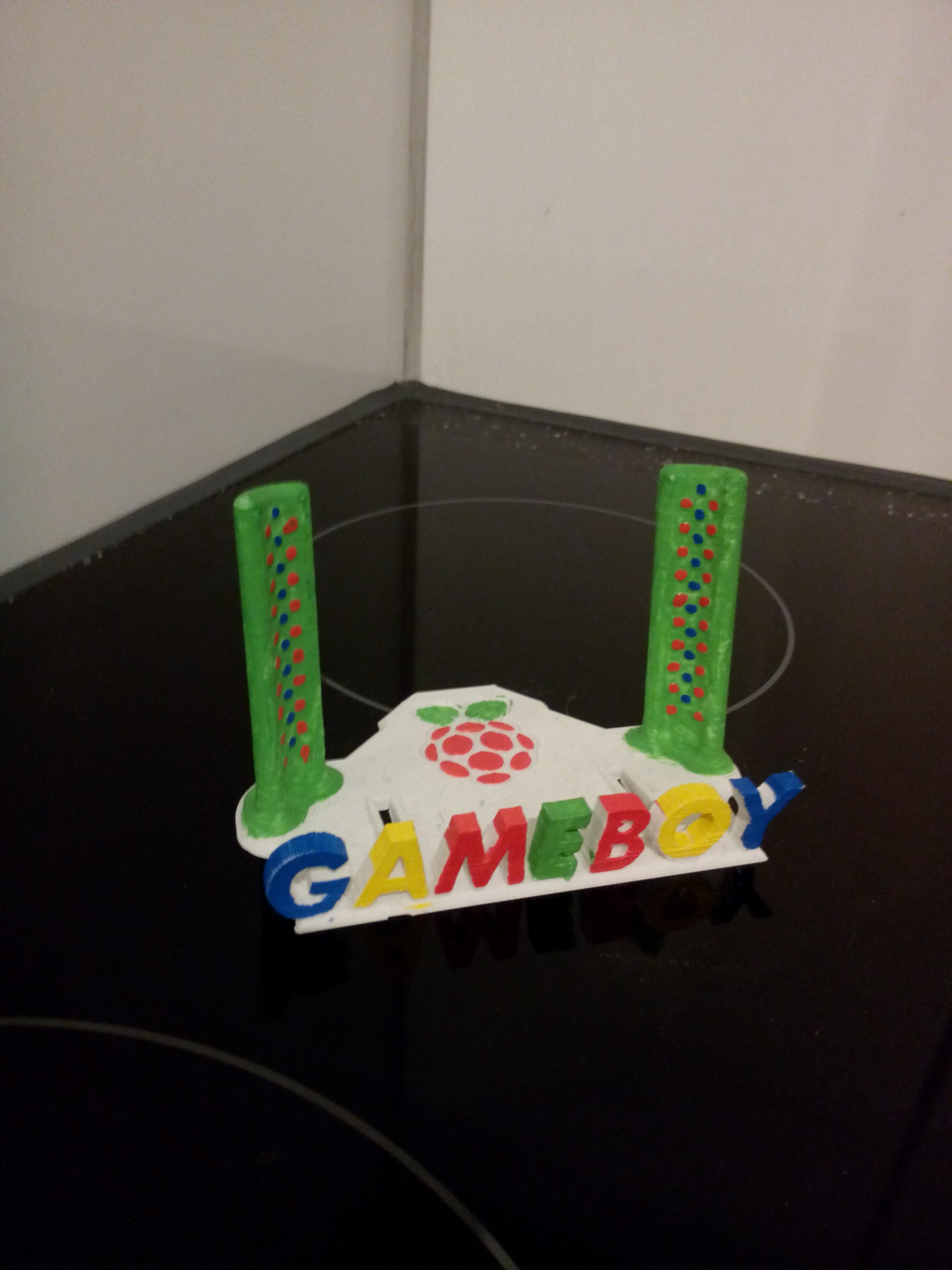

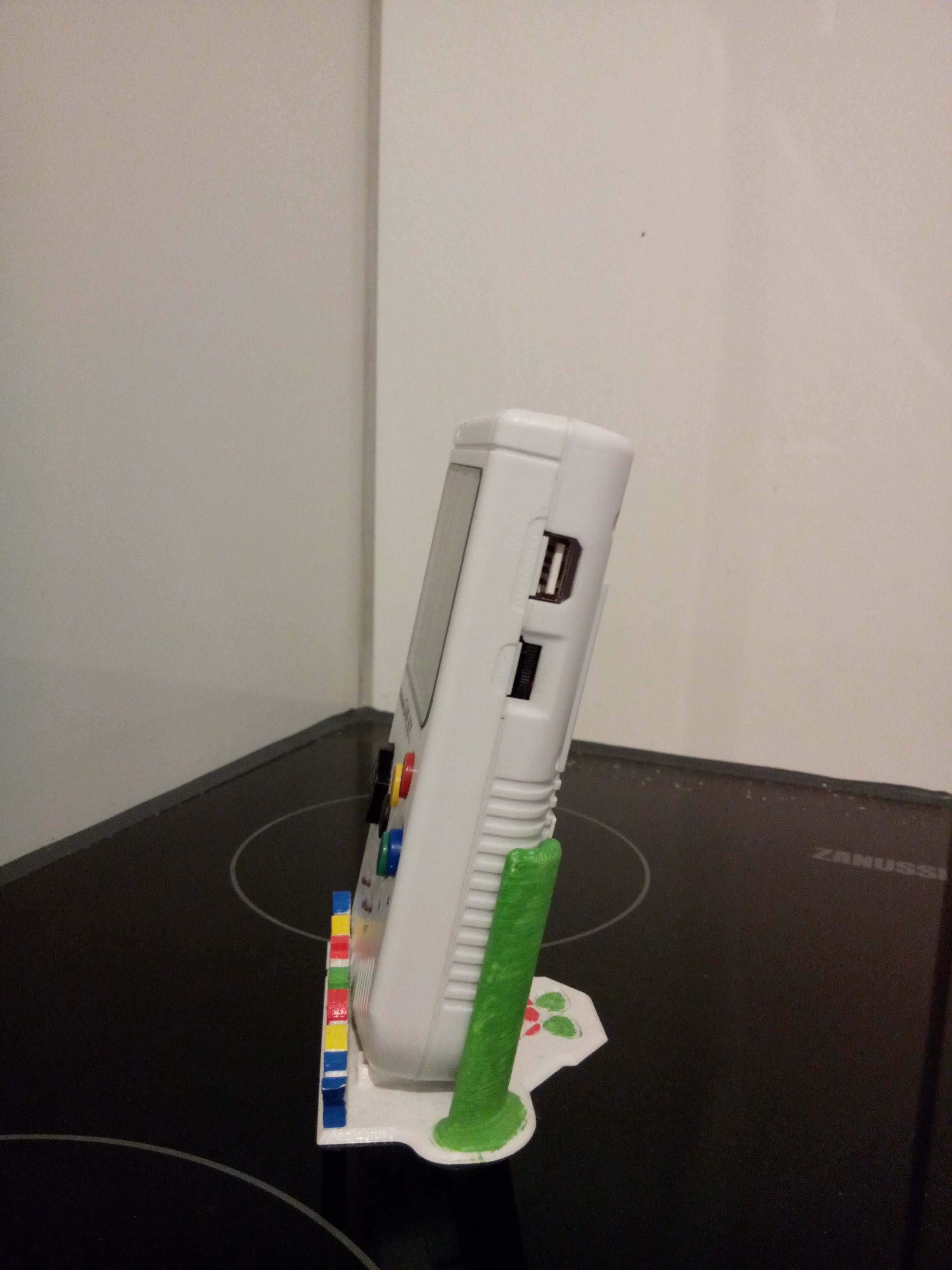

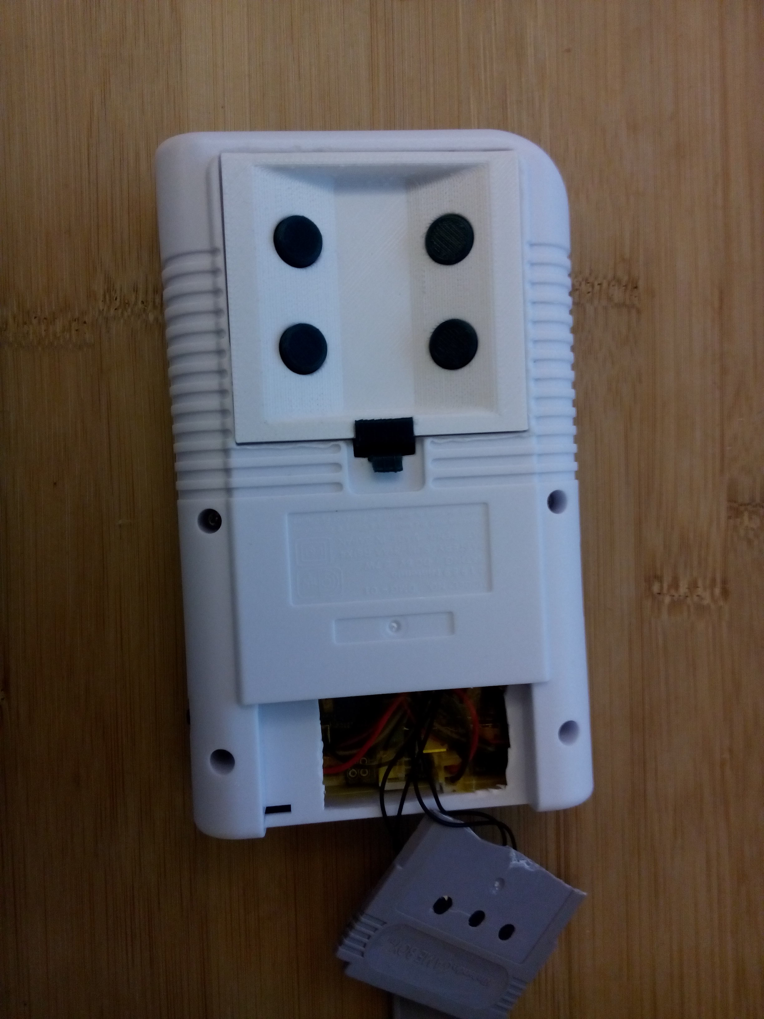

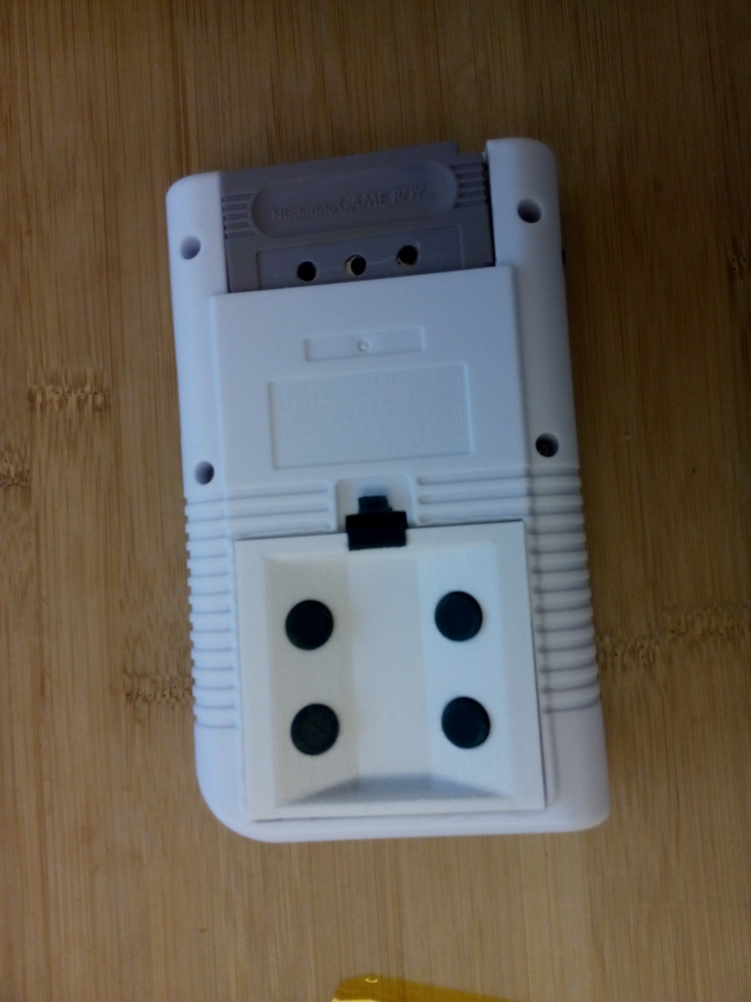

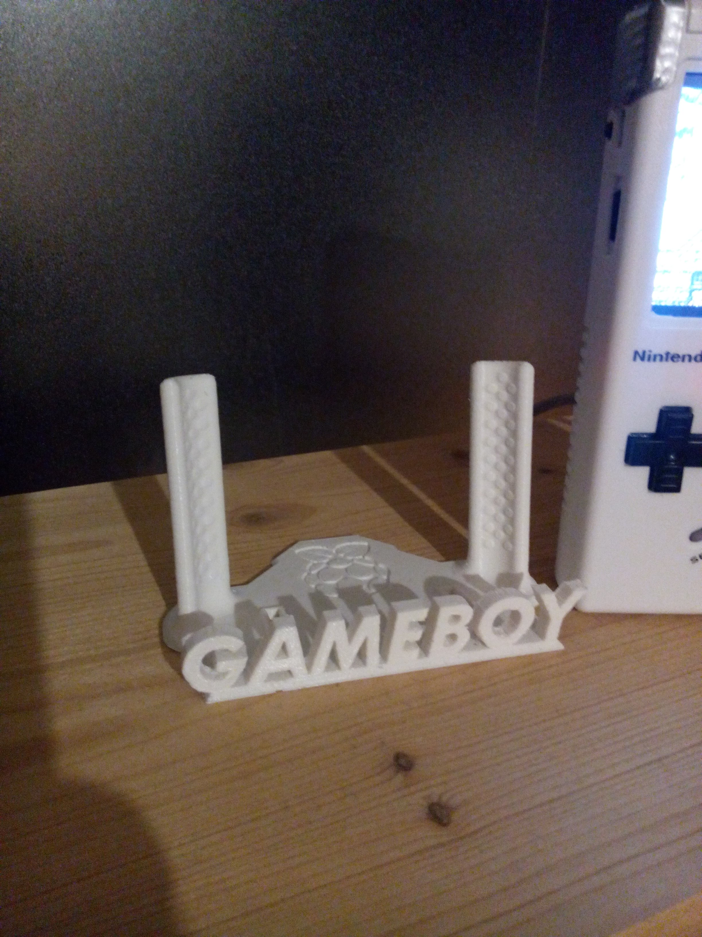

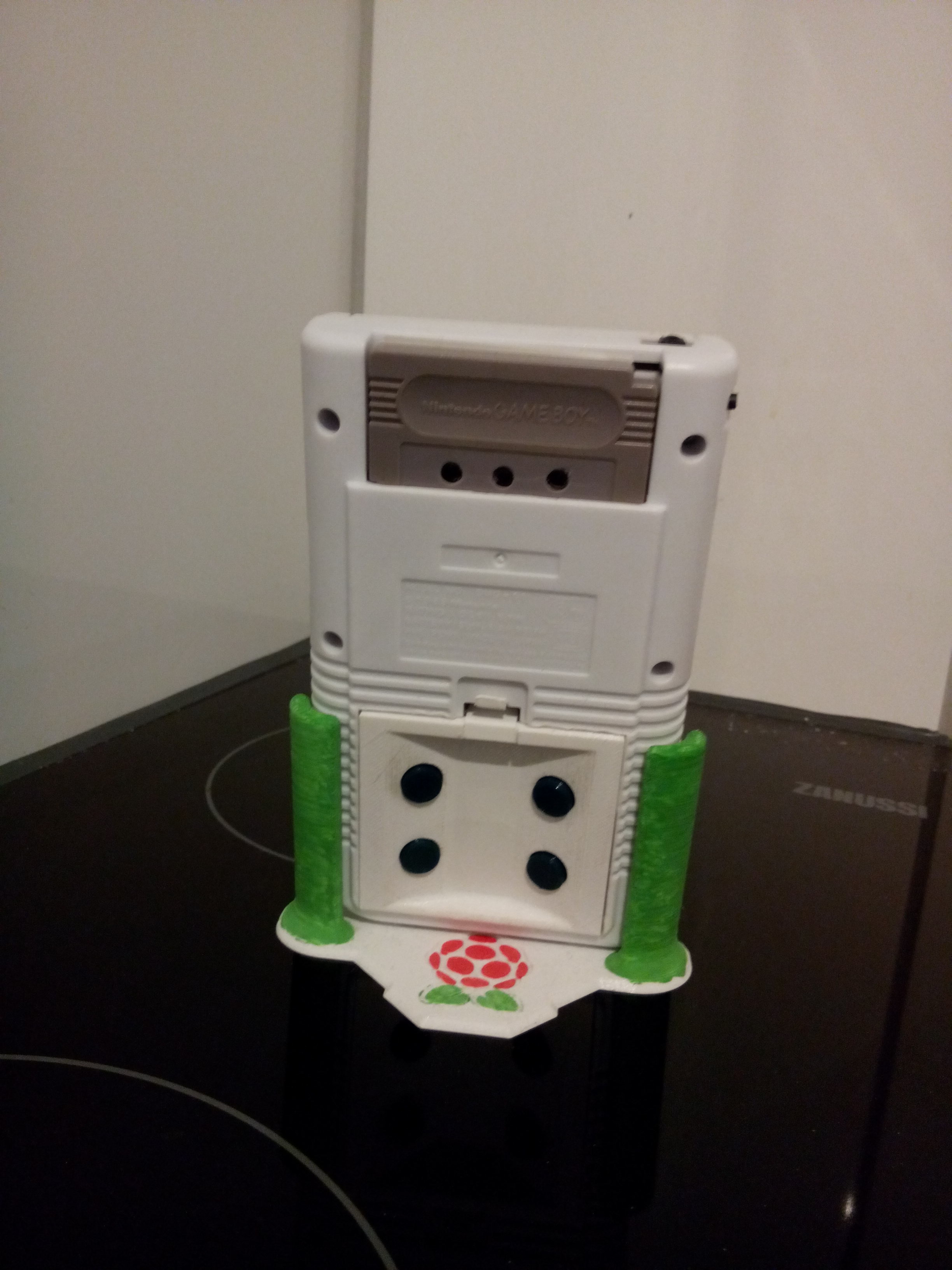

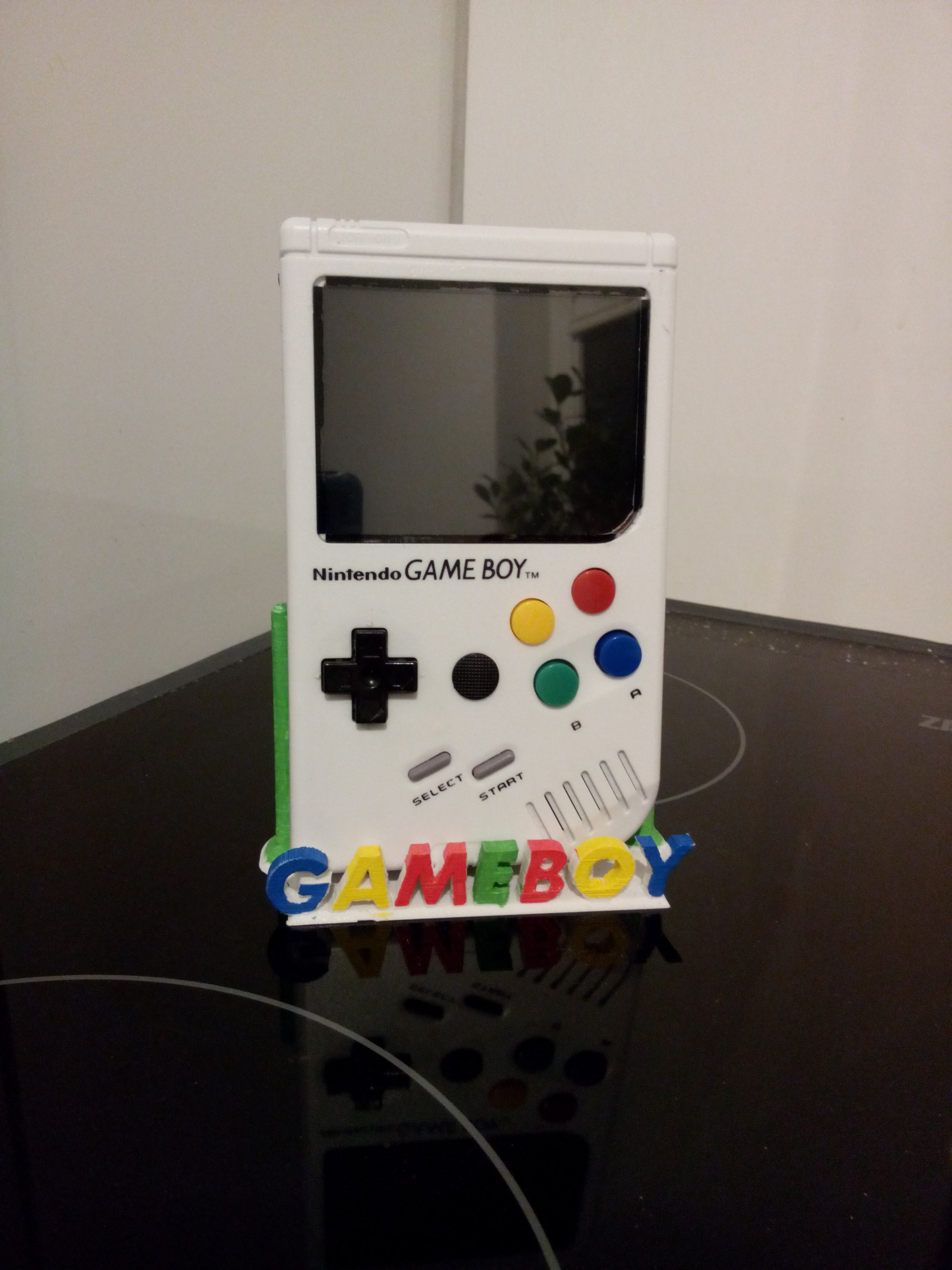

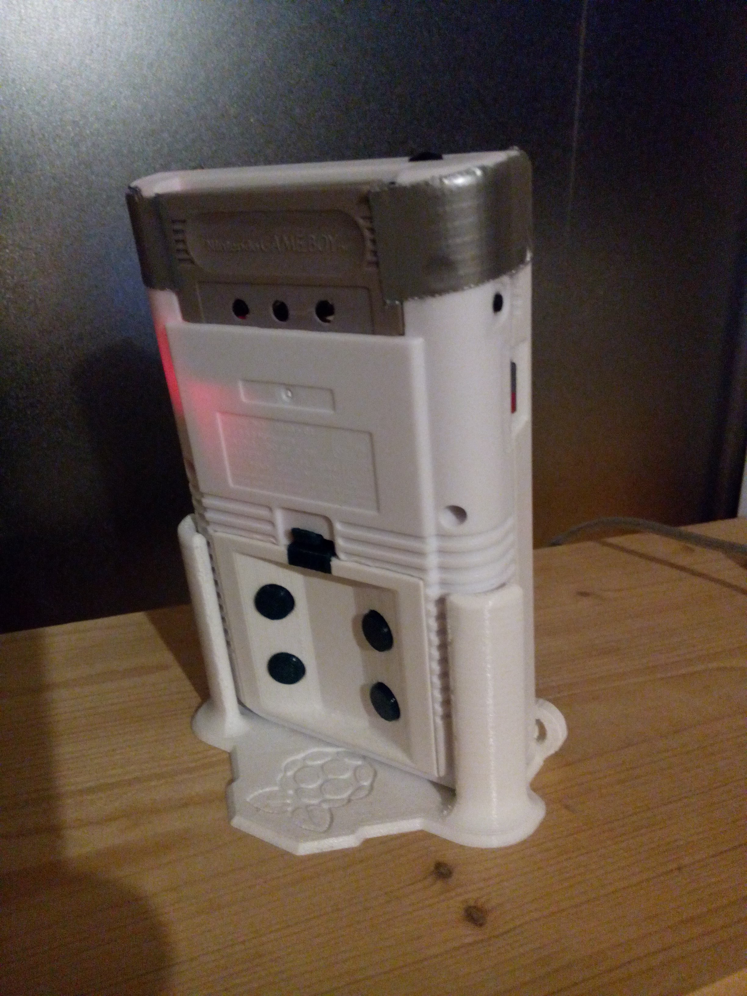

A few months ago I designed a holder for my future YaGz. I found only ugly and bulky things in Thingiverse and co. This weekend I printed the holder. Looks very good.
The holder will be painted sometime still colorful.

No Problem. It's a little bit tricky to get the support material out of the chars.

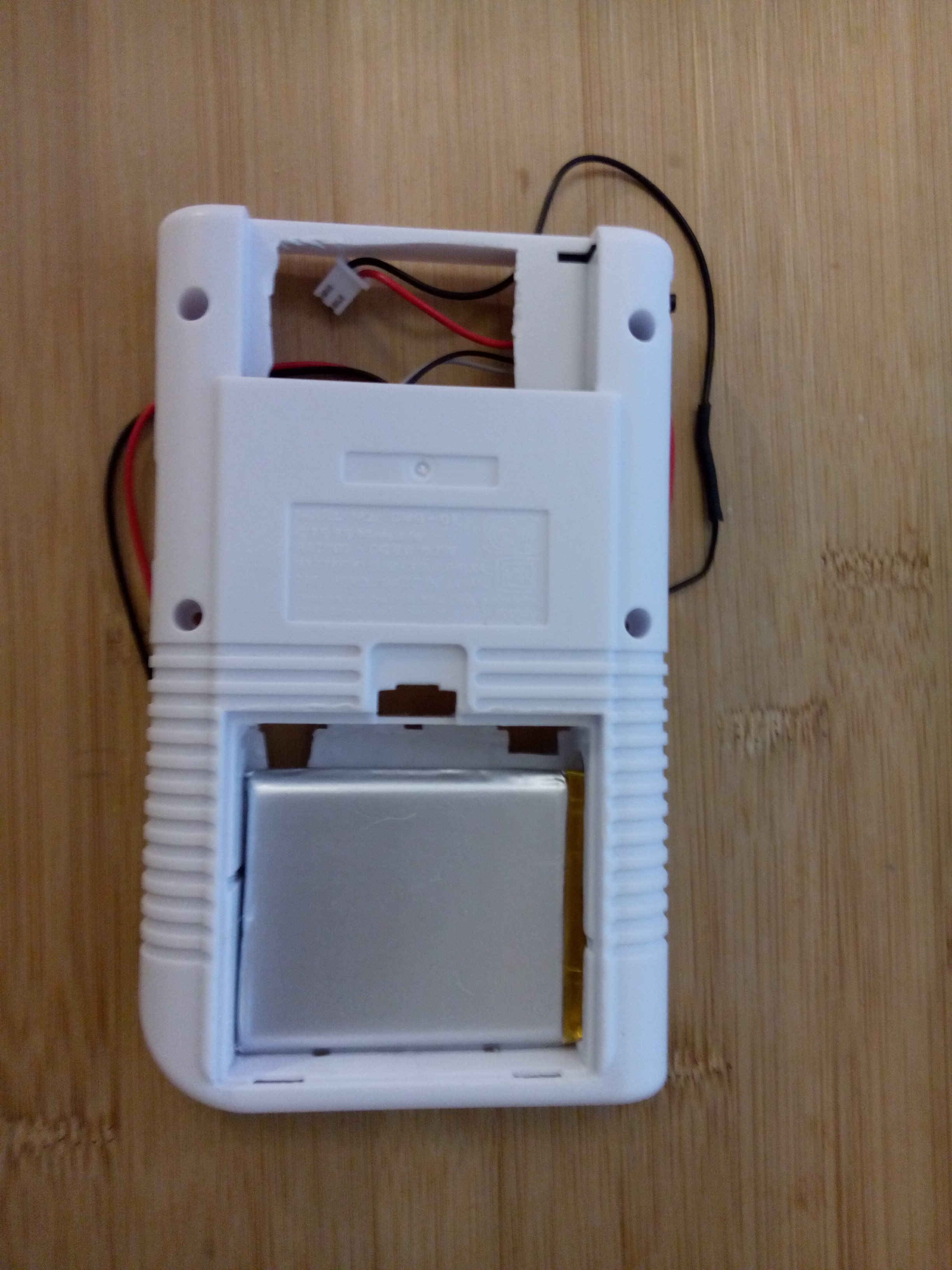

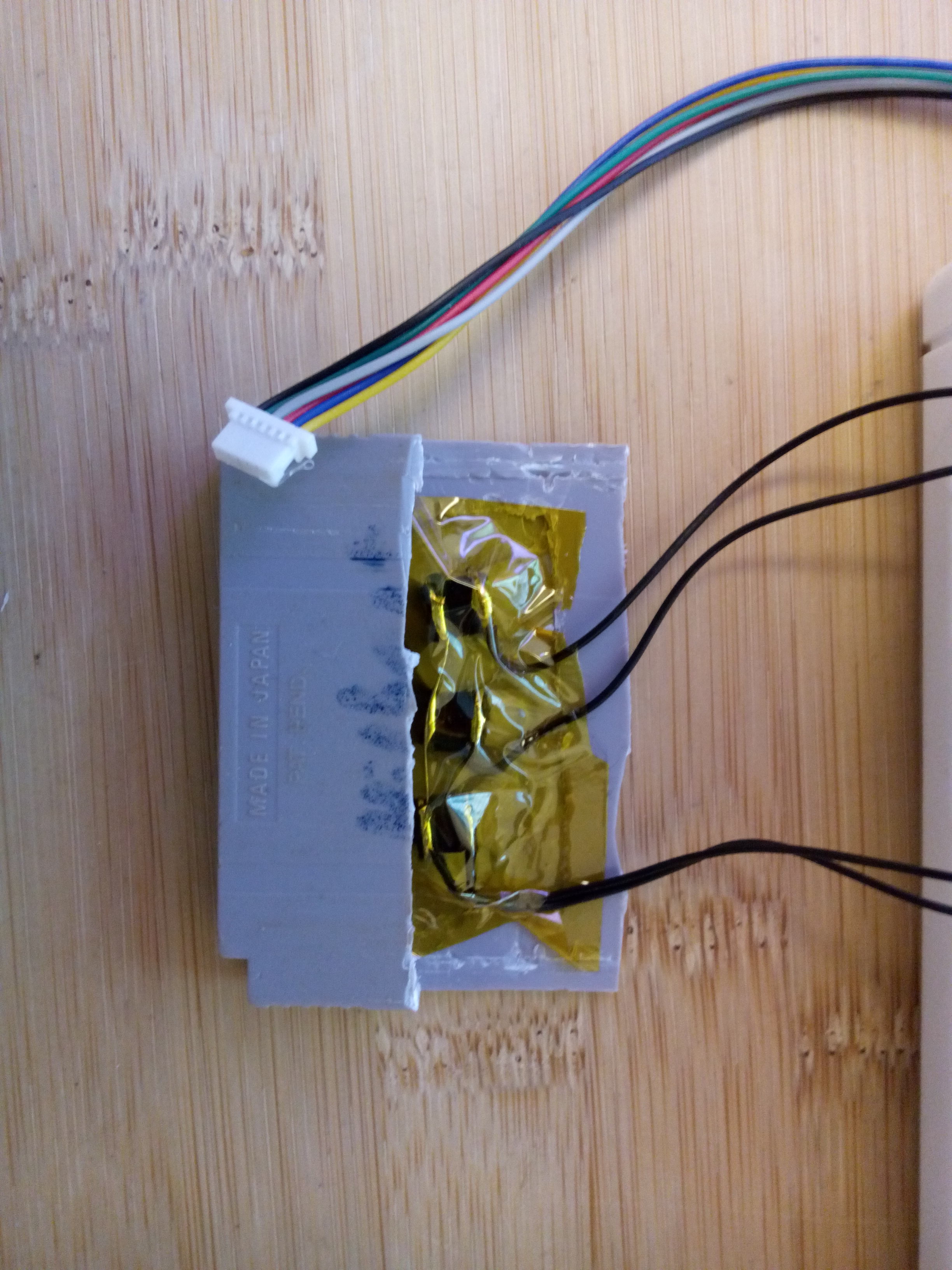

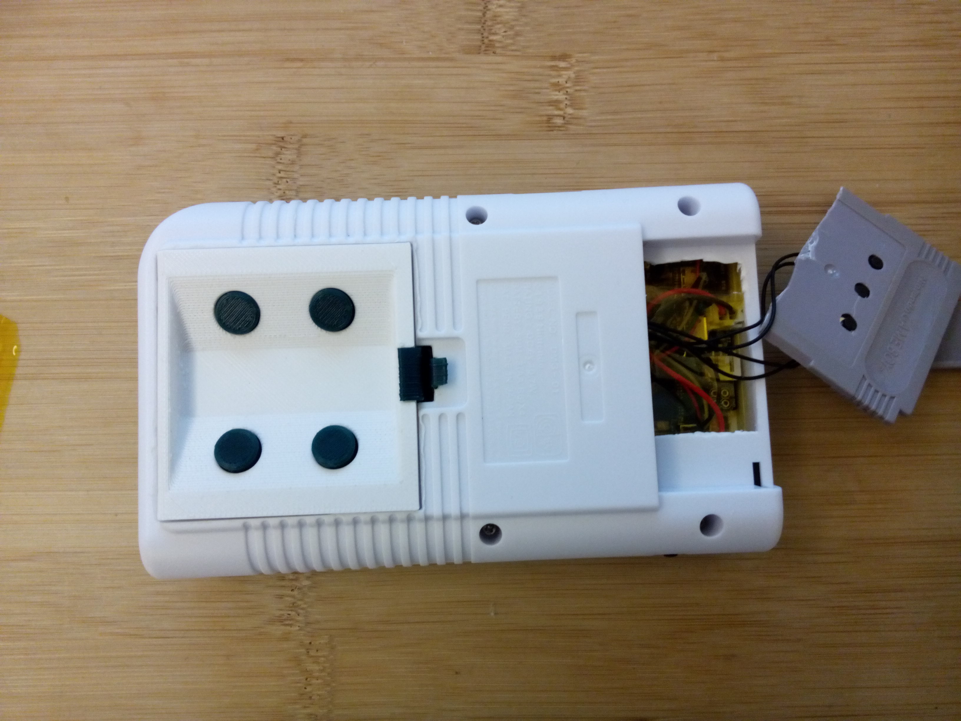

I forgot to post pictures. It is the situation as it can be seen above in the holder.

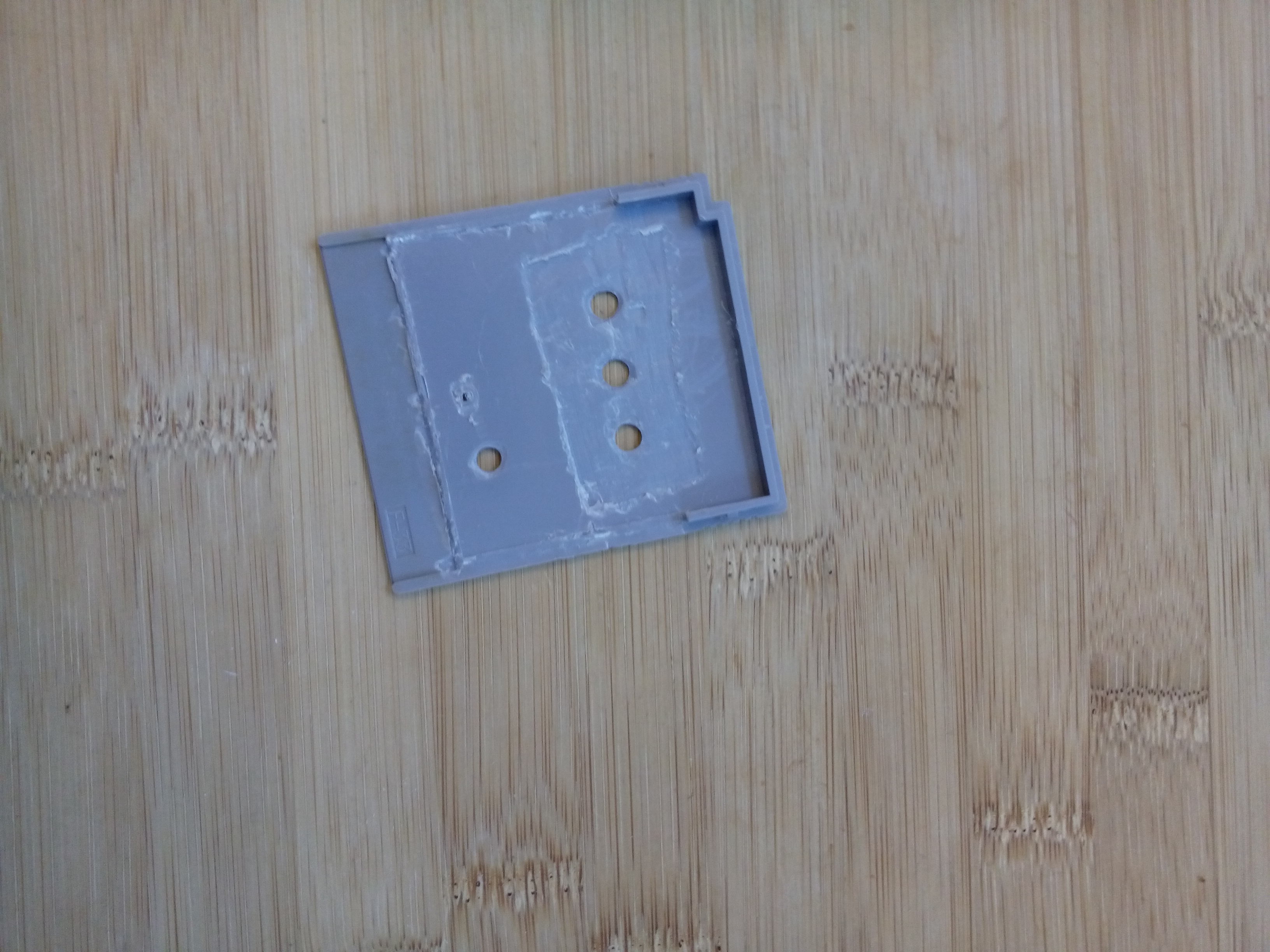

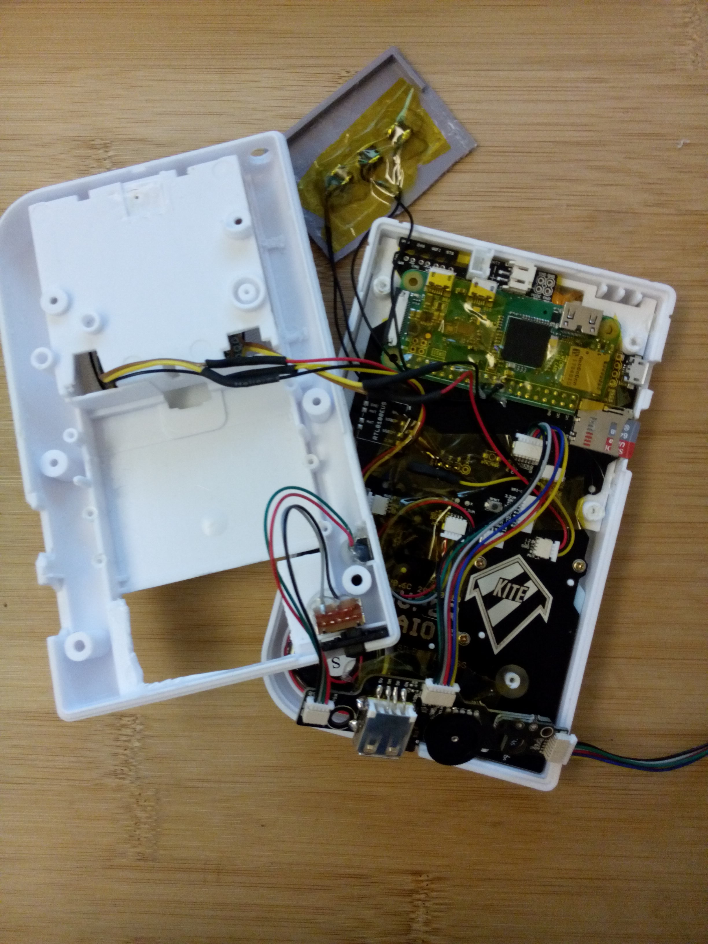

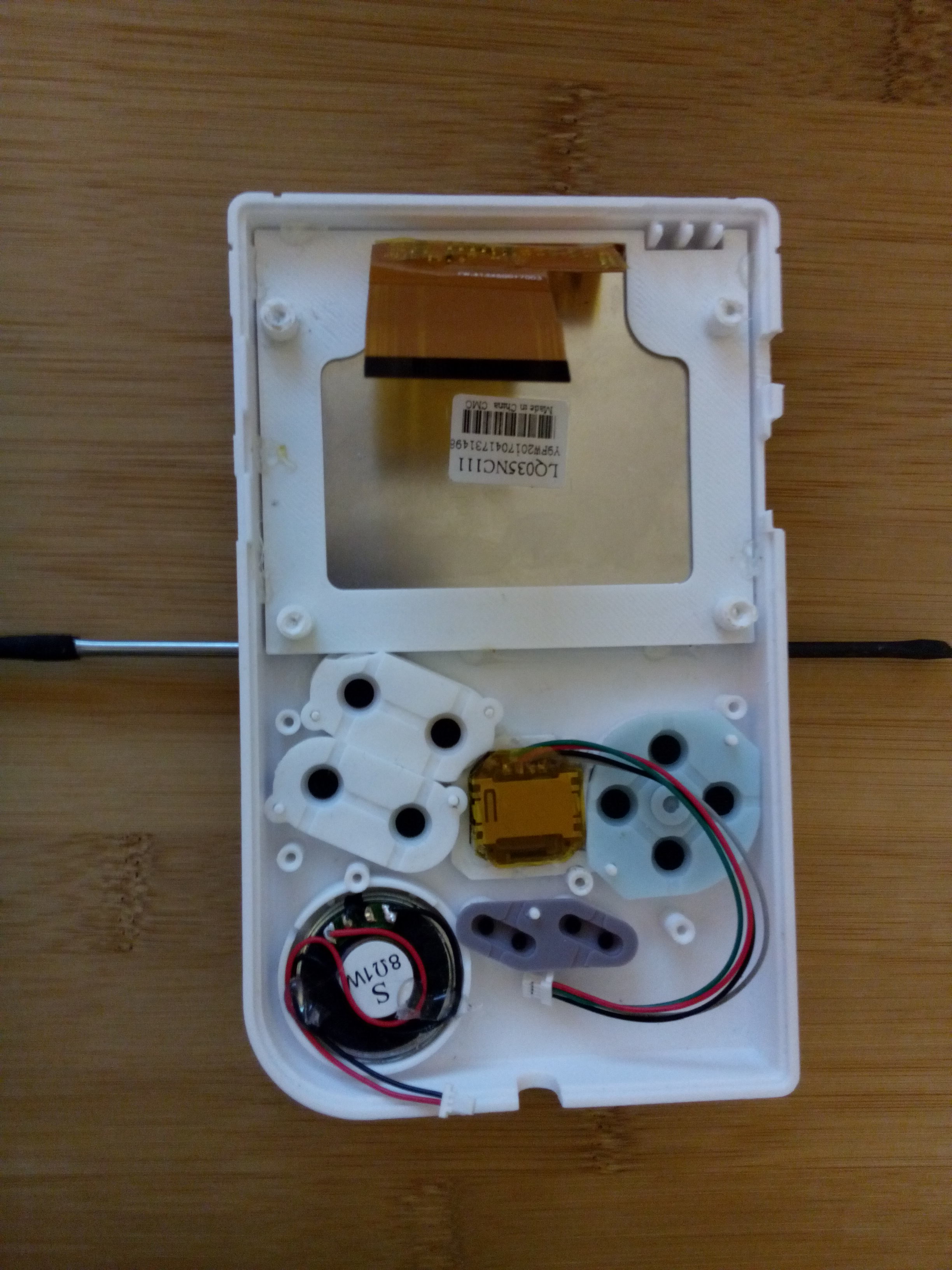

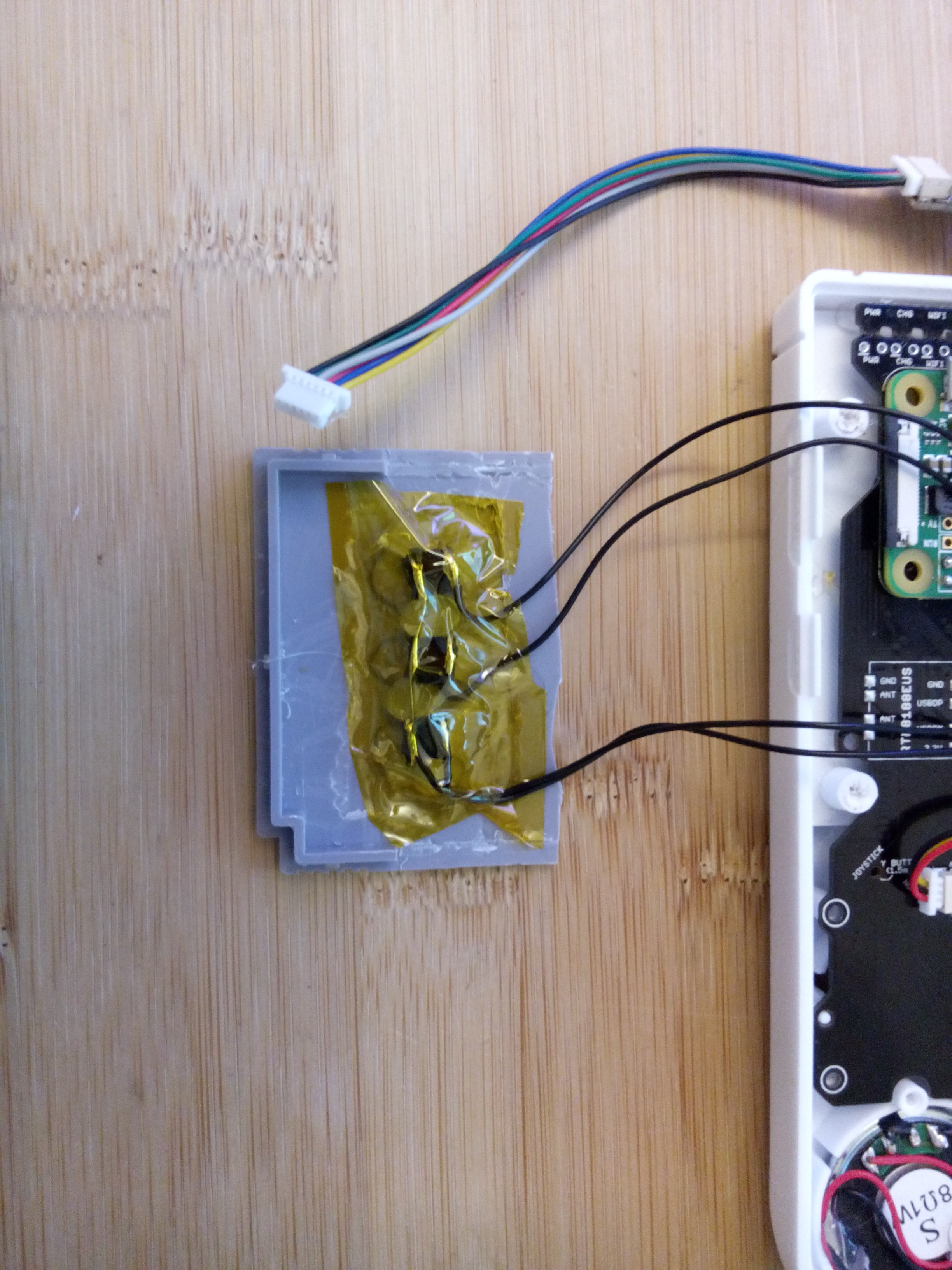

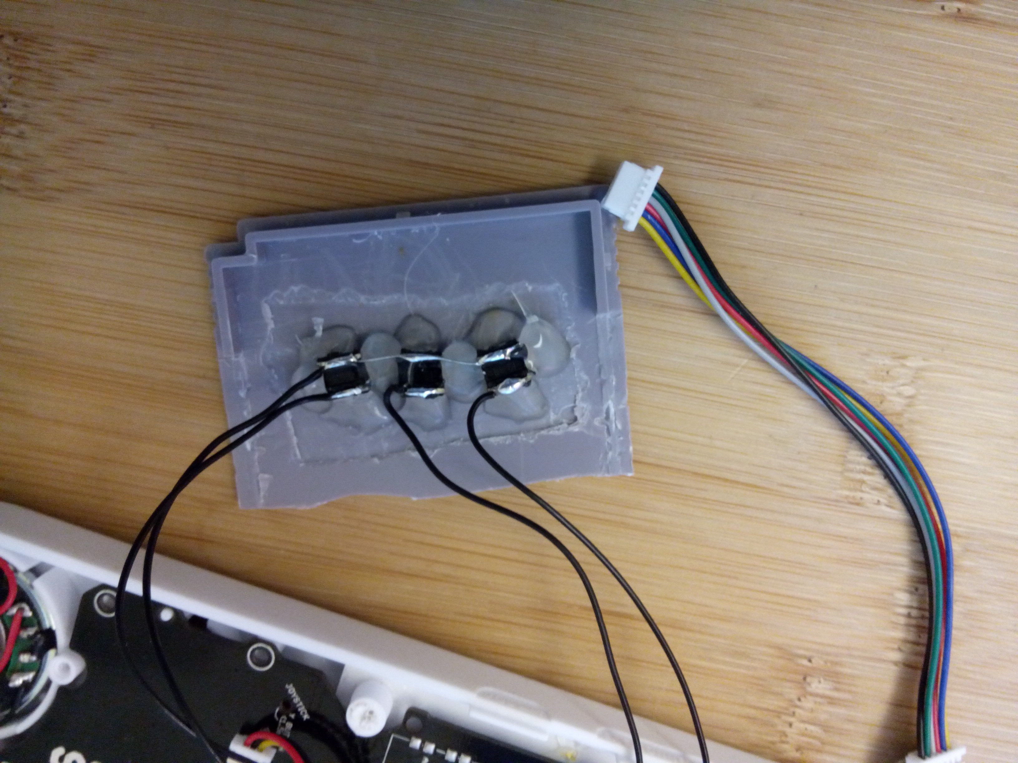

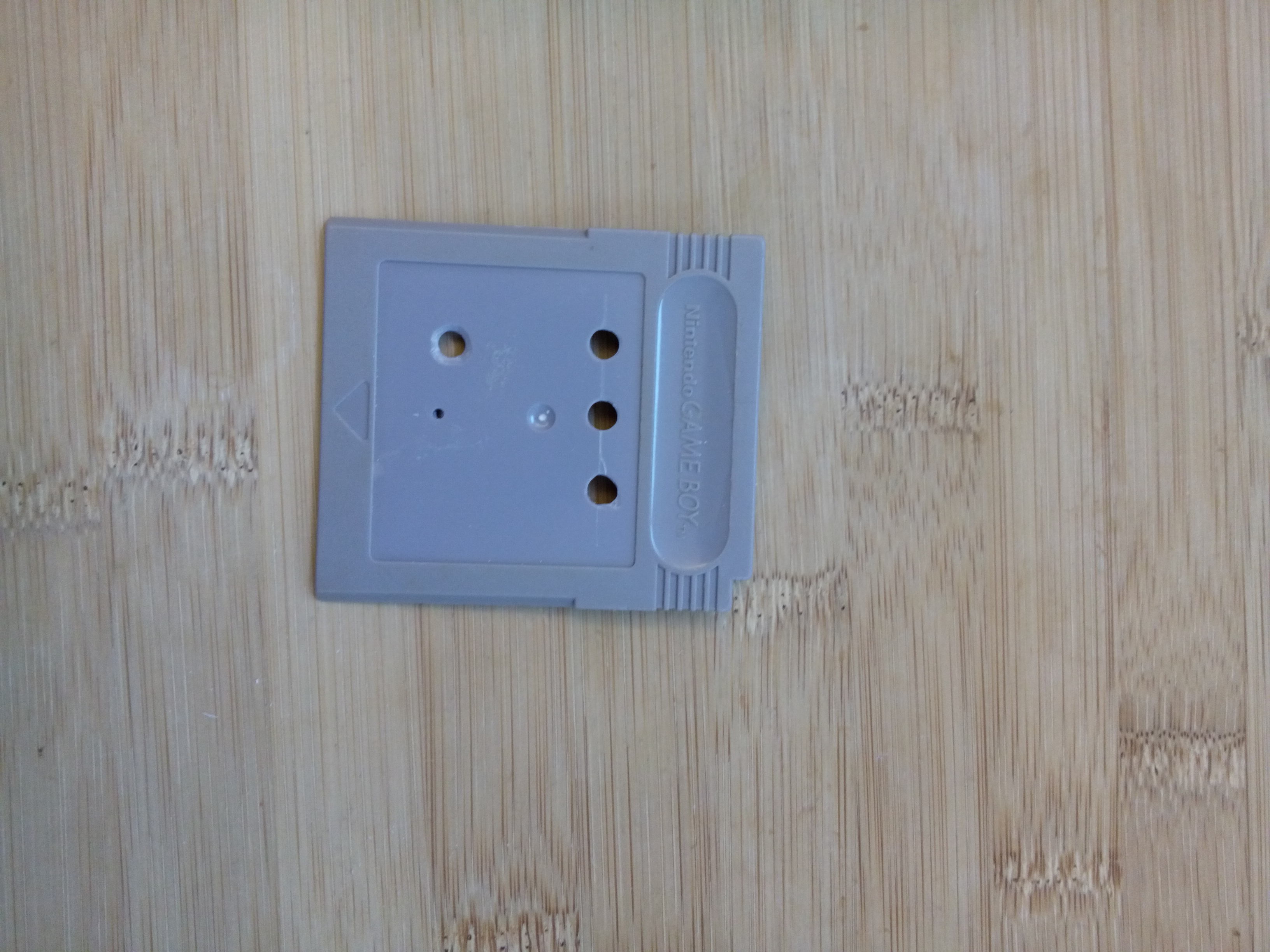

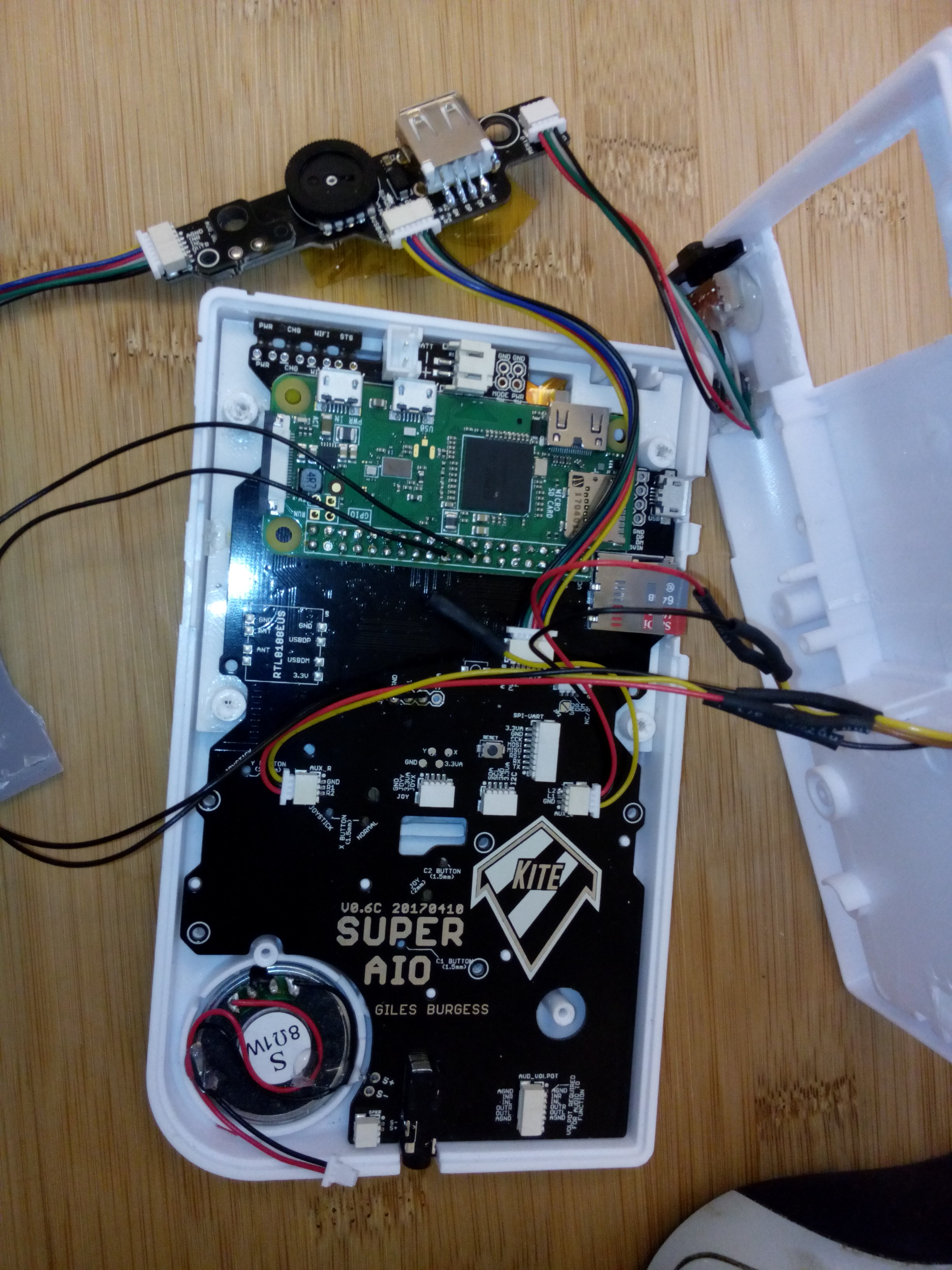

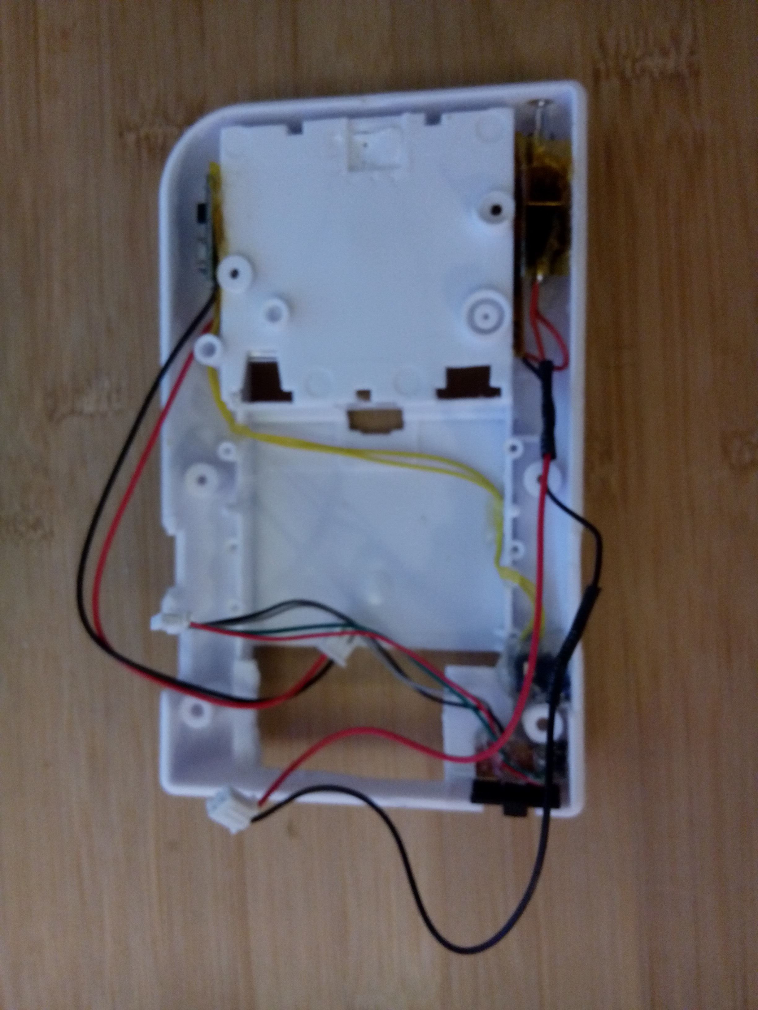

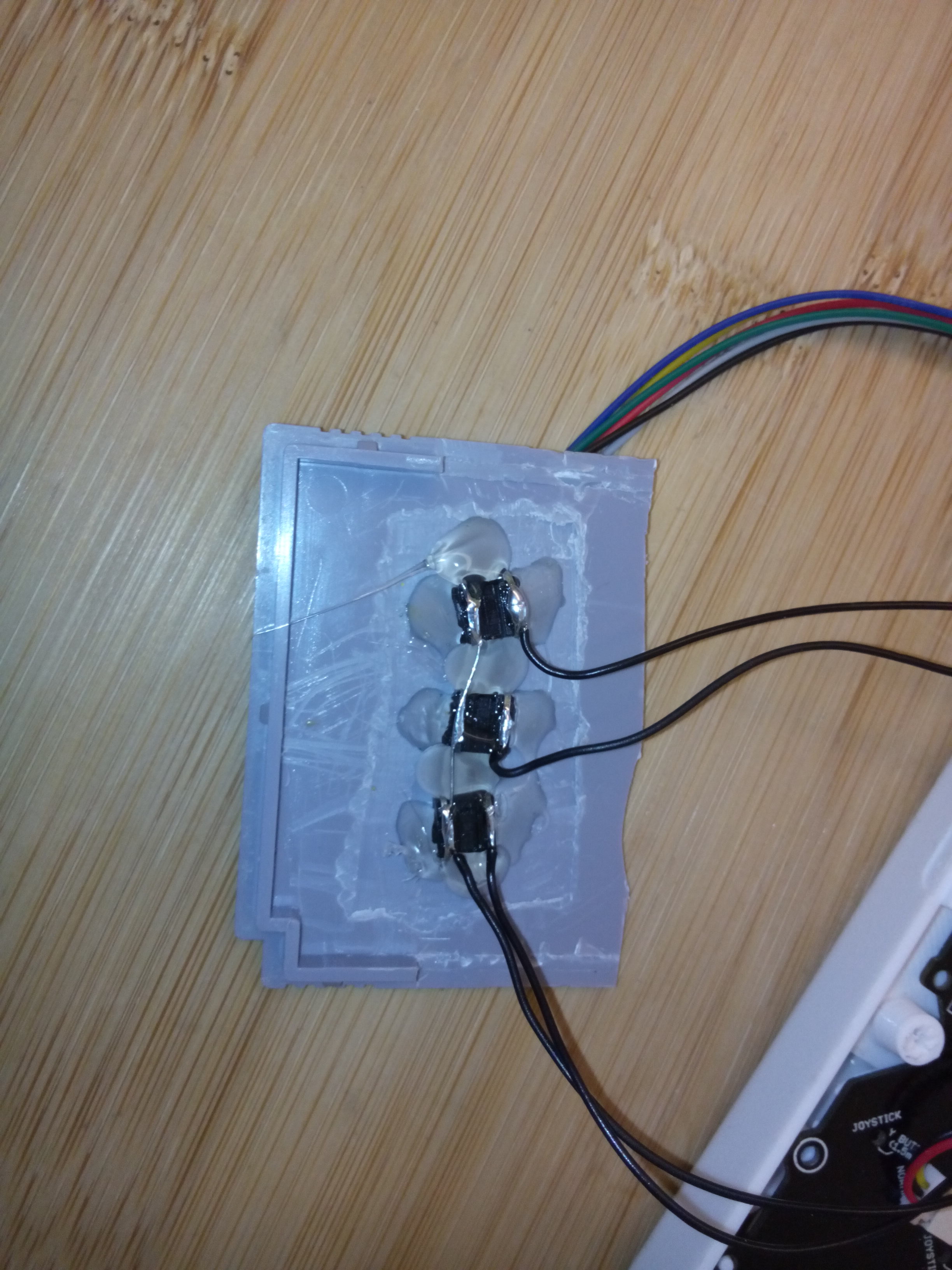

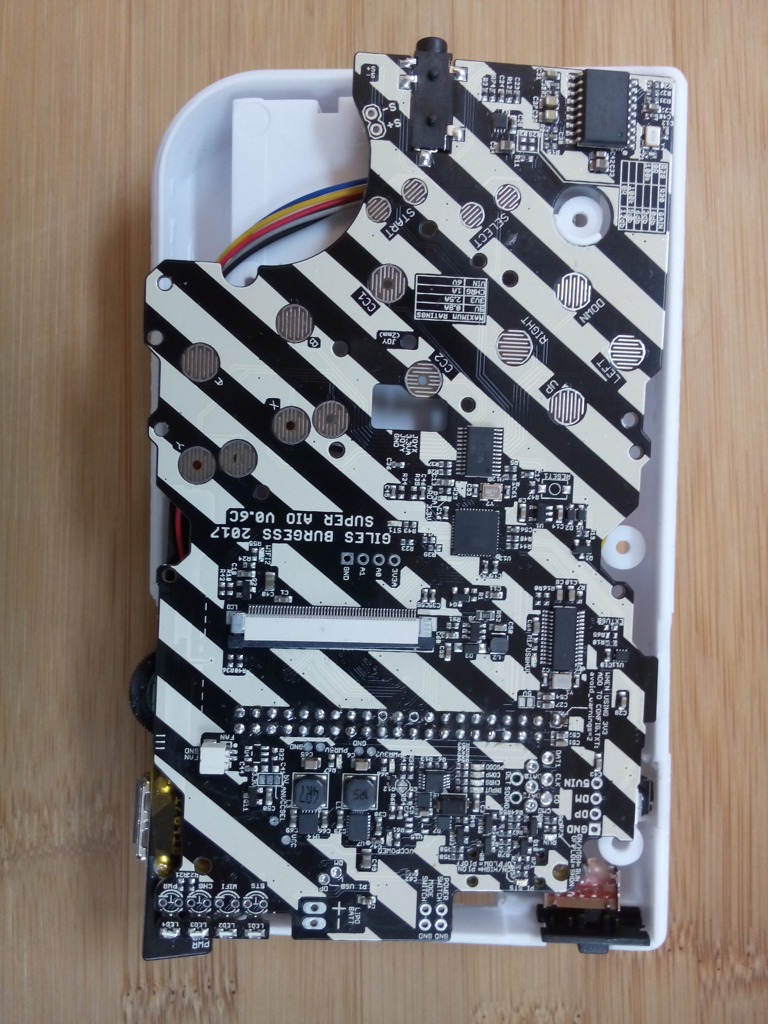

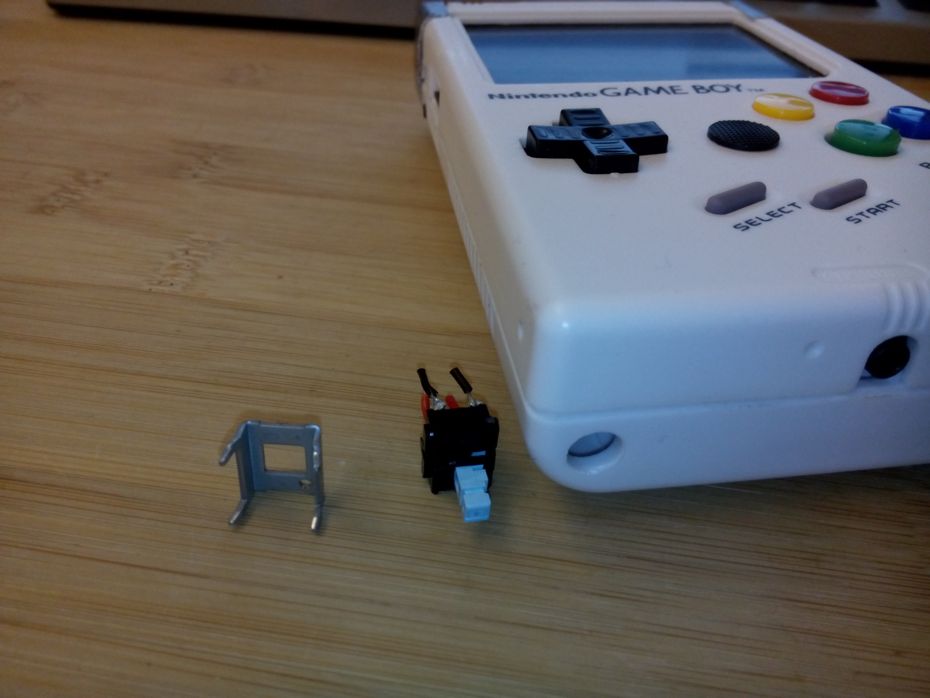

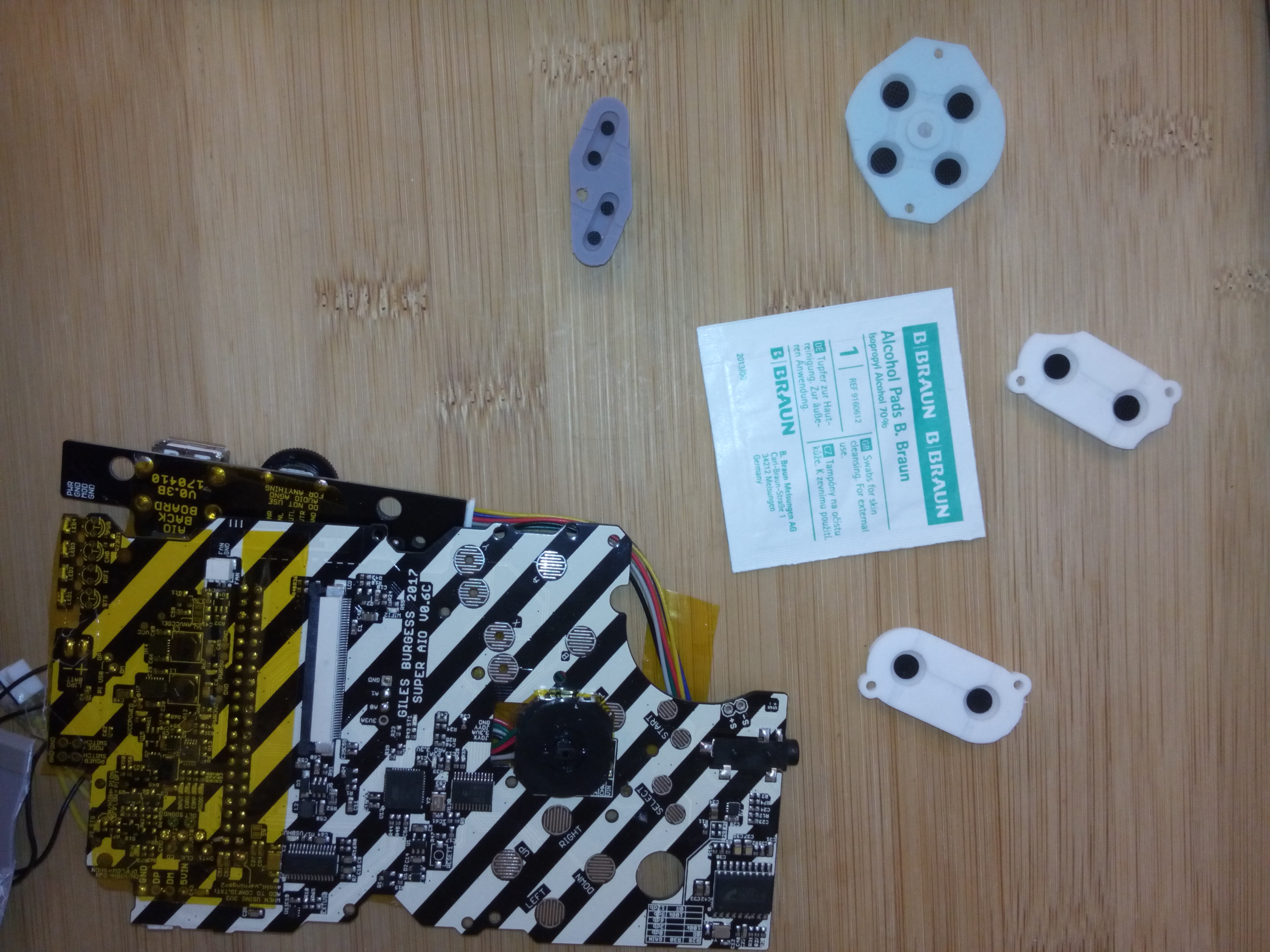

I have desoldered GPIO 24 and 25 and connected two switches. The third switch goes to A0 of the 32U4 MCU (for all buttons the internal pullups are used). I don't know exactly what I want to do with it yet. The middle button now starts music for a test.

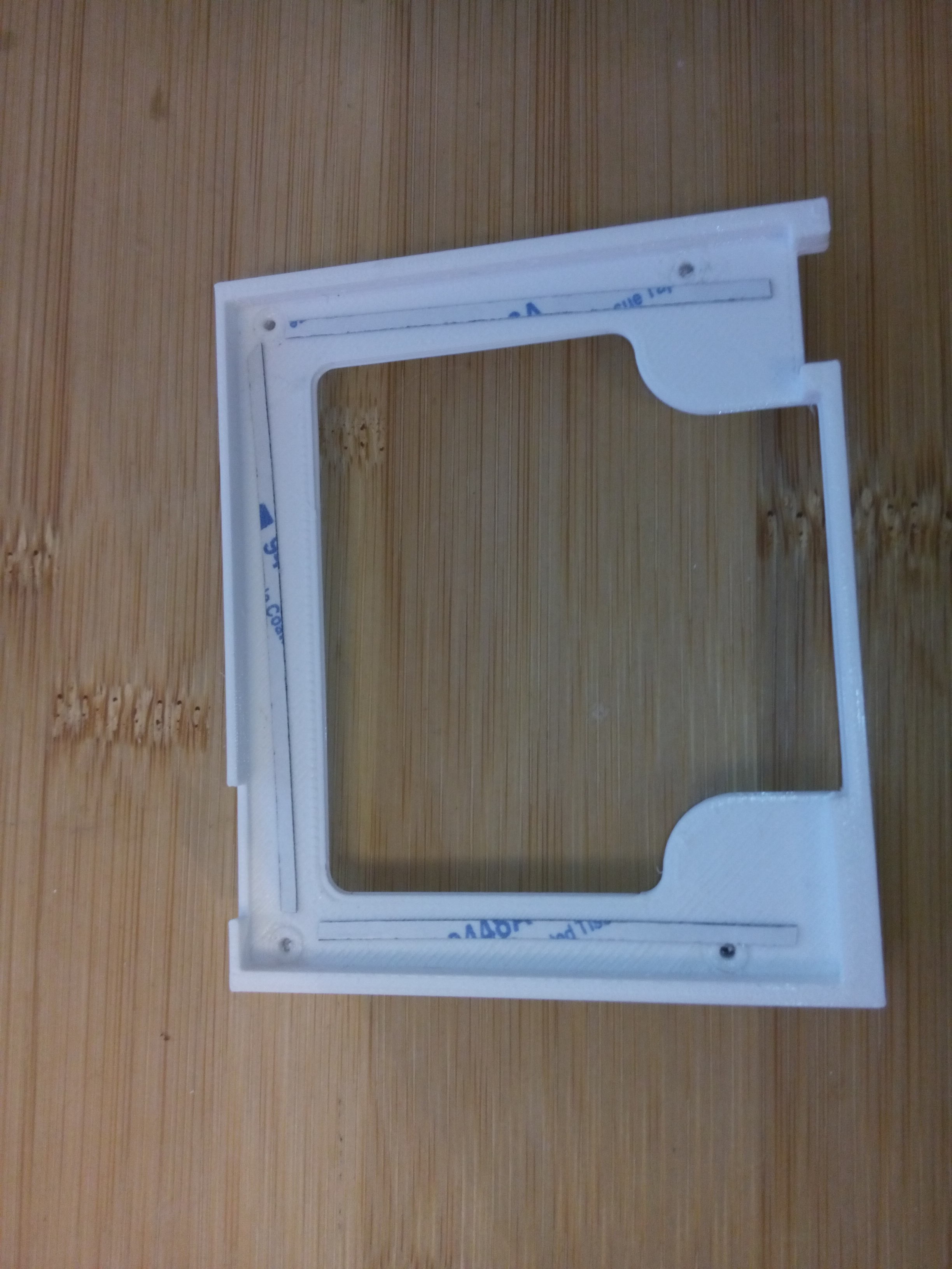

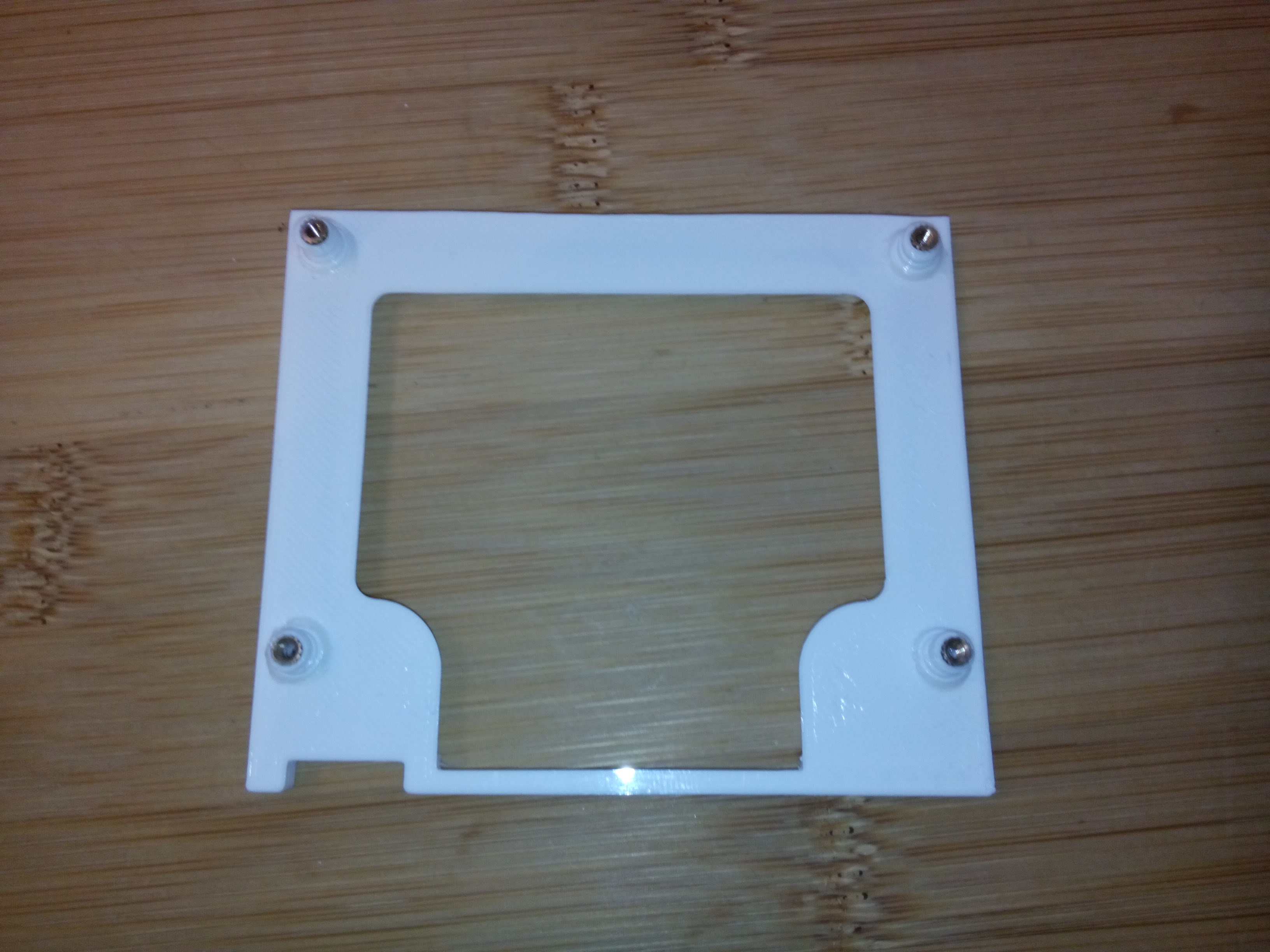

The glued screen bracket made of several parts works great. But I need brass inserts, the screws are ripped out. HoolyHoo is right. (Now taped as seen above.)

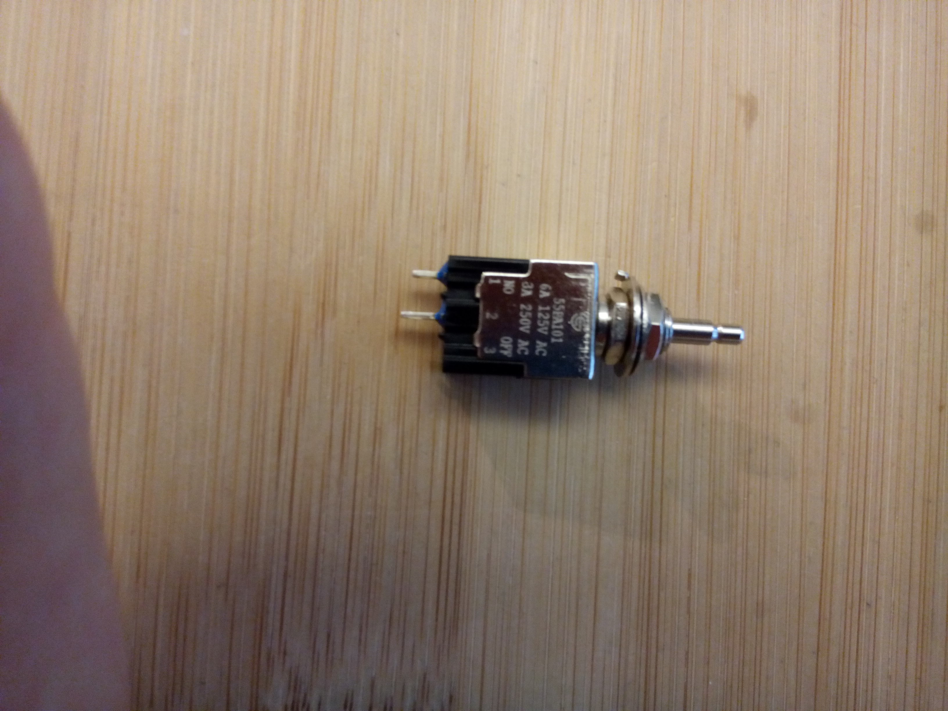

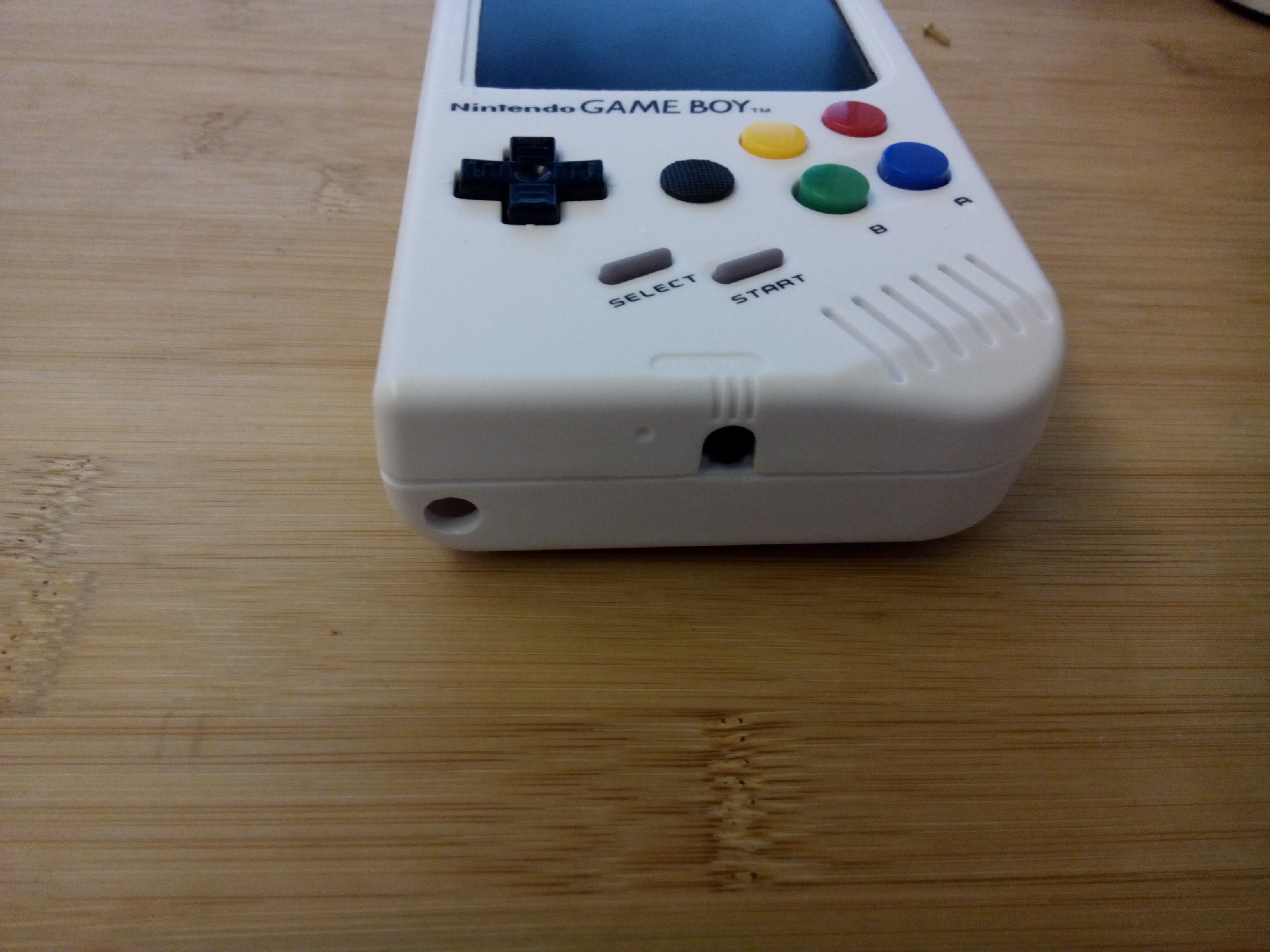

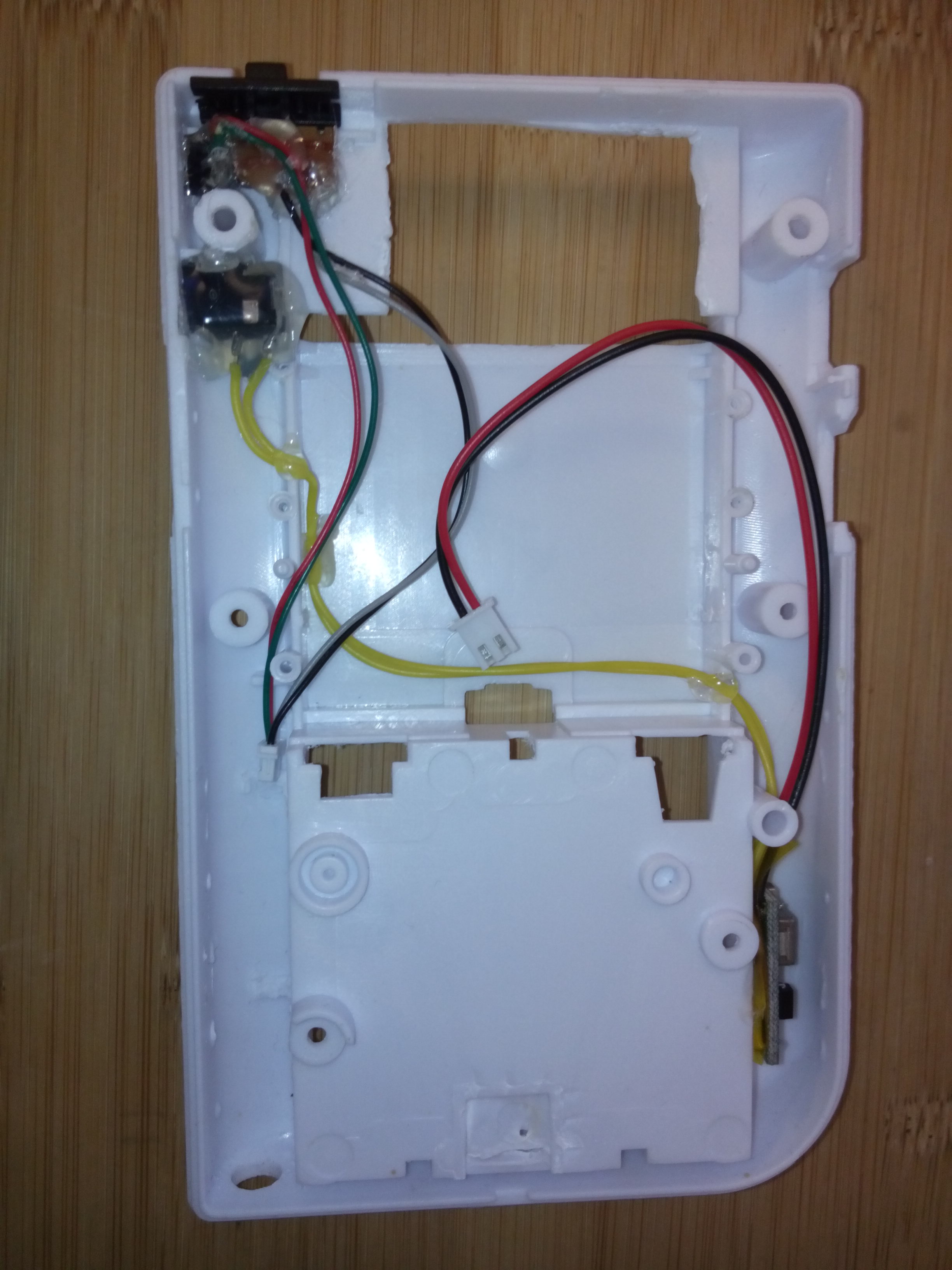

I want to install a main switch on the lower side. I'm still searching. The problem is the high current, the base size is max10x10mm.
At the top of the board, a new JST socket for the battery is soldered in. So I can just easy disconnect the battery.

- Brass inserts and M2 screws for the screen bracket.
- Add a DC-Jack like YaYa, place mode-button between DC-Jack and upper power-button.

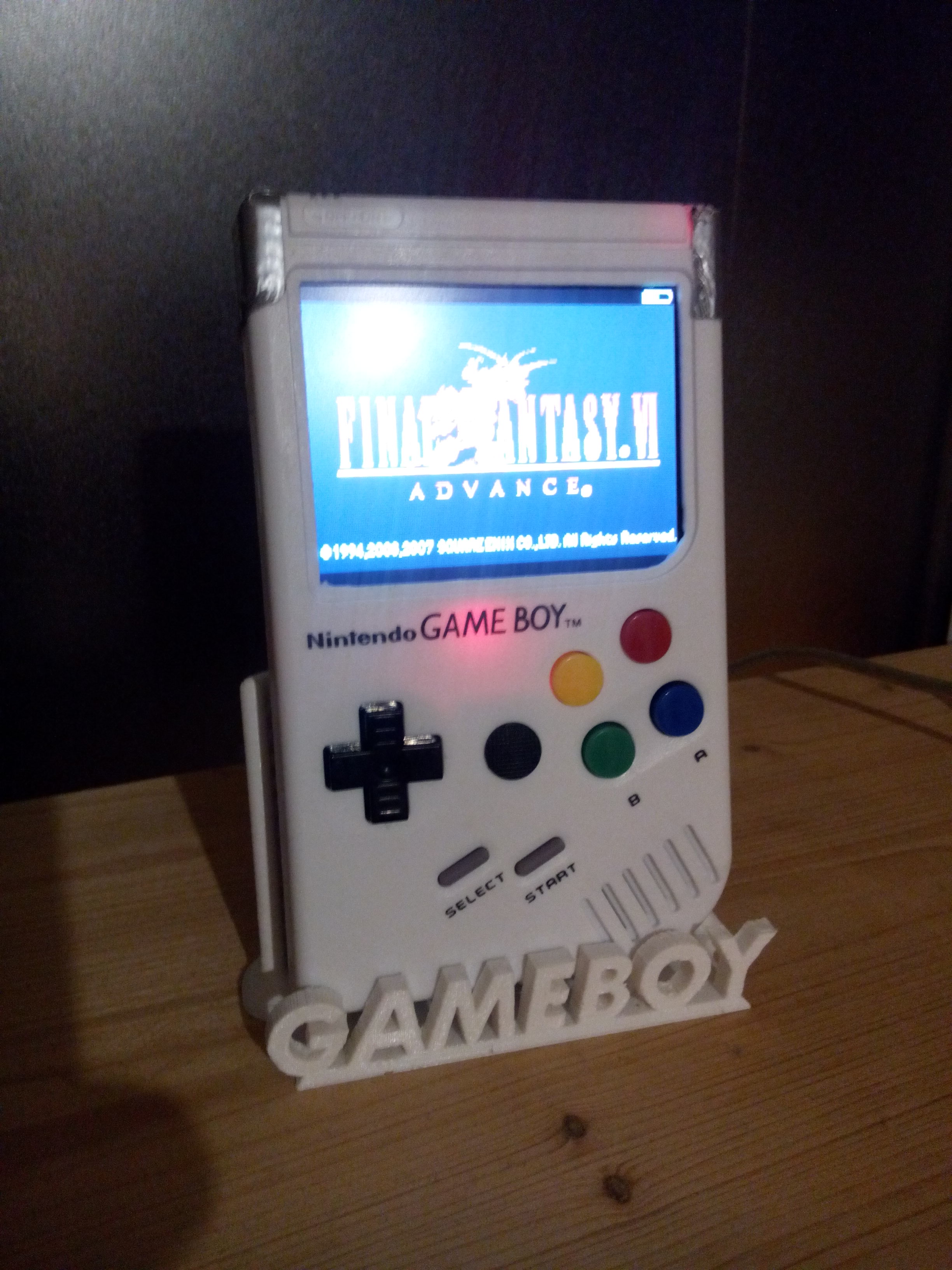

Result after 14 hours FinalFantasy VI: FAAAANTAAAAASTIC!

You are right, but the battery life is (for me) enough for a pi0. It is possible to put a second battery in the cartridge slot.

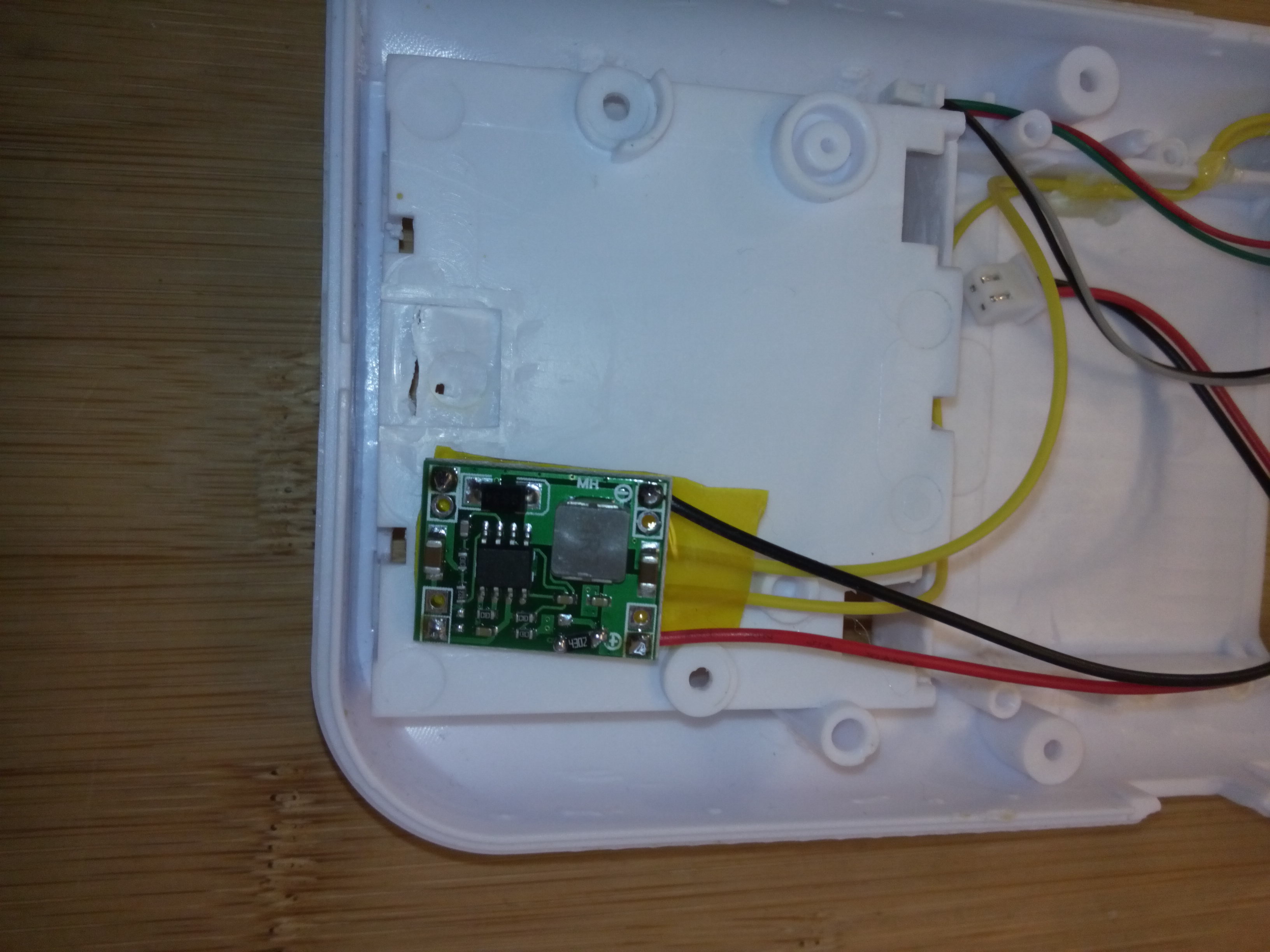

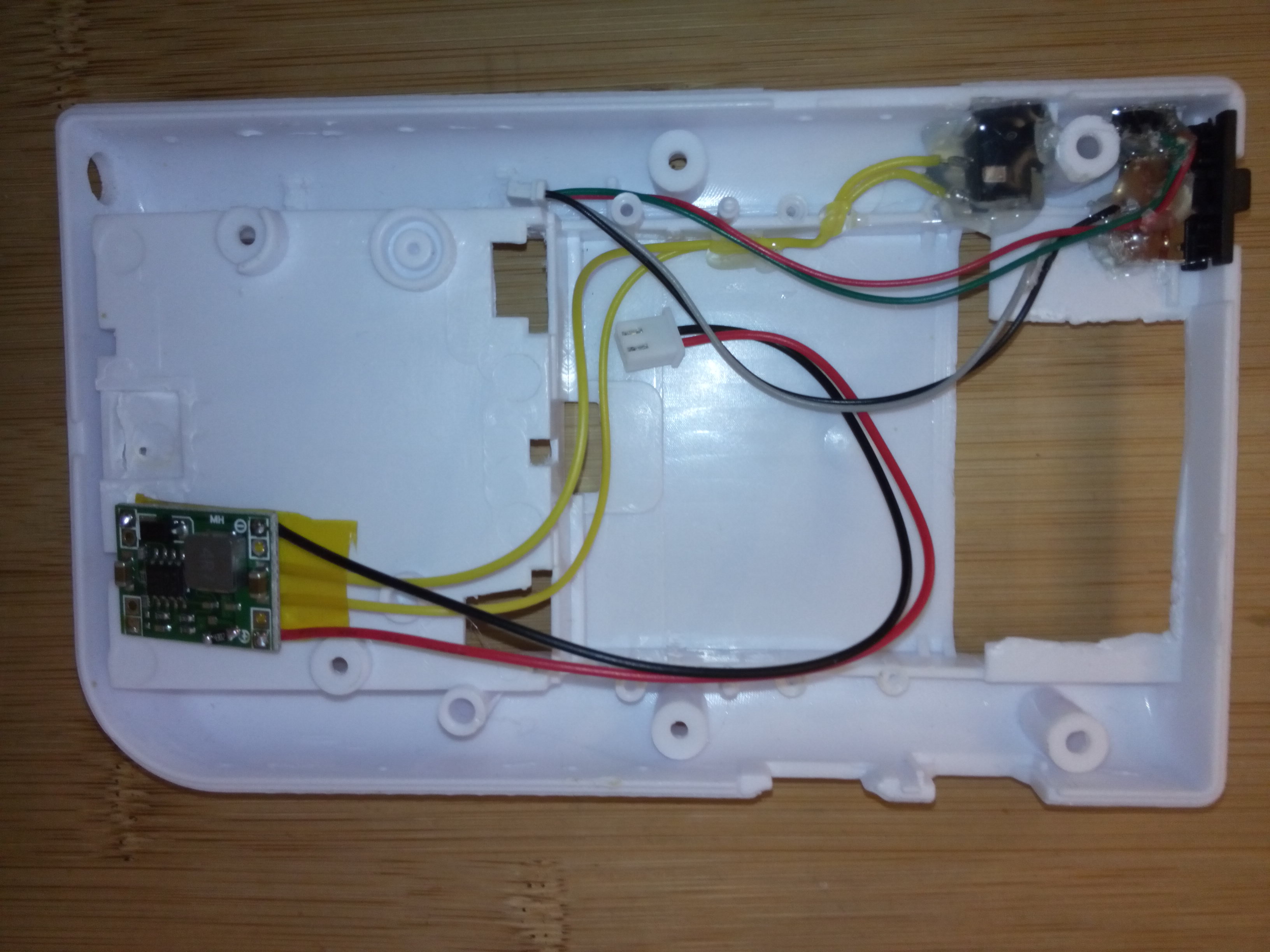

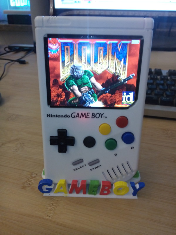

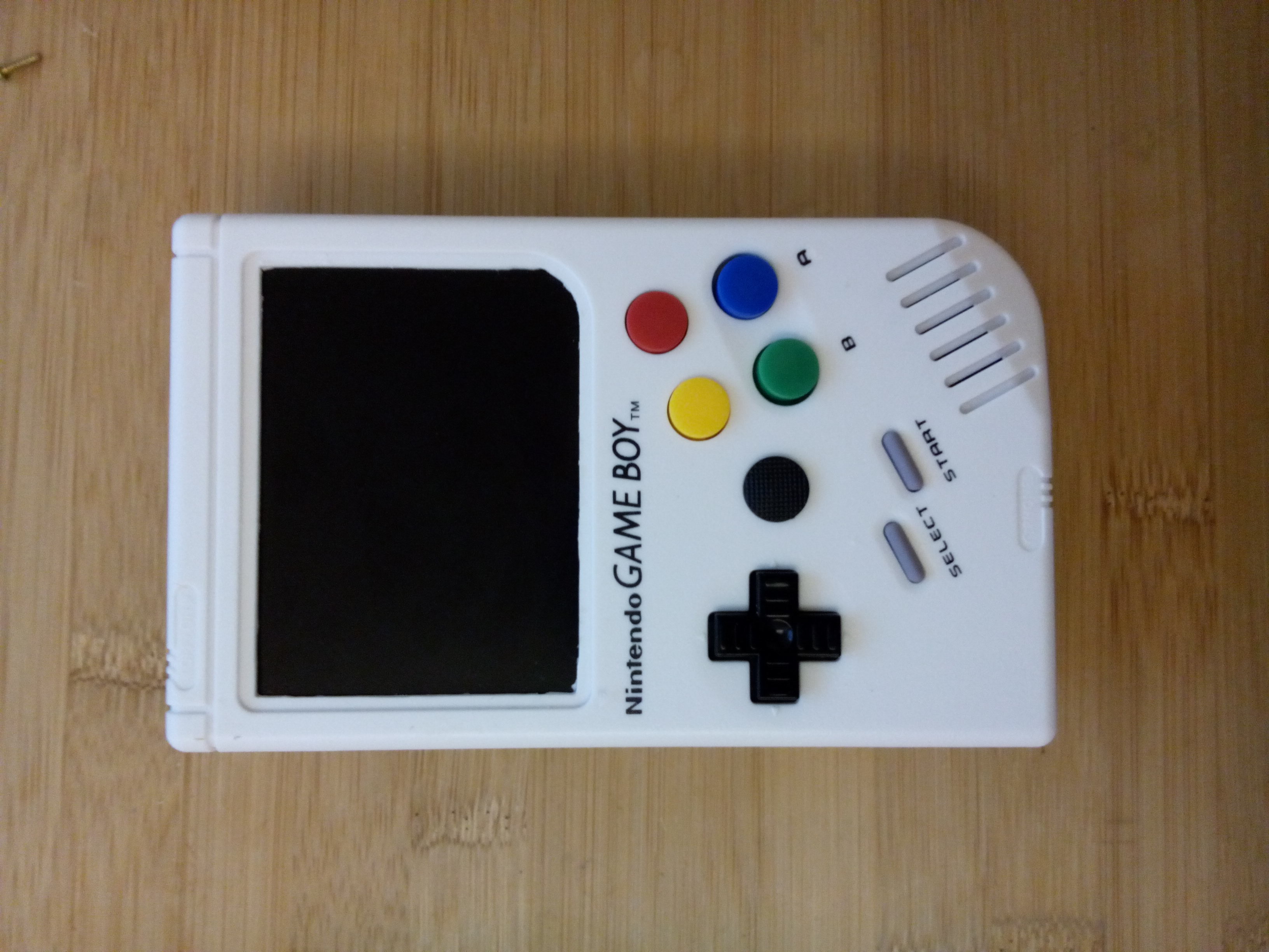

Friday I got the screws. I had planned too short. I installed a voltage regulator behind the DC-Jack. I can charge the YaGz with 9-32V.
My YaGz is ready.

The best shooter ever:
