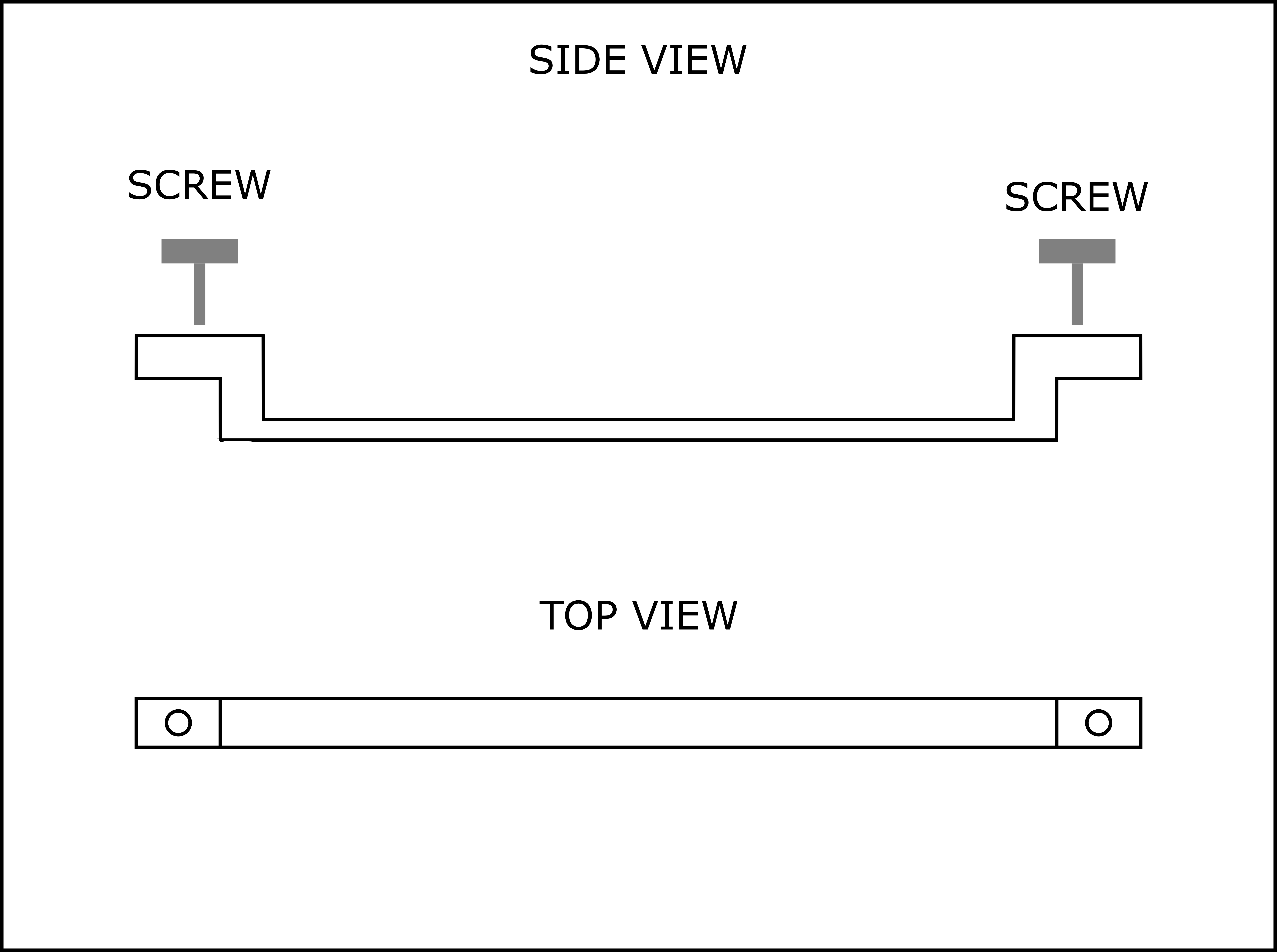

Probably won’t work with the snes cartridge, but on my build with a full gameboy cartridge (not cut like yours). I used a dremmel to cut a strip off the metal shielding piece just above the bottom? two screw holes. I then filed down the rough edges and covered it in electrical tape the friction keeps it in and stopped it popping out from the top at a funny angle. (I’ve just re-read your post and noticed the snes catridge is doing the same and I think the lip is the way to go). Maybe you could print a/some right angled piece(s) that screw into the same holes so you could keep your cartridge bracket at the top aswell. Something like below
These screw holes. (Sorry for bad editing did it on my phone.)
Cool. Thanks for the advice.
