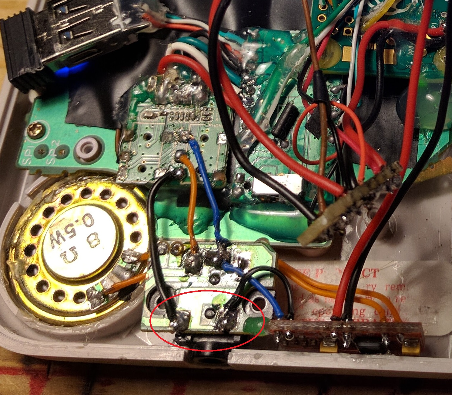

dirtybeagles
Posts: 386
Has thanked: 34 times
Been thanked: 64 times
Re: DirtyBeagles Build/Progress
Post by dirtybeagles » Mon May 30, 2016 1:27 am
Progress 5-30-2016 (Happy Memorial Day!):
Thanks for all the responses. I figured out what the connection should be and I will be making a complete diagram probably today after I sleep :lol: I used the USB sound board.
The only issue I have is when I plug in my headphones... I still get sound through the speaker. Here is my connection and I assume it has something to do with my ground wires circled:

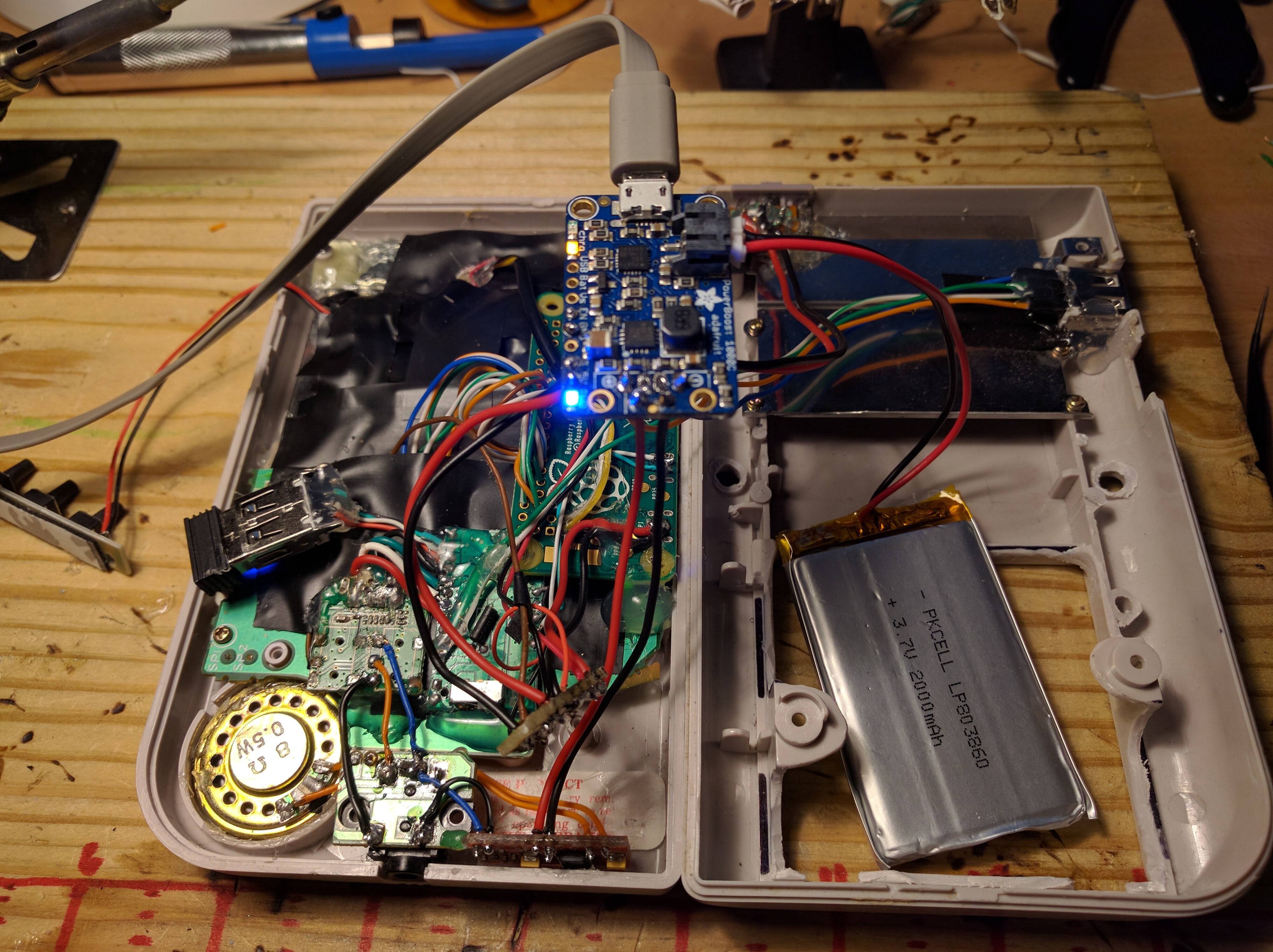

Here is the insides so far:
