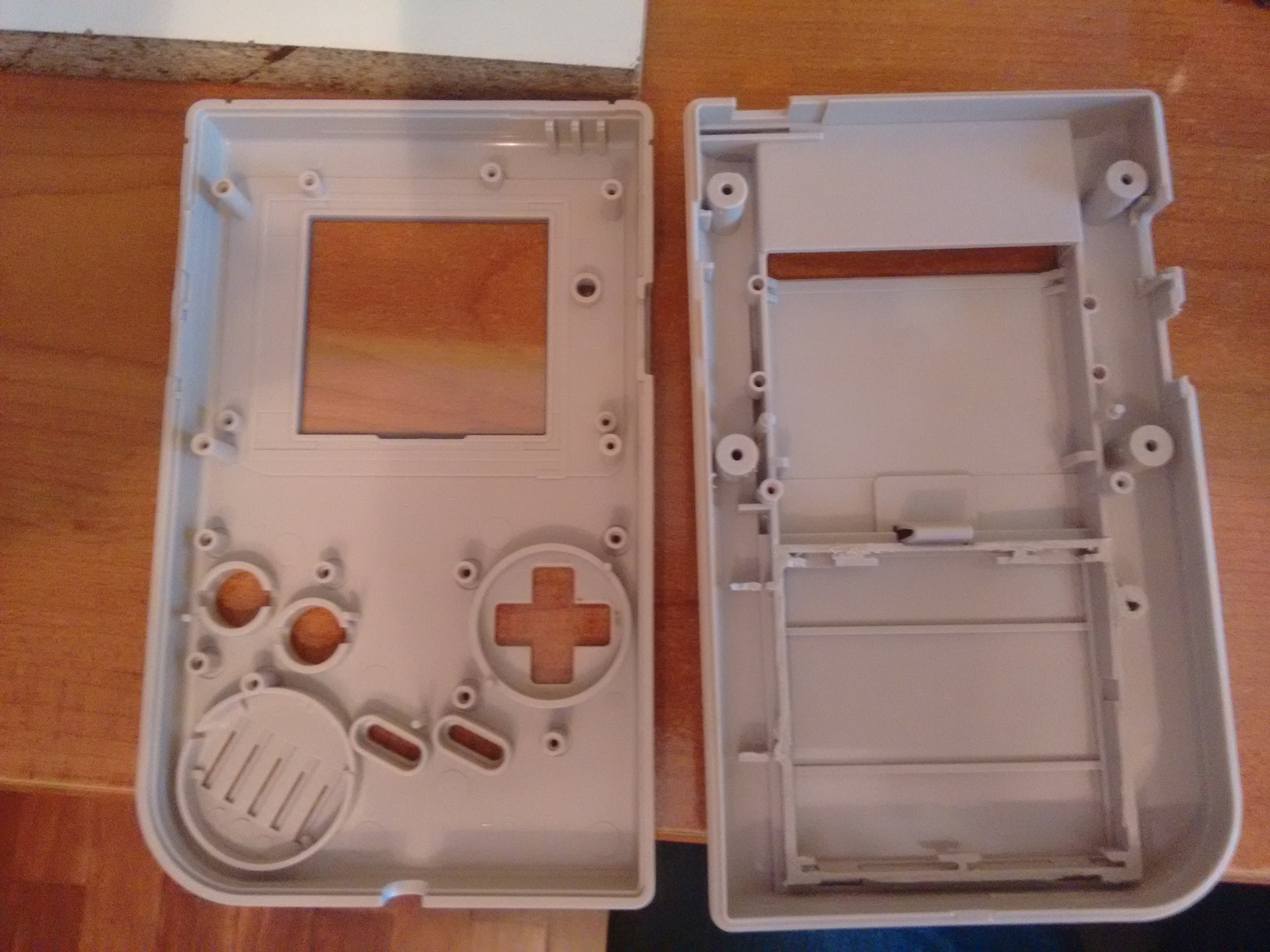

I started thinking about building the GBZ when I first saw the PiGRRL from Adafruit, but not having a 3d printer for the case, I thought about building it on a OEM Gameboy case. I removed completely the battery compartment.
[spoiler="OEM Gameboy Case"]
[/spoiler]

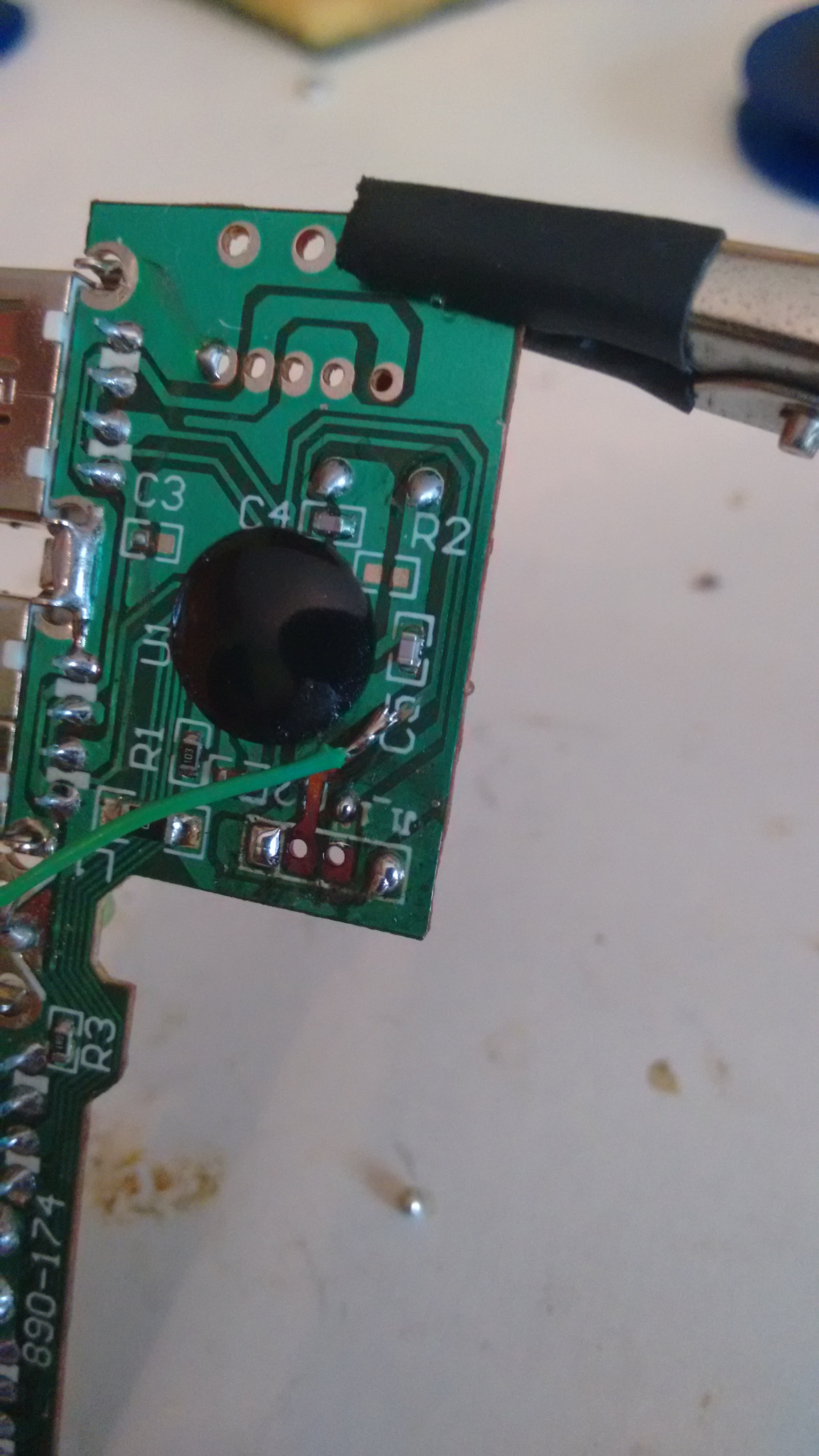

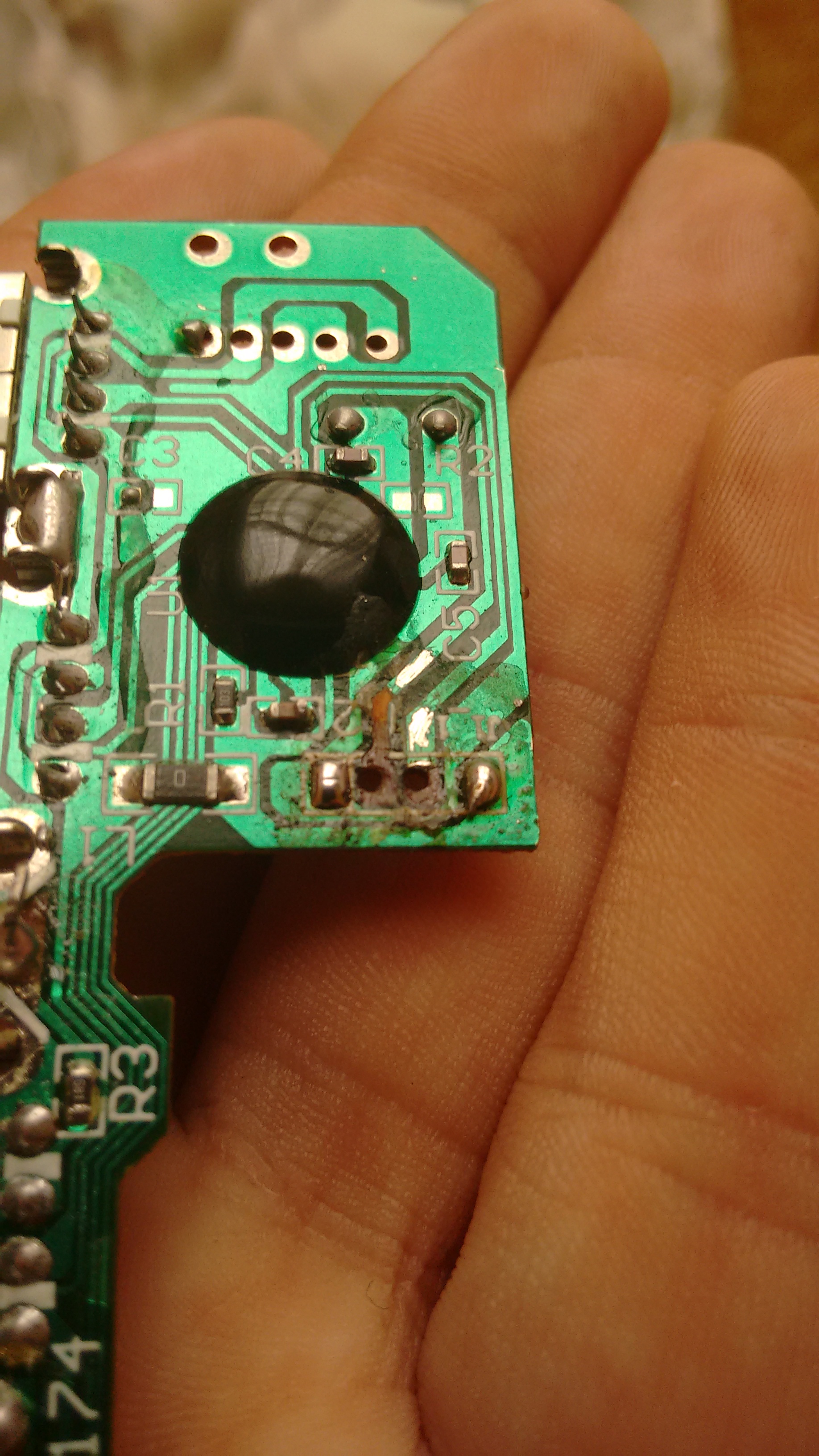

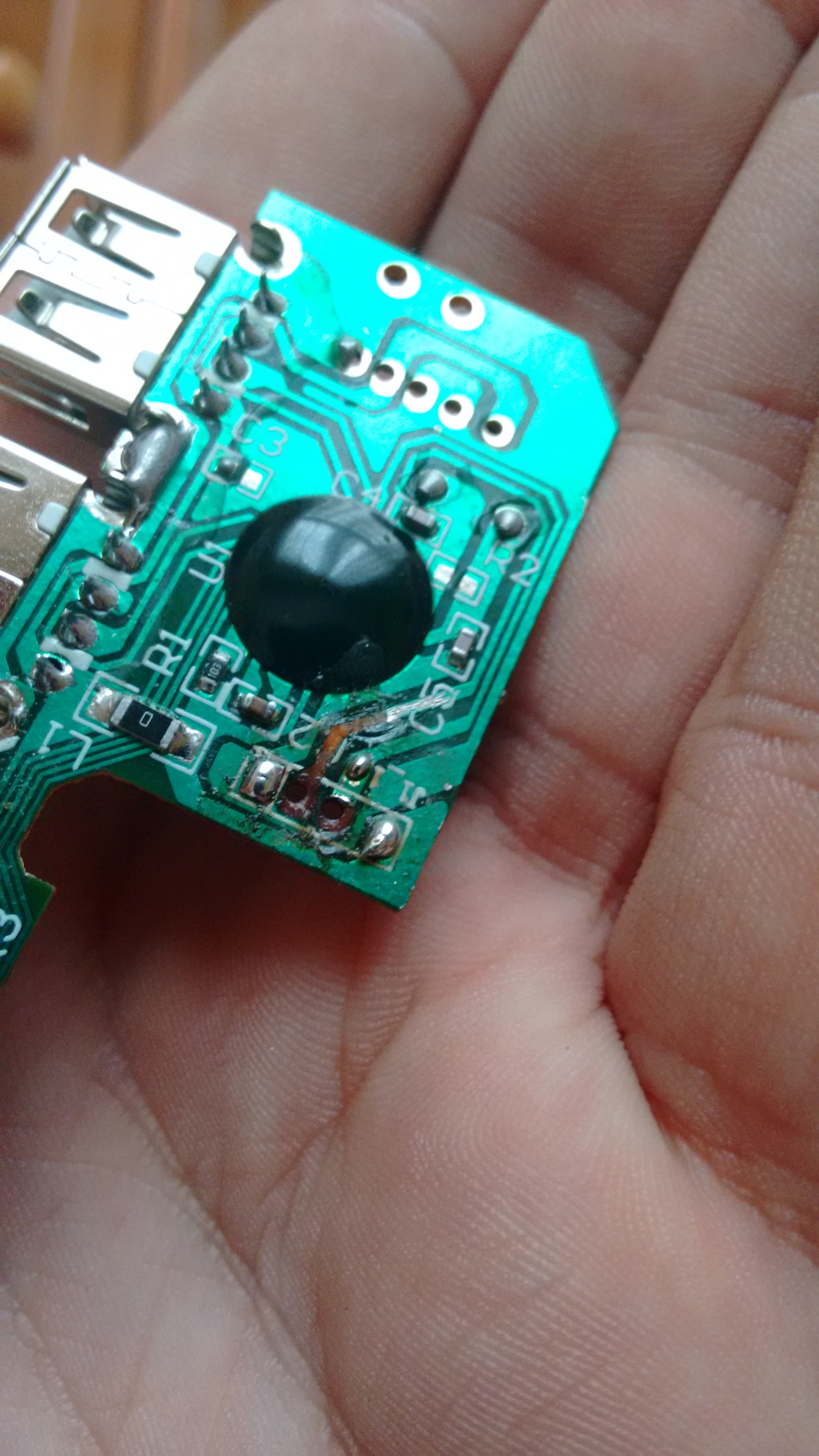

Well, I got my second Pi0, and as I did not have another screen yet to play with, I started testing a USB Hub I had laying around. However, it was so old and bad quality, that while removing the wires from the USB Cable, the traces lifted:
[spoiler="USB Hub is shit"] [/spoiler]
I repair it by scratching the traces and soldering there. I also hot glued it for making it stronger. I tested it in the Pi0, and nothing happened. The Hub didn´t seem to work with Pi0. Apparently Pi0 is very weirdo with Hubs.
[spoiler="Trying to fix it"] [/spoiler]

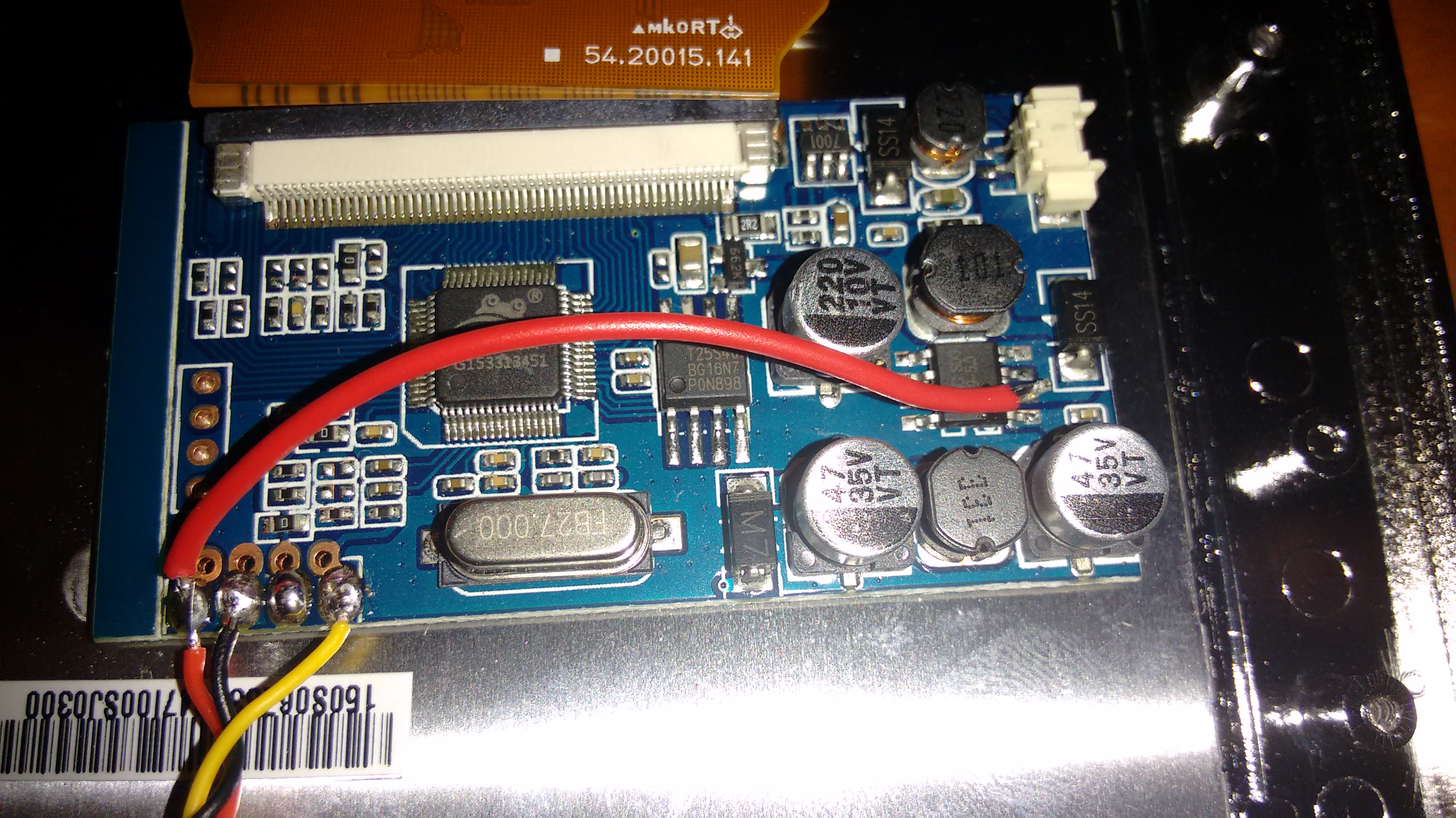

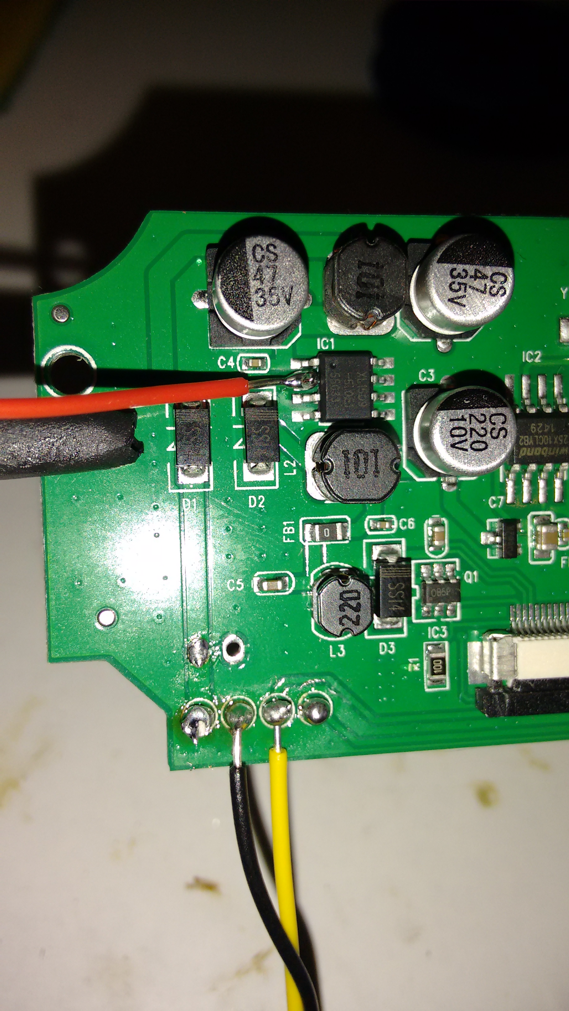

I was lucky, and I received the BW Varient 7 / ePathchina, which is on the wiki, and it´s easy to mod. So the first thing I did before testing it up, was modding it to work with 5v, and following @Fleder ´s guide to wiring the LCD to the Pi0.
[spoiler="Mod"] [/spoiler]
It worked!! I couldn´t believe that after so many problems, I could see a small light at the end of the proyect.
[spoiler="Screen working"] [/spoiler]

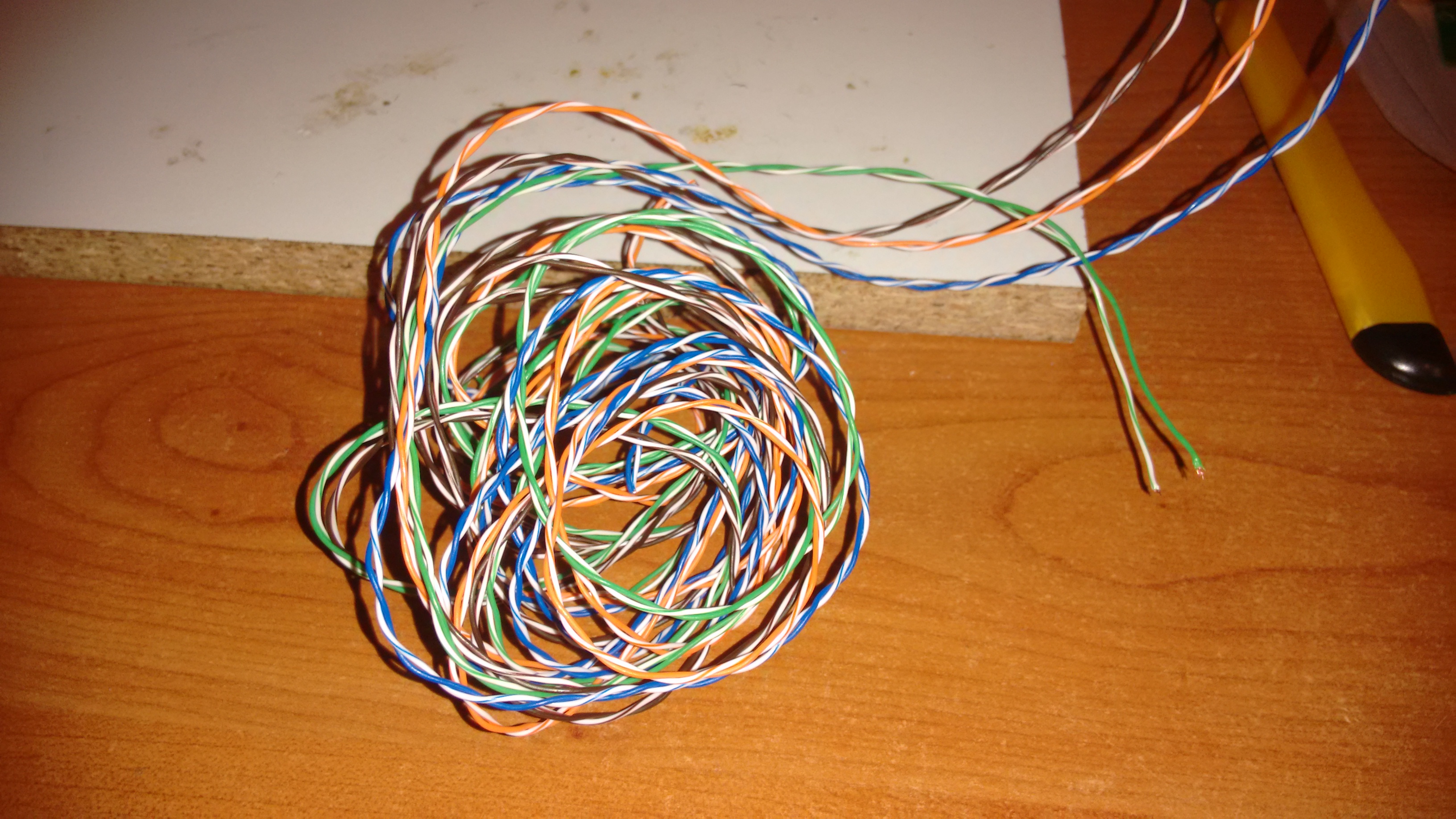

I have used a colored mix o wires, which I thought it would be easier and prettier to wire to the Teensy, but it was actually more difficult.
So in the second attempt, I used cables from and old broken Ethernet cable (I swear I did not break this one myself lol). It was far less from looking pro, but it worked perfectly. Why? Because in the previous attempt, I forget about wiring GND wire!!! Silly Tamasco...
[spoiler="Gamepad + Teensy V2"] [/spoiler]

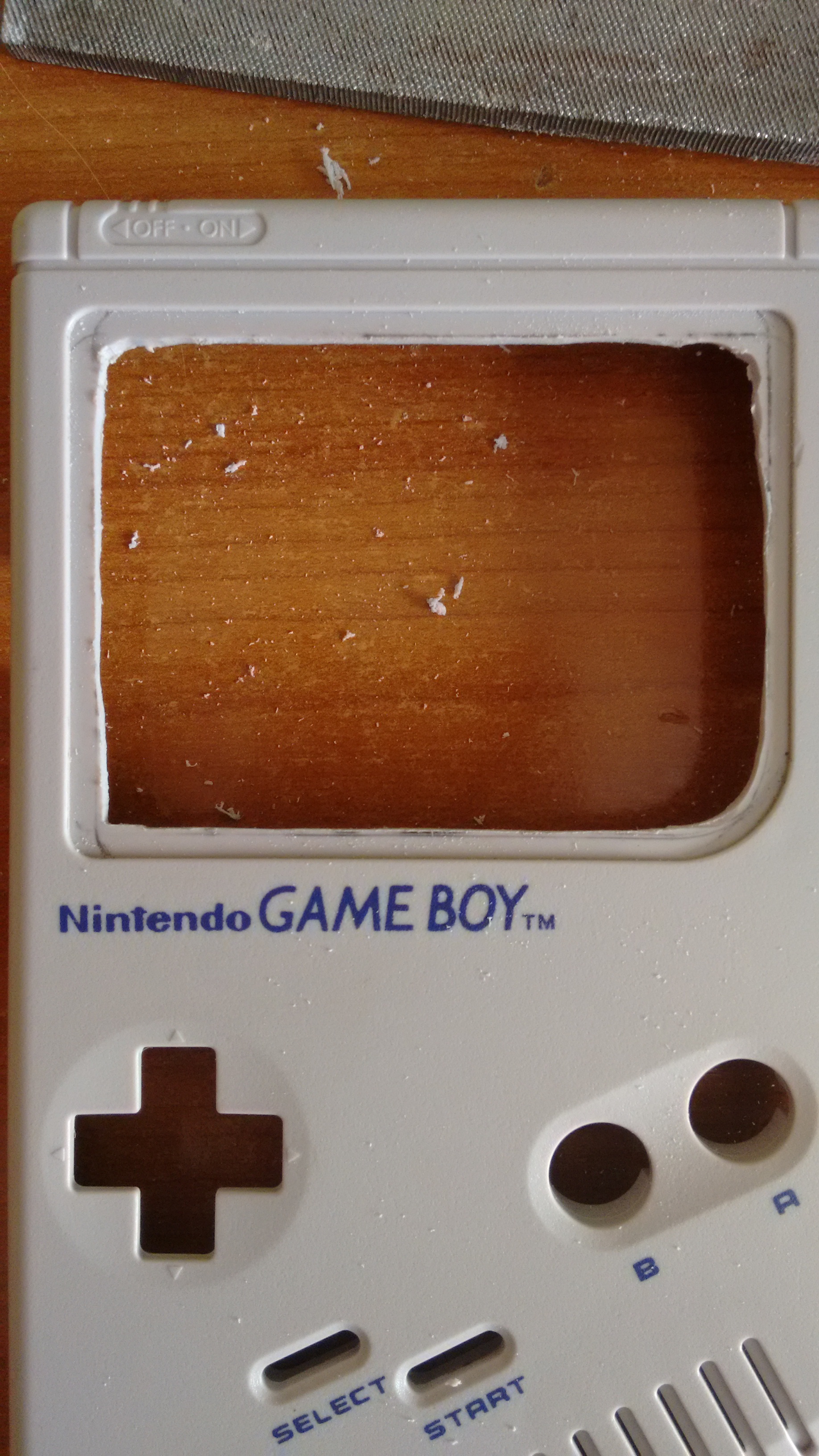

So, as my screen was working, I decided to finally mod the front case for the screen. I made use of the dremel, and some hand tools adviced in Discord chat (thanks everyone in there!).
[spoiler="Modding the front case"] [/spoiler]
