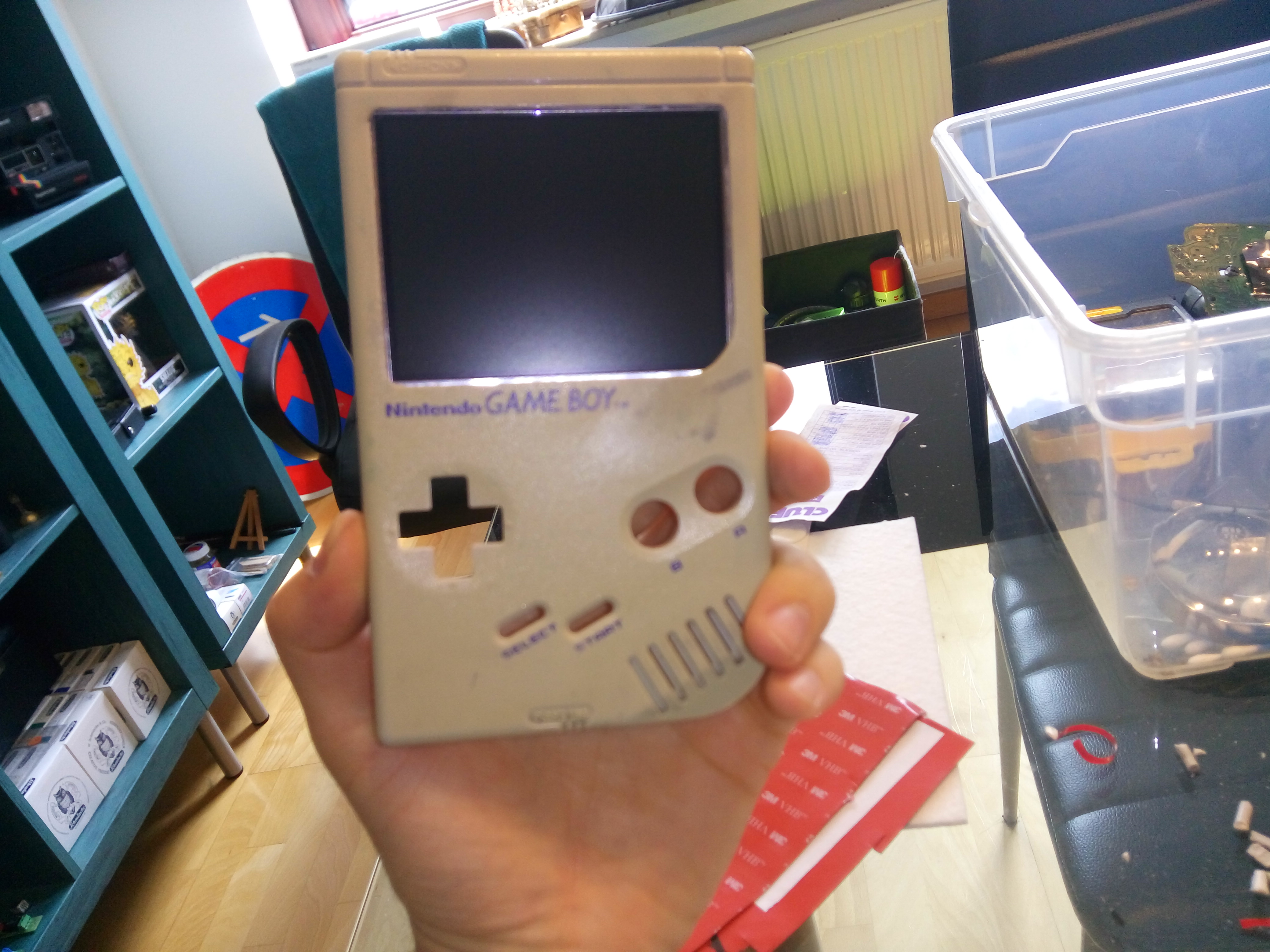

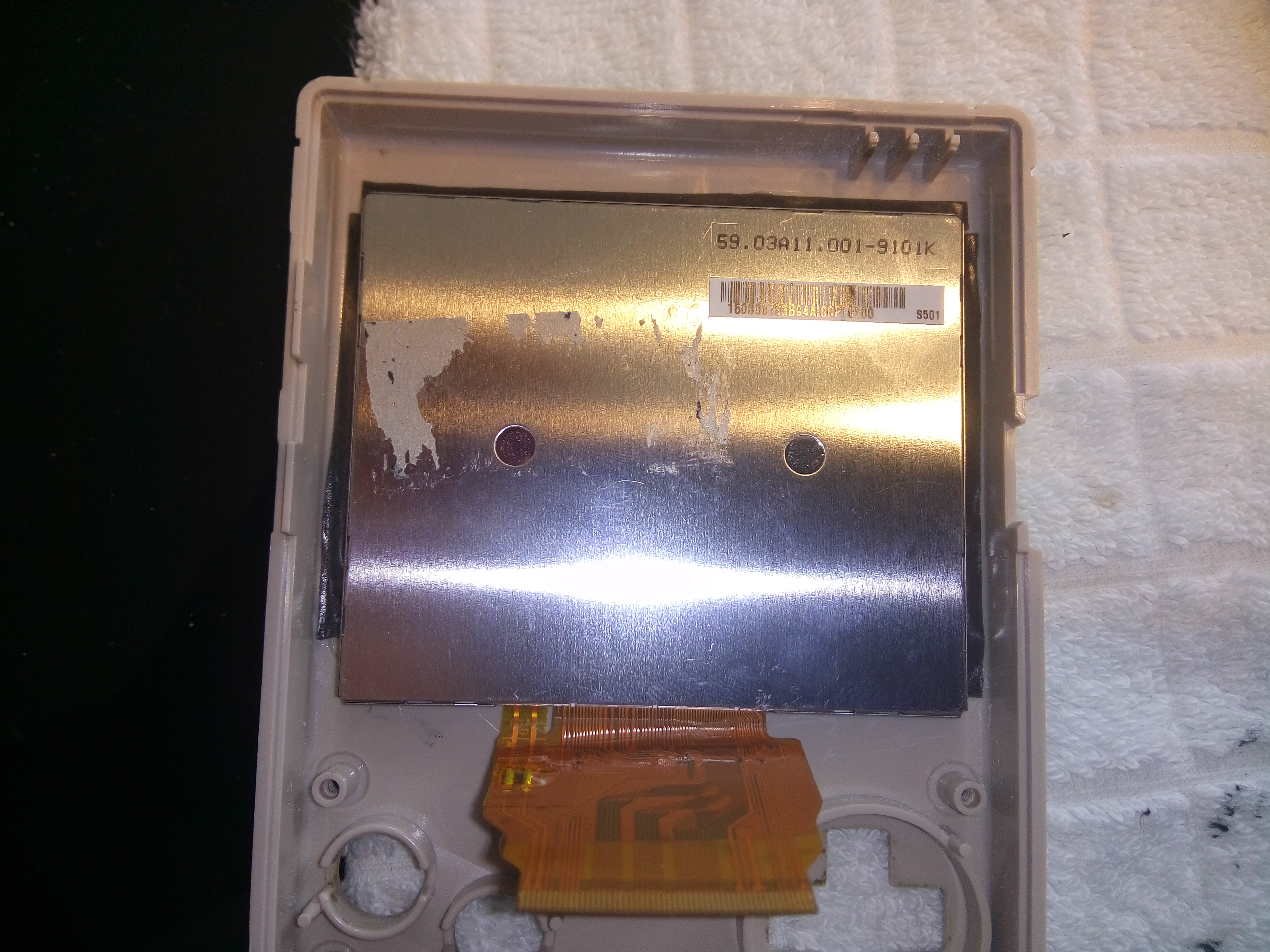

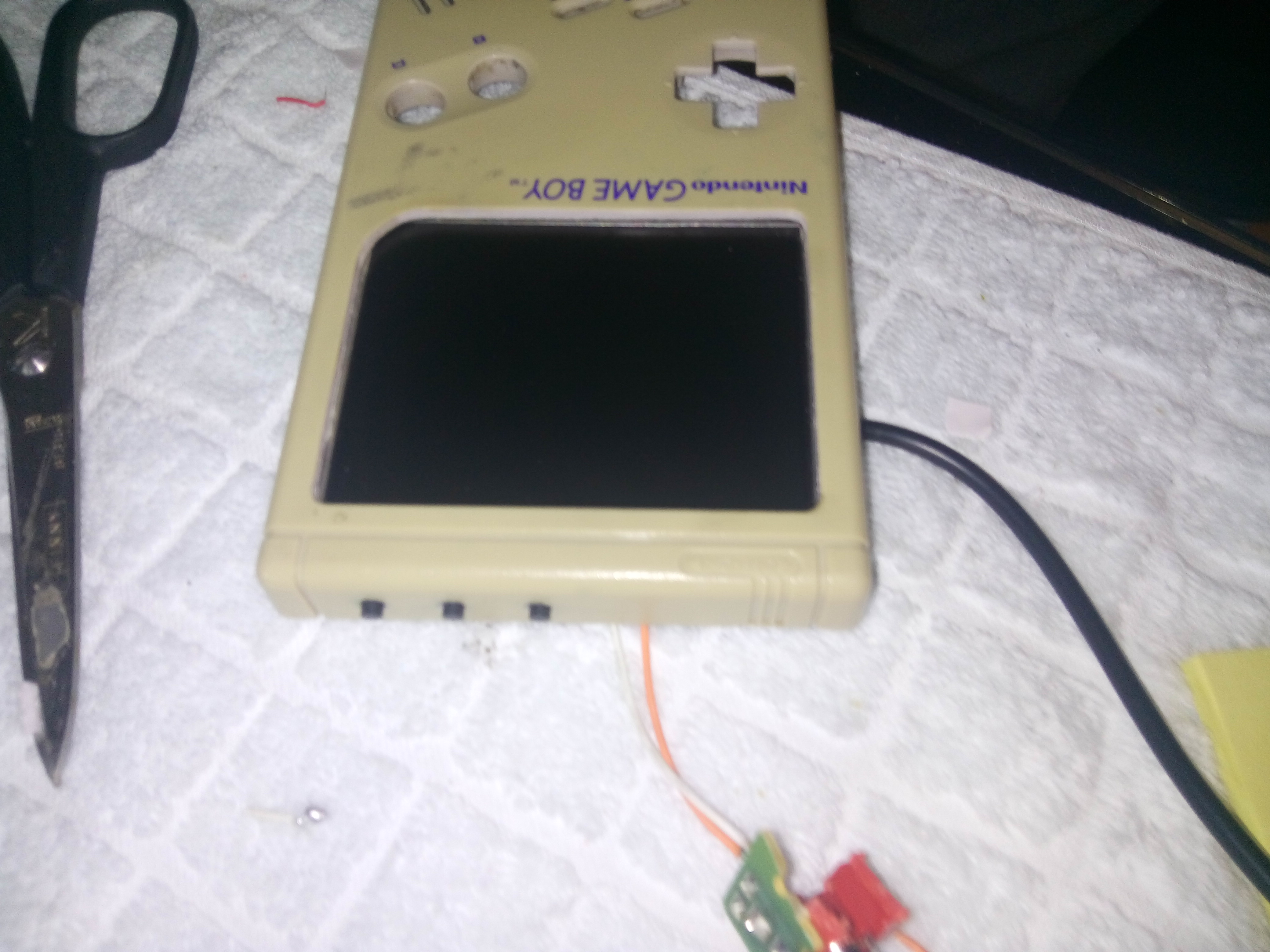

I filed the border in the Gameboy case for the display instead of using a Dremel, that worked great.
To mount it I used 3M VHB which saves a lot of room around the display (making place for the button board) and hold really really well.
I'm sure I will use it for other parts too.

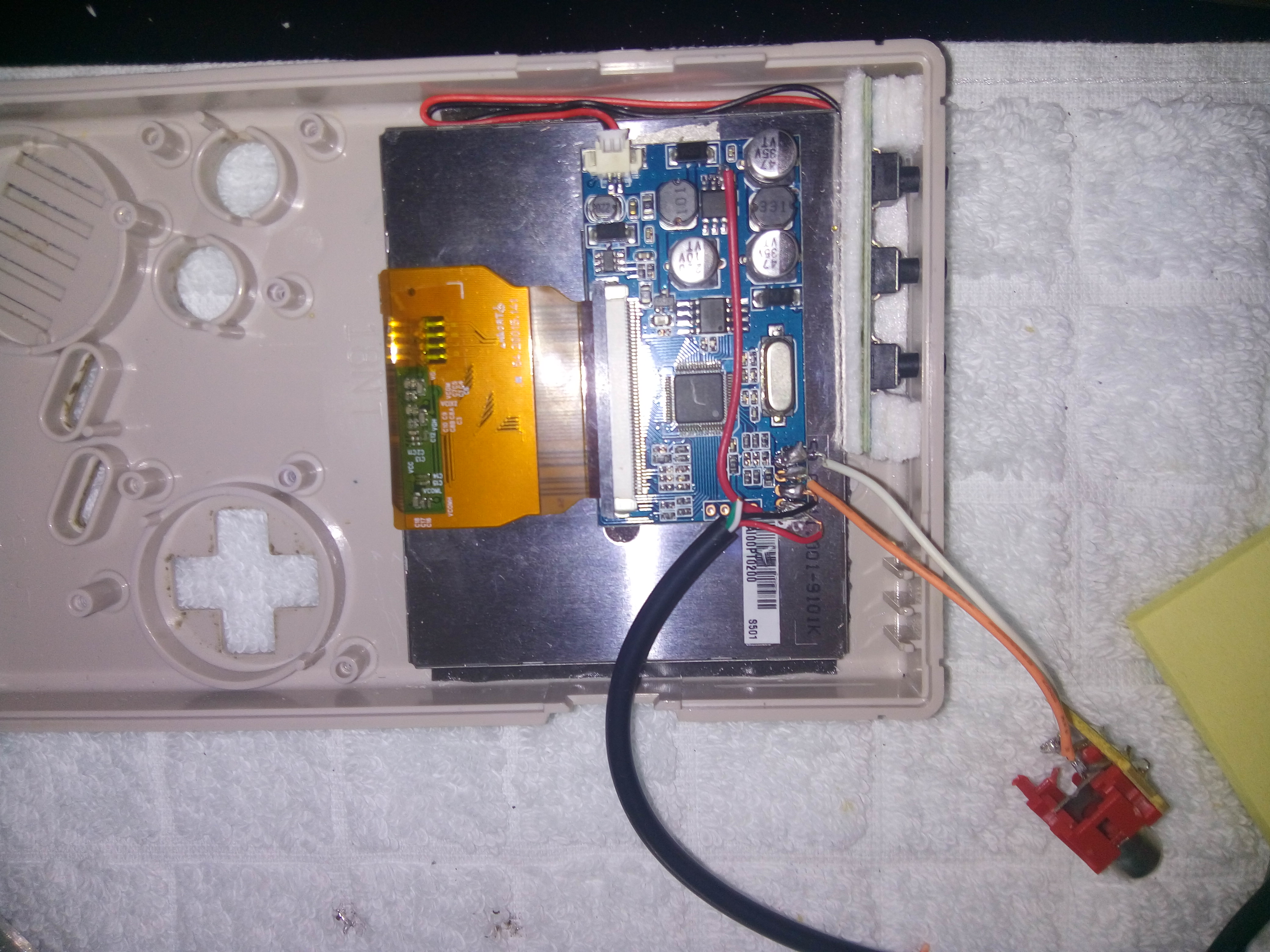

I went to the WIKI and ordered the BW 3.5 Variant 1 from Amazon. I got Variant 7 instead, which is great! It only needs a extra wire and the board is really small.
It has a separate Button Pad and i decided to mount it over the display, making holes for the buttons in the case. It mounted using some felt pad material and pressed between case and display. Surprisingly it holds really really well and doesn't move at all.
I tested the display with my WII and the quality is really nice and settings are now easily adjustable.

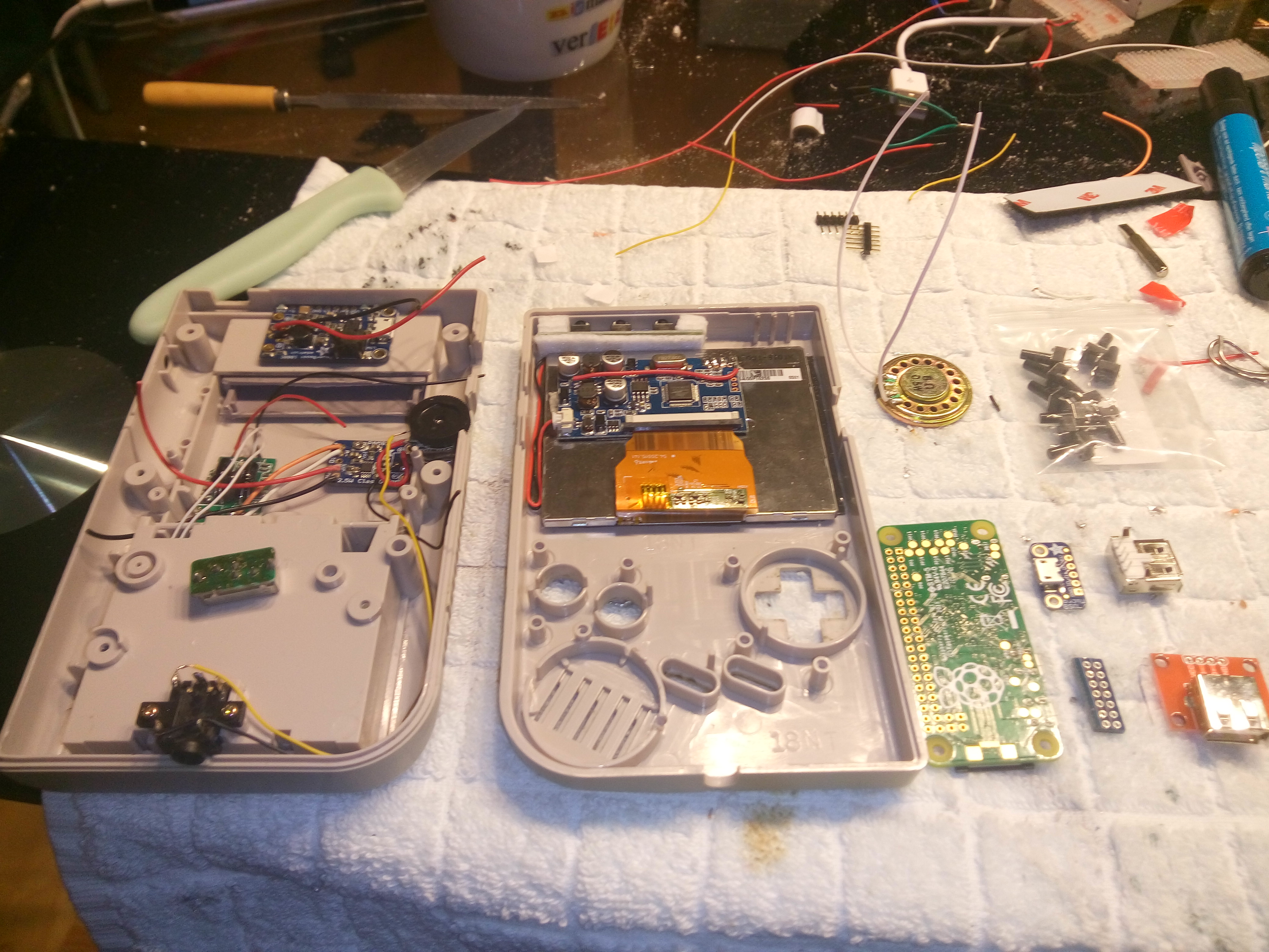

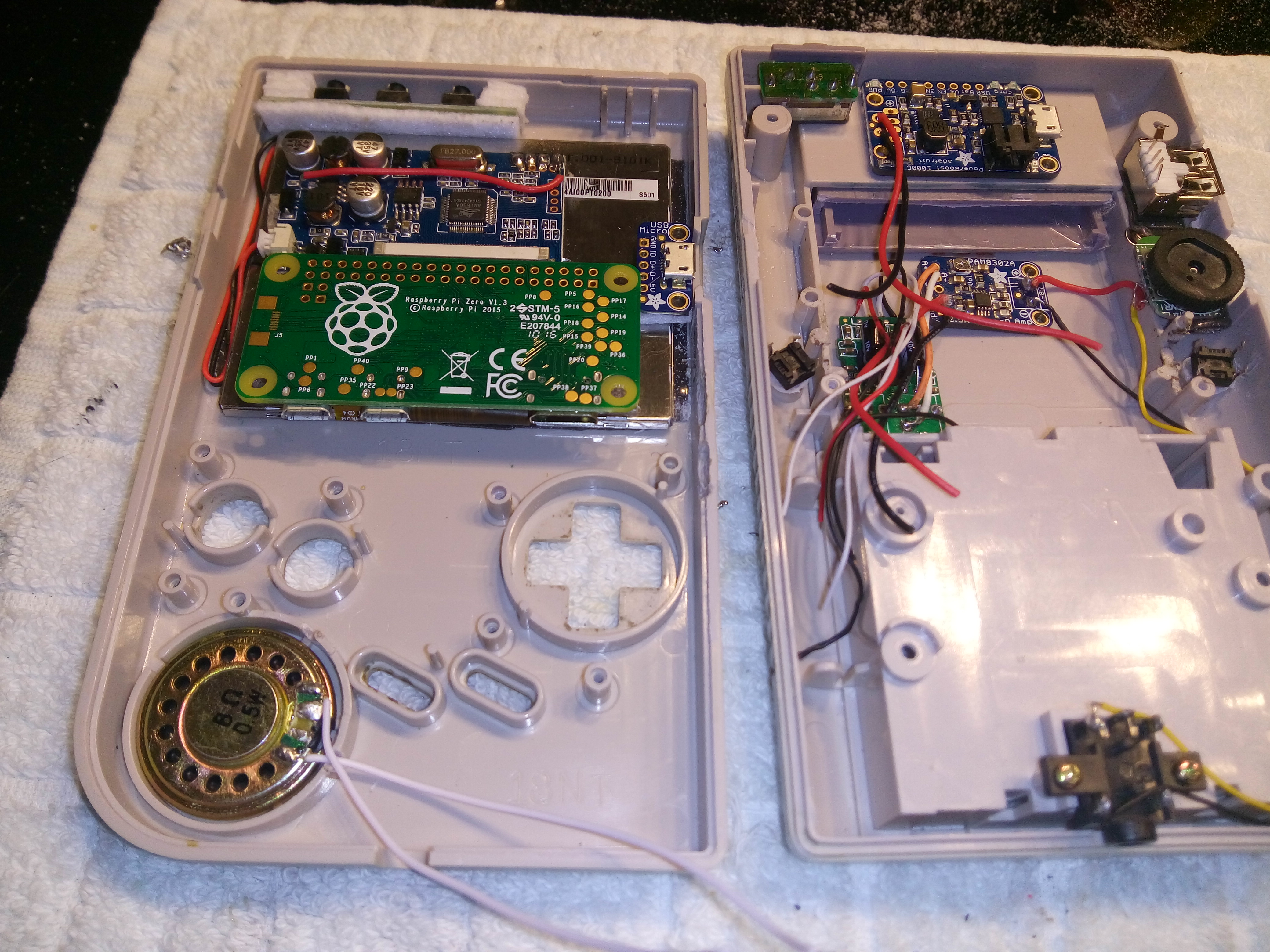

I tested out some layout options and figured when I remove the cartridge portion inside the case I would have more than enough room for everything without removing the battery compartment.
So, as I don't plan on changing the system often if at all (a big memory card with most romsets for working emulators) I decided to save some work by not making the SD card easily replaceable and not using the HDMI port.
I also won't use a separate microcontroller for the controller. I have enough room to add a header to the PI GPIO to connect the button board.
I also reused the volume wheel from the GB. It and the USB port is hold in place by a cut piece of the metal that was over the cardridge slot in the GB and some more VHB tape. The boards are also held in place with tape.
Missing:
USB Hub will be placed where the sound boards are (a small octopus one)
PI will get a header to connect the button board
Button board still not here :( also case modification for 2 extra buttons.

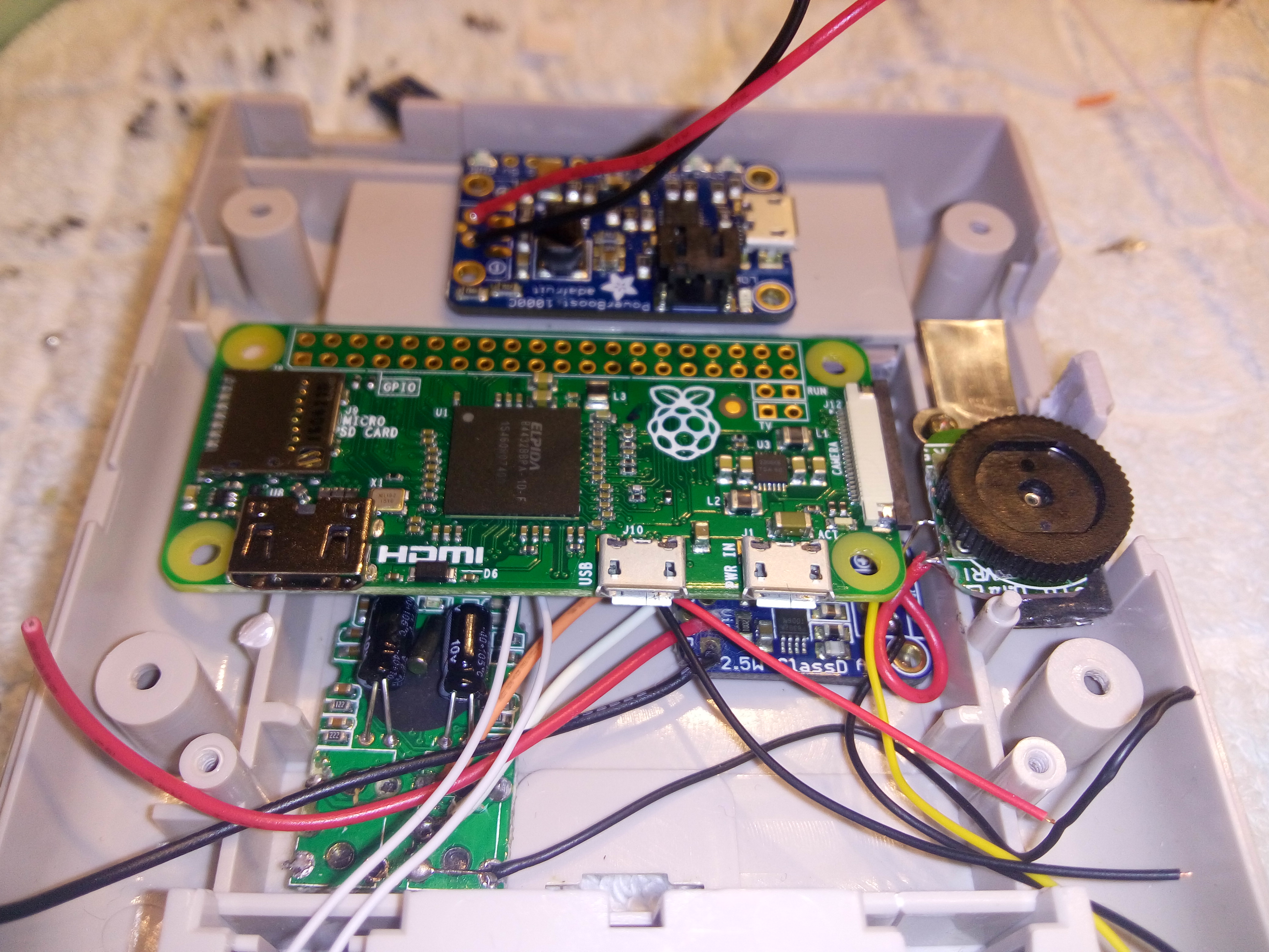

changed the layout so the Pi is on the button board side for easier wiring.
Added the power switch, micro usb charging board, two shoulder buttons and normal usb port.
Everything attached again with VHB tape and the PI with duallock except the shoulder buttons, they sadly need a drop of hot glue :(.
The dual lock creates a nice big gap between display connector and the PI with enough room to let air theough if I need to add a fan.
Now I have to wait for the missing parts (hub, button pcb and a screen protector) :( but I will wire everything up this weekend to set up the software with a usb keyboard.

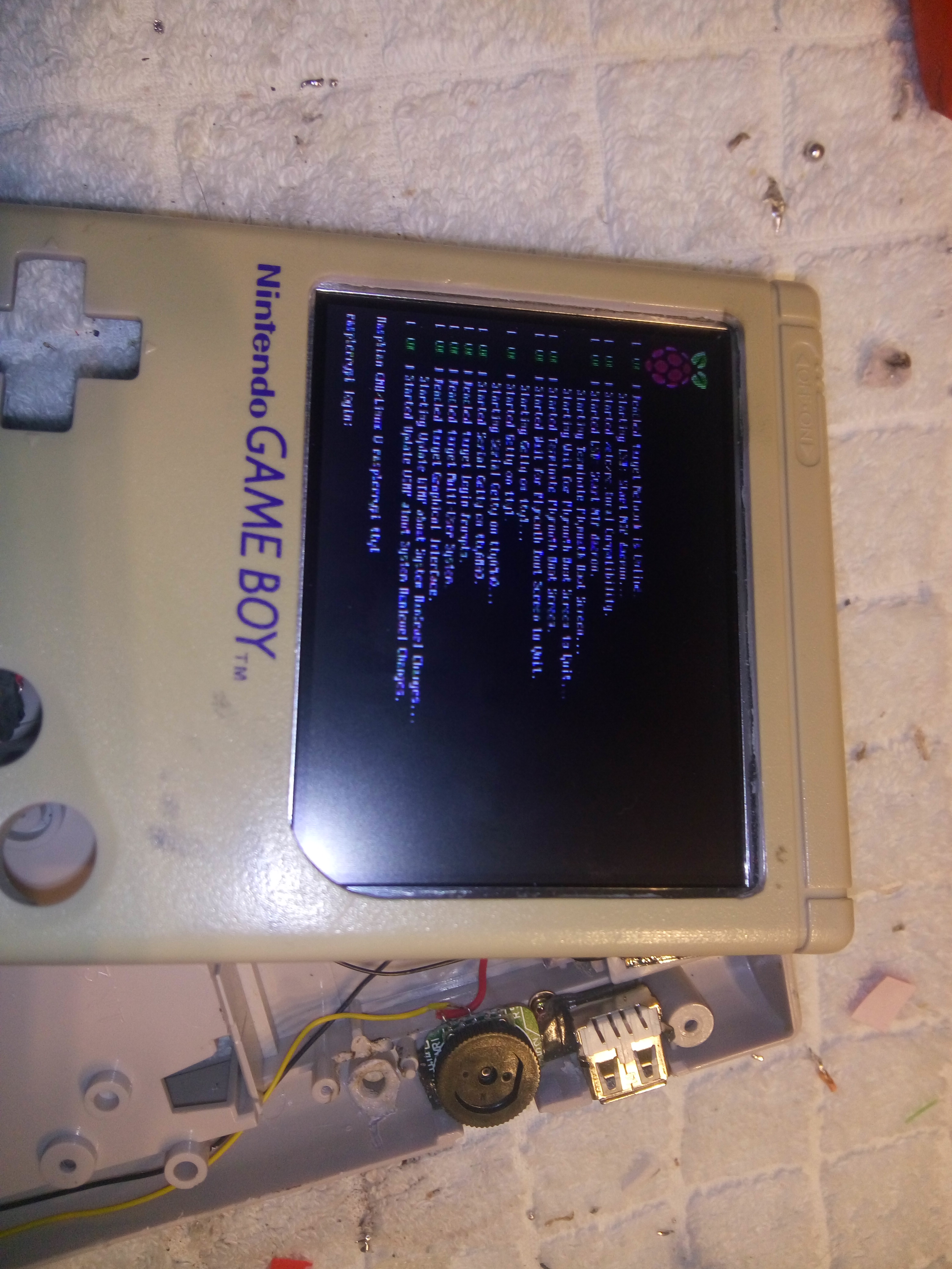

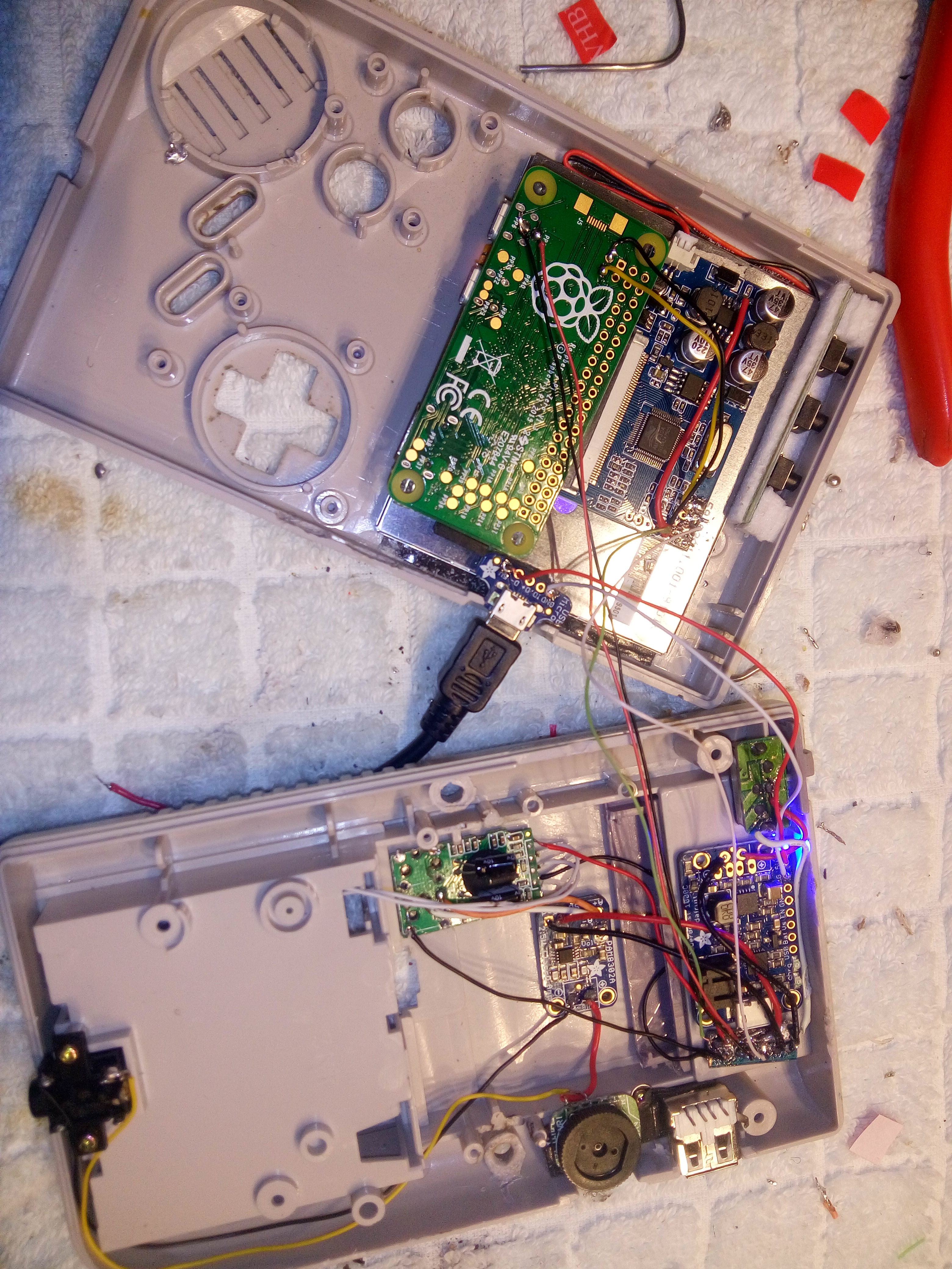

It lives =D
I wired everything except the usb devices and the button pcb (I guess it will arrive next week :( )
And it works just fine, display look OK too (I can read the text, but it definitely is not sharp) :)
I also did a not too stellar job on the wiring but it works. Also made the sad sad decision to put hot glue over the soldering points and some selected points to keep everything except the PI place, now I have to get a glue gun.
Power button works too and I hope the wiring I found for the audio works out too.
Also ordered 4 AA LiPo batteries to add to the original battery compartment, I will combine them into a powerpack but keep the look of 4 batteries in the compartment like it always looked. Also figured with my layout I can easily make the SD replaceable (I did't know it sticks out so much).
