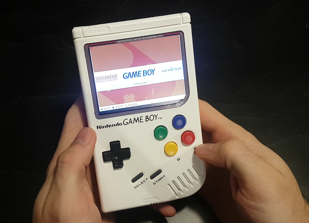

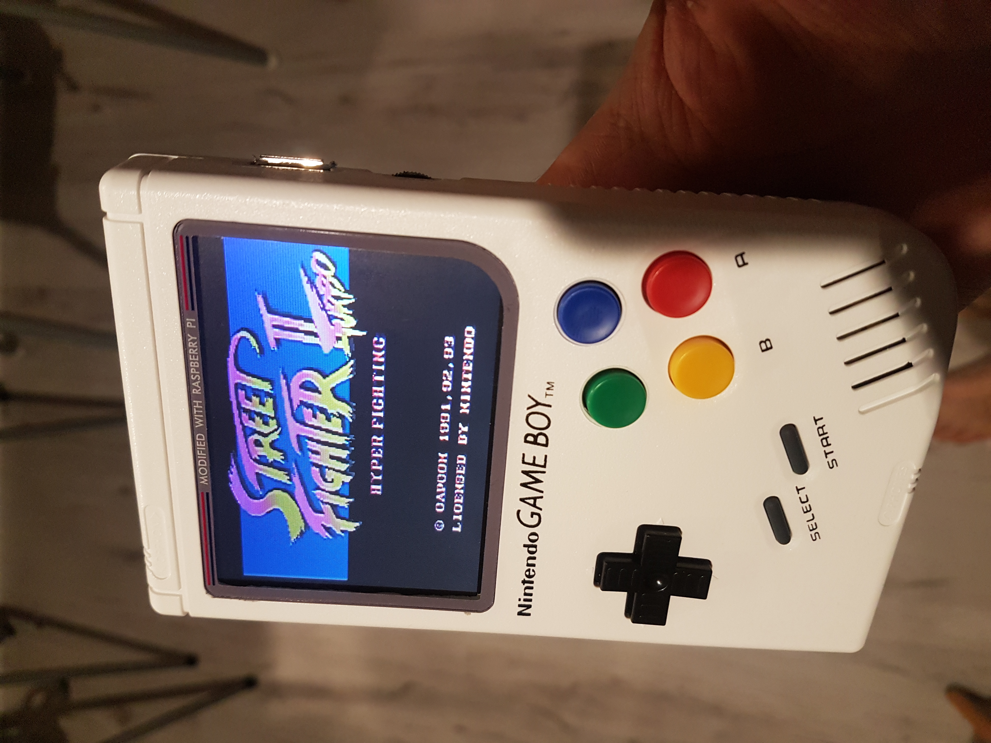

At long last I've finally completed my first build.
Had a delay after my Gearbest screen died on just before completion. New BW screen from Amazon UK arrived yesterday (I now live in Perth, Australia).
Albeit a few tweaks still to make before I'm completely happy.

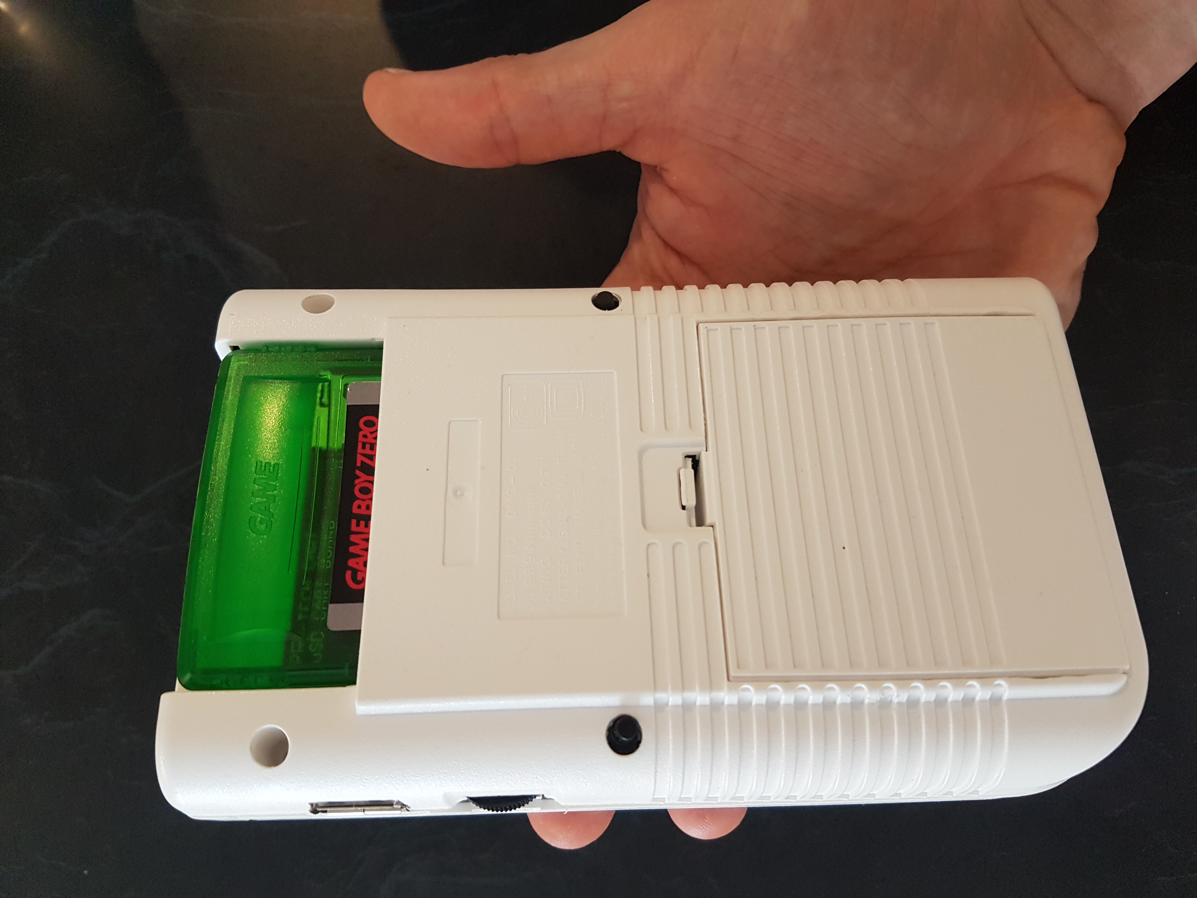

Here's the front and back:
Front:
Back:
Had some trouble closing the case despite trimming the wires as much as I could. All closed up now but perhaps a bit too much pressure on the screen as hard button presses or case presses cause the screen to distort, like if you press your finger on a screen too hard.
Will look to fix this.
Also to fix:
- Space inside battery bay - had to sacrifice my 2nd USB port as I couldn't fit this and the battery. Will look to reinstate.

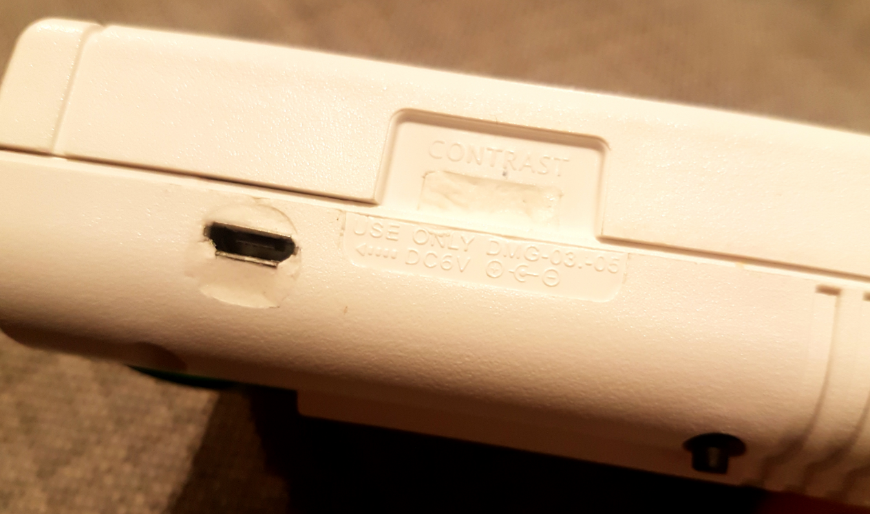

- USB port on side isn't quite straight.
- Going to use white silicone to fill surround of USB charge port.
- Audio - headphones work perfectly, speaker suffering from AIO 2.2 issues noted across forum. If volume is slightly increased the sound it intermittent and broken etc. Noted fix from others regarding 2x 75ohm resistors.
- Align the mini HDMI output slightly better as its not quite straight with case opening.
All in all, happy with the look!
Lots learned on this one, from doing little to no soldering before (Year 7 school project with a 9v battery and a red LED only) to being confident on the iron and soldering with speed and accuracy.
100% recommend the temperature controlled iron and 3rd hand.
Thanks to everyone who helped with my queries to date and special thanks to @wermy and @helder.

Instead of silicone you could use Sugru. I don't have a great picture, but you can see belowe how is smoothen the hdmi connectors.
I thought I would share, as I was really glad I found this solution.

This looks better than silicone. Will look into getting some!
UPDATE:
Arrived and applied, very happy with it!
Also filled in the micro HDMI out as i wont use it and i never quite got it aligned.
