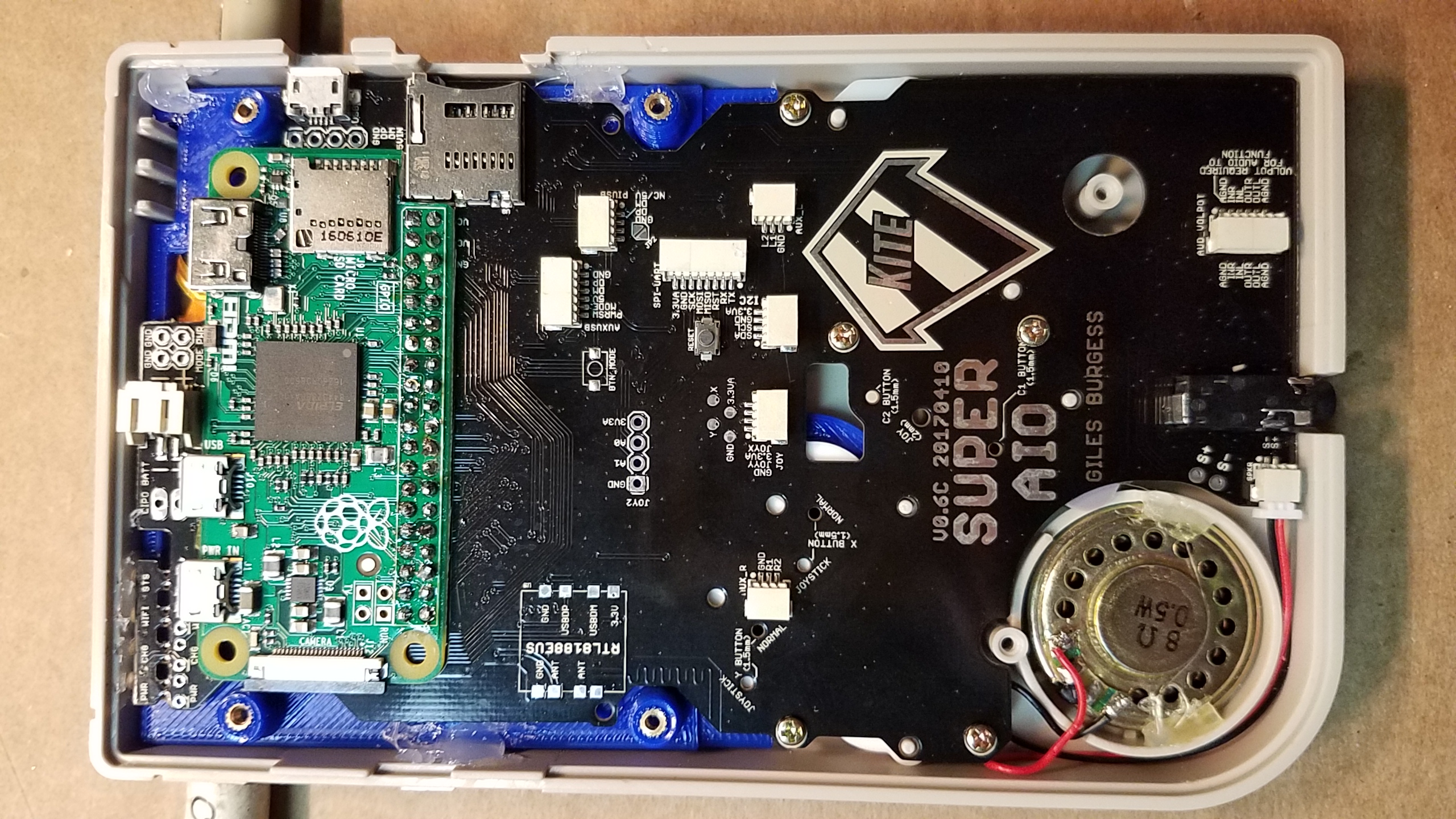

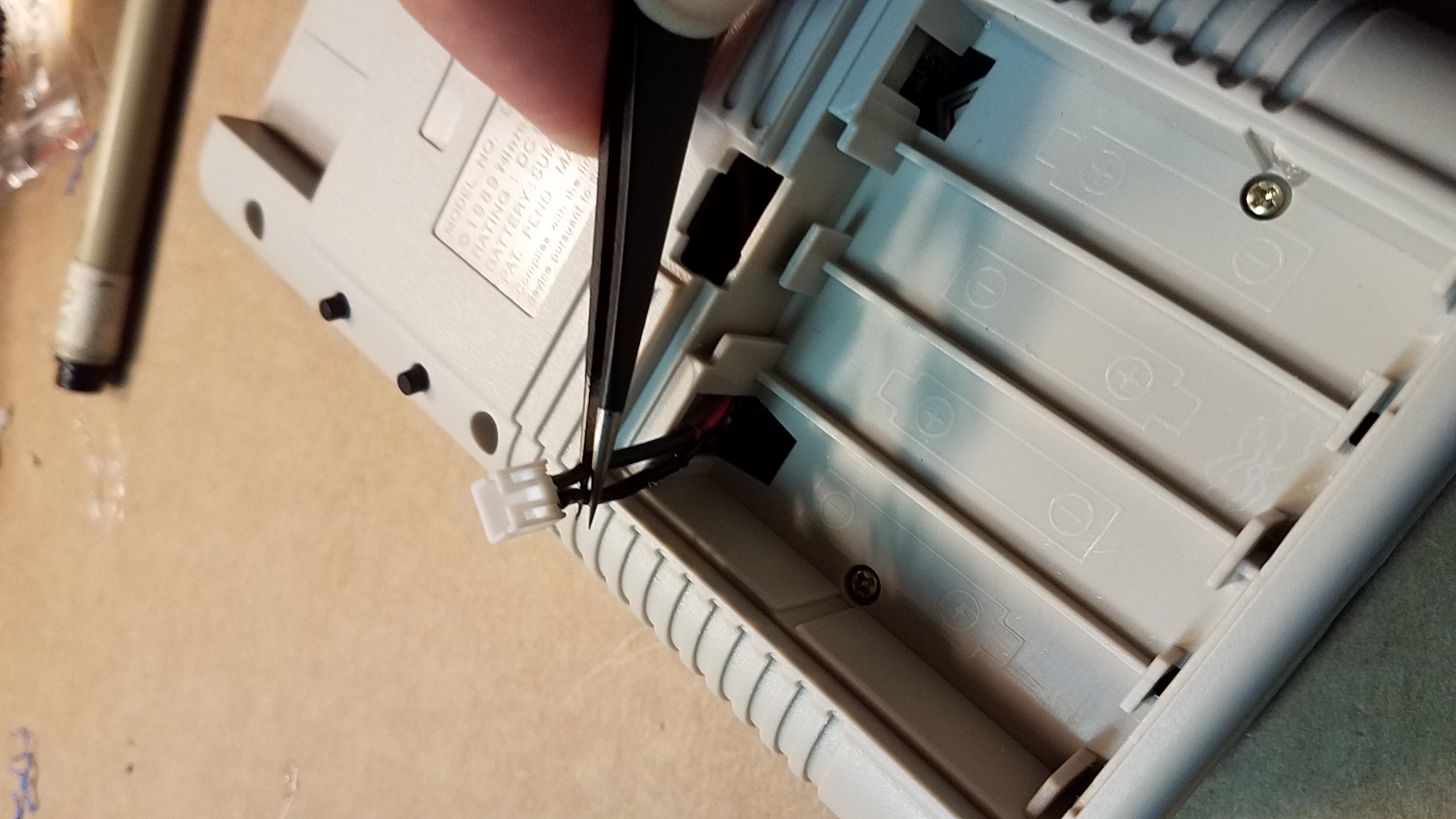

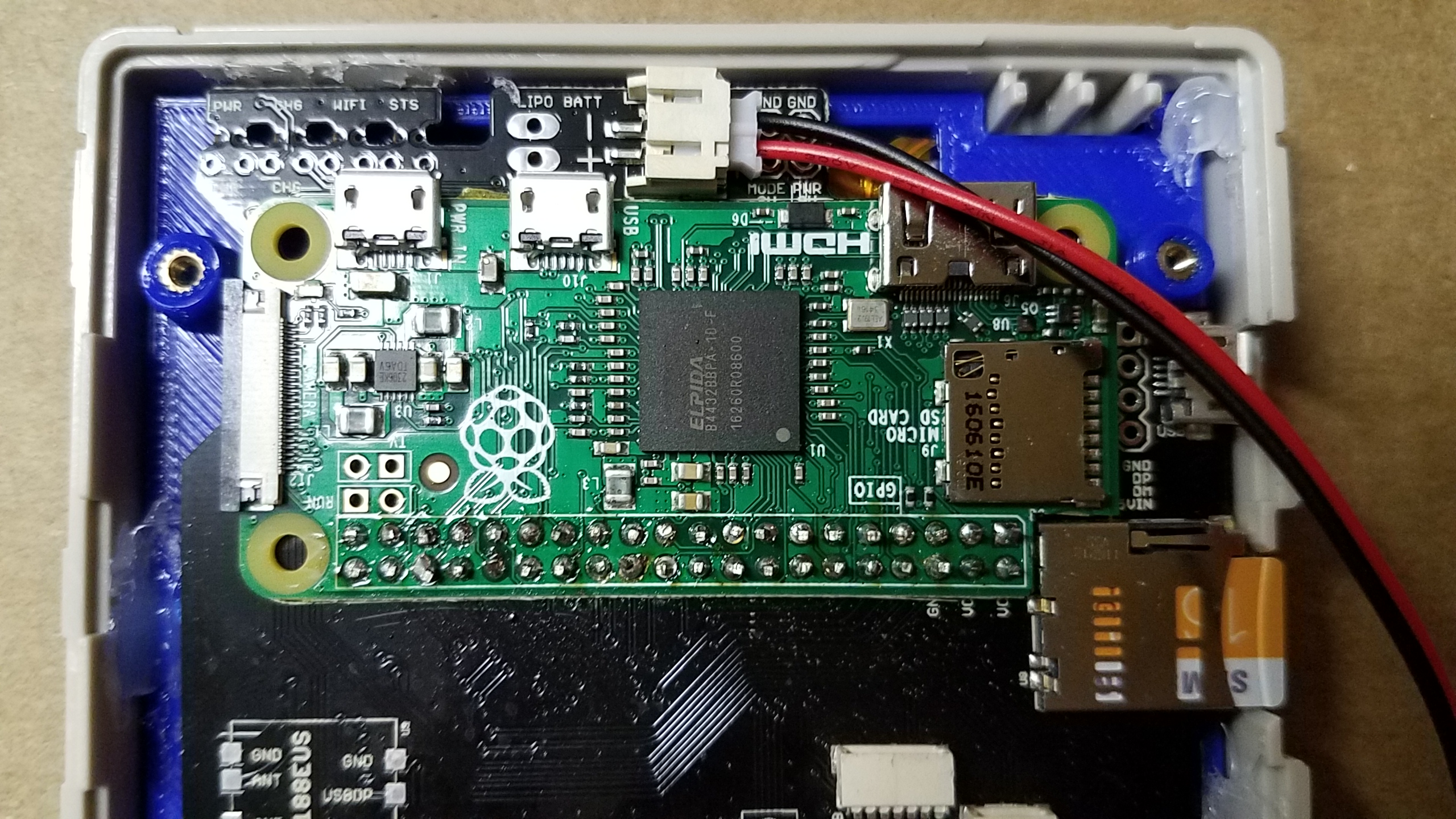

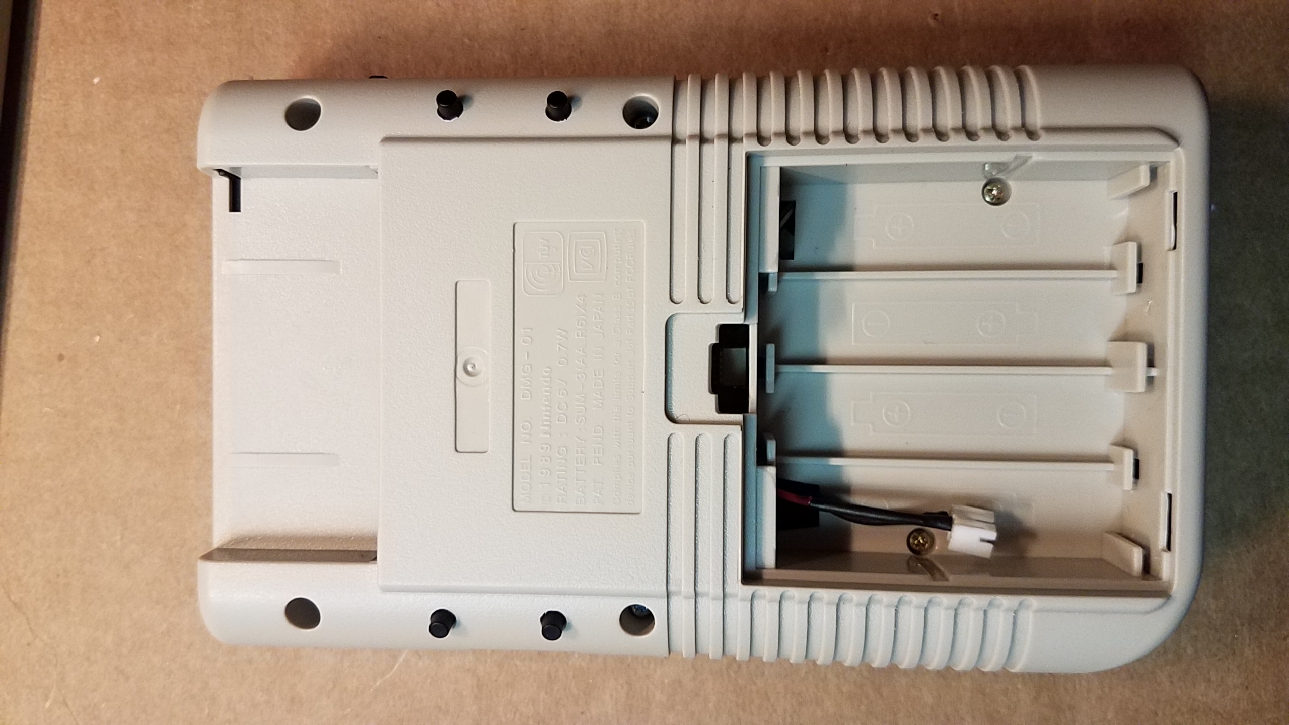

Going to get straight to the point.
Parts:
Aftermarket DMG case
Extra set of Game Boy buttons
Raspberry Pi Zero

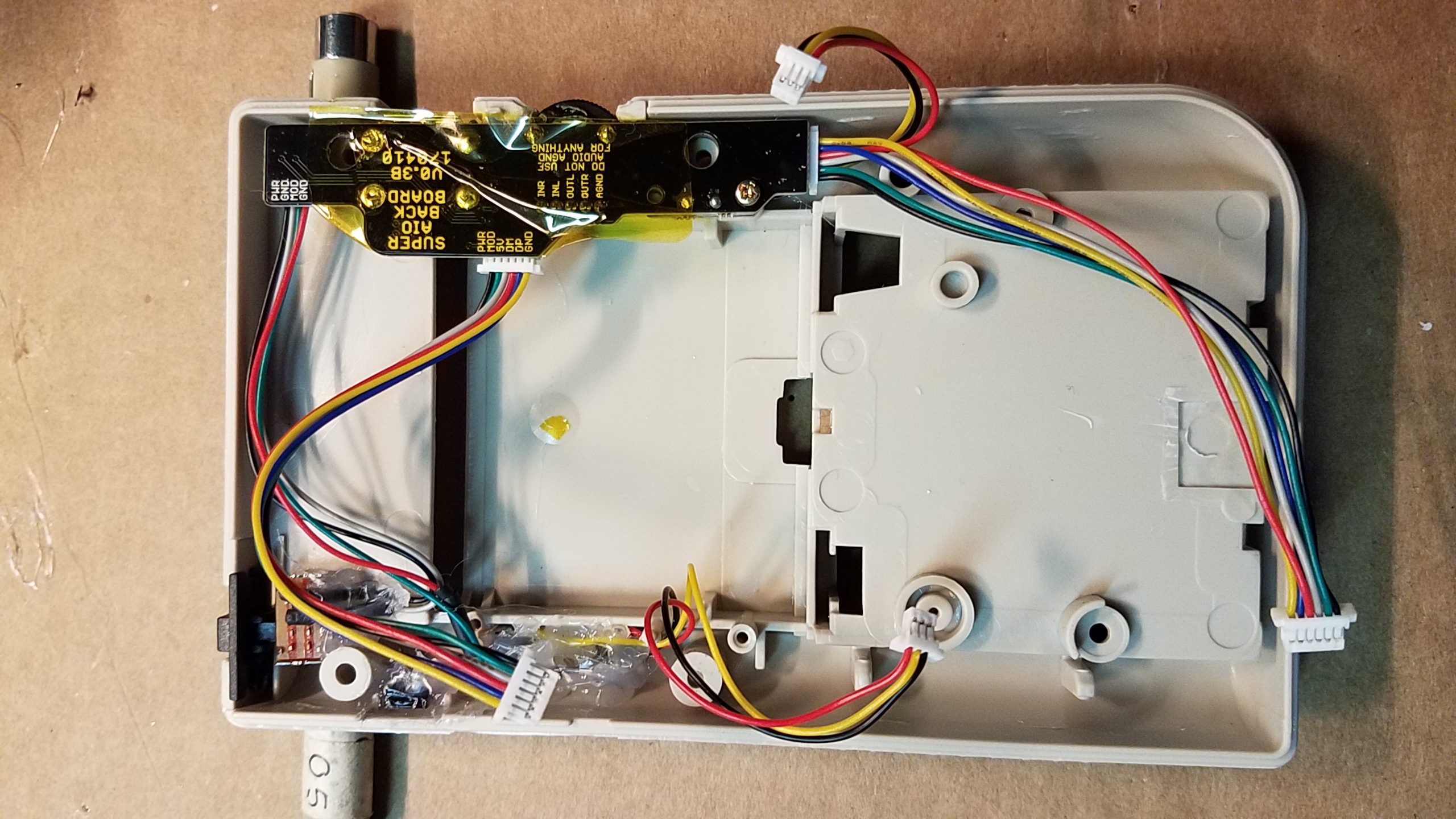

Tactile switches for rear buttons
A set of JST PH cables so I can have a disconnect I can reach without having to open the case.
Also I got a 4,000maH battery from eBay to serve until I get my batteries from Dextech. It fit in the battery case without a need to butcher it too badly. In fact a little less cutting than is required for the Dextech battery.
And of course parts from the users here Long story short, everything is working wonderfully. A very few minor issues occurred during the build, notably the guides built into Kites board for where to drill holes is slightly different from where HoolyHoo's screen wants it. Other issues that came up during the build were basically on me. I didn't double check wiring so I used the wrong line for ground when doing the rear buttons, swapped out and everything worked fine. Lastly, I should have test fit a few items before doing too much soldering, I might have found better ways to run items.

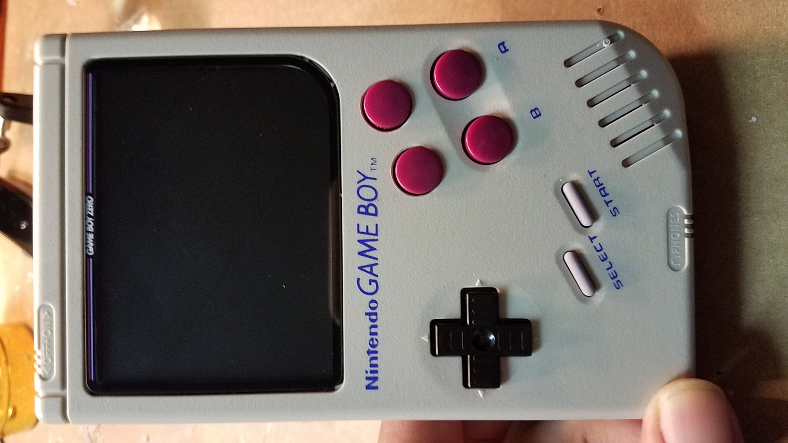

I spent a total of maybe 14 hours hours building this across multiple days. I am pretty happy with the results, but I'm sure others can judge the work for themselves.
So far it runs great and looks great. I'm already planning another build, and am anxiously awaiting word on inches CeMu partner board to do a Raspberry Pi3 build.
So here are the pictures.
