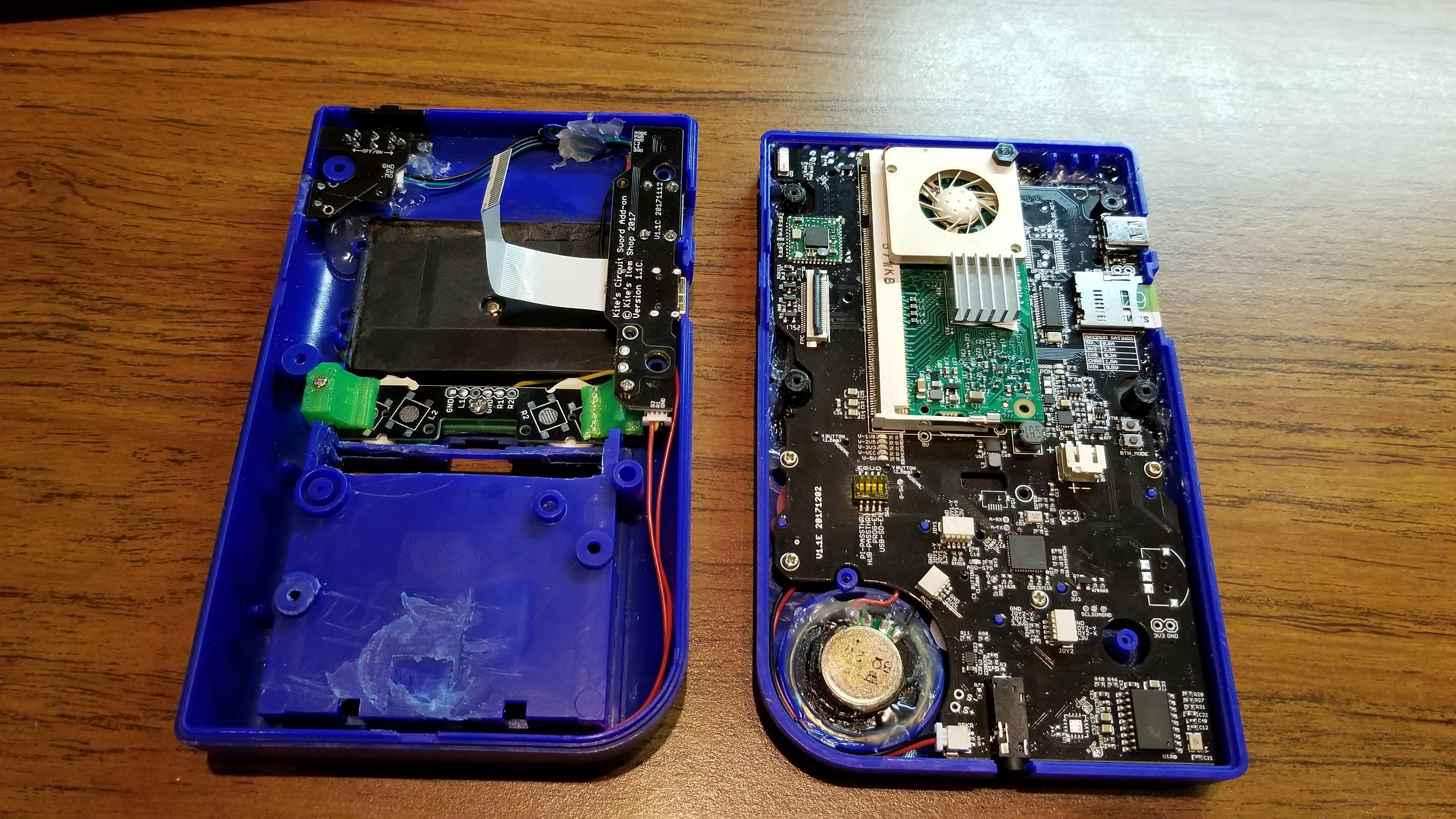

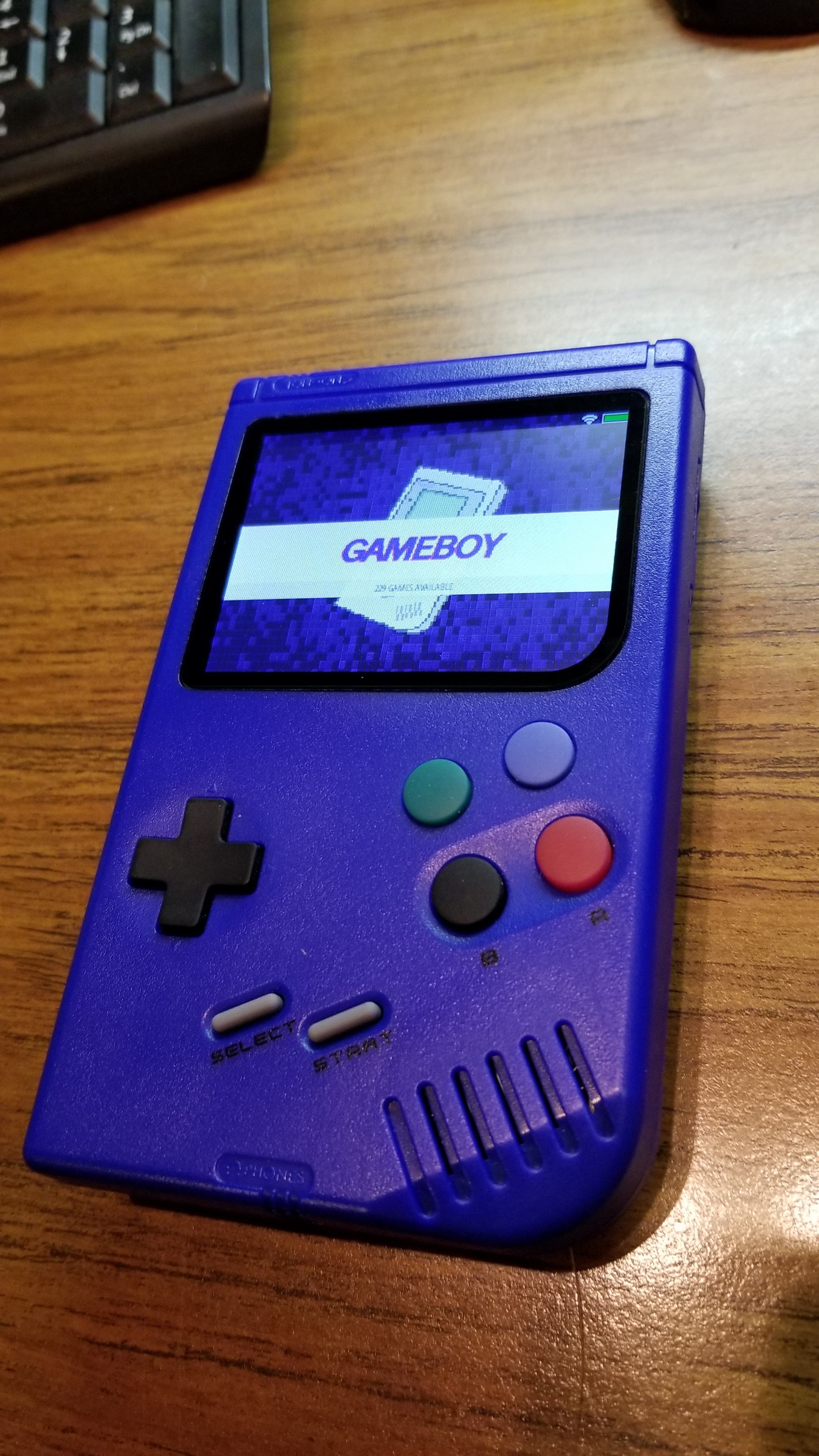

Here are my completed builds of two Gameboy projects both featuring a Raspberry Pi Compute Model 3:
Kite's Circuit Sword Gameboy Zero:
InternalsShow

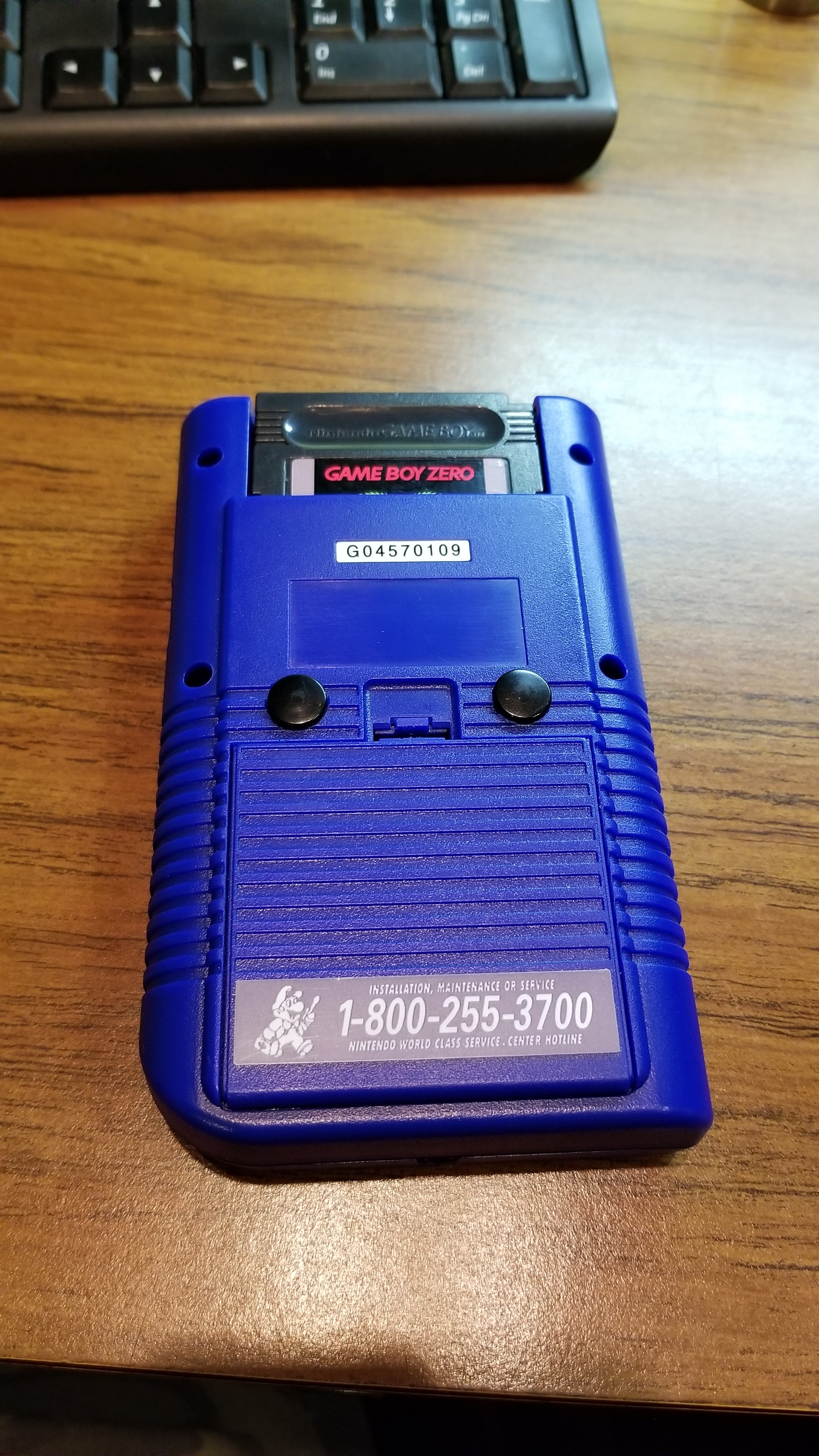

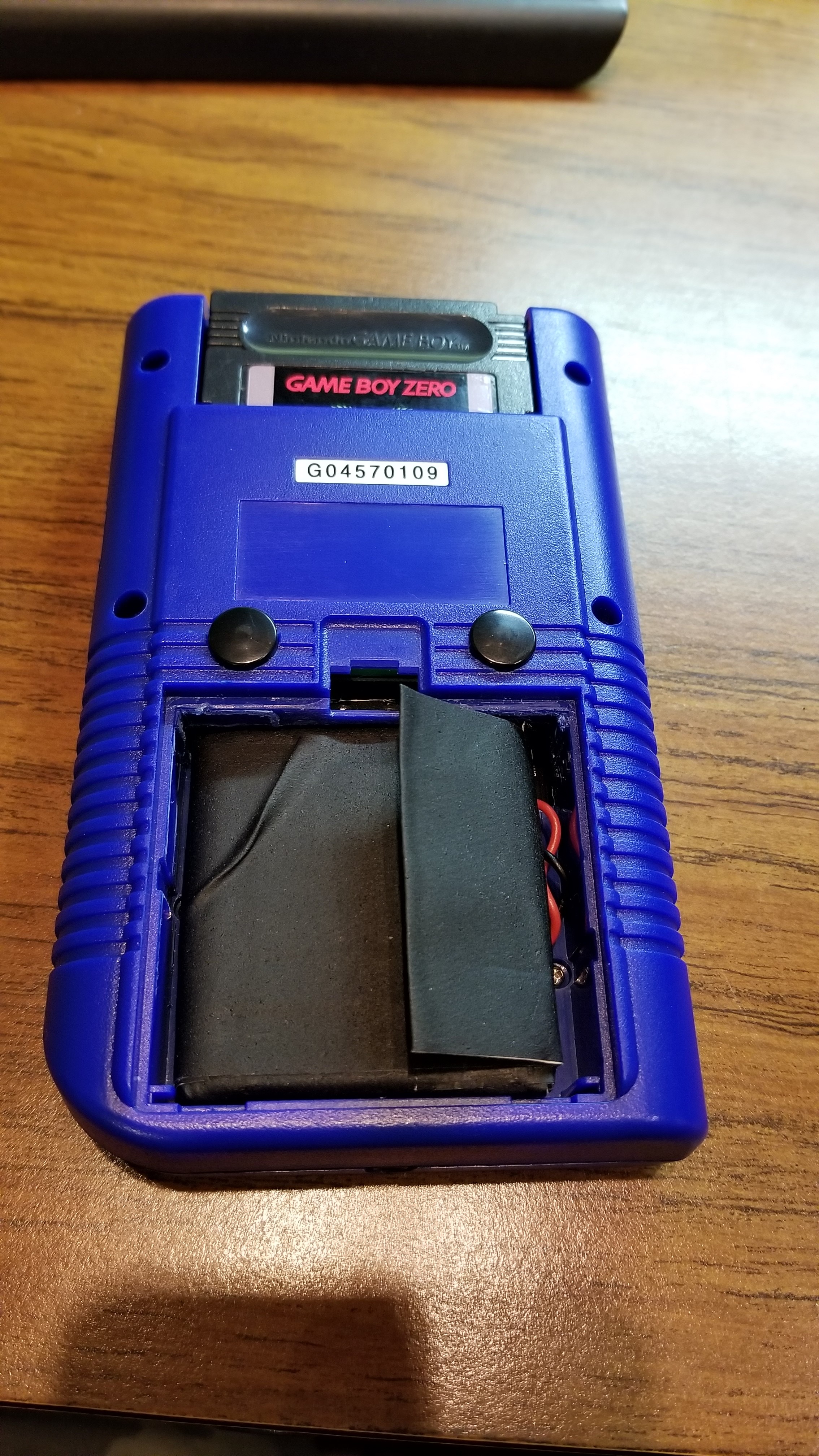

Battery bayShow
2018-02-26 10.33.32.jpg (2.01 MiB) Viewed 13403 times

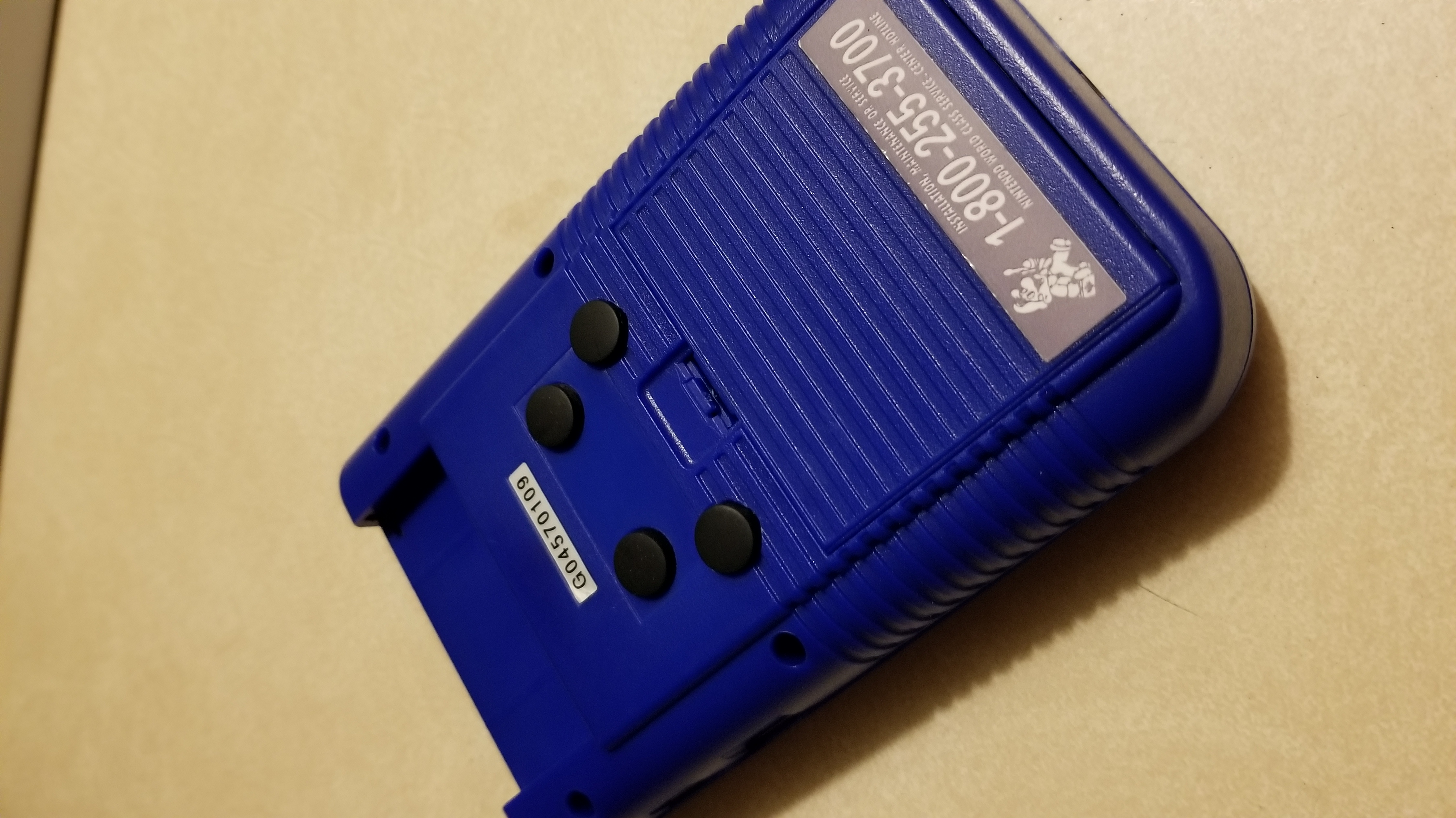

RearShow
2018-02-26 10.33.52.jpg (2.06 MiB) Viewed 13403 times

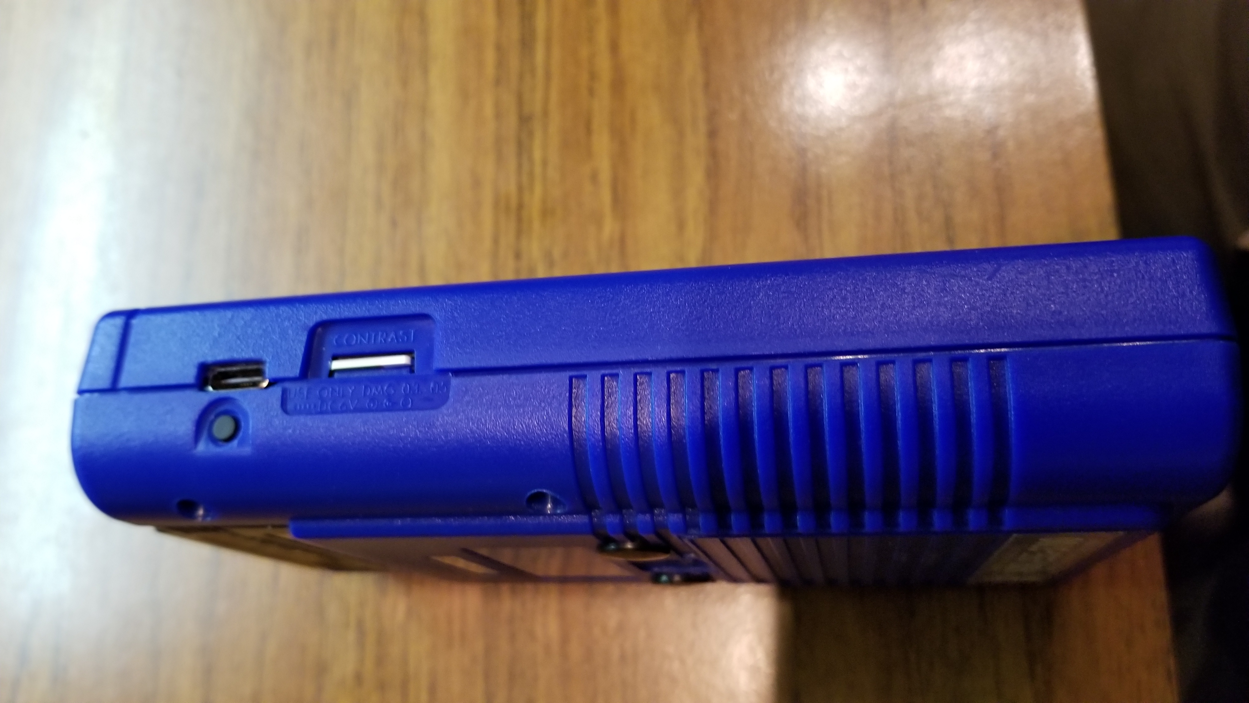

Right sideShow
2018-02-26 10.34.26.jpg (6.96 MiB) Viewed 13403 times

Splash screenShow
2018-02-26 10.34.49.jpg (1.5 MiB) Viewed 13403 times

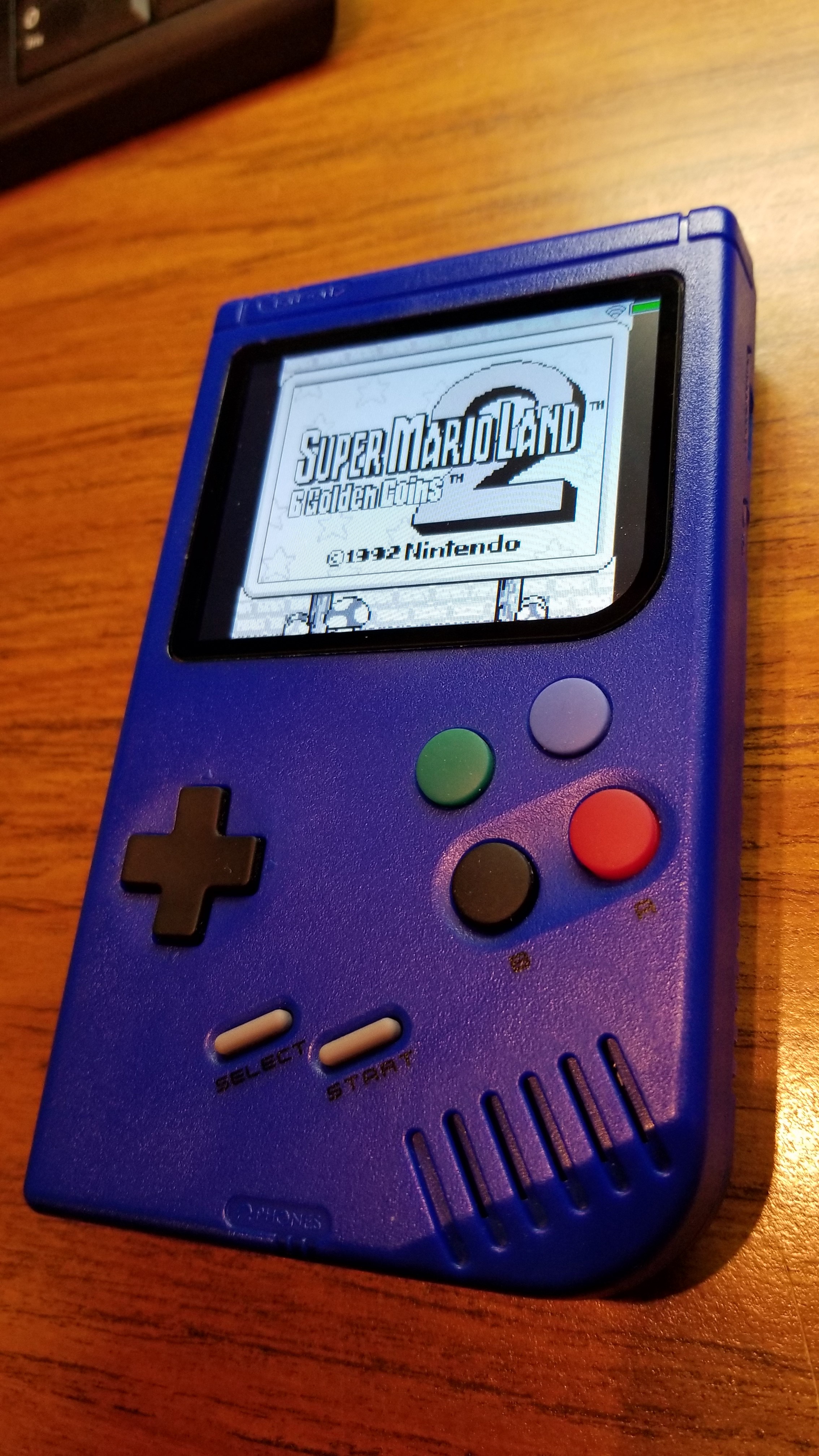

Super Mario Land 2Show
2018-02-26 10.35.56.jpg (1.73 MiB) Viewed 13403 times

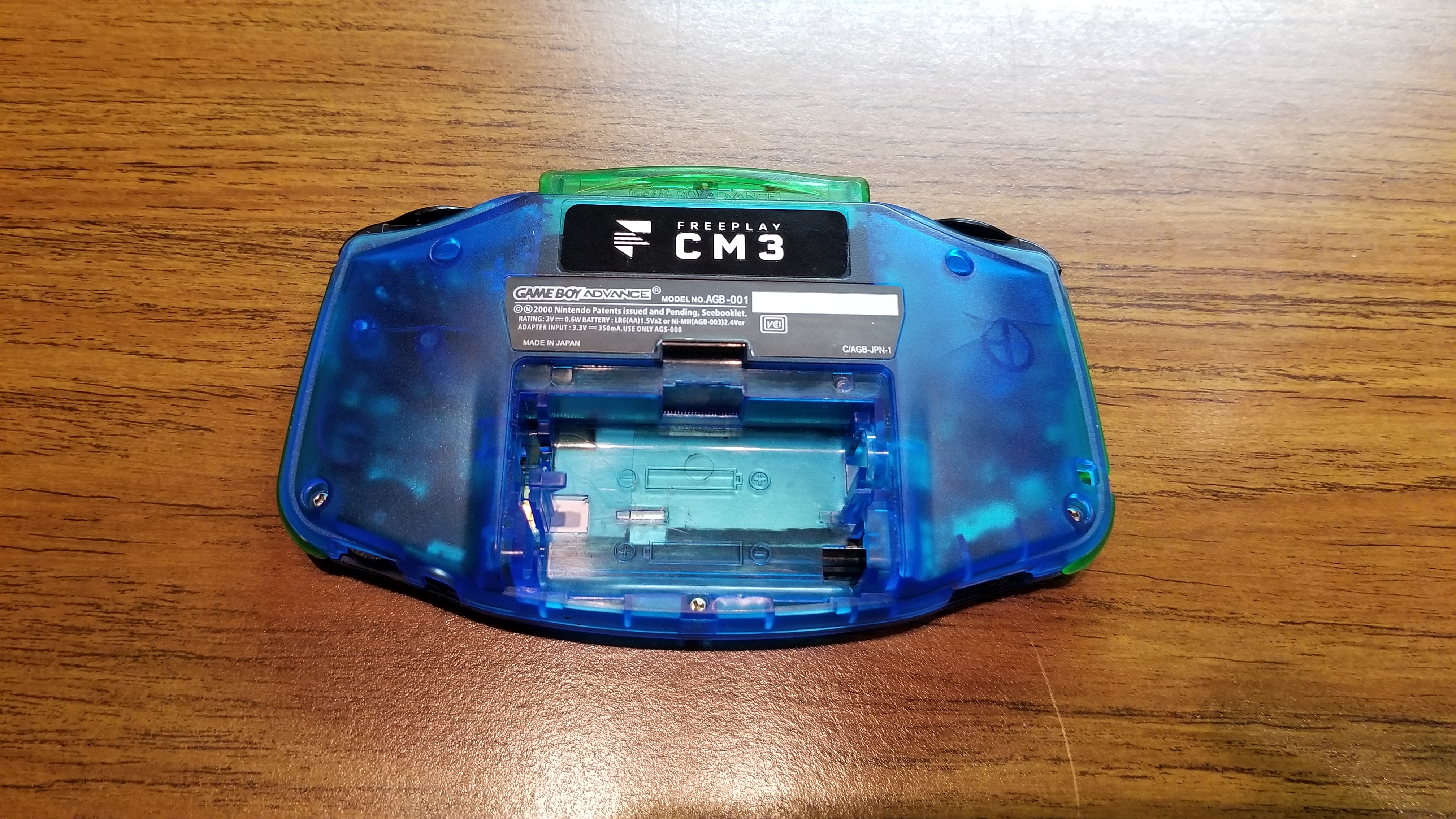

RearShow
2018-02-26 11.44.11.jpg (8.65 MiB) Viewed 13389 times

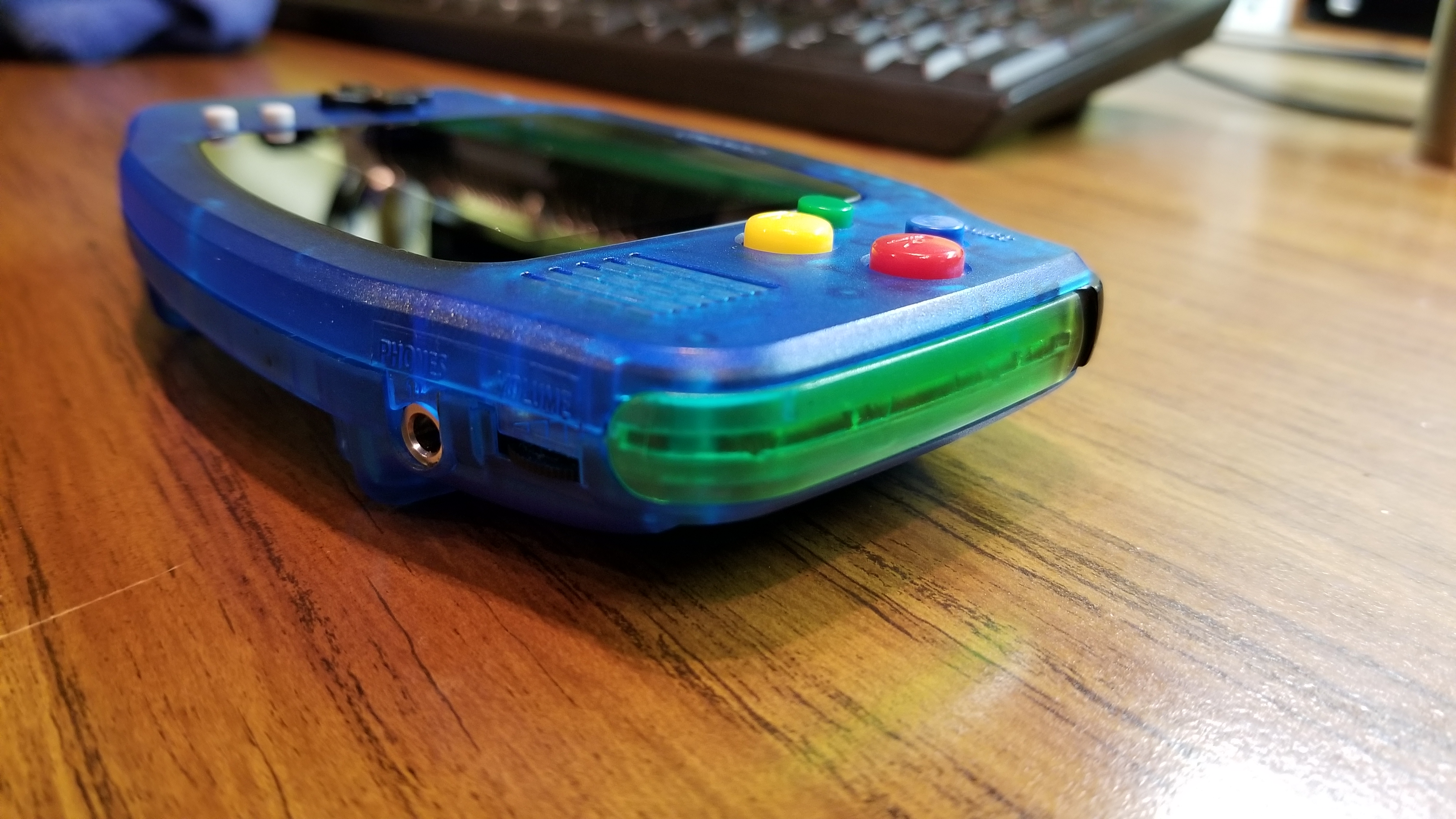

Left sideShow
2018-02-26 10.22.02.jpg (7.18 MiB) Viewed 13398 times
Right sideShow
2018-02-26 10.22.12.jpg (7.12 MiB) Viewed 13398 times

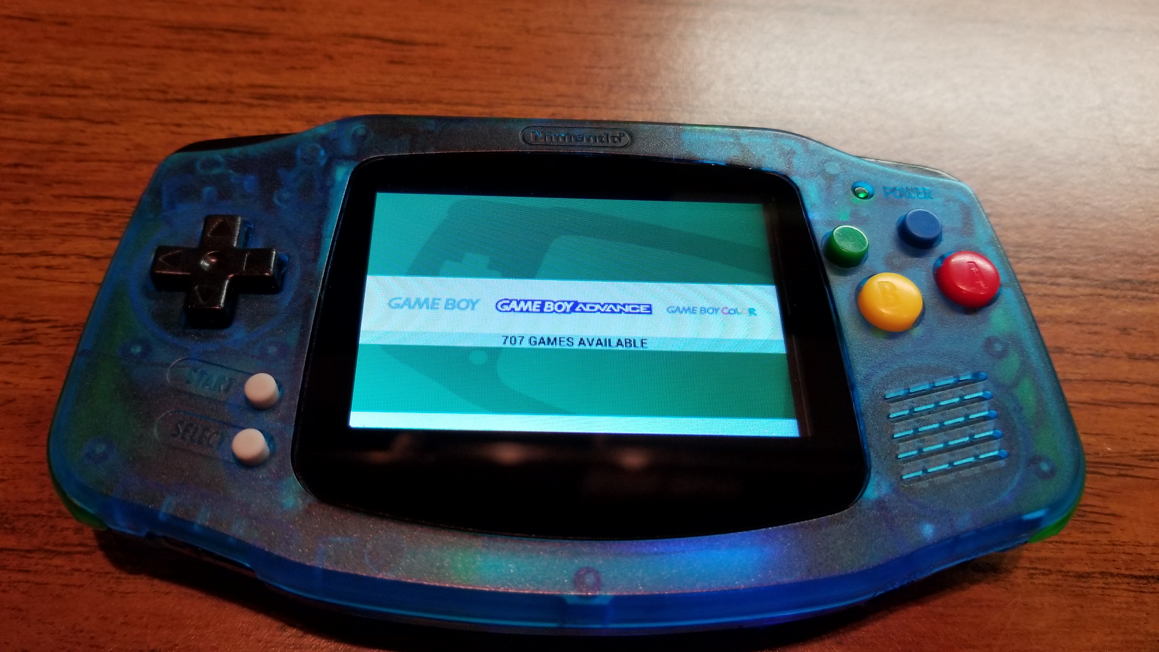

Splash screenShow
2018-02-26 11.46.40.jpg (7.24 MiB) Viewed 13387 times

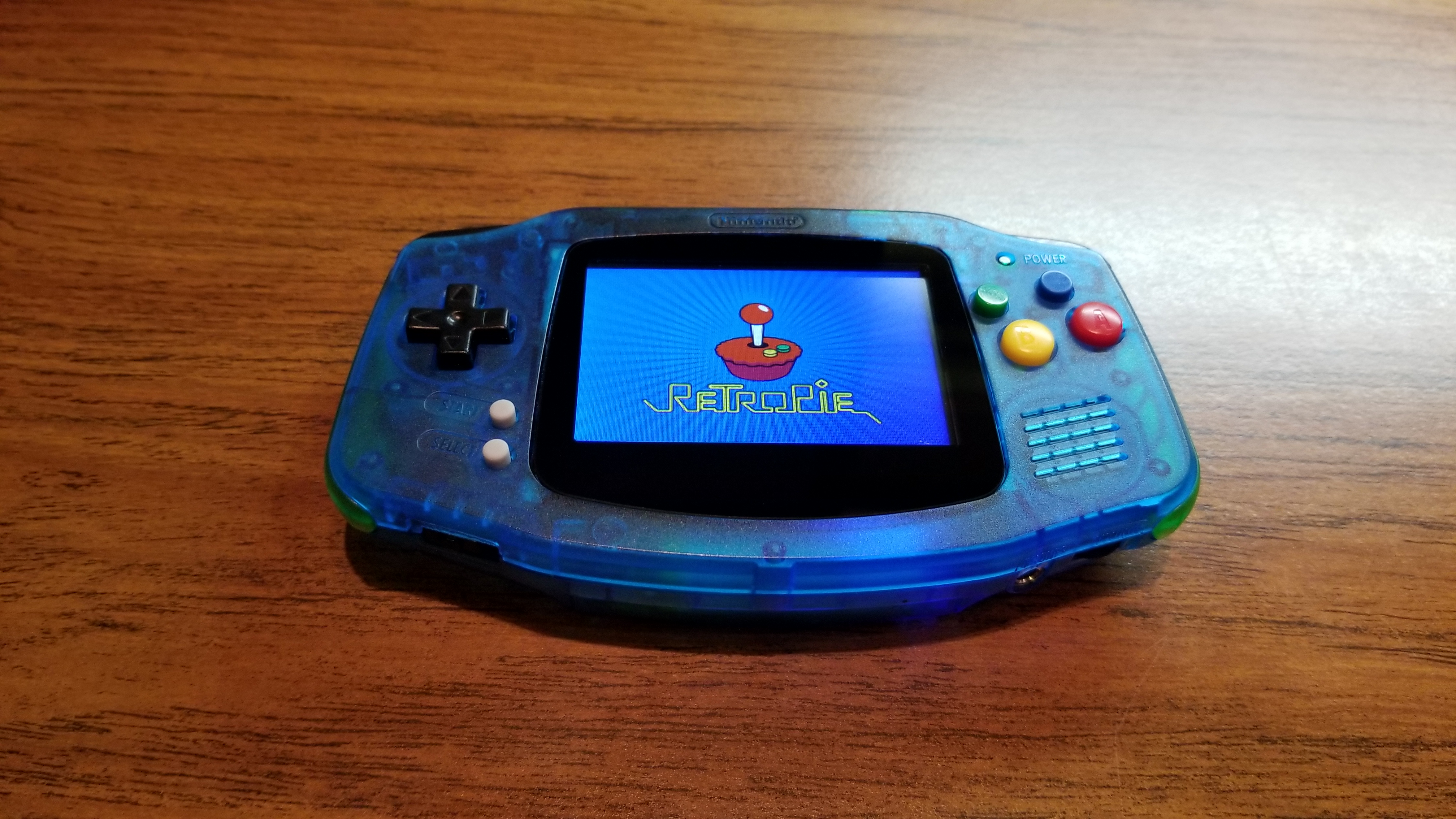

RetropieShow
2018-02-26 11.47.00.jpg (7.17 MiB) Viewed 13387 times

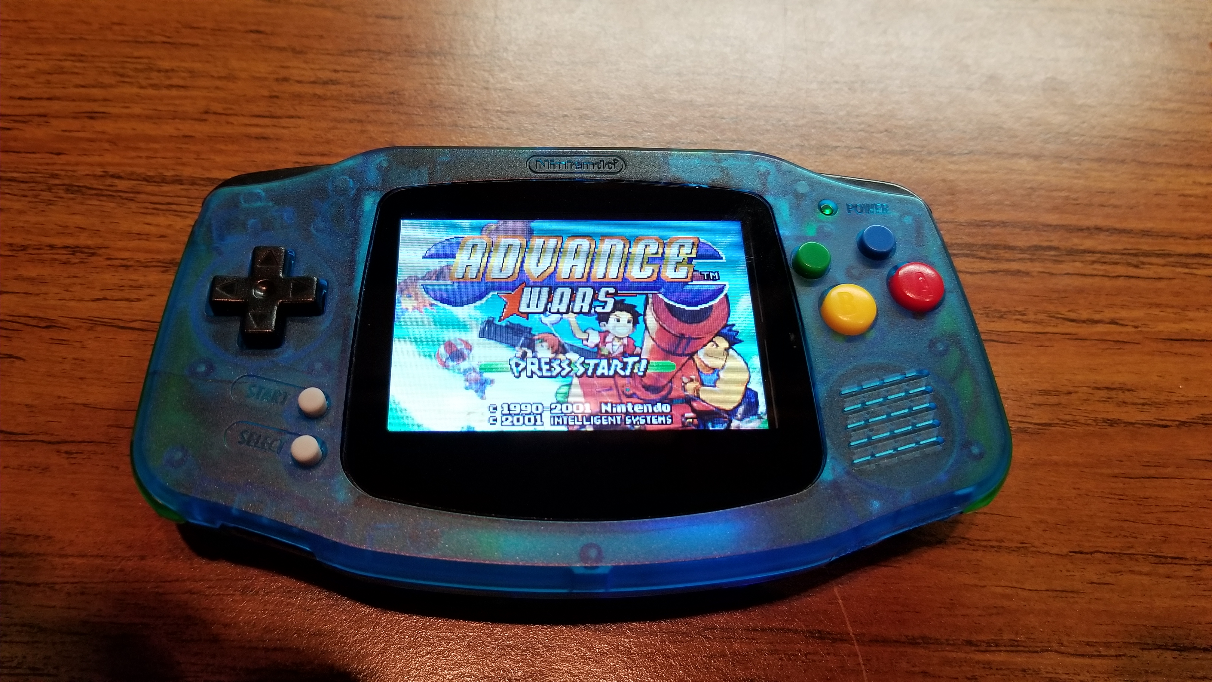

Advance WarsShow
2018-02-26 10.27.02.jpg (7.75 MiB) Viewed 13398 times

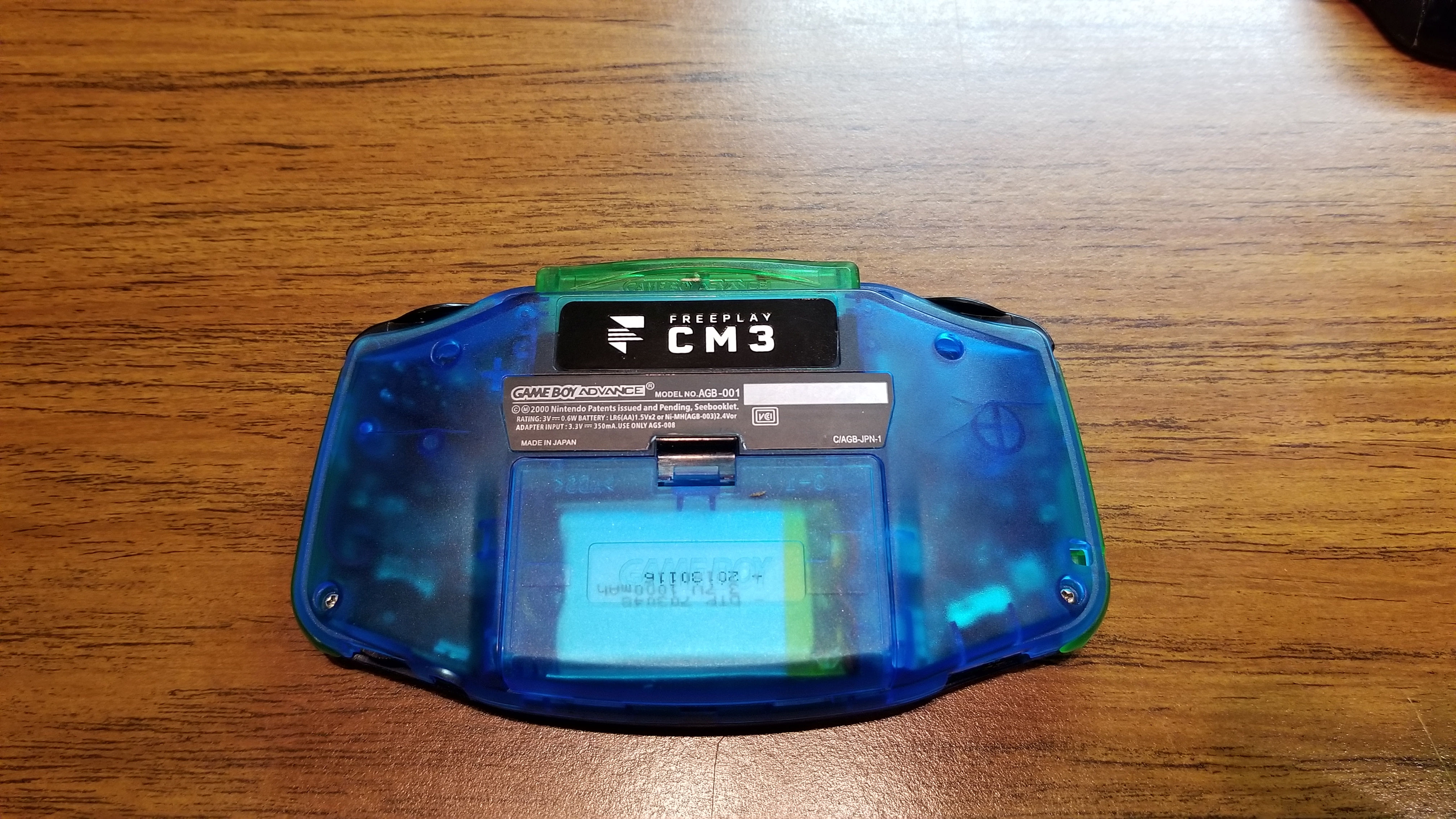

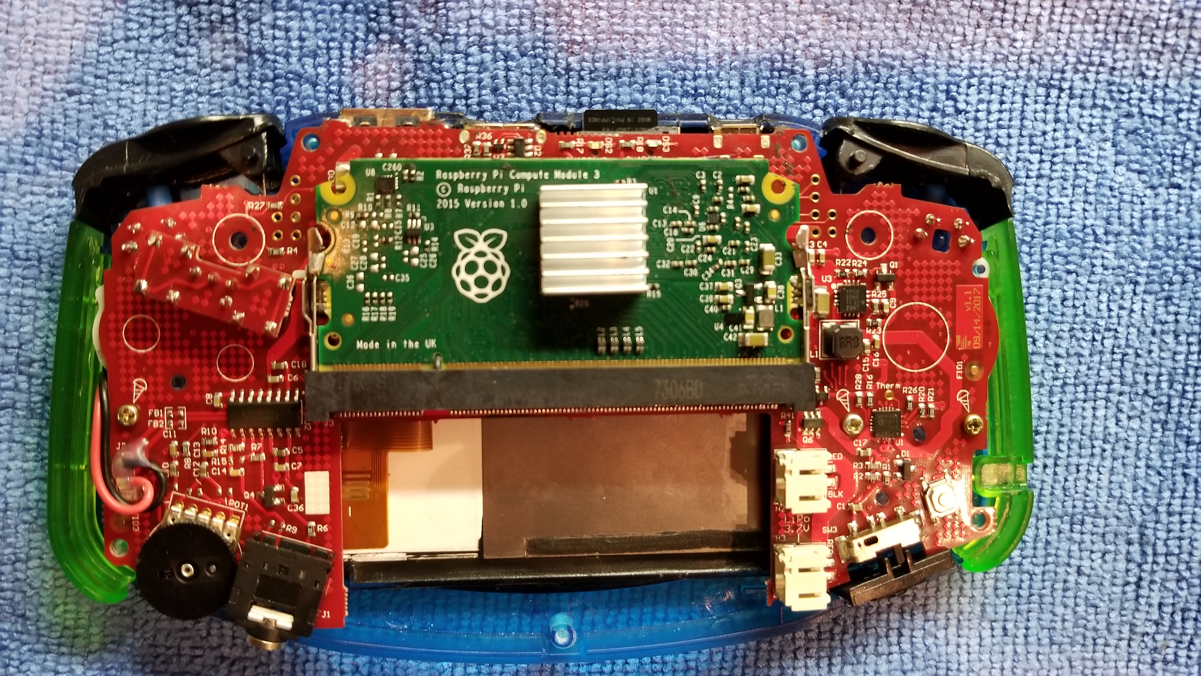

  • I got the sapphire Gameboy Advance shell, buttons, glass lense, 2 batteries, screen and board all from www.retromodding.com

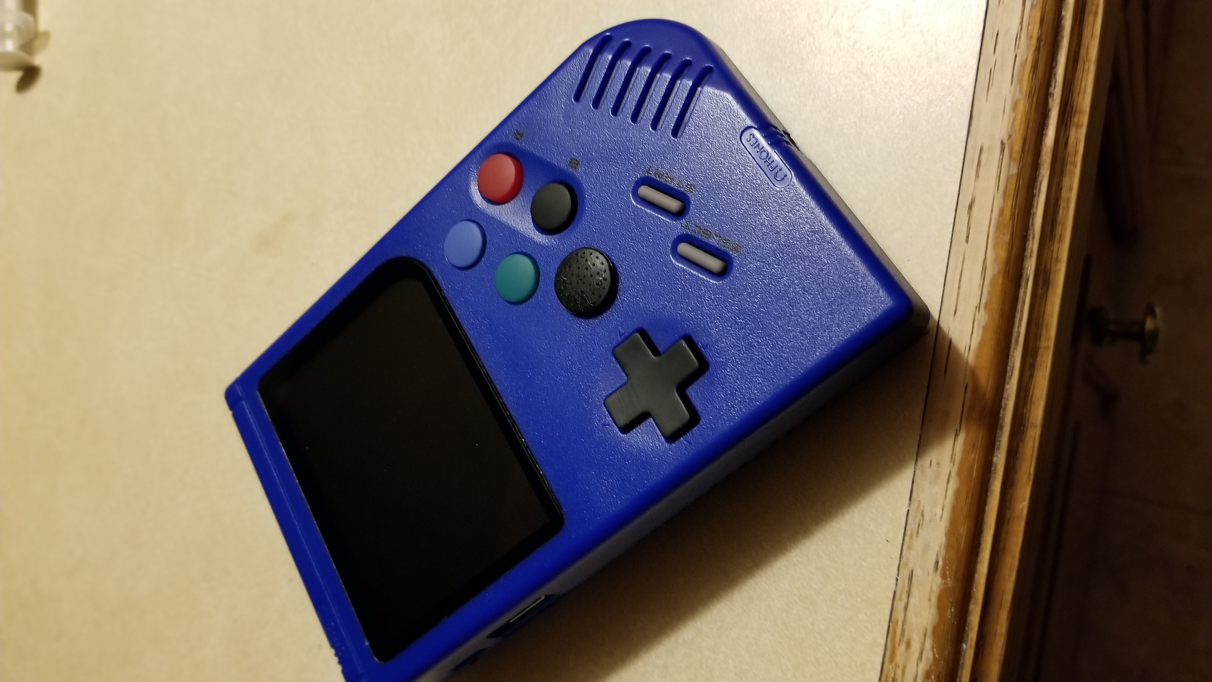

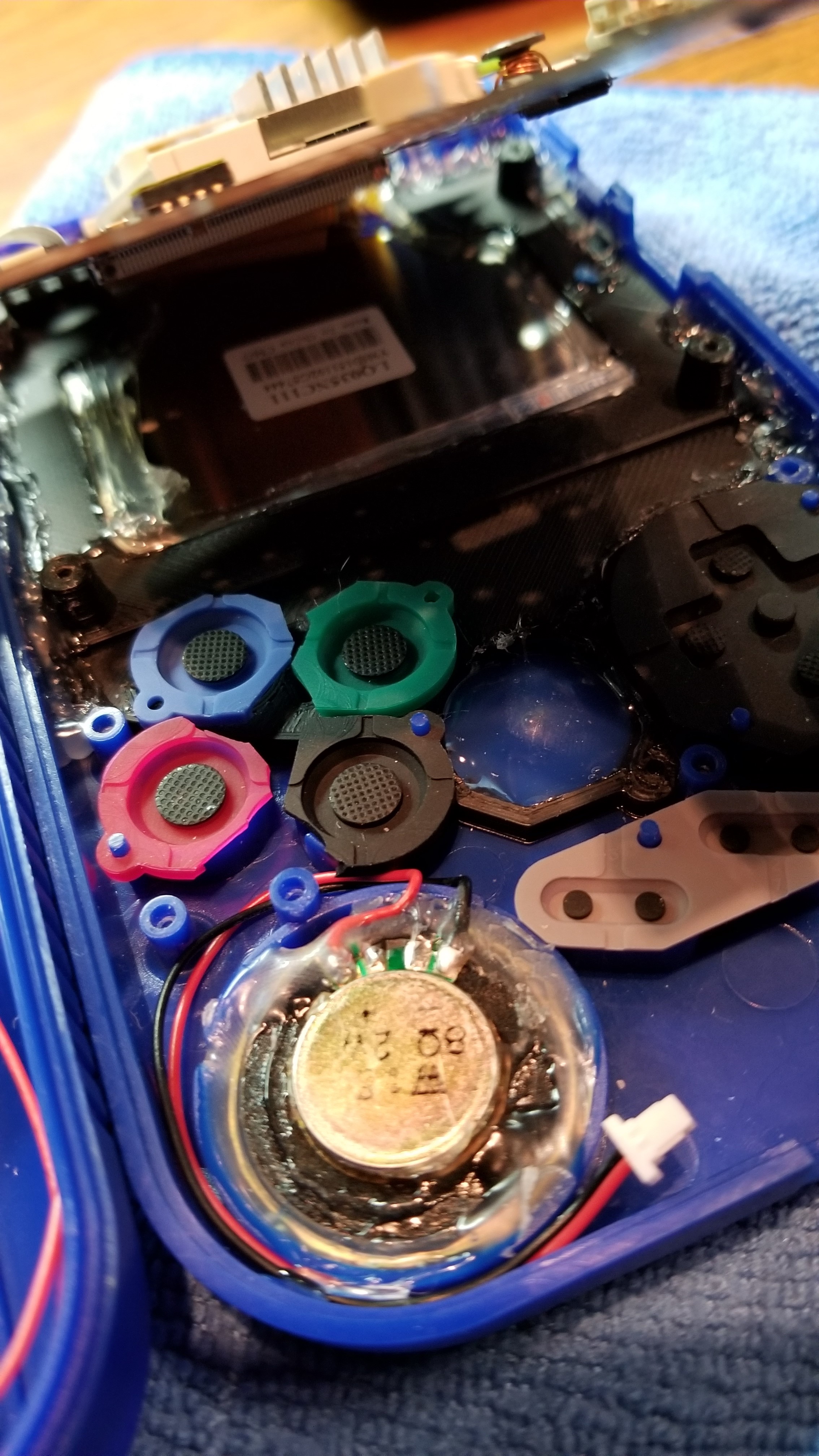

Could you please show how do silicone buttons look like? I've ordered a couple of them from kitsch-bend, but was sure they must have same color for A/B because they are connected to each other.

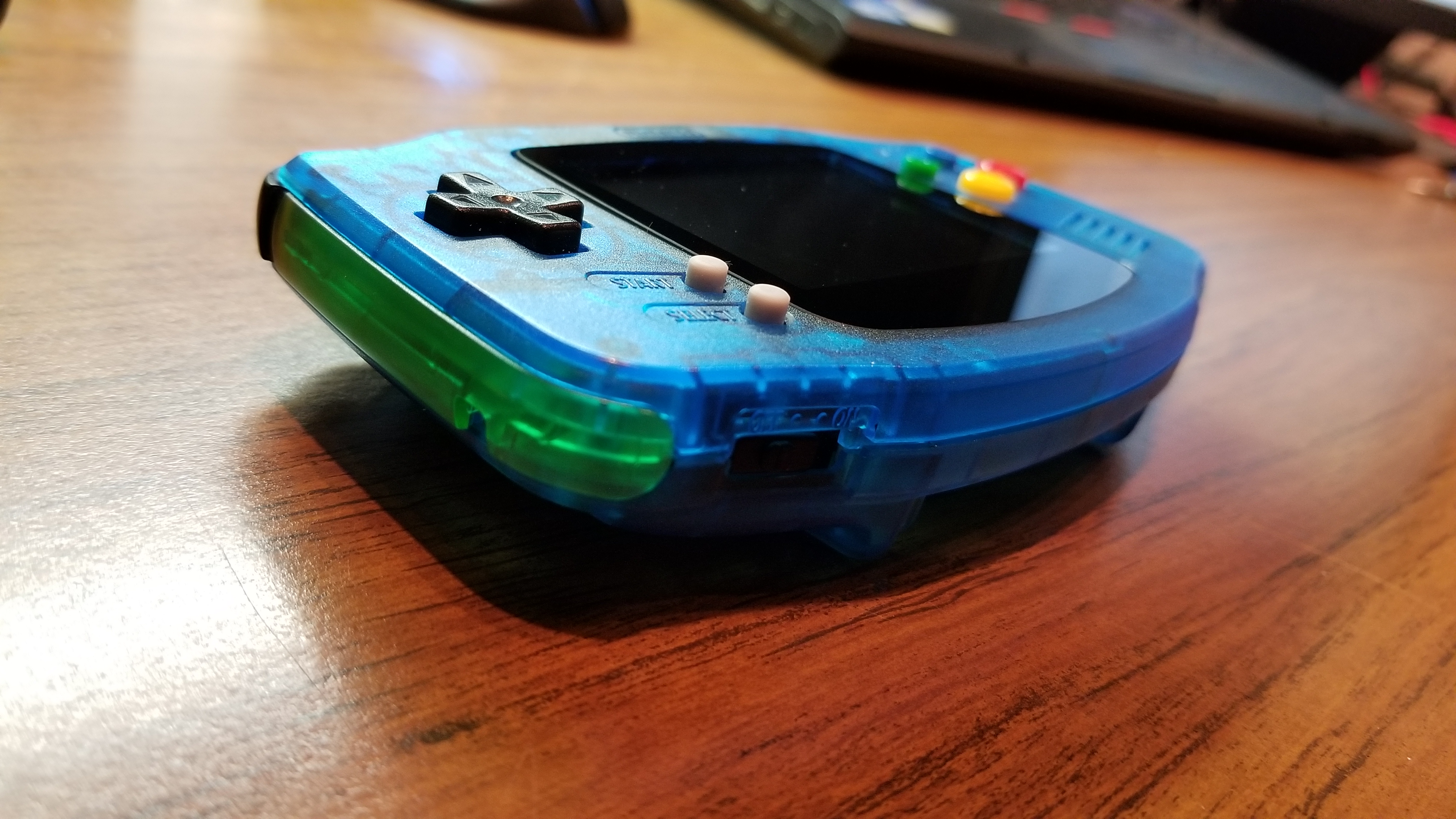

The A/B buttons from Kitsch-bent come connected in a pair. I ordered various colors and cut each of the buttons individually to get the multi-colored A/B/X/Y buttons on my build. I was trying to go for the Super Famicom color scheme but they do not have yellow silicone buttons, hence the one black button.
Button InternalShow

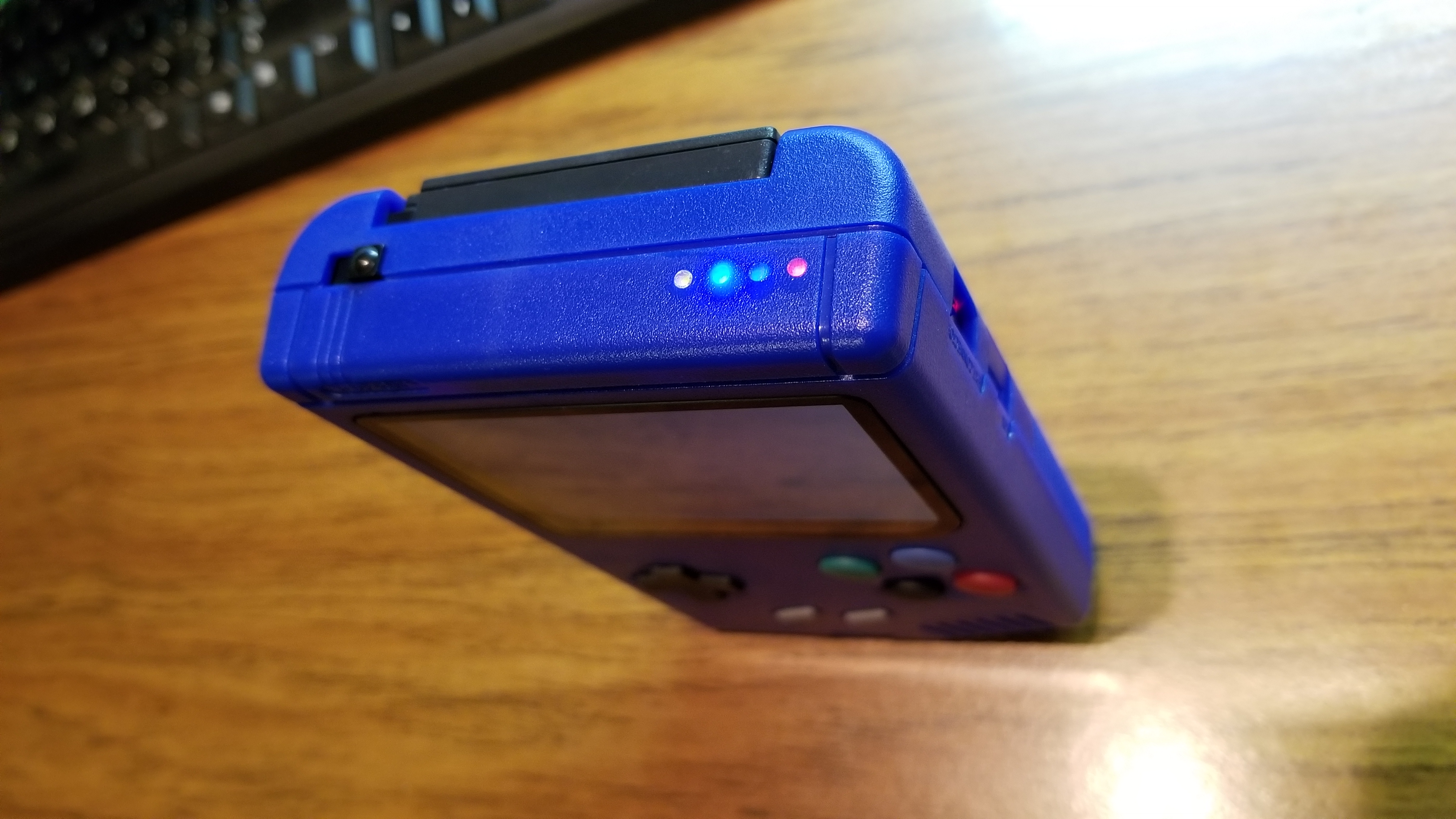

How did you do the status LEDs at the top of the gameboy? What size LEDs are they?

The LEDs are surface mounted onto the Circuit Sword AIO board. Per Kite's case mod instructions, those are 2mm holes backfilled with hot glue to serve as light pipes for the LEDs on the board. The Circuit Sword board comes with a template to drill the holes so that they are straight. I can't really take much credit here.
The instructions can be found in Kite's Wiki, this specific part is under the "(Optional) LED status holes" section.
There is also an in-depth overview of the board and the components which come populated onto it, also in the Wiki towards the bottom of the page.
Hope this helps!

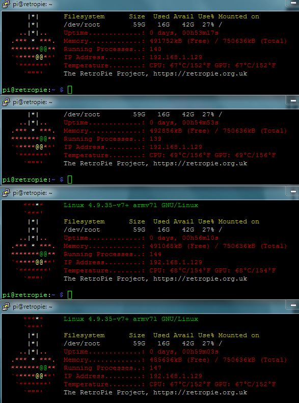

You are correct with each point. Also, the Freeplay does not have any way to currently adjust screen brightness so it is always at its brightest setting. The only advantage I see that it has is the GBA form factor, which I prefer over the DMG both for portability and nostalgia; I never had a DMG (I had a Gameboy Pocket) but I remember in my early teenage years saving up enough money for a GBA and really enjoying it. I am 1 of 6 kids so having a game system all to myself was a rarity which is why I was always found mobile platforms more compelling.

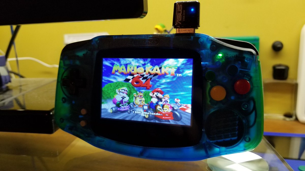

Regarding heat, I have not had an overheat with either CM3 system (so far). A few weeks ago, I got curious about the system in regards to overheating and loaded Mario Kart 64 onto the system and let it loop the start screen demo for an hour. I loaded a terminal every so often and remotely accessed the CM3 to check the temperature. The hottest it got was 152-156 degrees F. The back shell was somewhat warm but never hot and the video/audio never stuttered and the system never powered off.
Heat TestShow
That said, I have been regularly playing numerous titles from GBA, SNES, Turbo Grafx 16 and PSX on the Freeplay CM3 and have experienced no issues regarding heat. It appears the heatsink is quite sufficient without an active cooling addition.
