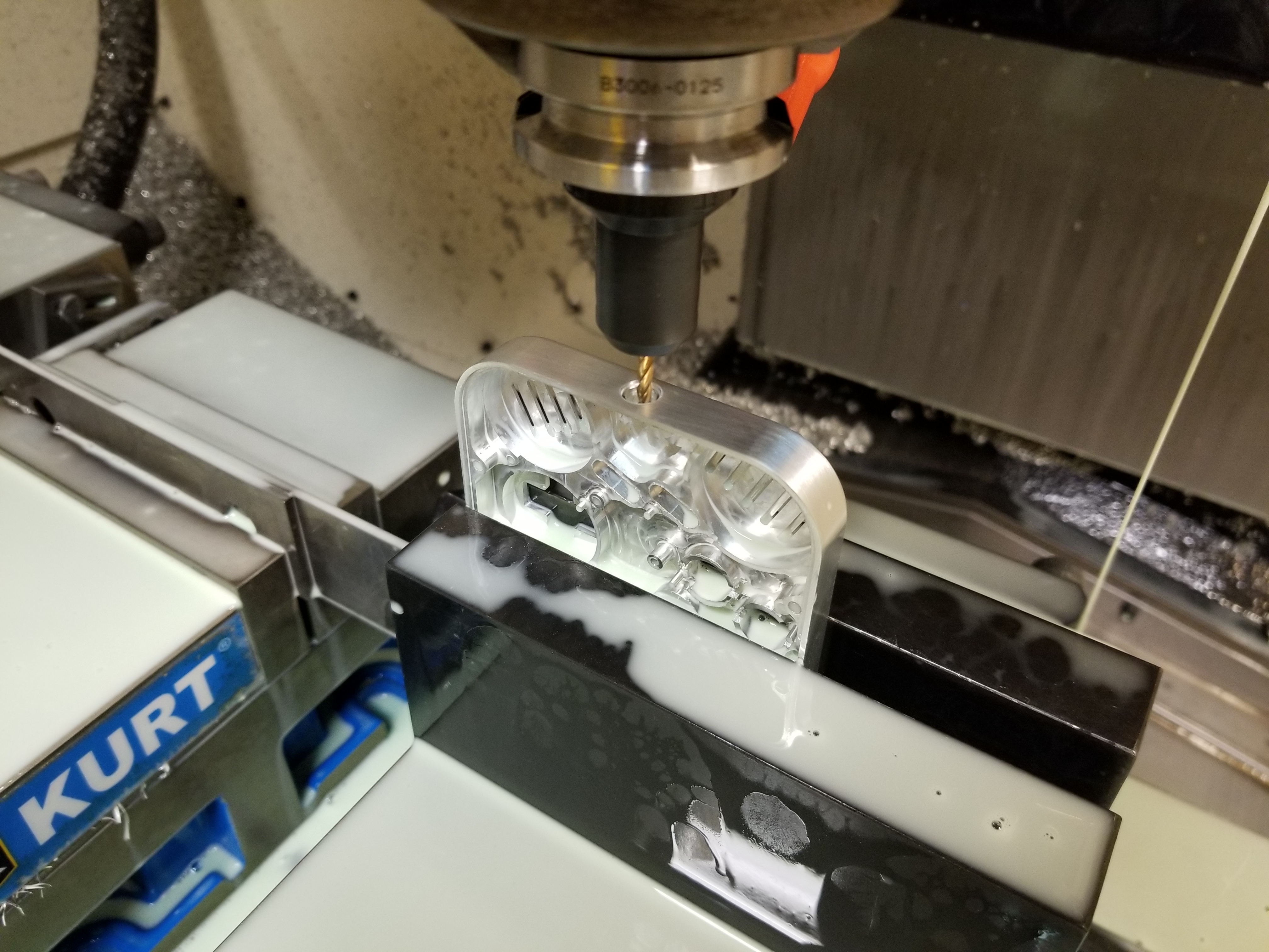

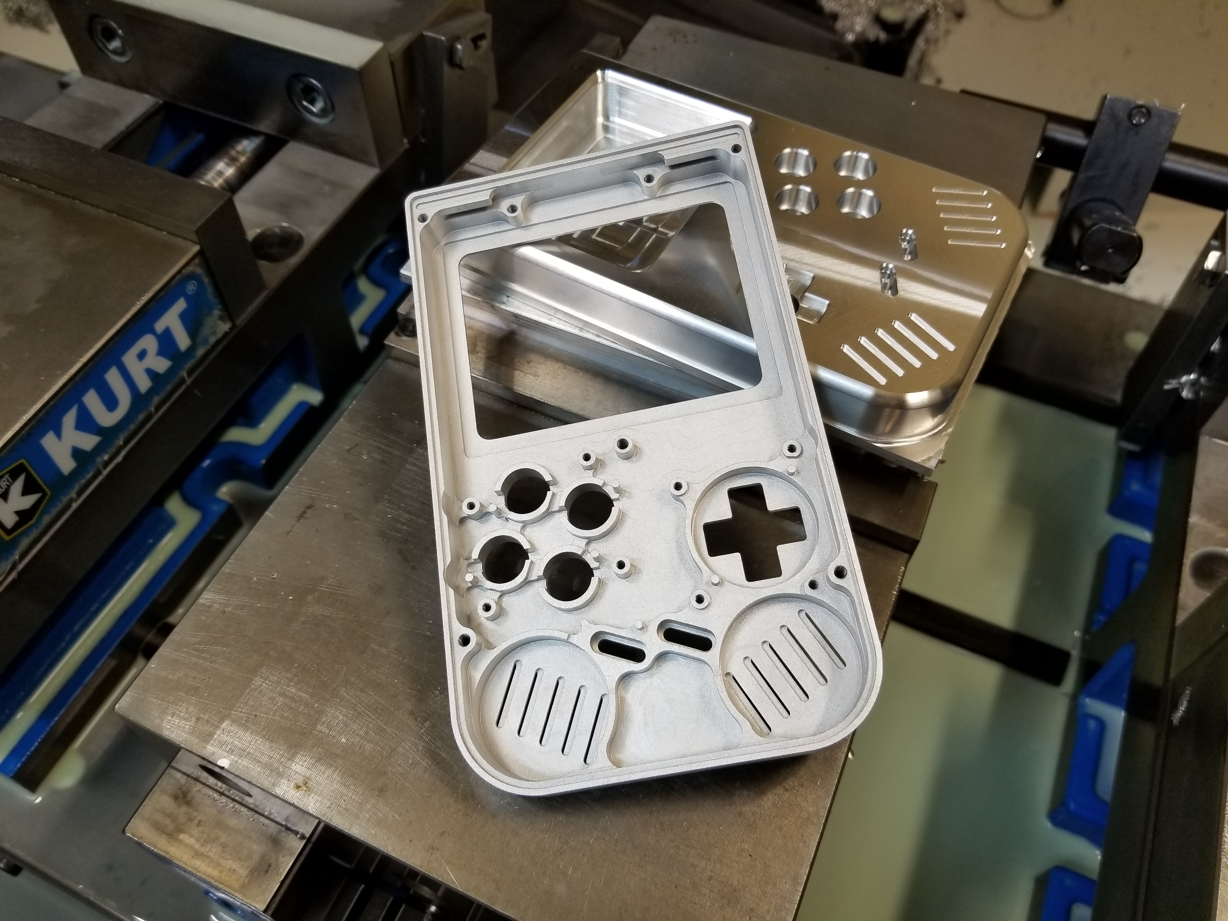

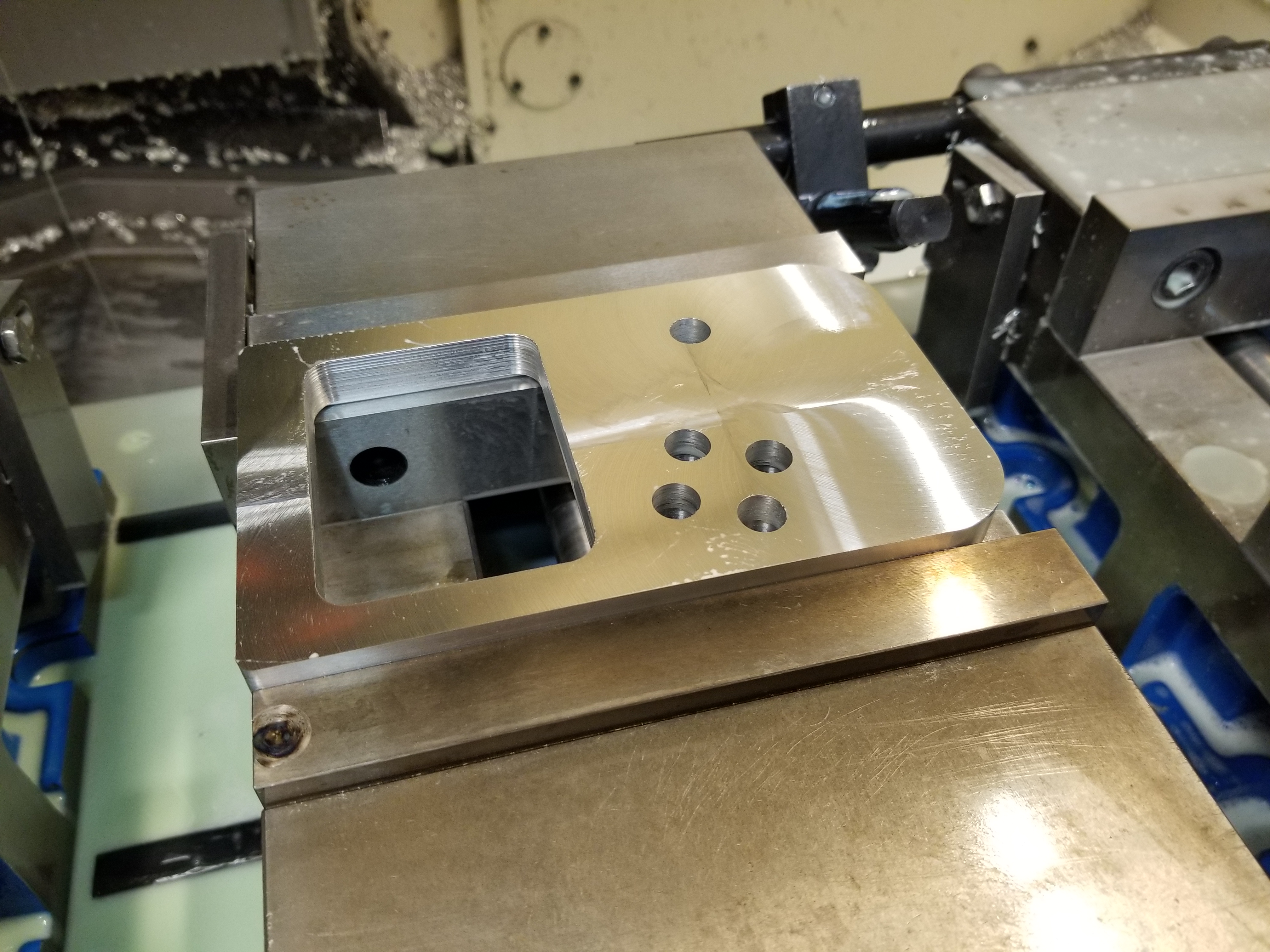

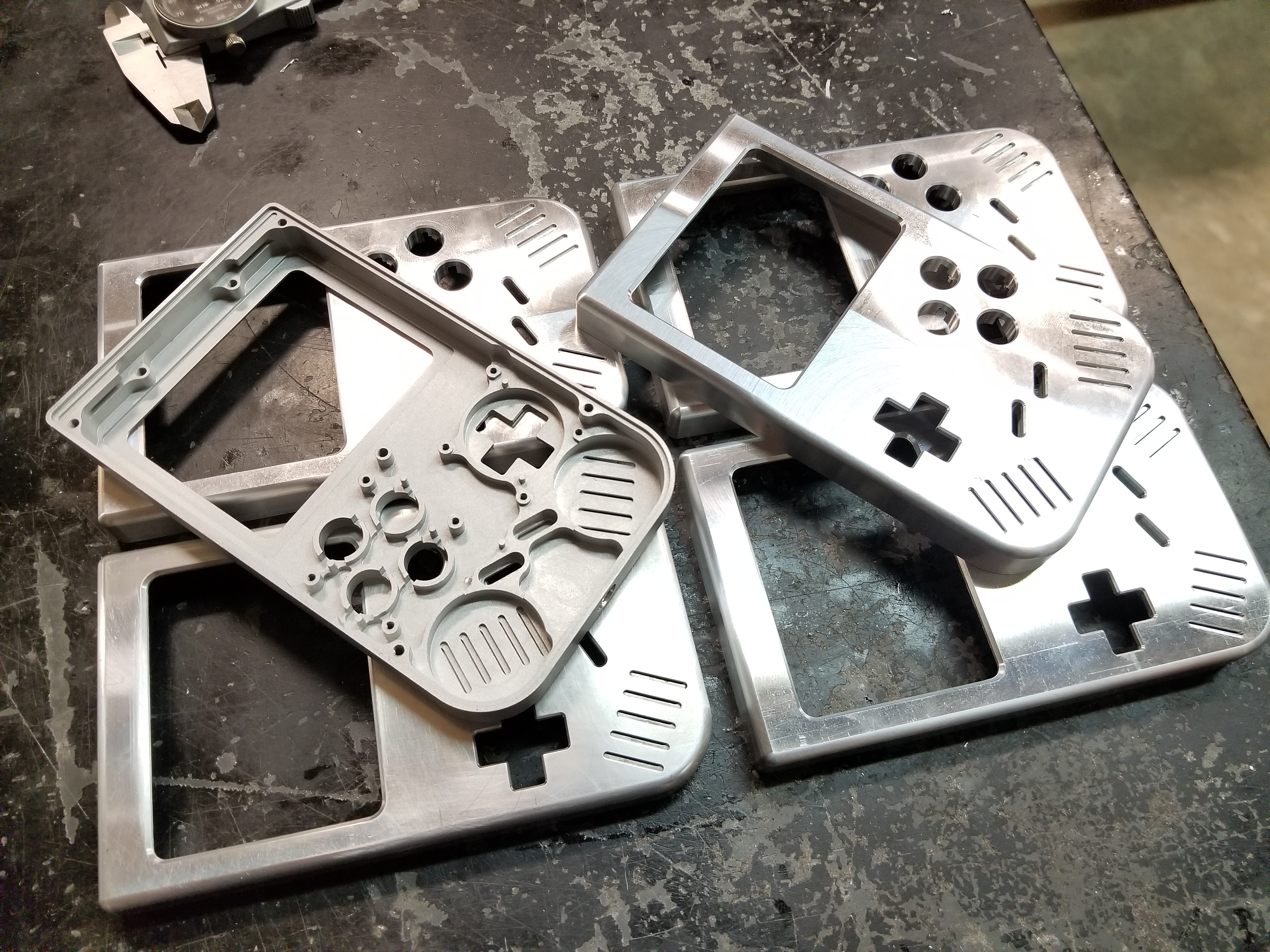

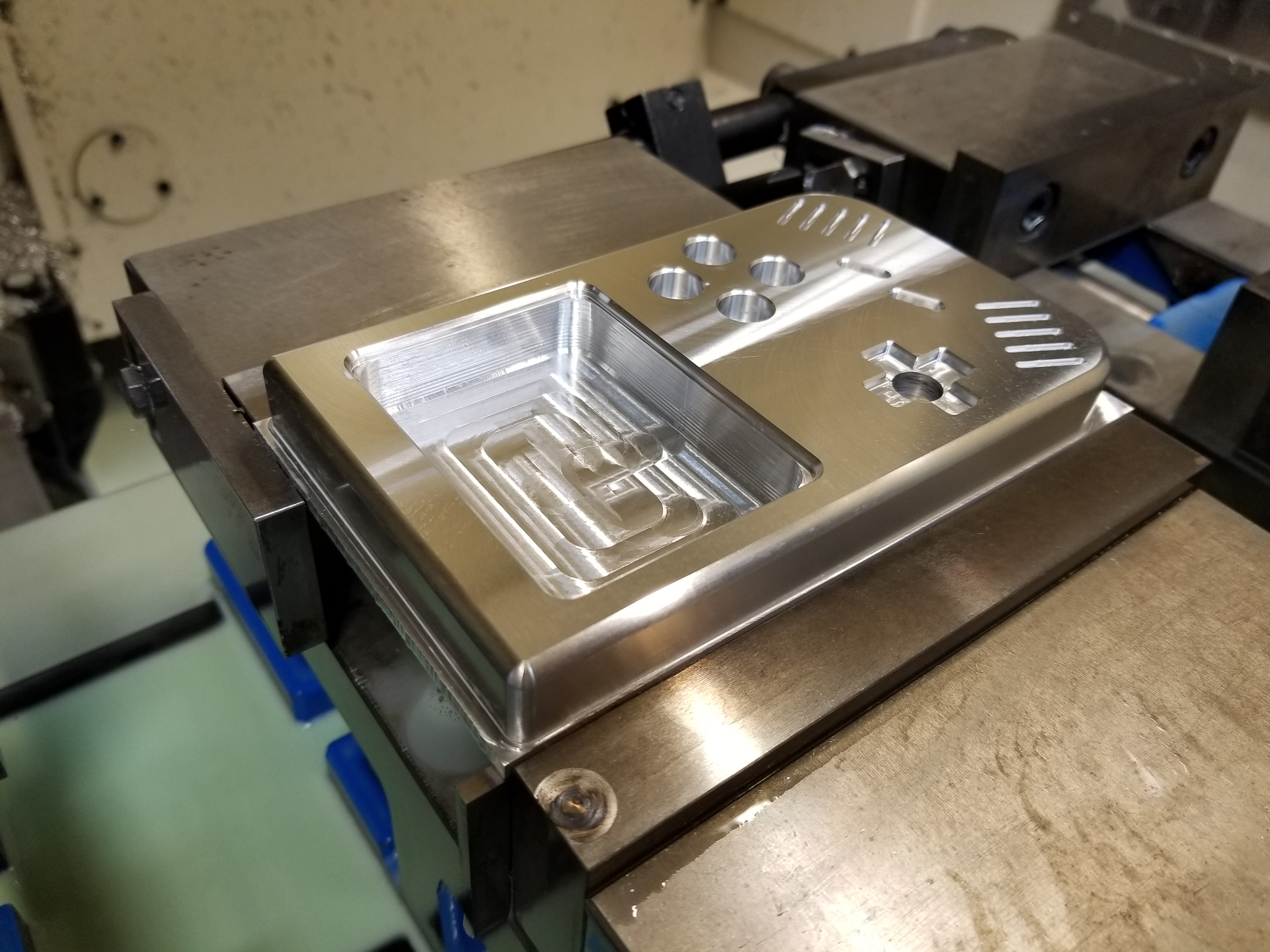

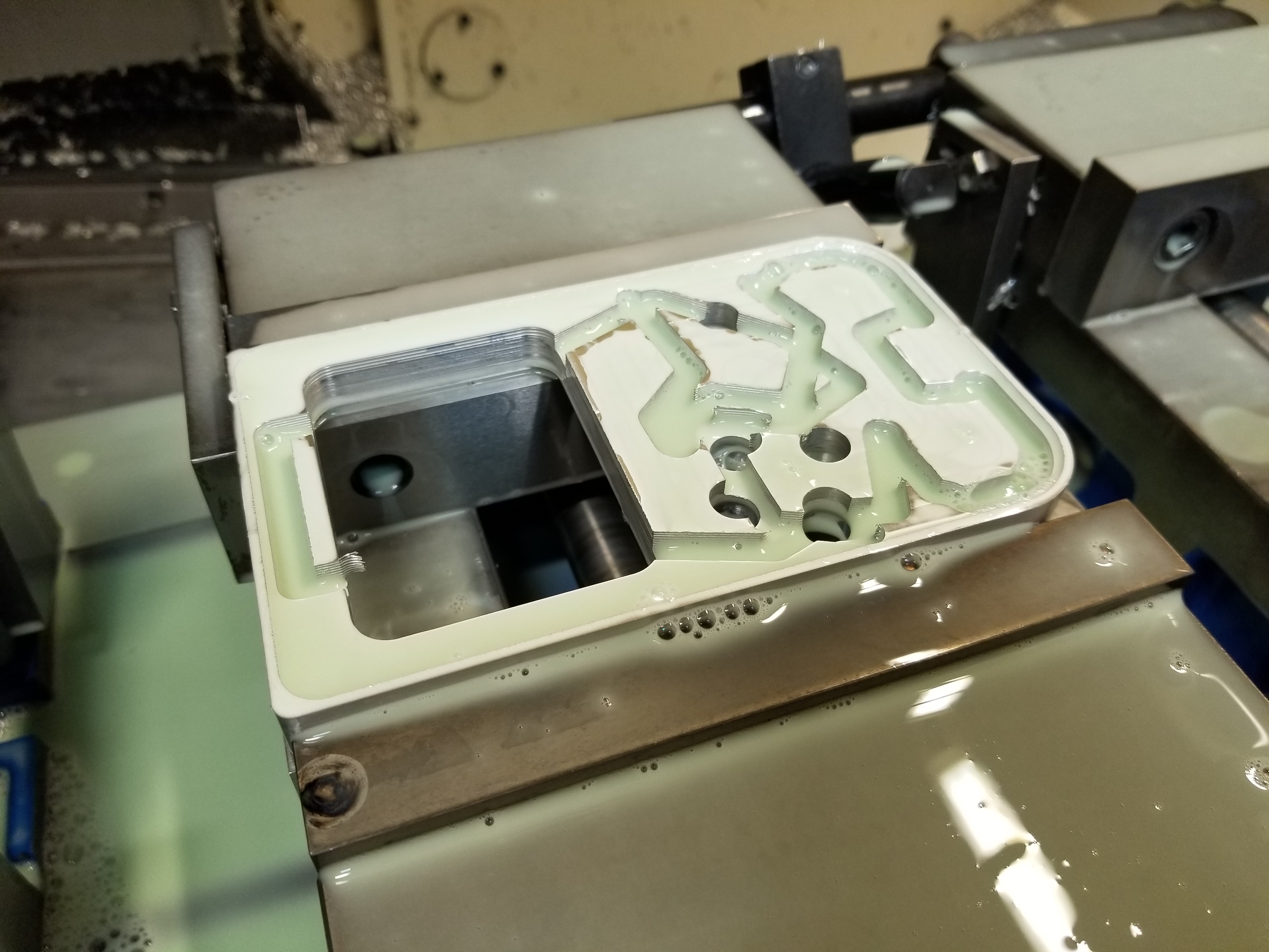

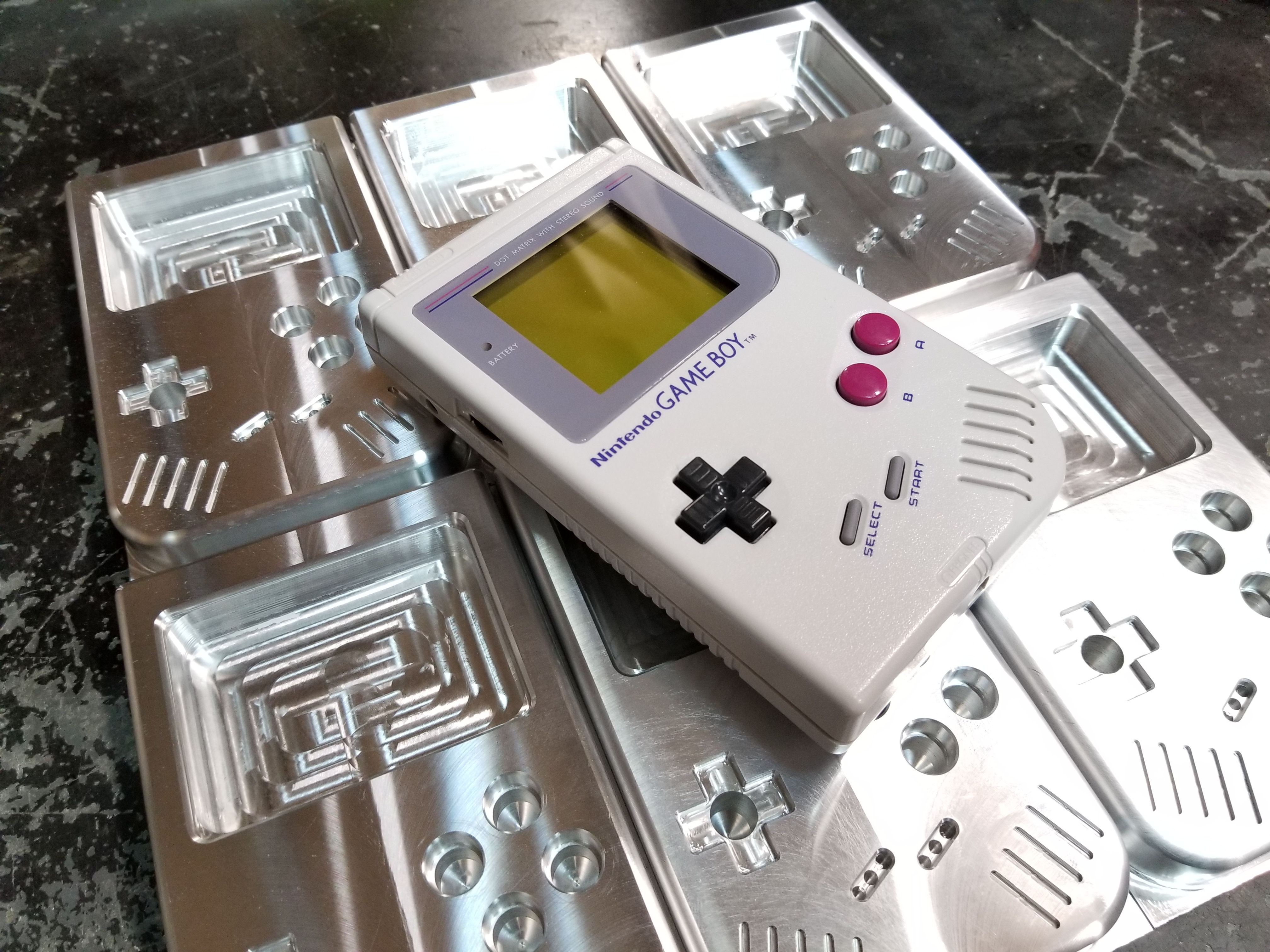

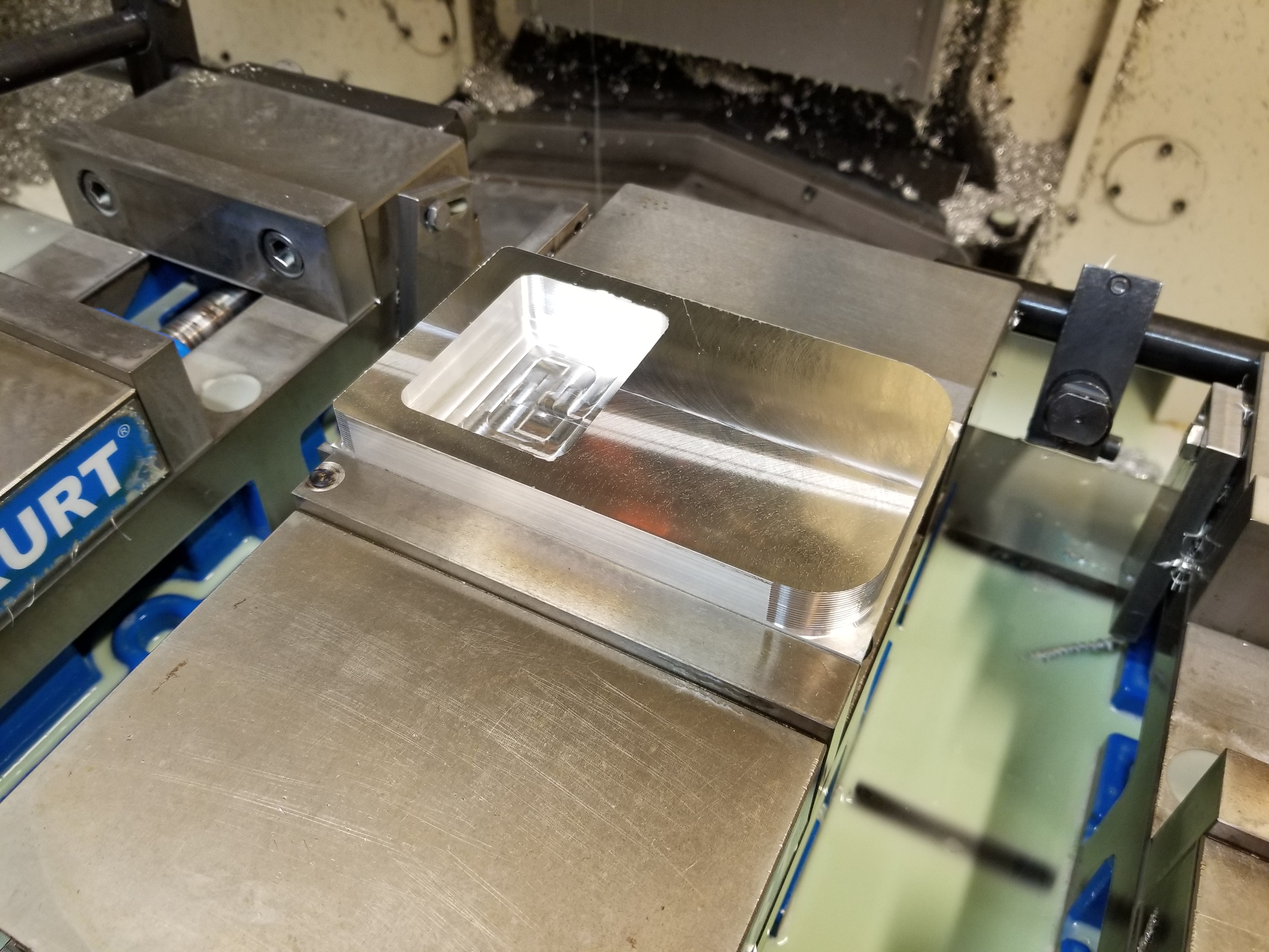

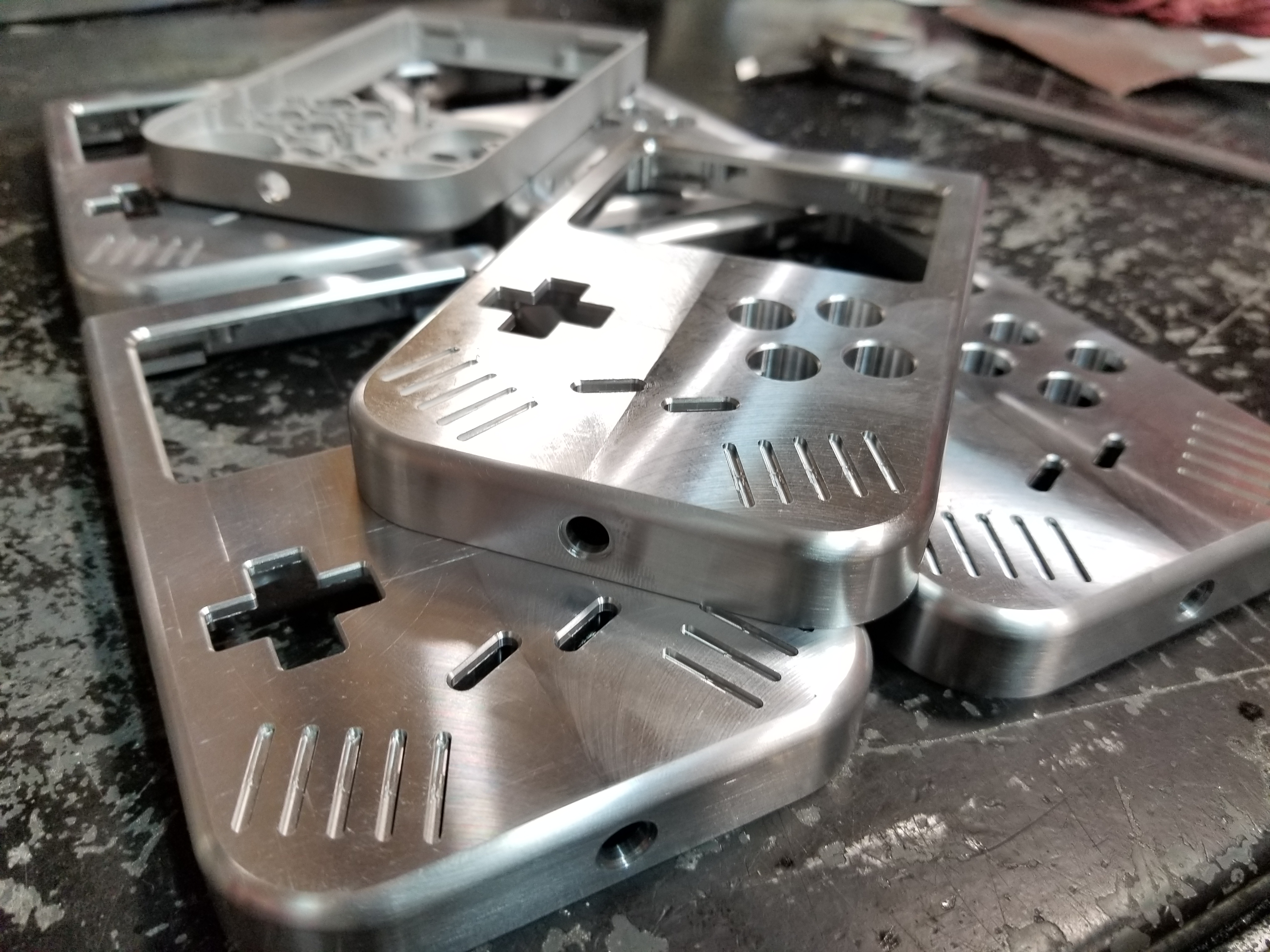

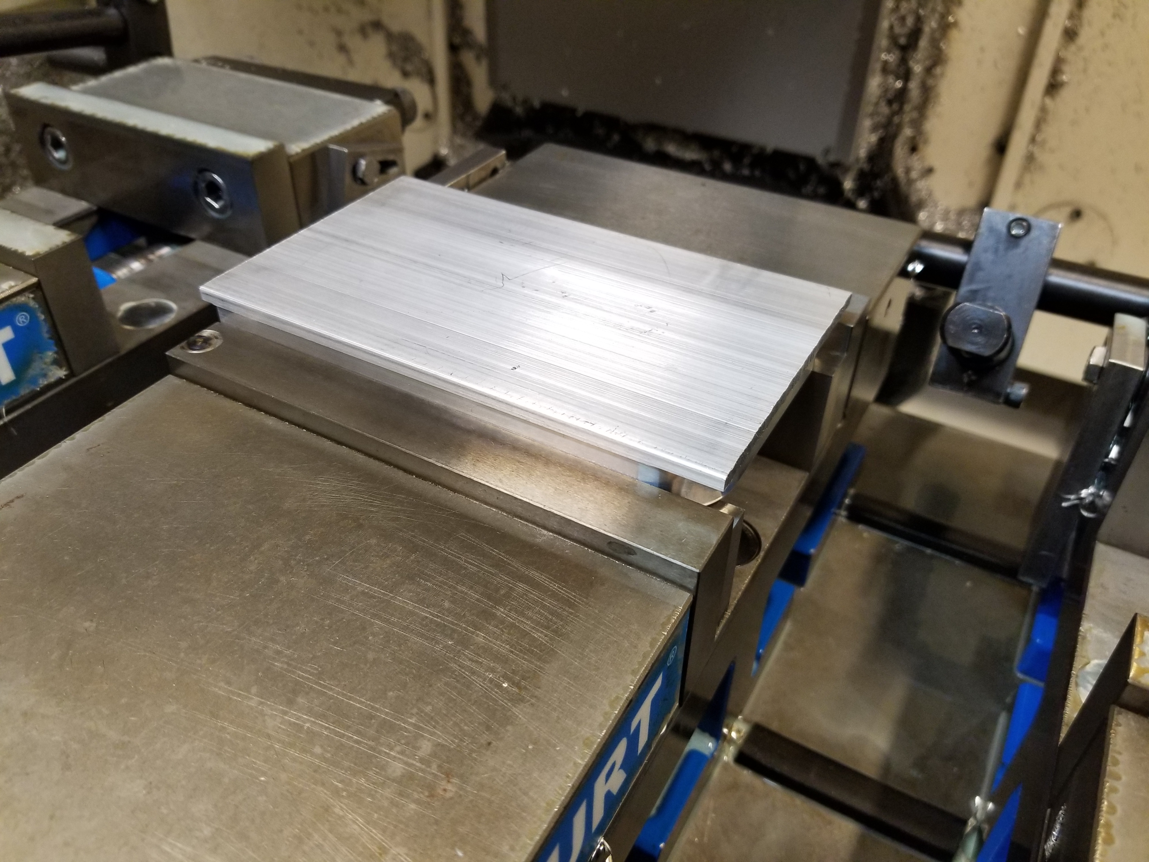

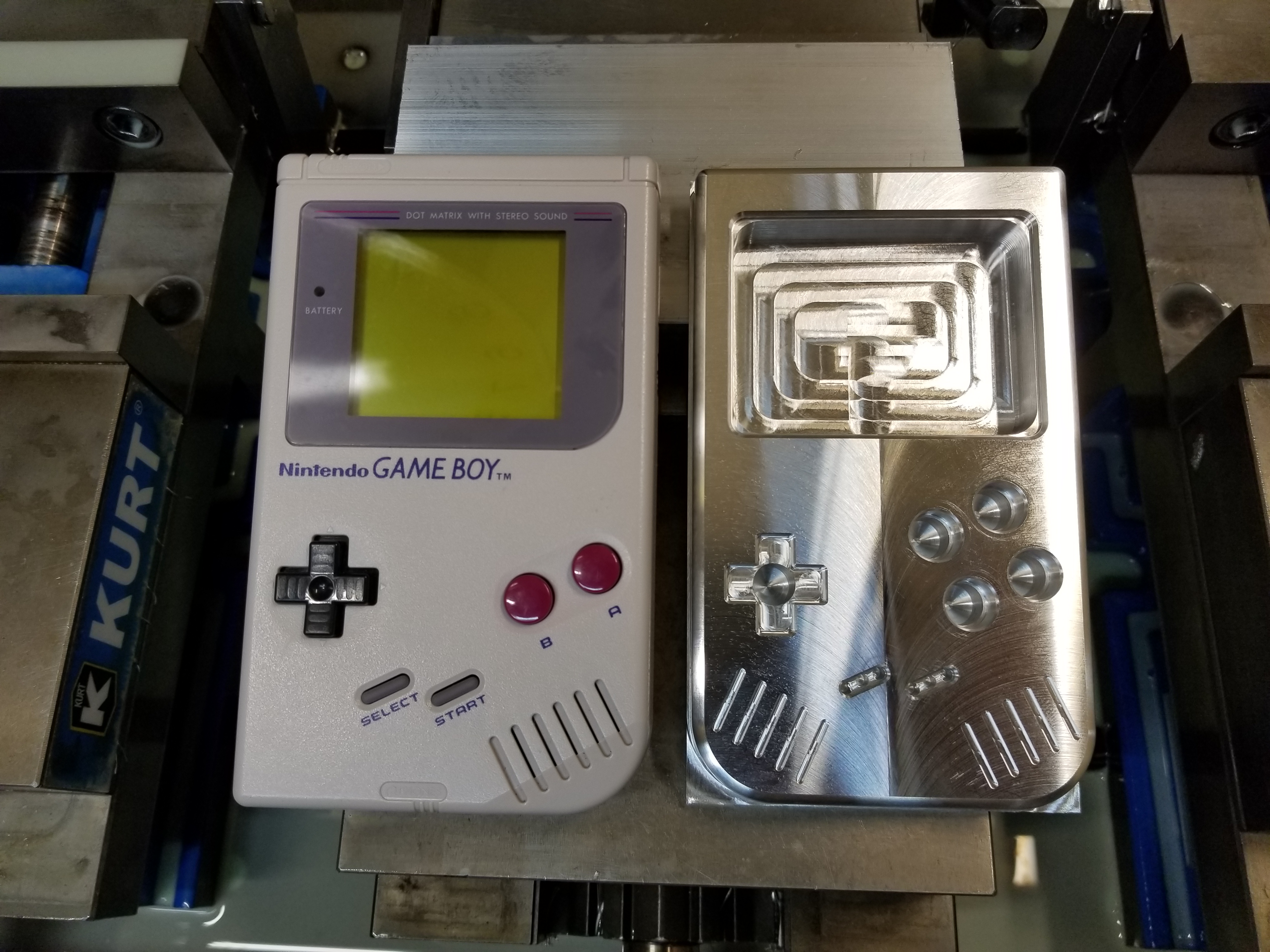

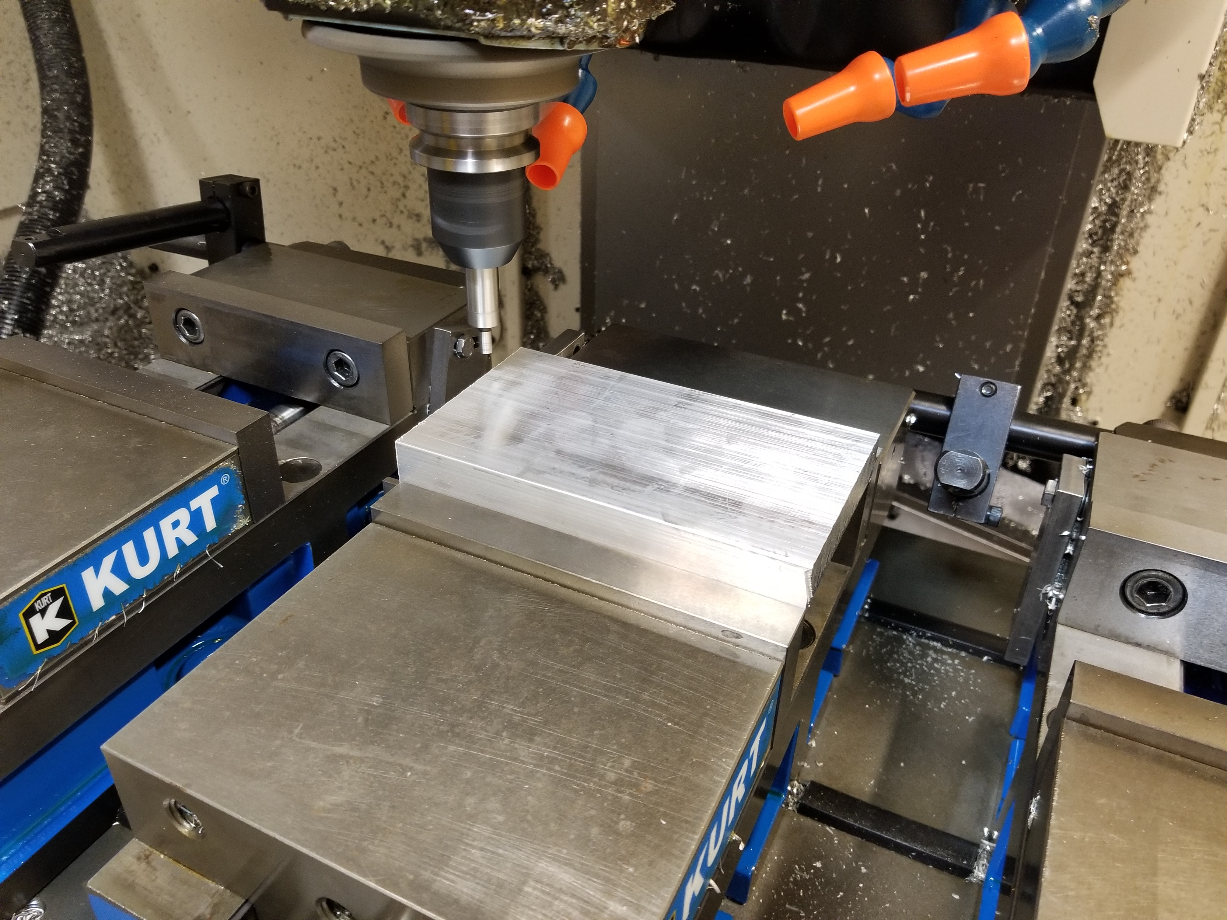

I first want to thank everybody on this forum for posting and sharing their builds. It has inspired me to try my hand at it. I've built some arcade cabinets in the past both from wood and metal but this is my first attempt at a handheld. I quickly realized it's pretty tricky to get all the little bits and pieces to fit inside a handheld system compared to a full size arcade machine. At first, I was just going to go the case mod route but I never found a AIO board with all the features I was looking for. So I decided to start from scratch and create my own case and PCB. It's taken me about 4 months of design time (working on it in my spare time) but I've finally started making some aluminum chips. My background is CNC machining / mechanical design so the case design and prototype is by far the easiest of all the task for me. I've only created basic PCB's in the past so creating the PCB's for this design will be a good learning experience.
Below are a few pics I took during the 1st and 2nd operations of cutting the front case.
2019-04-19 16.51.02.jpg (3.96 MiB) Viewed 8963 times
2019-04-19 18.45.21.jpg (3.53 MiB) Viewed 8963 times
2019-04-19 18.58.47.jpg (3.24 MiB) Viewed 8963 times
